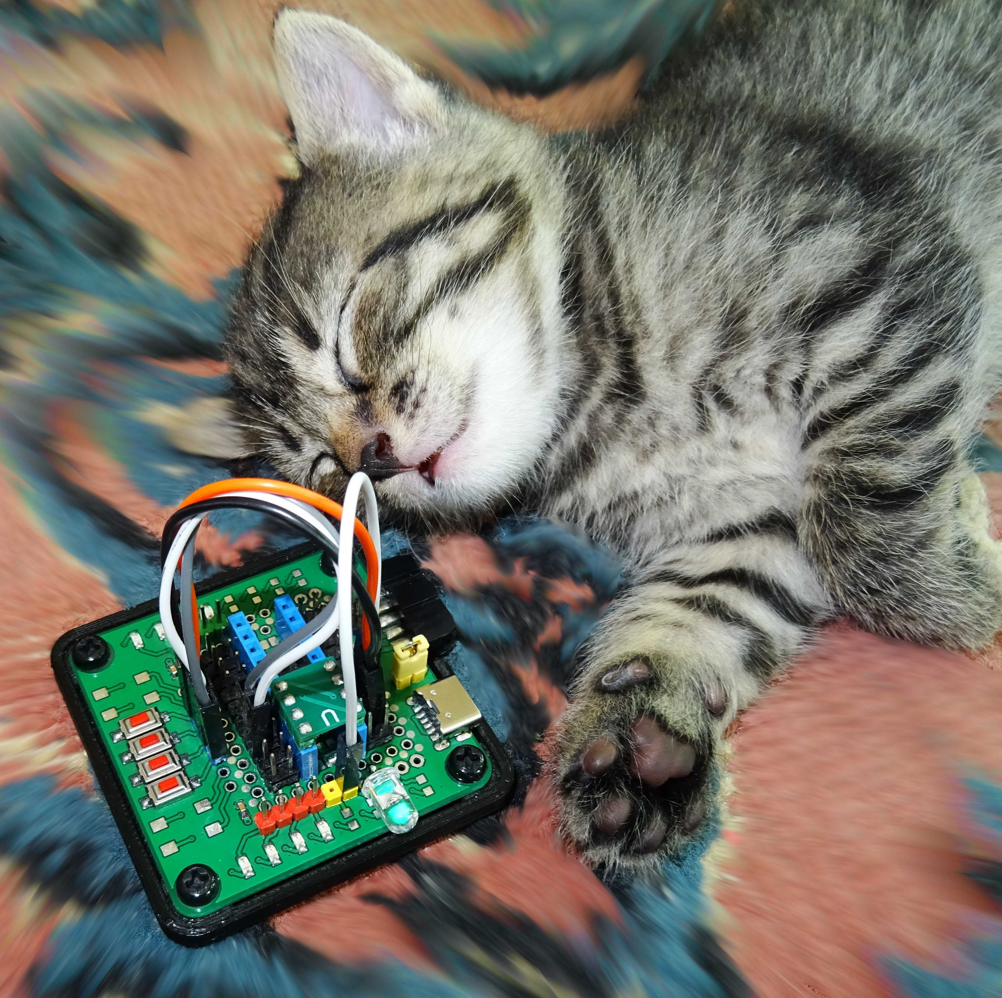

Hello, after a long break. This time the Chinese ... chip from Taiwan was used to build an IR remote for TV from LG.
The remote control can turn on / off the TV, change the channel or the volume. The number of functions has been limited due to the small number of IO of the microcontroller.
The used PFS154 can be changed to PMS150C after a slight modification of the program.
Codes:
To find out how the original remote control works, I connected an analyzer to its transmitting diode.
The pilot transmits at a frequency of 38 kHz. First there is a longer start bit, then 8 data bits + the same 8 bits only inverted, then another 8 data bits + negated 8 bits, finally a short stop bit.
Holding the key down causes sending a slightly different start bit every 100 ms without additional data.
The frequency of 38 kHz is generated by software:

Diagram:
I gave up the diode current limiting resistor :P .
The current capacity of the pin at a short-circuit to plus 3.3 V is 24 mA (measured).

Anonymous 21 Jul 2022 17:48
It is a bit unprofessional to load the pin of the microcontroller with a current exceeding 20 mA. I understand that the LED current is limited by the microcontroller gate protection, because the voltage... [Read more]
piotr_go 21 Jul 2022 18:06
The Chinese like to connect 7-segment displays without resistors. These microcontrollers have a programmable IO current capacity. IR LEDs consume quite a lot of current> 20 mA If I counted correctly,... [Read more]

16 mA it would be if some limiting resistor were used in the US. If it is a gate current stabilization, then by subtracting the voltage drop across the LED, there is still more than 2 V of reserve, and... [Read more]
piotr_go 21 Jul 2022 20:29
I would not expect a built-in current source from a 3 cent chip. 16mA after taking into account the decrease in the LED, 24 mA without the LED. Although I admit that I did not measure with the LED. I'll... [Read more]

piotr_go 22 Jul 2022 00:08
I tired PA5 set to 0 and shorted to +. After an hour on 3.3V and 5V power supply. The short-circuit current is still as it was. [Read more]

Mlody_Zdolny 22 Jul 2022 10:19
The PFS154 just has a global setting for all Low / Normal current output pins, something like fuses in the AVR. In PFC460, individual Normal / Strong pins can be individually set in a dedicated IOHD register. ... [Read more]
