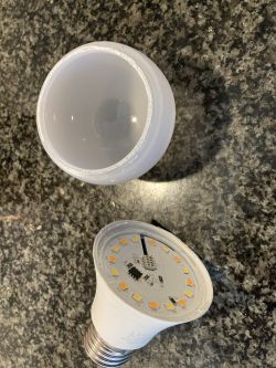

Opening the light is pretty easy. If you have some experience opening devices, you can easily pry it open en glue it back together without damage.
I use a 9mm thin blade, see picture. Slide the blade between the 'transparent' plastic and the base of the light. And keep turning the bulb in your hand, while you use the other hand to push the blade further into the bulb. It might take some time and force before you notice the top of bulb will loosen up. Just try to tilt the transparent piece after every other turn. Eventually it will separate from it's base.
When you've separated the bulb. You have to remove the LED board. Remove the glue around the board with a screwdriver and a sharp blade. I use a little metal hook that I've bend into an L-shape to pull out the LED board. Keep removing glue until it will pop out. Pull it out straight otherwise you'll damage the pins that hold the board to the base of the bulb.
Finally, remove the metal cap at the bottom of the bulb with a sharp balde or screwdriver. It's not screwed in or glued, just pull it out.
You'll see a little metal wire. Carefully bend it to the center of the bulb, into the hole.
Now that you've loosen the the metal wire at the bottom. You can pull out the main PCB of the bulb a little bit, for 5 to 10mm.
When the sticker on the chip is removed. I found a BK7231T.
On the bottom of the PCB you'll find the pins you need for flashin. They are clearly marked. The TX and RX are small but with a steady hand and your soldering iron, you'll manage to attach some wires.

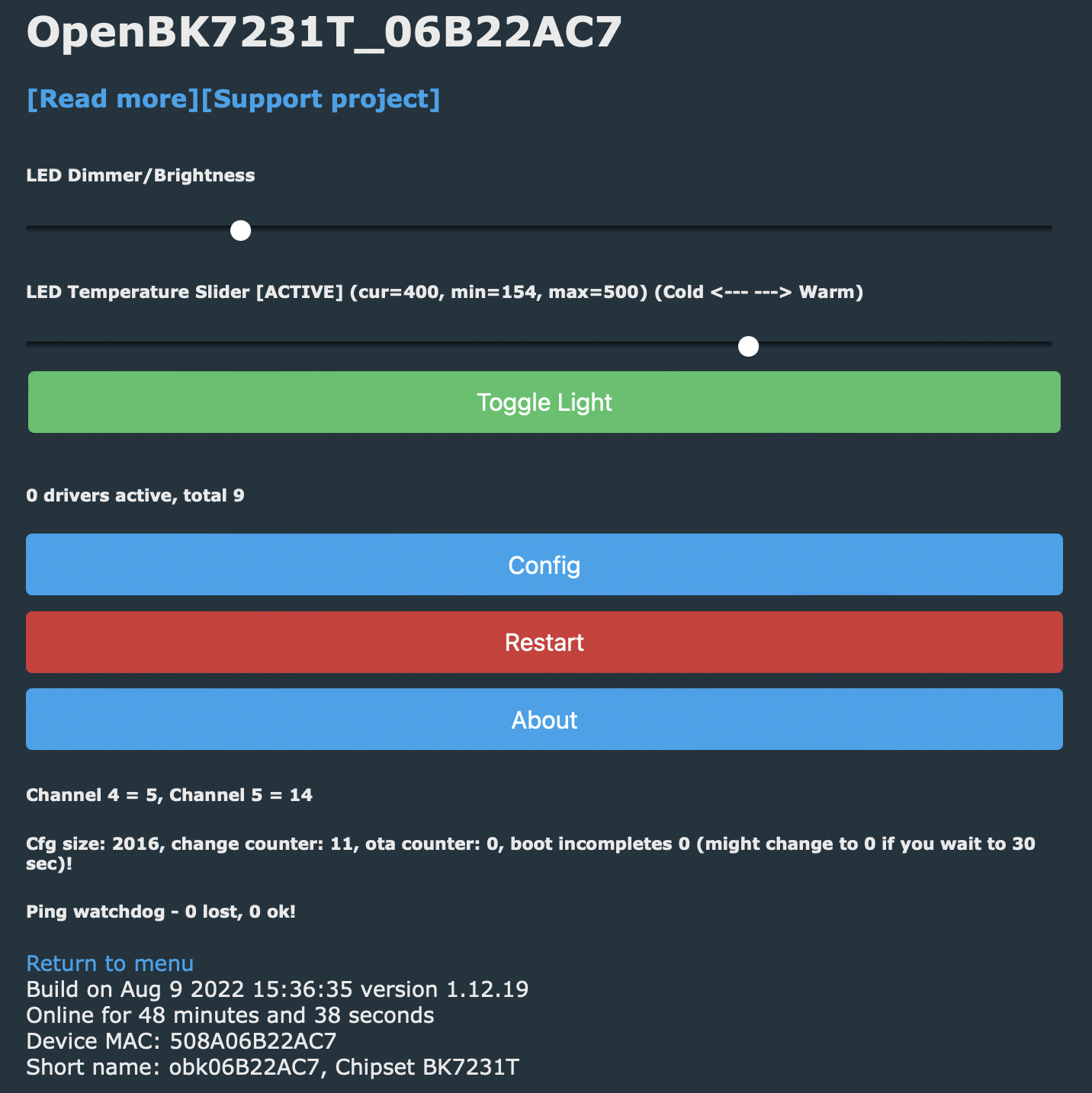

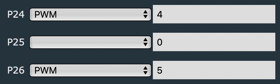

Flash it with your USB UART flashing device and set pin 24 as PWM value 4 (CW) and pin 16 as PWM value 5(WW).

This is the YAML configuration I use in HA.
The light shows up as I expect in the HA GUI.

Hi there, i have a very similar bulb, 2000273 instead of 2000272 - it's basically the same bulb but with 1400 instead of 800ish Lumen... After some searching around, from what i gather on the tasmota... [Read more]
p.kaczmarek2 28 Oct 2022 13:47
Beken chips have 6 possible PWM pins. Have you checked them all? Is your device CW? If none of PWM combinations are working, then you might have a bulb with a dedicated LED driver chip with a variation... [Read more]
starfelicious 28 Oct 2022 14:01
Yes, it's a CW device... I did notice this as well, the config page states that "BK7231N/BK7231T supports PWM only on pins 6, 7, 8, 9, 24 and 26!" How would i go about testing the other 'pins' ...do... [Read more]
p.kaczmarek2 28 Oct 2022 14:44
Well... the simplest way... would be to try setting 6, 7, 8, 9 24 and 26 to "Relay" role and give each of them a separate channel, 6 will be channel 0, 7 channel 1, 8 channel 2, 9 channel 3, 24 channel... [Read more]
starfelicious 28 Oct 2022 15:02
Aaaah, i see what you did there. That actually got me somewhere... Turned out, 7 and 8 (once on channel 1 and 2) did the trick. One switched on full white, the other switches on full warm/yellow. Removed... [Read more]
