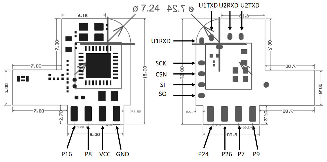

RGB+CW Lapm Tuya WBLC9 (BK7231T) + BP1658
skrc1  7 5670 Cool? (+7)
  • A Tuya RGB+CW lamp using the WBLC9 module with BK7231T and BP1658 gets converted for OpenBK7231T control.
  • The body is heated, pried open, and the controller’s flash is backed up with a CH341A before any firmware changes.
  • The SPI chip is identified as EN25QH16, a 16 Mbits / 2 Mbytes flash, and the backup can be restored later.
  • OpenBK7231T is flashed over UART with a 3.3V serial adapter, then configured at 192.168.4.1 for BP1658CJ_DAT on P24 and BP1658CJ_CLK on P26.
  • Home Assistant MQTT settings and the startup command `BP1658CJ_Map 2 1 0 4 3` complete the lamp integration, with power-loss restore enabled by Flag4 and Flag12.
My humble contribution.

Next are two options:
save a backup and be able to rollback or just flash
Create and save a flash memory backup. You need a programmer SPI memory, for example
inexpensive CH341A.
Spoiler:
connect the SPI bus in CEN
??????..PNG (104.41 kB)You must be logged in to download this attachment. msg1652874...-36683.jpg (129.17 kB)You must be logged in to download this attachment.
connect the programmer. Be careful. TC can be damaged by jerks on the wires
msg1652874...-36684.jpg (257.65 kB)You must be logged in to download this attachment.
Software NeoProgrammer, Asprogrammer
NeoProgrammer download
Drivers download
Script for transferring the chip to memory access mode

1. Press CEN in gnd, Execute script & release CEN
wait 15701 in log
repit in err (id 00000)
2.Press "Detect" Chip
select EN25Q16
3. Press Read IC
Wait:
Currently selected: EN25QH16 [3.3V] 16 Mbits, 2 Mbytes
Current programmer: CH341 Black
21:19:22
Reading memory... Main Memory
Success
Execution time: 00:00:17.072
CRC32 = 0x********
4.Press File & Save
Great. you can always return to this state if you do not break the board :-)
Firmware through any UART port available to you with 3.3v levels (for example)
We transfer the programmer CH341A to serial mode, remove the jumper (or any other, which is available)
run the program for the firmware (download the program and the latest firmware )
specify your file with the program and your com port
python uartprogram С:\test\OpenBK7231T_UA_1.12.103.bin  -d com8 -w
Next, we connect to the access point, go to the address 192.168.4.1 and make settings
The main ones related to the lamp and the chip:
Configure module:
P24 BP1658CJ_DAT
P26 BP1658CJ_CLK
Configure General
set Flag4 ( restore on power and flag12 )
Change Startup command text::
Setting up MQTT ( ip, topic, username, password )
