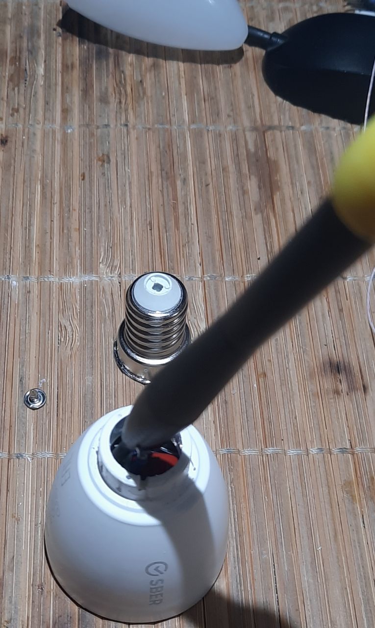

    disassembly:
    Spoiler:
    We heat up
    Spoiler:
    RGB+CW Lapm Tuya WBLC9 (BK7231T) + BP1658msg1652874...-36671.jpg (137.91 kB)You must be logged in to download this attachment. RGB+CW Lapm Tuya WBLC9 (BK7231T) + BP1658msg1652874...-36673.jpg (94.07 kB)You must be logged in to download this attachment.
    And with both hands, just gently break it in half. :-) The main thing is not to damage your hands, eyes, body, as well as the lamp body and the ceiling.

    With a blunt knife, gently move the base in a circle

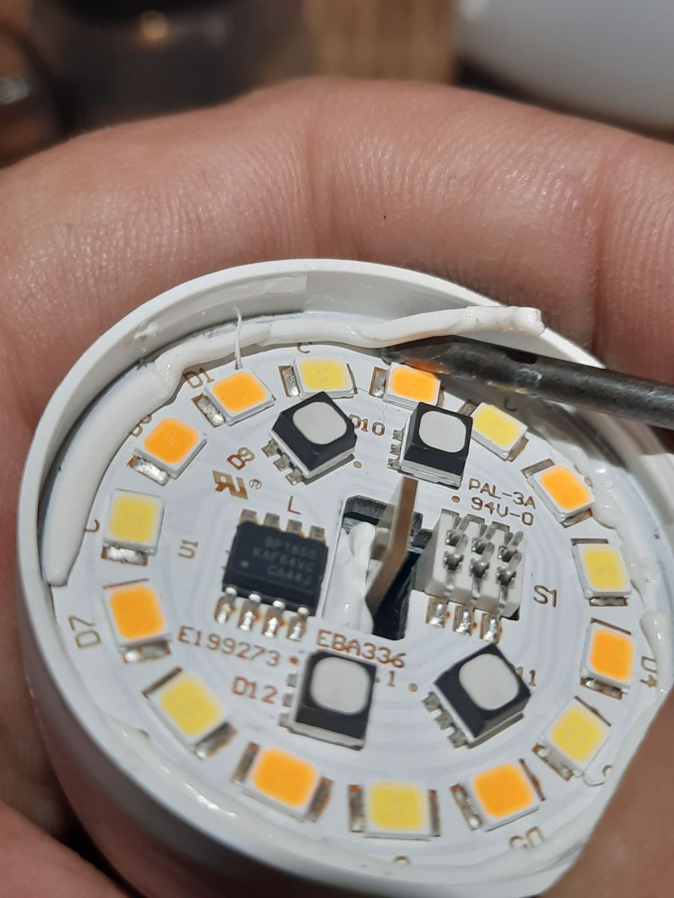

    cut off white snot
    Spoiler:
    RGB+CW Lapm Tuya WBLC9 (BK7231T) + BP1658msg1652874...-36680.jpg (123.36 kB)You must be logged in to download this attachment.
    with a thin but strong screwdriver, push the disk out with LEDs
    Spoiler:
    RGB+CW Lapm Tuya WBLC9 (BK7231T) + BP1658msg1652874...-36679.jpg (143.45 kB)You must be logged in to download this attachment.
    Excellent result:

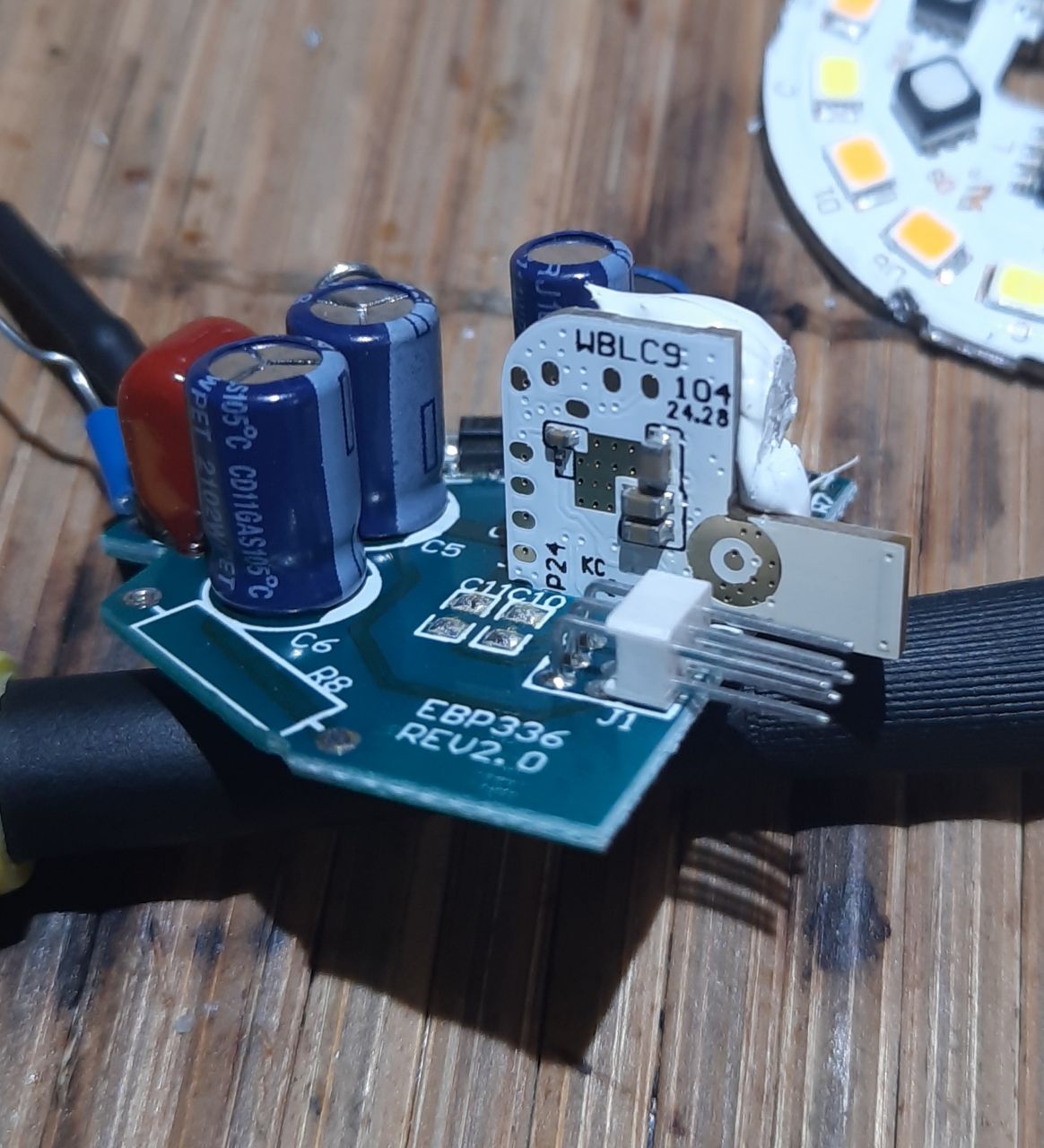

    connect external power
    RGB+CW Lapm Tuya WBLC9 (BK7231T) + BP1658msg1652874...-36682.jpg (71.34 kB)You must be logged in to download this attachment.
    We solder the contacts of the TP
    RGB+CW Lapm Tuya WBLC9 (BK7231T) + BP1658msg1652874...-36685.jpg (31.28 kB)You must be logged in to download this attachment.

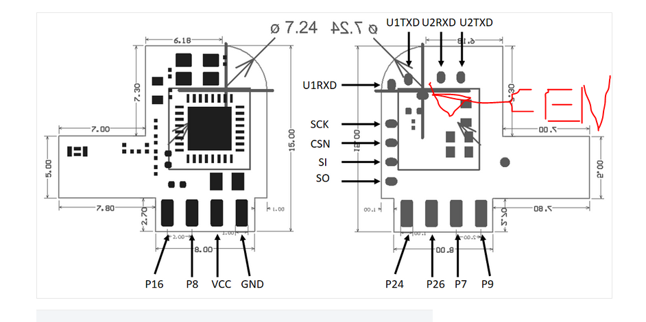

    Create and save a flash memory backup. You need a programmer SPI memory, for example
    inexpensive CH341A.
    Spoiler:
    connect the SPI bus in CEN
    RGB+CW Lapm Tuya WBLC9 (BK7231T) + BP1658??????..PNG (104.41 kB)You must be logged in to download this attachment. RGB+CW Lapm Tuya WBLC9 (BK7231T) + BP1658msg1652874...-36683.jpg (129.17 kB)You must be logged in to download this attachment.
    connect the programmer. Be careful. TC can be damaged by jerks on the wires
