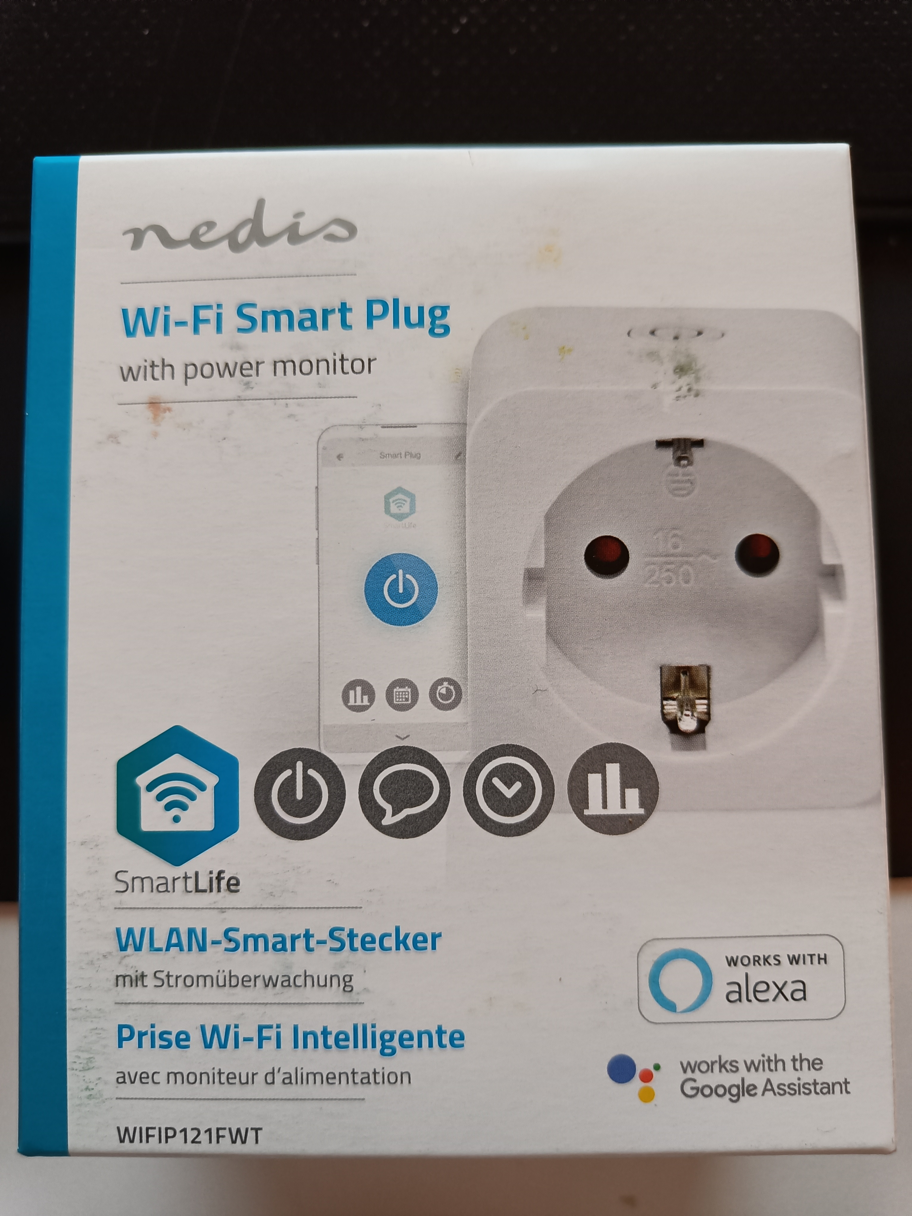

About The Device
Nedis Wi-Fi Smart Plug WIFIP121FWT, Remote controllable plug with energy monitoring.
