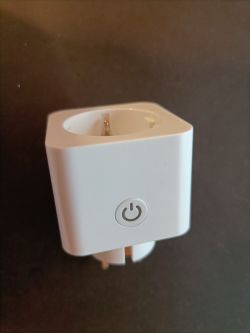

    Disassembled
    The plug itself
    Nedis Wi-Fi Smart Plug WIFIP121FWT (BK7231N, BL0937, CB2S)
    To remove the bottom cover, there is need only for simple small screw driver. The cover has small fastener in the each corner of the cover. A bit force is needed, but not that much there is any fear of breaking the cover.

    Flasing
    Since I am not electronics guy, I couldn't find regulator from the PCB. There might be, but I went through all chips which I found and none of them were regulator for my eyes. So I used normal FTDI USB to TTL adapter. I soldered short cables to the 3.3V, GND, TX, RX and CEN pins of the BK7231N module.
    Connected everything like this:
    ModuleUSB to TTL
    3.3V3.3V
    GNDGND
    TXRX
    RXTX

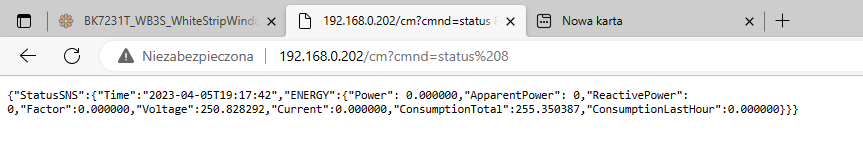

    The problem
    The relay works so the plug can be remotely controlled. Unfortunately the BL0937 is not automatically starting up during reboot. When using command startDriver BL0937 the chip seems to be available, but once trying to give VoltageSet etc.. there is just information:
    Info:EnergyMeter:VoltageSet: you gave 230.000000, set ref to inf

    Hey @elurkki , thanks for the post and the teardown, I will add it to our online teardowns database.
    Regarding your issue.... that's strange, please give me a while to investigate. I will update my post here later.
    EDIT: I know what might be wrong.
    the res_v variable is 0 so you get the division by zero here.
    When dividing by zero, you get infinity.
    It sounds like an invalid configuration of BL0937.
    And now that I look at the post...
    This sounds very implausible.
    CF1 is used to count voltage pulses:
    It is not possible to measure voltage without CF1. This is why you have zero value in res_v variable.
    How to fix? Well, you have two options.
    1. recheck connections with multimeter to determine where CF1 goes
    2. try to guess where CF1 is, maybe look at other templates, and just try it out, but remember to reboot every time after changing config so BL0937 driver can be reset.
  • BL0937 CF1 pin and startup values fixed
    #3 20238655
    elurkki
    Hi,
    You are absolutely correct! I opened the plug again and measured all the pins again. The pin 6 was just covered something and didn't give values until I used a bit force to get some values. Sorry for this inconvenience.
    The pin for this is BK7231N (24) -> BL0937 (CF1). Now the BL0937 starts up at the startup.

    Btw I hope you also know that we have Tasmota-like JSON interface:
