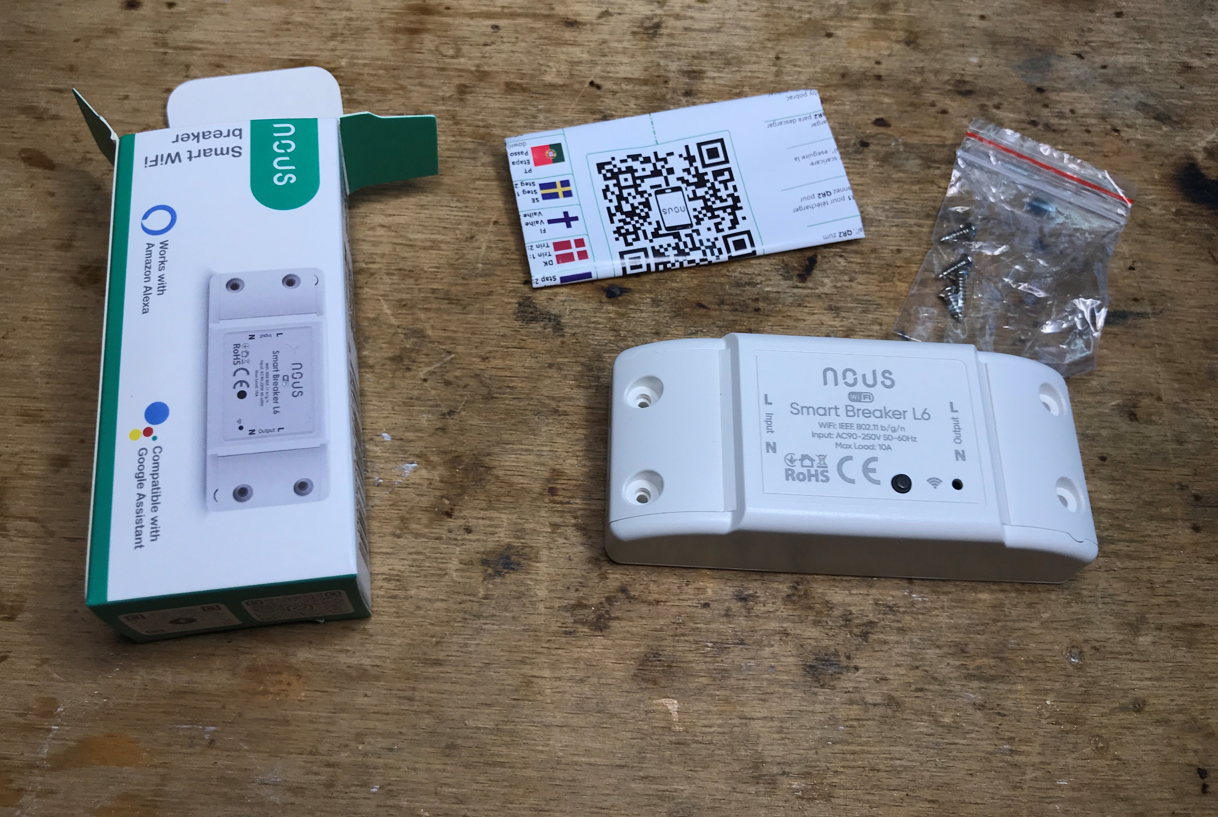

Today a glimpse inside another IoT gadget, this time from a Polish auction site. We'll check if it's worth buying and whether there's an ESP8266 or some other WiFi module inside. The Nous L6 relay, called a 'controller' by the seller for some reason. Standard, a gadget that cuts off just one wire (if wired right, it cuts off the phase) for control via the mobile app or via a button on the case. PLN35 a pop, I've seen cheaper Sonoffs....
Product to be controlled via WiFi via mobile app, of course.
Screenshot from the auction:
That's odd - the seller doesn't warn you that you need to ensure that you connect the phase and zero correctly (i.e. don't swap them places):
Box:
Kit contents:
Bottom:
Tuya sometimes still gives a strip of double-sided tape, here this was not present.
We take a look inside:
Everything standard... there is even a varistor, there is a fuse, there are two electrolytic capacitors at 400V and a choke (pi filter?) between them....
Transformerless power supply, probably gives 5V to the relay:
Bottom of the board... LDO AMS1117 3.3V regulator - gives 3.3V for the WiFi module:
BP2905 - transformerless inverter controller:
Transistor with code 1AM (engages the relay):
And the WiFi module - WBR2:

Summary .
Unfortunately. There is no way to change the firmware of this relay at this time. My OpenBeken supports the platforms: BK7231N, BK7231T, T34, BL602, XR809, W800 and W600, but does not yet support WBR2/W701 (W701-VA2-CG). Tasmota will not be uploaded here either. I will try to add W701-VA2-CG support in the future, but for now I would advise against buying this product. Better to buy something proven on ESP.
