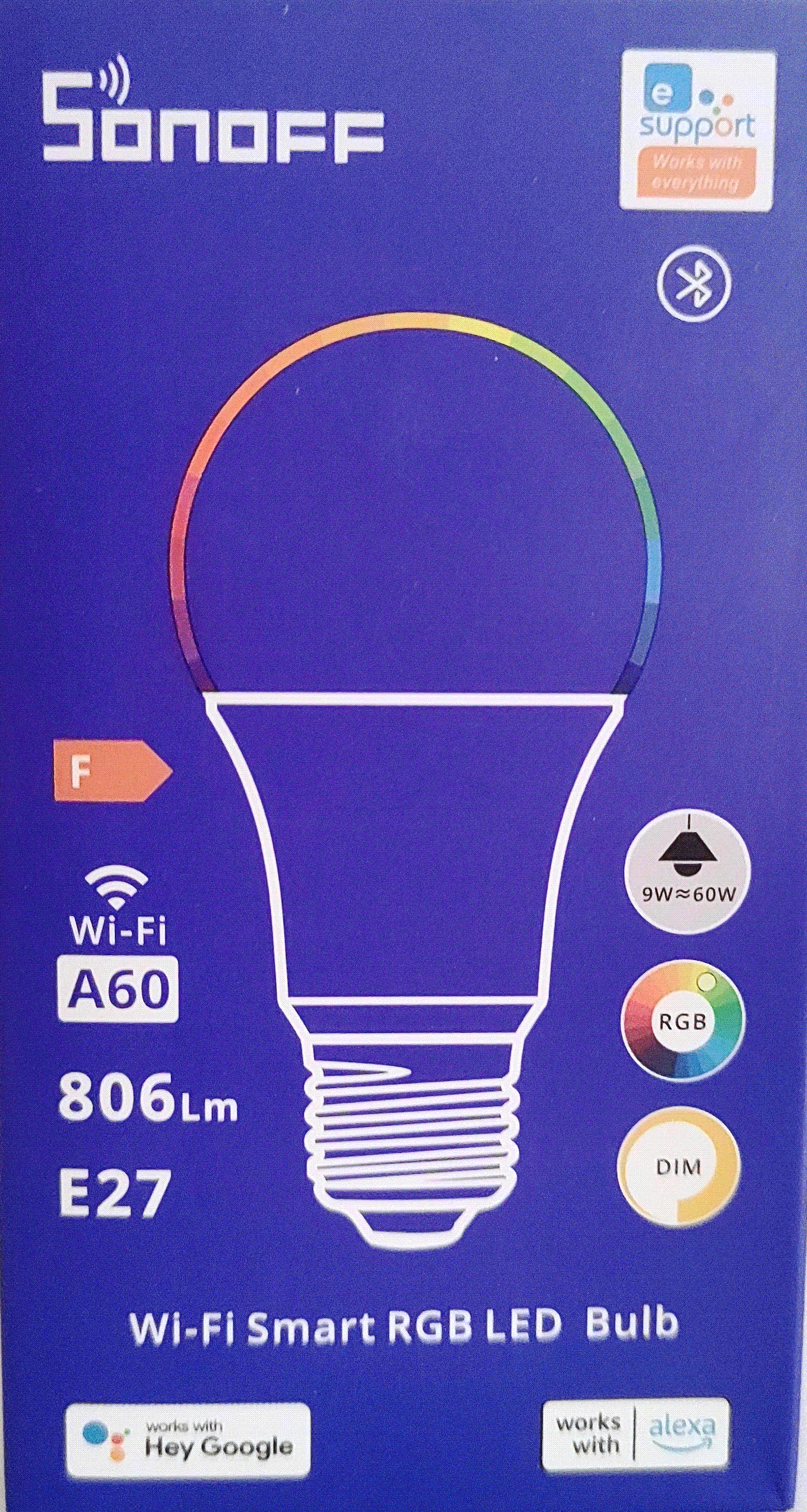

  • Teardown of the Sonoff B05-BL-A60 smart bulb, chosen for its advertised API support and explicitly distinguished from the different B05-B-A60 variant.
  • Opening the bulb reveals a BP5758 LED driver on the LED plate, with the power supply and Wi‑Fi components underneath and easy access to 3.3V, Ground, TX, RX, and Boot pins.
  • Each bulb costs around 11€ and carries energy class F.
  • Flashing is described as feasible with online guides and SDK tools, but the current firmware does not yet support the BP5758, and the API is awkward for multiple devices because of different IDs.
Because of the, from Sonoff advertised, API, I ordered from Appla.cy the B05-BL-A60 bulbs.
Each one has a price of around 11€. Take care, I am talking here about the B05-BL-A60 NOT the B05-B-A60 which has a different chip, different led driver and no API!
Surprised of the energy class F, I tested the API which is more or less useless if you have a need of some more devices and if you don’t want to struggle with different ID's for each single device.
