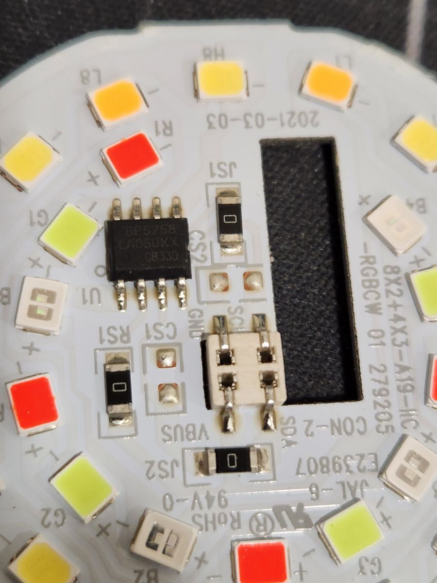

    After opening the bulb, B05-BL-A60 Sonoff Teardown you will find the LED plate with an BP5758 LED Driver. THE BP5758 seams to be an I2C Tuya Driver. Removing the LED Plate, you will find the power supply and the WIFI components:
    After disassembling, all the necessary pins are easily accessible.
    3.3V
    Ground
    TX
    RX
    Boot.

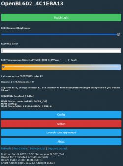

  • BP5758D driver loads but RGBCW command missing
    #6 20276360
    Thom4Fun
    Rate: 7

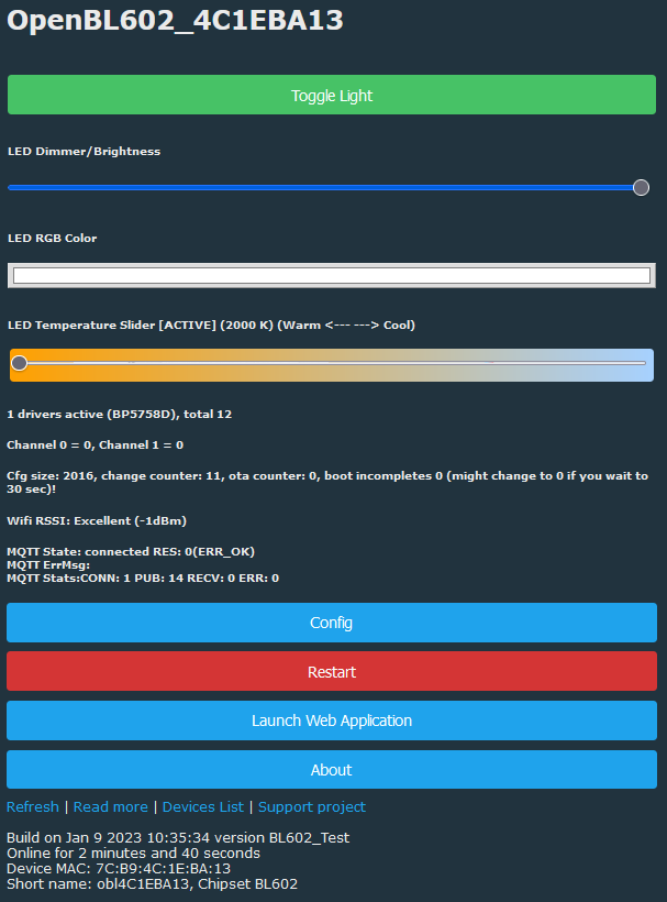

    Sorry for the delay, I have some healty problems and have to be back to the hospital on Friday.
    But I give the new version a try on a brand new device, and with luck. The gui shows the LED stuff, but the webapplication not.
    As well, the the gui shows 1 driver loded (BP5758D) total 11. The command BP5758D_RGBCW returns "command not found".
    I put
    BP5758D_CLK on Pin 2 and channel to 1, and
    BP5758D_DTA on Pin 21 and channel to 2.
    Not sure if the channel stuff is needed, but in general it works well. The colors are mistaken, but I am sure that this will easy to correct with BP5758D_RGBCW if implemented. As soon as possible, I will update the teardown with more infos.

    My bulb won't light up.
    I put BP5758D_CLK on Pin 2 and channel to 1
    And BP5758D_DTA on Pin 21 and channel to 2
    I need help please .

  • B05-BL-A19 model has 4 LED pins
    #11 20377022
    Zain00
    Posts: 61
    Rate: 20

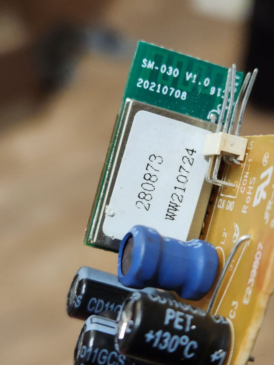

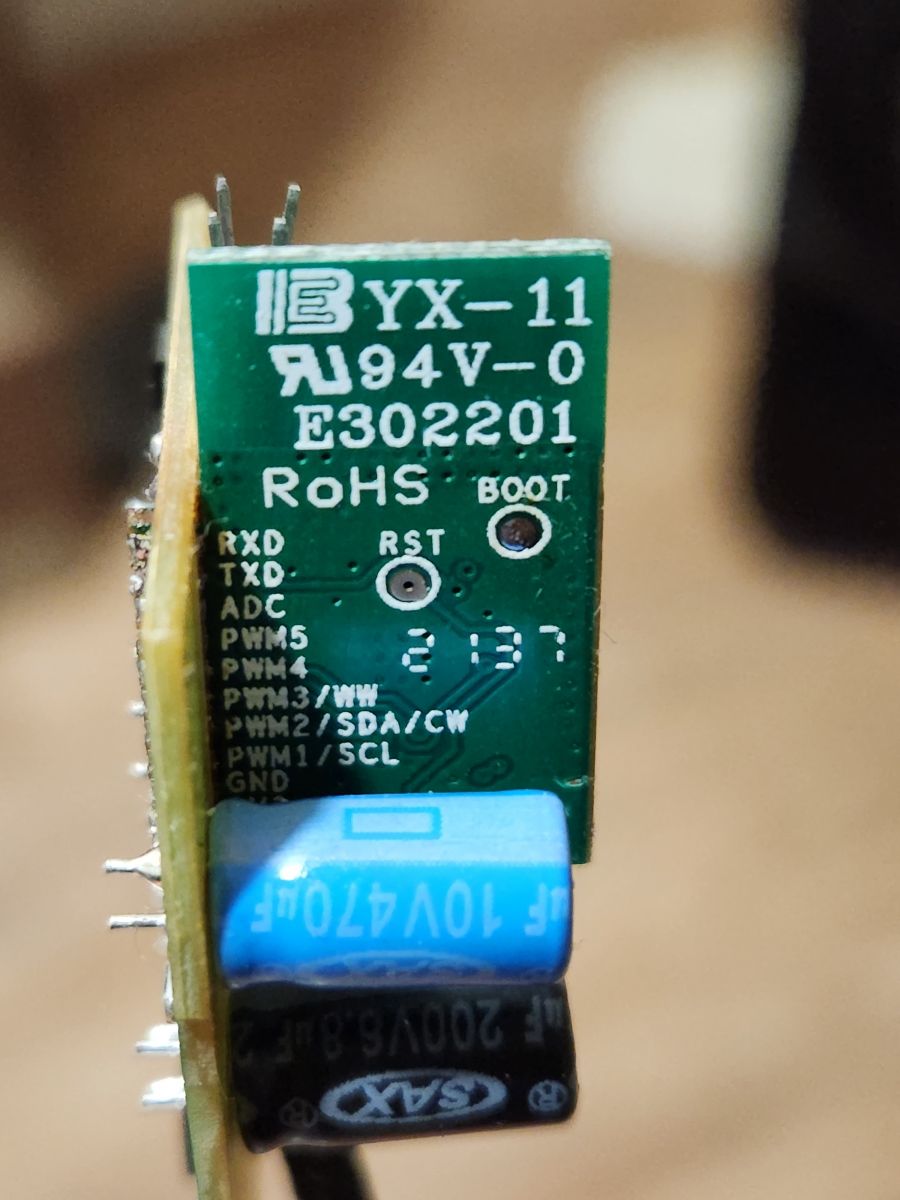

    @Zain00 , to make sure, is your bulb using BL602?
    This is my bulb
    B05-BL-A60 Sonoff Teardown B05-BL-A60 Sonoff Teardown B05-BL-A60 Sonoff Teardown
    It seems the chip is the same as what @Thom4Fun has, but mine has only 4 pins to the leds while Thom4Fun has 6 pins
    Edit: I just noticed that I have the B05-BL-A19 model

    New Update: I reflashed the chip and somehow it works now.
    But I noticed that the brightness has decreased, also the I can dim it further down now with openbeken than what I could with the original firmware.
  • Requesting firmware version and build date screenshot
    #13 20378355
    Posts: 14797
    Rate: 12954
    @Zain00 can you show a screenshot from main HTTP page showing version and build date?
    Our contributor @rogere66 recently submitted a patch that greatly increased lighting quality and introduced gamma correction setting (you can even calibrate your device!)
    https://github.com/openshwprojects/OpenBK7231T_App/issues/599
    https://github.com/openshwprojects/OpenBK7231T_App/blob/main/docs/led_gamma_control.md
  • #14 20378359
    Zain00
    Posts: 61
    Rate: 20
    @p.kaczmarek2

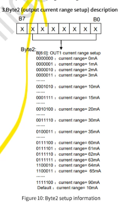

  • BP5758D current command to boost brightness
    #15 20378399
    Posts: 14797
    Rate: 12954
    Can you try doing this process?
    Or does it yields "unknown command"? You have yesterdays build, but at the moment I am not sure if it's a build made hours before Gamma Control merge, or after...
    Oh wait! There is another thing to try!
    BP5758D_Current command!
    This can increase brightness of the LED, but do not set too much values, because you'll shorten their life significantly.
    See:
    This command can be executed at runtime, but if you want a permanent setting, then you should put it in "short startup command", so it's executed with every reboot.
    NOTE: when testing, refer to datasheet and start with lowest current values. We don't know which current value used original firmware. So you have to experiment. But don't overdo it! It's better to set lower and lengthen LED lifespan than to set higher and burn them.

    It does give me "NOT found", and I used OpenBL602_1.15.301.bin.
    I did try "BP5758D_Current 0001111" command and I think it's working now.

  • BP5758D current setting needs decimal or hex
    #17 20378794
    Posts: 14797
    Rate: 12954
    It seems your build didn't include that, but don't worry, it's not necessary:
    I think it doesn't support binary notation, only hexadecimal and decimal. You should convert desired value from datasheet to decimal. Right now, you entered a random value (code interpreted it as a decimal 1111, one thousand, one hundred eleven) and lucked out that it works.

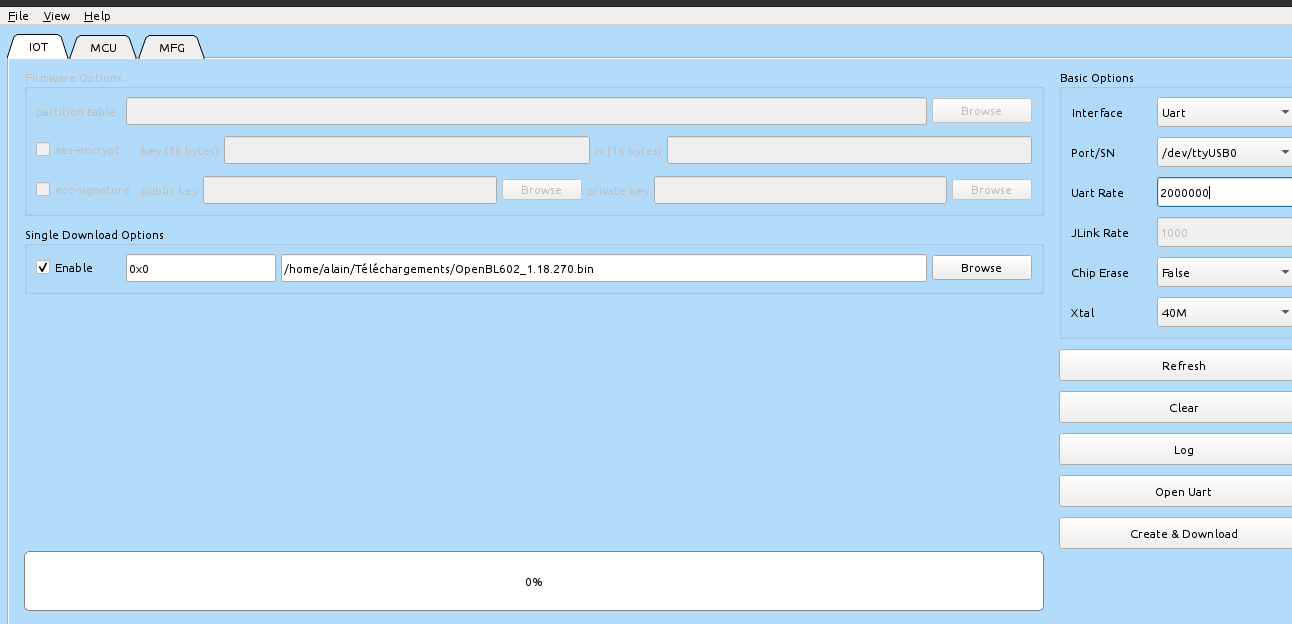

  • Flashed BL602 bulb but no Wi‑Fi AP appears
    #28 21857434
    defaliz
    Posts: 19
    ok, i've follow the video to flash B05-BL-A19 bulb, download lab_dev_cube and OpenBL602_1.18.270.bin file,
    then flash with success, but no wifi AP when i re-plug the bulb
    here are the logs , do you know where is the problem ?
    regards

    [17:17:34.182] - Load eflash_loader.bin via uart
    [17:17:34.183] - ========= image load =========
    [17:17:34.466] - tx rx and power off, press the machine!
    [17:17:34.468] - cutoff time is 0.1
    [17:17:34.571] - power on tx and rx
    [17:17:35.315] - reset cnt: 0, reset hold: 0.005, shake hand delay: 0.1
    [17:17:35.316] - clean buf
    [17:17:35.317] - send sync
    [17:17:35.522] - ack is b'4f4b'
    [17:17:35.553] - shake hand success
    [17:17:35.565] - get_boot_info
    [17:17:35.569] - data read is b'0100000000000000030000003d9d824cb97c1700'
    [17:17:35.571] - ========= ChipID: 7cb94c829d3d =========
    [17:17:35.571] - last boot info: None
    [17:17:35.571] - sign is 0 encrypt is 0
    [17:17:35.572] - segcnt is 1
    [17:17:35.581] - segdata_len is 37152
    [17:17:35.666] - 4080/37152
    [17:17:35.751] - 8160/37152
    [17:17:35.837] - 12240/37152
    [17:17:35.923] - 16320/37152
    [17:17:36.008] - 20400/37152
    [17:17:36.094] - 24480/37152
    [17:17:36.179] - 28560/37152
    [17:17:36.265] - 32640/37152
    [17:17:36.351] - 36720/37152
    [17:17:36.363] - 37152/37152
    [17:17:36.366] - Run img
    [17:17:36.468] - Load helper bin time cost(ms): 2284.8525390625
    [17:17:36.570] - Flash load shake hand
    [17:17:36.596] - default set DTR high
    [17:17:36.697] - clean buf
    [17:17:36.698] - send sync
    [17:17:36.904] - ack is b'4f4b'
    [17:17:36.937] - Read mac addr
    [17:17:36.941] - flash set para
    [17:17:36.941] - ========= flash read jedec ID =========
    [17:17:36.944] - Read flash jedec ID
    [17:17:36.944] - readdata:
    [17:17:36.944] - b'ef401580'
    [17:17:36.944] - Finished
    [17:17:36.956] - Program operation
    [17:17:36.956] - Flash Chip Erase
    [17:17:37.968] - erase pending
    [17:17:38.977] - erase pending
    [17:17:39.986] - erase pending
    [17:17:40.994] - erase pending
    [17:17:41.574] - Chip erase time cost(ms): 4617.172119140625
    [17:17:41.576] - Dealing Index 0
    [17:17:41.577] - ========= programming chips/bl602/img_create_iot/img_single.bin to 0x00000000
    [17:17:41.589] - ========= flash load =========
    [17:17:41.793] - decompress flash load 429684
    [17:17:41.806] - Load 2048/429684 {"progress":0}
    [17:17:41.822] - Load 4096/429684 {"progress":0}
    [17:17:41.836] - Load 6144/429684 {"progress":1}
    [17:17:41.851] - Load 8192/429684 {"progress":1}
    [17:17:41.866] - Load 10240/429684 {"progress":2}
    [17:17:41.881] - Load 12288/429684 {"progress":2}
    [17:17:41.896] - Load 14336/429684 {"progress":3}
    [17:17:41.911] - Load 16384/429684 {"progress":3}
    [17:17:41.926] - Load 18432/429684 {"progress":4}
    [17:17:41.942] - Load 20480/429684 {"progress":4}
    [17:17:41.957] - Load 22528/429684 {"progress":5}
    [17:17:41.972] - Load 24576/429684 {"progress":5}
    [17:17:41.987] - Load 26624/429684 {"progress":6}
    [17:17:42.003] - Load 28672/429684 {"progress":6}
    [17:17:42.018] - Load 30720/429684 {"progress":7}
    [17:17:42.033] - Load 32768/429684 {"progress":7}
    [17:17:42.048] - Load 34816/429684 {"progress":8}
    [17:17:42.063] - Load 36864/429684 {"progress":8}
    [17:17:42.078] - Load 38912/429684 {"progress":9}
    [17:17:42.093] - Load 40960/429684 {"progress":9}
    [17:17:42.108] - Load 43008/429684 {"progress":10}
    [17:17:42.122] - Load 45056/429684 {"progress":10}
    [17:17:42.137] - Load 47104/429684 {"progress":10}
    [17:17:42.154] - Load 49152/429684 {"progress":11}
    [17:17:42.169] - Load 51200/429684 {"progress":11}
    [17:17:42.184] - Load 53248/429684 {"progress":12}
    [17:17:42.199] - Load 55296/429684 {"progress":12}
    [17:17:42.214] - Load 57344/429684 {"progress":13}
    [17:17:42.229] - Load 59392/429684 {"progress":13}
    [17:17:42.244] - Load 61440/429684 {"progress":14}
    [17:17:42.259] - Load 63488/429684 {"progress":14}
    [17:17:42.274] - Load 65536/429684 {"progress":15}
    [17:17:42.290] - Load 67584/429684 {"progress":15}
    [17:17:42.304] - Load 69632/429684 {"progress":16}
    [17:17:42.319] - Load 71680/429684 {"progress":16}
    [17:17:42.334] - Load 73728/429684 {"progress":17}
    [17:17:42.349] - Load 75776/429684 {"progress":17}
    [17:17:42.364] - Load 77824/429684 {"progress":18}
    [17:17:42.379] - Load 79872/429684 {"progress":18}
    [17:17:42.393] - Load 81920/429684 {"progress":19}
    [17:17:42.409] - Load 83968/429684 {"progress":19}
    [17:17:42.424] - Load 86016/429684 {"progress":20}
    [17:17:42.440] - Load 88064/429684 {"progress":20}
    [17:17:42.454] - Load 90112/429684 {"progress":20}
    [17:17:42.470] - Load 92160/429684 {"progress":21}
    [17:17:42.485] - Load 94208/429684 {"progress":21}
    [17:17:42.499] - Load 96256/429684 {"progress":22}
    [17:17:42.514] - Load 98304/429684 {"progress":22}
    [17:17:42.529] - Load 100352/429684 {"progress":23}
    [17:17:42.544] - Load 102400/429684 {"progress":23}
    [17:17:42.559] - Load 104448/429684 {"progress":24}
    [17:17:42.574] - Load 106496/429684 {"progress":24}
    [17:17:42.588] - Load 108544/429684 {"progress":25}
    [17:17:42.603] - Load 110592/429684 {"progress":25}
    [17:17:42.618] - Load 112640/429684 {"progress":26}
    [17:17:42.633] - Load 114688/429684 {"progress":26}
    [17:17:42.648] - Load 116736/429684 {"progress":27}
    [17:17:42.665] - Load 118784/429684 {"progress":27}
    [17:17:42.679] - Load 120832/429684 {"progress":28}
    [17:17:42.694] - Load 122880/429684 {"progress":28}
    [17:17:42.710] - Load 124928/429684 {"progress":29}
    [17:17:42.725] - Load 126976/429684 {"progress":29}
    [17:17:42.740] - Load 129024/429684 {"progress":30}
    [17:17:42.755] - Load 131072/429684 {"progress":30}
    [17:17:42.771] - Load 133120/429684 {"progress":30}
    [17:17:42.786] - Load 135168/429684 {"progress":31}
    [17:17:42.801] - Load 137216/429684 {"progress":31}
    [17:17:42.817] - Load 139264/429684 {"progress":32}
    [17:17:42.832] - Load 141312/429684 {"progress":32}
    [17:17:42.847] - Load 143360/429684 {"progress":33}
    [17:17:42.862] - Load 145408/429684 {"progress":33}
    [17:17:42.878] - Load 147456/429684 {"progress":34}
    [17:17:42.892] - Load 149504/429684 {"progress":34}
    [17:17:42.907] - Load 151552/429684 {"progress":35}
    [17:17:42.923] - Load 153600/429684 {"progress":35}
    [17:17:42.937] - Load 155648/429684 {"progress":36}
    [17:17:42.952] - Load 157696/429684 {"progress":36}
    [17:17:42.967] - Load 159744/429684 {"progress":37}
    [17:17:42.983] - Load 161792/429684 {"progress":37}
    [17:17:42.998] - Load 163840/429684 {"progress":38}
    [17:17:43.012] - Load 165888/429684 {"progress":38}
    [17:17:43.028] - Load 167936/429684 {"progress":39}
    [17:17:43.043] - Load 169984/429684 {"progress":39}
    [17:17:43.056] - Load 172032/429684 {"progress":40}
    [17:17:43.072] - Load 174080/429684 {"progress":40}
    [17:17:43.095] - Load 176128/429684 {"progress":40}
    [17:17:43.109] - Load 178176/429684 {"progress":41}
    [17:17:43.124] - Load 180224/429684 {"progress":41}
    [17:17:43.139] - Load 182272/429684 {"progress":42}
    [17:17:43.153] - Load 184320/429684 {"progress":42}
    [17:17:43.168] - Load 186368/429684 {"progress":43}
    [17:17:43.183] - Load 188416/429684 {"progress":43}
    [17:17:43.198] - Load 190464/429684 {"progress":44}
    [17:17:43.213] - Load 192512/429684 {"progress":44}
    [17:17:43.228] - Load 194560/429684 {"progress":45}
    [17:17:43.243] - Load 196608/429684 {"progress":45}
    [17:17:43.258] - Load 198656/429684 {"progress":46}
    [17:17:43.273] - Load 200704/429684 {"progress":46}
    [17:17:43.289] - Load 202752/429684 {"progress":47}
    [17:17:43.303] - Load 204800/429684 {"progress":47}
    [17:17:43.318] - Load 206848/429684 {"progress":48}
    [17:17:43.334] - Load 208896/429684 {"progress":48}
    [17:17:43.349] - Load 210944/429684 {"progress":49}
    [17:17:43.364] - Load 212992/429684 {"progress":49}
    [17:17:43.379] - Load 215040/429684 {"progress":50}
    [17:17:43.392] - Load 217088/429684 {"progress":50}
    [17:17:43.408] - Load 219136/429684 {"progress":50}
    [17:17:43.423] - Load 221184/429684 {"progress":51}
    [17:17:43.437] - Load 223232/429684 {"progress":51}
    [17:17:43.452] - Load 225280/429684 {"progress":52}
    [17:17:43.467] - Load 227328/429684 {"progress":52}
    [17:17:43.482] - Load 229376/429684 {"progress":53}
    [17:17:43.497] - Load 231424/429684 {"progress":53}
    [17:17:43.512] - Load 233472/429684 {"progress":54}
    [17:17:43.527] - Load 235520/429684 {"progress":54}
    [17:17:43.540] - Load 237568/429684 {"progress":55}
    [17:17:43.555] - Load 239616/429684 {"progress":55}
    [17:17:43.570] - Load 241664/429684 {"progress":56}
    [17:17:43.585] - Load 243712/429684 {"progress":56}
    [17:17:43.600] - Load 245760/429684 {"progress":57}
    [17:17:43.616] - Load 247808/429684 {"progress":57}
    [17:17:43.631] - Load 249856/429684 {"progress":58}
    [17:17:43.645] - Load 251904/429684 {"progress":58}
    [17:17:43.660] - Load 253952/429684 {"progress":59}
    [17:17:43.676] - Load 256000/429684 {"progress":59}
    [17:17:43.691] - Load 258048/429684 {"progress":60}
    [17:17:43.706] - Load 260096/429684 {"progress":60}
    [17:17:43.721] - Load 262144/429684 {"progress":61}
    [17:17:43.734] - Load 264192/429684 {"progress":61}
    [17:17:43.750] - Load 266240/429684 {"progress":61}
    [17:17:43.764] - Load 268288/429684 {"progress":62}
    [17:17:43.780] - Load 270336/429684 {"progress":62}
    [17:17:43.795] - Load 272384/429684 {"progress":63}
    [17:17:43.810] - Load 274432/429684 {"progress":63}
    [17:17:43.825] - Load 276480/429684 {"progress":64}
    [17:17:43.840] - Load 278528/429684 {"progress":64}
    [17:17:43.855] - Load 280576/429684 {"progress":65}
    [17:17:43.870] - Load 282624/429684 {"progress":65}
    [17:17:43.886] - Load 284672/429684 {"progress":66}
    [17:17:43.901] - Load 286720/429684 {"progress":66}
    [17:17:43.915] - Load 288768/429684 {"progress":67}
    [17:17:43.930] - Load 290816/429684 {"progress":67}
    [17:17:43.945] - Load 292864/429684 {"progress":68}
    [17:17:43.960] - Load 294912/429684 {"progress":68}
    [17:17:43.975] - Load 296960/429684 {"progress":69}
    [17:17:43.990] - Load 299008/429684 {"progress":69}
    [17:17:44.005] - Load 301056/429684 {"progress":70}
    [17:17:44.020] - Load 303104/429684 {"progress":70}
    [17:17:44.034] - Load 305152/429684 {"progress":71}
    [17:17:44.049] - Load 307200/429684 {"progress":71}
    [17:17:44.064] - Load 309248/429684 {"progress":71}
    [17:17:44.079] - Load 311296/429684 {"progress":72}
    [17:17:44.094] - Load 313344/429684 {"progress":72}
    [17:17:44.110] - Load 315392/429684 {"progress":73}
    [17:17:44.125] - Load 317440/429684 {"progress":73}
    [17:17:44.140] - Load 319488/429684 {"progress":74}
    [17:17:44.155] - Load 321536/429684 {"progress":74}
    [17:17:44.170] - Load 323584/429684 {"progress":75}
    [17:17:44.185] - Load 325632/429684 {"progress":75}
    [17:17:44.200] - Load 327680/429684 {"progress":76}
    [17:17:44.216] - Load 329728/429684 {"progress":76}
    [17:17:44.231] - Load 331776/429684 {"progress":77}
    [17:17:44.246] - Load 333824/429684 {"progress":77}
    [17:17:44.261] - Load 335872/429684 {"progress":78}
    [17:17:44.276] - Load 337920/429684 {"progress":78}
    [17:17:44.291] - Load 339968/429684 {"progress":79}
    [17:17:44.306] - Load 342016/429684 {"progress":79}
    [17:17:44.320] - Load 344064/429684 {"progress":80}
    [17:17:44.334] - Load 346112/429684 {"progress":80}
    [17:17:44.350] - Load 348160/429684 {"progress":81}
    [17:17:44.365] - Load 350208/429684 {"progress":81}
    [17:17:44.380] - Load 352256/429684 {"progress":81}
    [17:17:44.396] - Load 354304/429684 {"progress":82}
    [17:17:44.410] - Load 356352/429684 {"progress":82}
    [17:17:44.425] - Load 358400/429684 {"progress":83}
    [17:17:44.440] - Load 360448/429684 {"progress":83}
    [17:17:44.455] - Load 362496/429684 {"progress":84}
    [17:17:44.470] - Load 364544/429684 {"progress":84}
    [17:17:44.484] - Load 366592/429684 {"progress":85}
    [17:17:44.499] - Load 368640/429684 {"progress":85}
    [17:17:44.514] - Load 370688/429684 {"progress":86}
    [17:17:44.529] - Load 372736/429684 {"progress":86}
    [17:17:44.544] - Load 374784/429684 {"progress":87}
    [17:17:44.560] - Load 376832/429684 {"progress":87}
    [17:17:44.575] - Load 378880/429684 {"progress":88}
    [17:17:44.590] - Load 380928/429684 {"progress":88}
    [17:17:44.614] - Load 382976/429684 {"progress":89}
    [17:17:44.631] - Load 385024/429684 {"progress":89}
    [17:17:44.655] - Load 387072/429684 {"progress":90}
    [17:17:44.671] - Load 389120/429684 {"progress":90}
    [17:17:44.695] - Load 391168/429684 {"progress":91}
    [17:17:44.711] - Load 393216/429684 {"progress":91}
    [17:17:44.735] - Load 395264/429684 {"progress":91}
    [17:17:44.751] - Load 397312/429684 {"progress":92}
    [17:17:44.774] - Load 399360/429684 {"progress":92}
    [17:17:44.790] - Load 401408/429684 {"progress":93}
    [17:17:44.814] - Load 403456/429684 {"progress":93}
    [17:17:44.830] - Load 405504/429684 {"progress":94}
    [17:17:44.846] - Load 407552/429684 {"progress":94}
    [17:17:44.869] - Load 409600/429684 {"progress":95}
    [17:17:44.886] - Load 411648/429684 {"progress":95}
    [17:17:44.902] - Load 413696/429684 {"progress":96}
    [17:17:44.926] - Load 415744/429684 {"progress":96}
    [17:17:44.942] - Load 417792/429684 {"progress":97}
    [17:17:44.966] - Load 419840/429684 {"progress":97}
    [17:17:44.990] - Load 421888/429684 {"progress":98}
    [17:17:45.006] - Load 423936/429684 {"progress":98}
    [17:17:45.021] - Load 425984/429684 {"progress":99}
    [17:17:45.044] - Load 428032/429684 {"progress":99}
    [17:17:45.060] - Load 429684/429684 {"progress":100}
    [17:17:45.061] - Load 429684/429684 {"progress":100}
    [17:17:45.064] - Write check
    [17:17:45.079] - Flash load time cost(ms): 3488.94873046875
    does this mean on mains power or still on 3.3v?
  • #30 21857474
    defaliz
    Posts: 19
    Thank for reply divadiow
    Still on 3.3 v, but i don't know if i use correctly lab dev cube ?
    Screenshot of firmware download tool with UART settings and a selected BIN file
    Added after 4 [minutes]:
    i've re-plug the pcb on power 230v and it's the same..
    and now no possibility to use the bulb with ewelink app...
