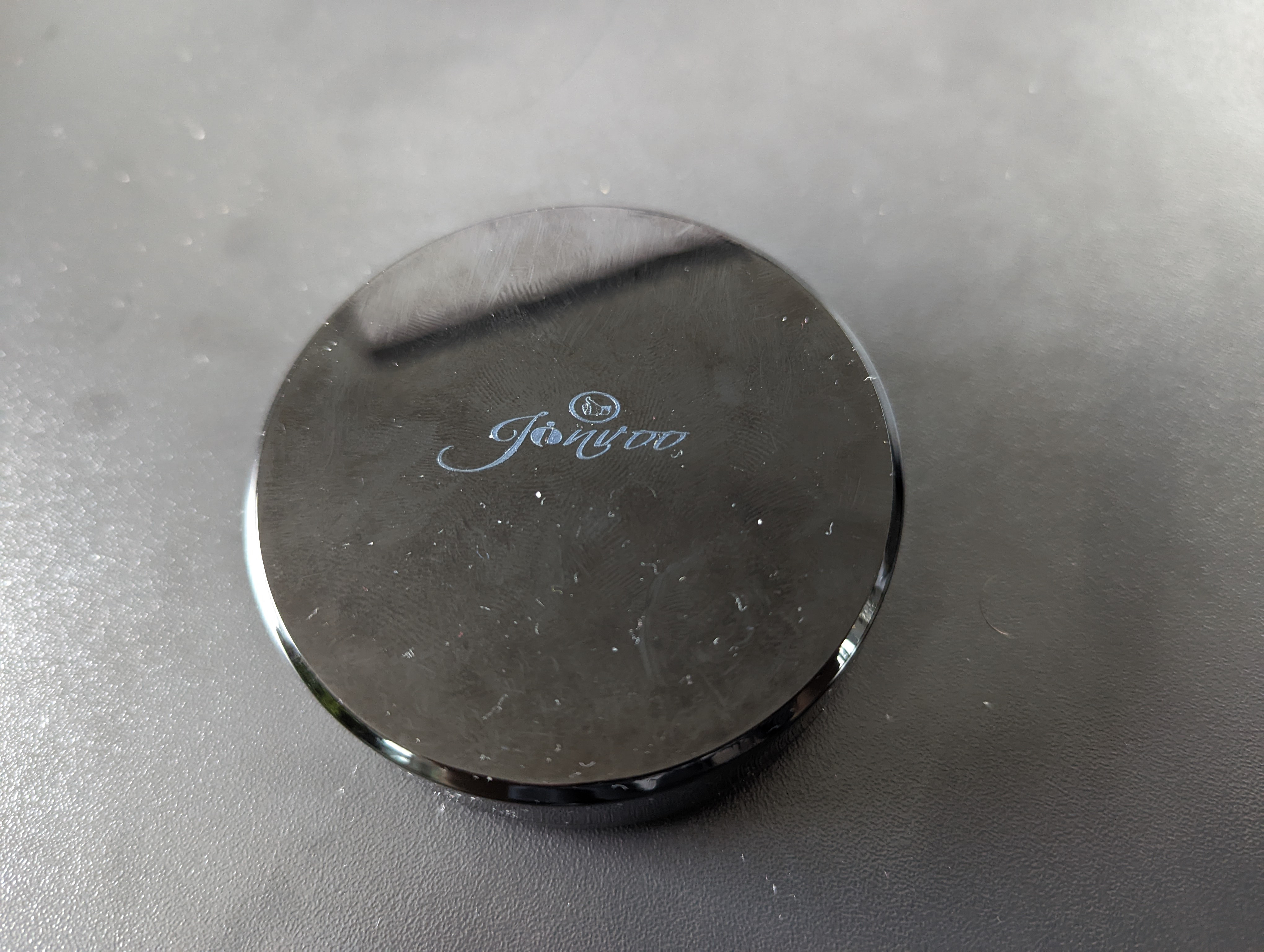

  • Jinvoo SM-AW502S AC/TV Box IR controller uses a BK7231N (CB3S) chip and is a successor to SM-AW502A.
  • Remove the rubber feet, open the case, and flash OpenBK7231N_QIO_X.Y.Z.bin through FTDI; short CB3S pin 1 to GND after uartprogram.
  • It cost 10€ from Amazon and exposes CB3S pins 1 (RESET), 8 (VCC), 9 (GND), 15 (RX), and 16 (TX) for flashing.
  • Configuring PINs, starting driver IR, and aiming a remote at the 'DIY' area reveals the IR protocol and code, and IRSend works via console or MQTT.
  • Multiple units do not seem to have unique MAC addresses, so unique names and MACs may need to be set manually.
Successor of https://templates.blakadder.com/jinvoo_SM-AW502A.html. Has a BK7231N (CB3S) chip that can be flashed. I bought it from Amazon for 10€ (https://www.amazon.de/dp/B07VYWN88F?tag=tasmotatempla-21)
Teardown
1. Remove the rubber feet on the bottom
2. Open the screws and open the case

Configuration
0. Disconnect the wires and plug in the device.
1. You'll see an OpenBK7231N_####### wifi network. Connect and configure the device to connect to your home network.
2. Find the device's IP in your home network. The devices don't seem to have a unique MAC address, if you have multiple, make sure to set unique names and MACs in the configuration.
3. Go to the web application and configure the PINs in the "Config" tab as follows:
PINType
6Btn
7IRRecv
8WifiLED
26IRSend
4. In the "Logs" tab, run the command startdriver IR
Now when you point a remote at the device where the "DIY" is written you should see the IR Protocol and code inside the logs. To send IR commands, you can run IRSend <PROTOCOL>-<ADDRESS>-<COMMAND>-<REPEAT>, e.g. IRSend RC5-0x0-0x54-1 inside the console or also via MQTT cmnd/<device>/IRSend with payload RC5-0x0-0x54-1.
