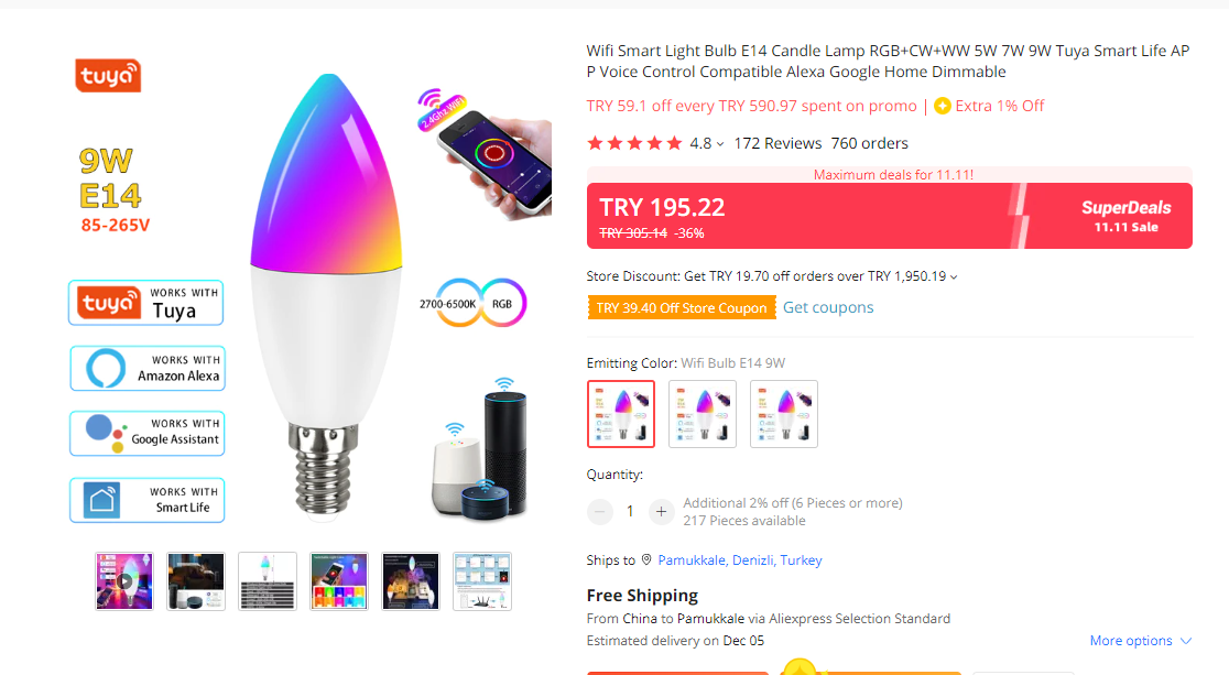

Cheap Aliexpress bulbs with apparently a unique board.
