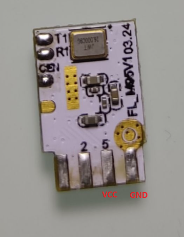

  • Tuya E14 RGB+CW+WW 9W Belon BL2028N bulb uses a BK7231N platform and a unique PCB layout.
  • RX and TX are exposed on the backside, enabling flashing with hid_download_py without desoldering anything.
  • The LED driver IC is BP1633, and the board is marked FL_M95_V1.
  • A backup was taken first, then OpenBK7231N_app_QIO_1.0.0.bin was flashed with uartprogram on com10 from start address 0x0.
  • Cheap Aliexpress bulbs with apparently a unique board.
    Tuya E14 Lamp RGB+CW+WW - 9w [Belon BL2028N] (BK7231N)
    RX and TX is exposed on the backside and I successfully flashed with this tool, https://github.com/OpenBekenIOT/hid_download_py. No need to desolder anything.
    I used this command: (first I took a backup)
    python uartprogram OpenBK7231N_app_QIO_1.0.0.bin --unprotect -d com10 -w --startaddr 0x0

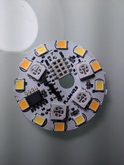

    LED IC is "BP1633"
    It's marked as FL_M95_V1.
    Tuya E14 Lamp RGB+CW+WW - 9w [Belon BL2028N] (BK7231N) Tuya E14 Lamp RGB+CW+WW - 9w [Belon BL2028N] (BK7231N)

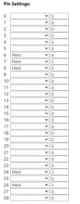

    Pin settings:

    Hey, can you specify which pins of FL_M95_V1 are VDD and GND? The remaining pads needed for programming are clearly visible on the photo (RX1, TX1, CSN/CEN)...
  • #3 20280352
    kaankasim88
    By VDD, do you mean VCC? I used these pins successfuly, but I didn't actually need to connect these for successful programming. It still flashed.
  • VDD likely on unmarked 3.3 V pad
    #4 20280383
    Posts: 14791
    Rate: 12937
    VDD is the same as VCC.
    I am not sure if 5 is really VDD. I'd guess that pads marked 0-5 are PWMs:
    5PWM5I/OGPIOP_26, which is connected to the P26 pin on the internal IC
    6PWM4I/OGPIOP_24, common GPIO, which is connected to the P24 pin on the internal IC
    7PWM0I/OGPIOP_6, which is connected to the P6 pin on the internal IC
    10PWM1I/OGPIOP_7, which is connected to the P7 pin on the internal IC
    13PWM3I/OGPIOP_9, common GPIO, which is connected to the P9 pin on the internal IC
    14PWM2I/OGPIOP_8, which is connected to the P8 pin on the internal IC
    Those signals are broken out on the pads. Futhermore, one pad is GND and one (not marked?) is VDD - 3.3V.
    I think flashing might have worked for you because pins have protection diodes to VDD and BK can run with a lower voltage that 3.3V (including diode drop) but you did not identify the VDD correctly. Still, good job, as it worked and obk flashed.
