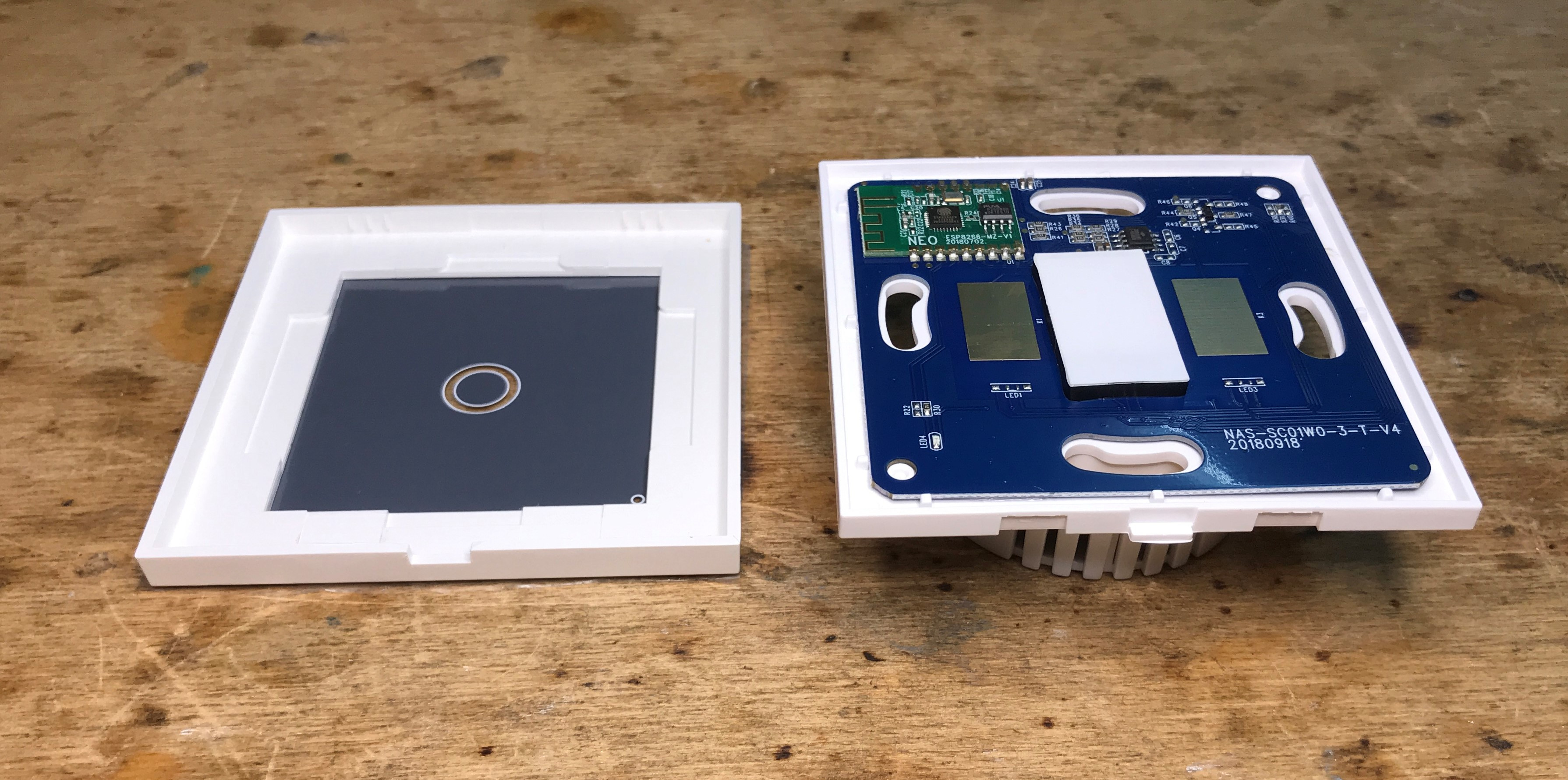

  • Teardown and pinout of NAS-SC01W-1/NAS-SC01W-2/NAS-SC01W-3 WiFi touch light switches based on ESP8266.
  • Shows the internal wiring, UART and IO0 access points, and which ESP8266 GPIOs handle buttons, relays, and the Wi‑Fi LED.
  • The single-gang unit uses an ESP8266-MZ-V1 dated 20180702, a BS813A touch controller, and the switches measure 86 mm x 86 mm x 34 mm.
  • UART lines are free and flashing needs only 3.3V, GND, TX, RX, and IO0, but the module lacks TYWE3S/ESP12E-compatible pins.
  • Tasmota can be uploaded, and SetOption13 1 may enable instant touch response instead of switching only after lifting a finger.

Interior NAS-.SC01W-1 We remove the cover and see the ESP8266-MZ-V1 dated 20180702. You can upload Tasmota, although I don't know what is in the same switches but produced after 2018 or, for example, in 2022....
Only now a note - this module has no leads compatible with TYWE3S, or there with ESP12F, ESP12E .
BS813A is a touch button controller, production of Holtek.
8cb911fbb
A few more photos:
Now most importantly - a connection spread for you. Both ESP pins and physically where the signals go. For programming, use 3.3V, GND and TX, RX and IO0 marked on the picture! All as, among others. here:
QTouch WiFi switch plugged into L-wire only - test, interior, schematic [tr] [/td]
Role [td] Pin ESP
Button 1 [td] MTDI/GPIO12 (10)
Button 2 GPIO5 (24)
Button 3 MTMS/GPIO14 (24)
Transmitter 1 MTCK/GPIO13 (12)
Transmitter 2 MTDO/GPIO15 (13)
Transmitter 3 GPIO4 (16)
LED WiFi XDP-.DCDC/GPIO16 (8)
Tasmot settings for the triple version (although I'm not sure, if I didn't swap the order of the relays):
A few more pics of the relay board:
From what I can see, the power supply here is on ASZCNB (decipher anyone?) in SOIC8, the relay turns on Y1, and the 3.3V is provided by S47B9BB.
Interesting fact: this is the first switch in which I've encountered a 3.3V regulator on the backplane, rather than the one on the front.

These switches are based on ESP8266, are simple to change the firmware, UART lines are not busy, nothing needs to be cut or soldered. If you are looking for something to upload Tasmota, you can consider buying them. I have given you the ESP leads, so anyone can now conveniently change the firmware. In the queue I still have to work out the dimmer of this series (to check whether it operates on TuyaMCU and what dpID have specific variables), but about that later.
For details about the programming of the module with ESP8266 I refer, among others. here:
QTouch WiFi switch plugged into L wire only - test, interior, schematic This has been discussed many, many times already. In this topic, I just wanted to provide information on what is inside these switches and which IOs are used. I hope this will be useful to someone, especially since the WiFi module present here does not have TYWE3S/ESP12E-compatible outputs.
PS: For Tasmota, it may be worth considering activating the instantaneous touch response via SetOption13 1 . Otherwise, the relay only switches its state when you "let go" of the touch. .[/td][/tr]
