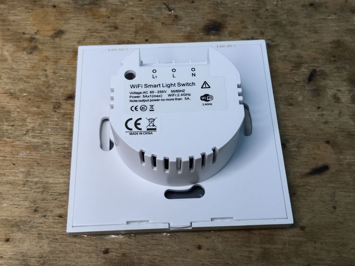

    The dimensions of the product are 86mm x 86mm x 34mm.

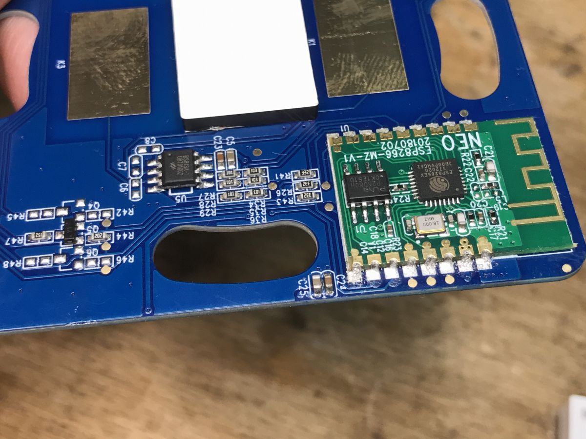

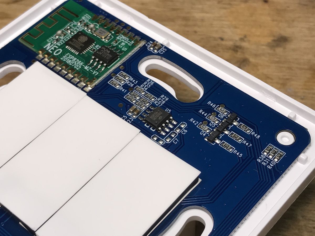

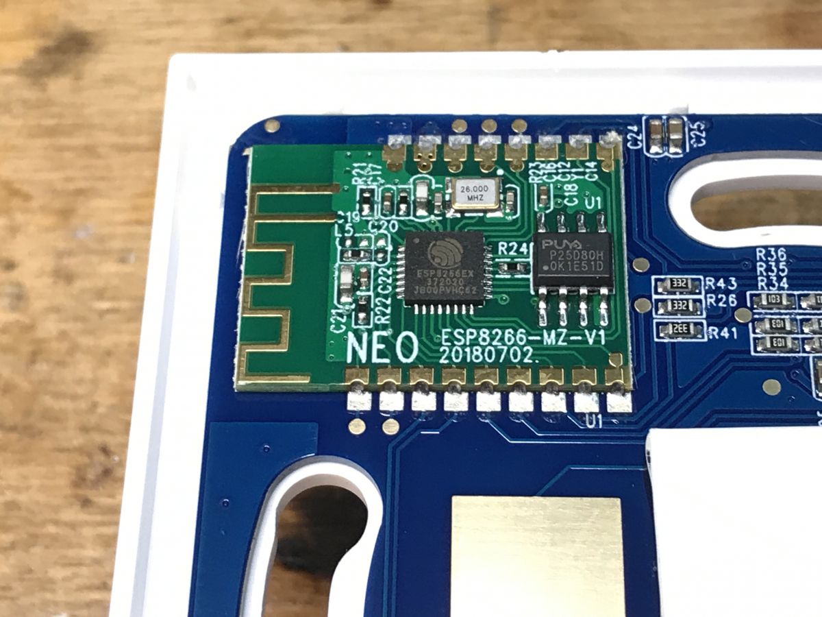

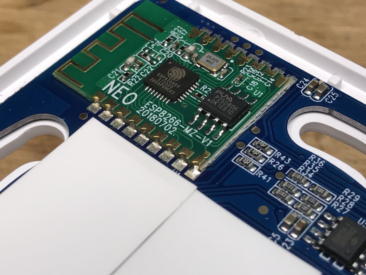

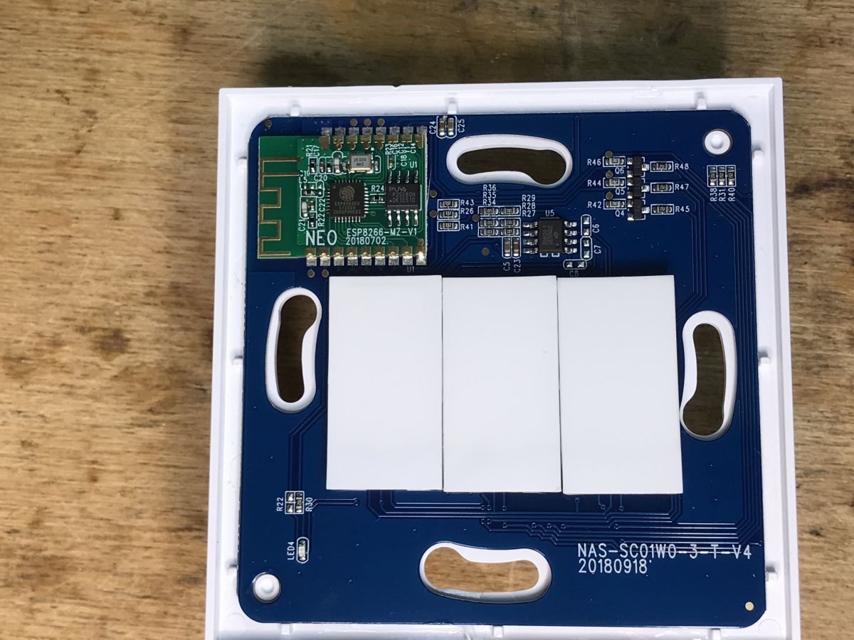

    WiFi light switches NAS-SC01W-1/NAS-SC01W-3 [ESP8266][Pinout]. WiFi light switches NAS-SC01W-1/NAS-SC01W-3 [ESP8266][Pinout]. Interior NAS-.SC01W-1 We remove the cover and see the ESP8266-MZ-V1 dated 20180702. You can upload Tasmota, although I don't know what is in the same switches but produced after 2018 or, for example, in 2022....

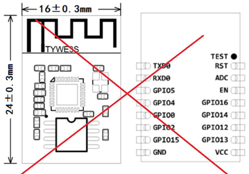

    WiFi light switches NAS-SC01W-1/NAS-SC01W-3 [ESP8266][Pinout]. WiFi light switches NAS-SC01W-1/NAS-SC01W-3 [ESP8266][Pinout]. Only now a note - this module has no leads compatible with TYWE3S, or there with ESP12F, ESP12E .

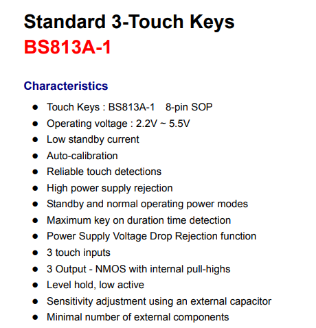

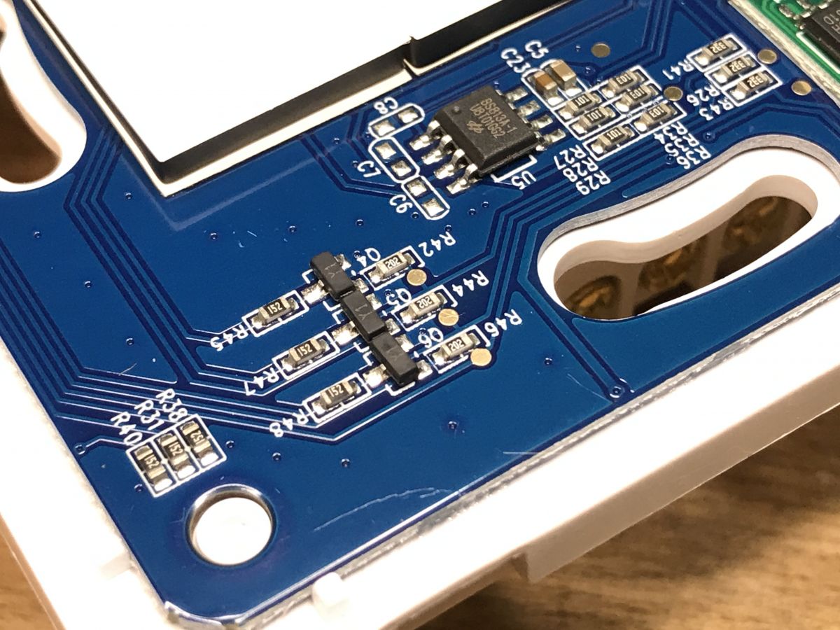

    WiFi light switches NAS-SC01W-1/NAS-SC01W-3 [ESP8266][Pinout]. WiFi light switches NAS-SC01W-1/NAS-SC01W-3 [ESP8266][Pinout]. BS813A is a touch button controller, production of Holtek.

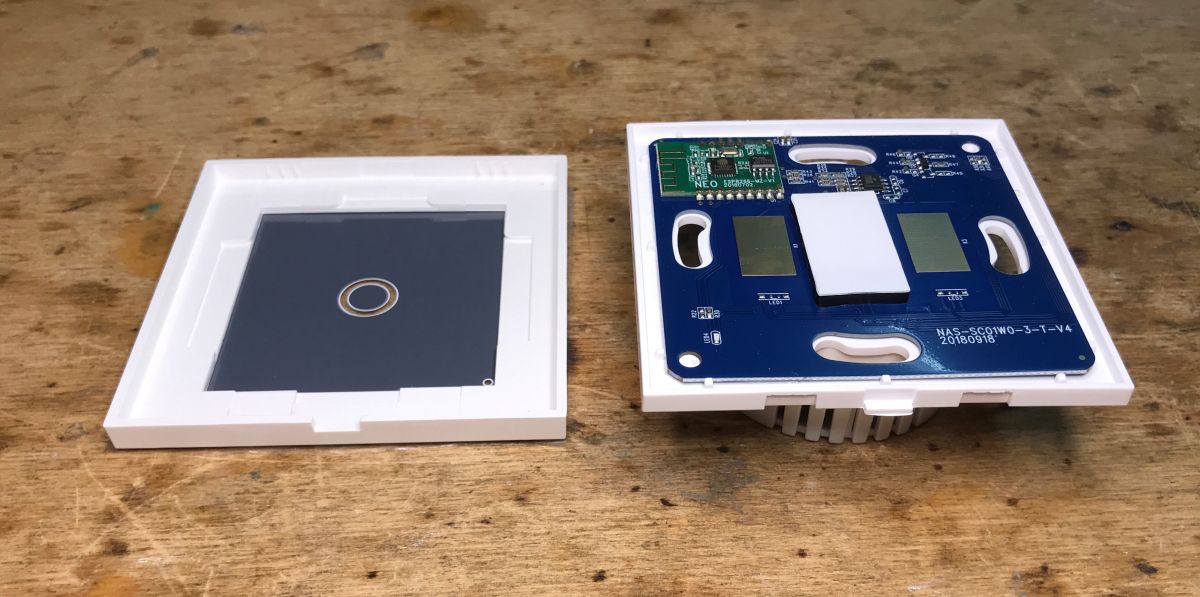

    A few more photos:

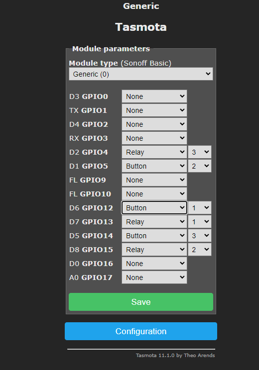

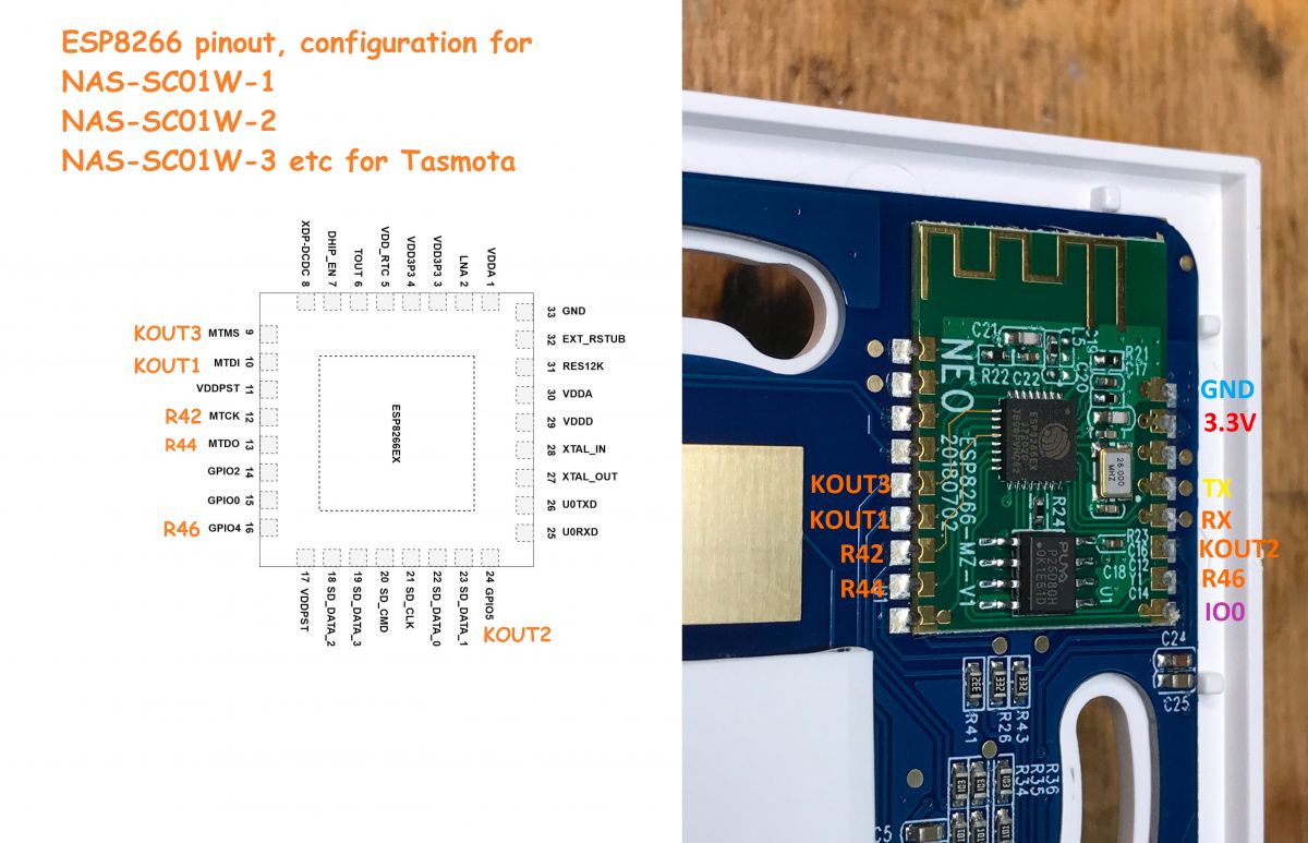

    Now most importantly - a connection spread for you. Both ESP pins and physically where the signals go. WiFi light switches NAS-SC01W-1/NAS-SC01W-3 [ESP8266][Pinout]. For programming, use 3.3V, GND and TX, RX and IO0 marked on the picture! All as, among others. here:
    QTouch WiFi switch plugged into L-wire only - test, interior, schematic [tr] [/td]
    Role [td] Pin ESP
    Button 1 [td] MTDI/GPIO12 (10)
    Button 2 GPIO5 (24)
    Button 3 MTMS/GPIO14 (24)
    Transmitter 1 MTCK/GPIO13 (12)
    Transmitter 2 MTDO/GPIO15 (13)
    Transmitter 3 GPIO4 (16)
    LED WiFi XDP-.DCDC/GPIO16 (8)
    Tasmot settings for the triple version (although I'm not sure, if I didn't swap the order of the relays):

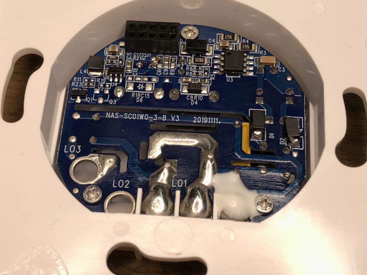

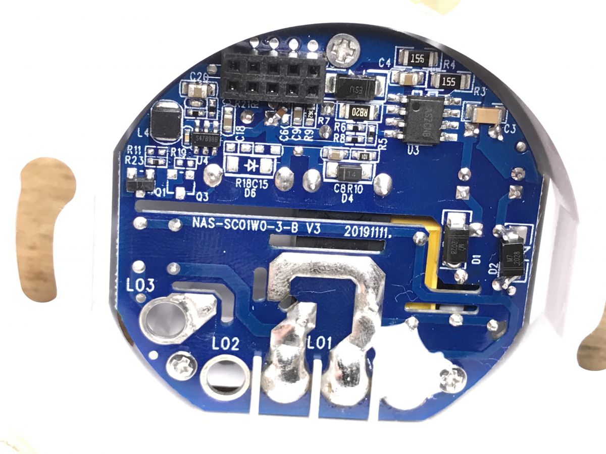

    A few more pics of the relay board:
    WiFi light switches NAS-SC01W-1/NAS-SC01W-3 [ESP8266][Pinout]. WiFi light switches NAS-SC01W-1/NAS-SC01W-3 [ESP8266][Pinout]. WiFi light switches NAS-SC01W-1/NAS-SC01W-3 [ESP8266][Pinout]. From what I can see, the power supply here is on ASZCNB (decipher anyone?) in SOIC8, the relay turns on Y1, and the 3.3V is provided by S47B9BB.
    Interesting fact: this is the first switch in which I've encountered a 3.3V regulator on the backplane, rather than the one on the front.

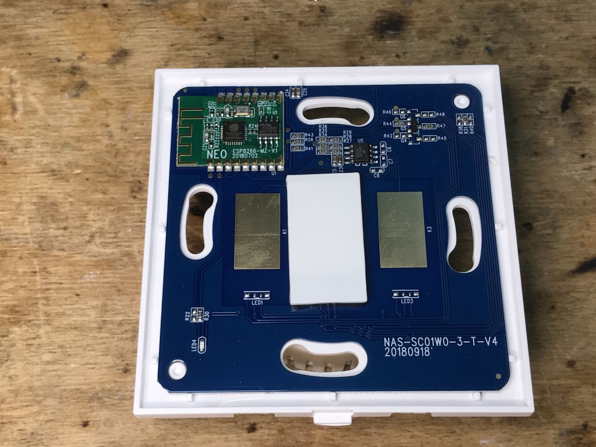

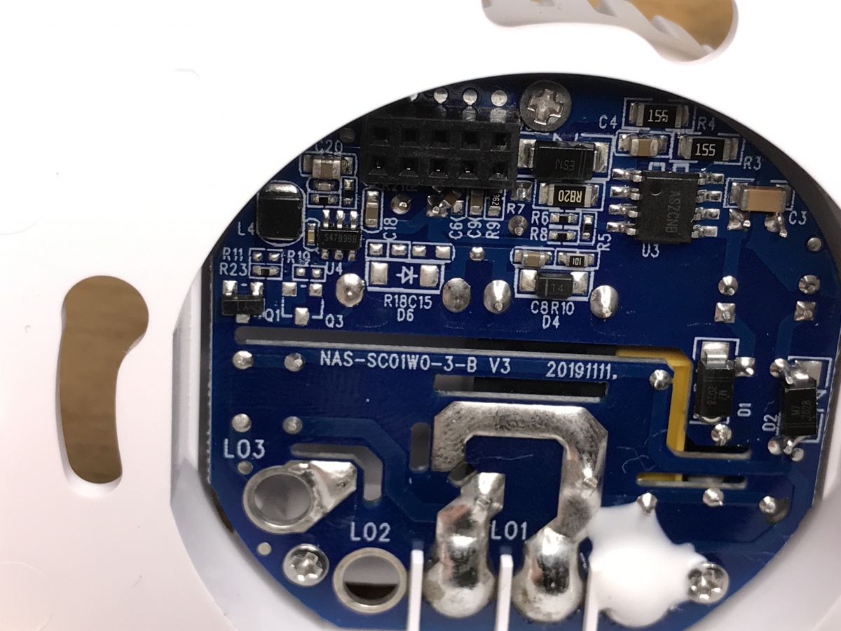

    Interior NAS-.SC01W-3 The interior of the three-relay version looks similar. No unnecessary commentary:
    WiFi light switches NAS-SC01W-1/NAS-SC01W-3 [ESP8266][Pinout]. WiFi light switches NAS-SC01W-1/NAS-SC01W-3 [ESP8266][Pinout]. WiFi light switches NAS-SC01W-1/NAS-SC01W-3 [ESP8266][Pinout]. WiFi light switches NAS-SC01W-1/NAS-SC01W-3 [ESP8266][Pinout].

    QTouch WiFi switch plugged into L wire only - test, interior, schematic This has been discussed many, many times already. In this topic, I just wanted to provide information on what is inside these switches and which IOs are used. I hope this will be useful to someone, especially since the WiFi module present here does not have TYWE3S/ESP12E-compatible outputs.
