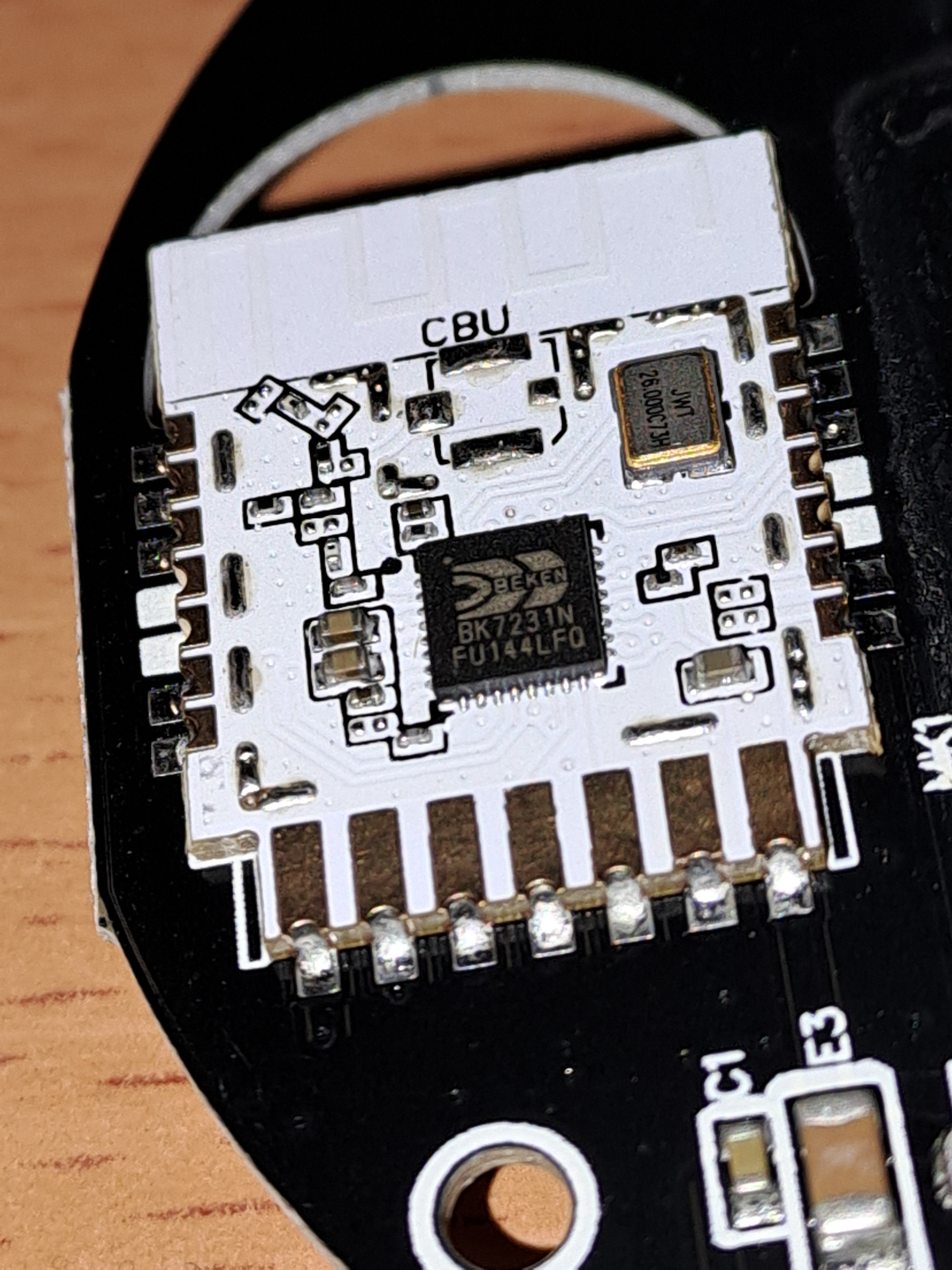

  • Aubess WiFi Smart IR Controller gets opened, documented, and flashed for custom use.
  • hid_download_py flashes it over UART testpoints after shorting PIN 18 (CEN) to GND.
  • The board uses PIN 7 for IRSend, PIN 8 for IRRecv, and PIN 24 for LED_n.
  • It sends and receives IR codes, including NEC 0xE384 0x24 0, and integrates with Home Assistant over MQTT.
Disassembly and box pictures:
I bought it on AliExpress
Datasheet
Flashing:
I flashed with the hid_download_py tool (uartprogram, same as described HERE ), using the UART testpoints located on the board. PIN 18 (CEN) needed to be shorted to GND to reset.
I was then able to use the device with this pin configuration:
PINPIN Setting
7IRSend
8IRRecv
24LED_n
I was also able to send and receive IR codes:
 IRSEND NEC 0xE384 0x24 0
And was able to add to Home-Assistant via MQTT with this yaml config:

Thanks! Just ordered this a few days ago, I was expecting they'd be using WB3S but I guess they've replaced it with CBU now [Read more]
