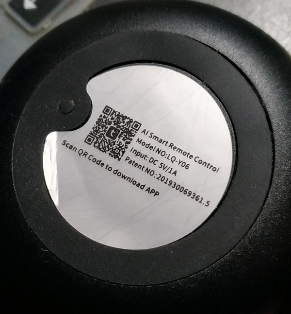

  • Aubess WiFi Smart IR Controller gets opened, documented, and flashed for custom use.
  • hid_download_py flashes it over UART testpoints after shorting PIN 18 (CEN) to GND.
  • The board uses PIN 7 for IRSend, PIN 8 for IRRecv, and PIN 24 for LED_n.
  • It sends and receives IR codes, including NEC 0xE384 0x24 0, and integrates with Home Assistant over MQTT.

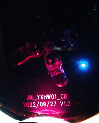

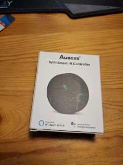

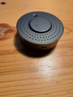

  • Disassembly and box pictures:
    Aubess WiFi Smart IR Controller Aubess WiFi Smart IR Controller Aubess WiFi Smart IR Controller Aubess WiFi Smart IR Controller Aubess WiFi Smart IR Controller Aubess WiFi Smart IR Controller Aubess WiFi Smart IR Controller
    I bought it on AliExpress
    Datasheet

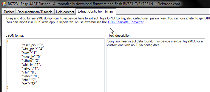

    Flashing:
    I flashed with the hid_download_py tool (uartprogram, same as described HERE ), using the UART testpoints located on the board. PIN 18 (CEN) needed to be shorted to GND to reset.

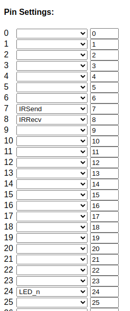

    I was then able to use the device with this pin configuration:
    PINPIN Setting
    7IRSend
    8IRRecv
    24LED_n

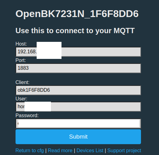

    I first configured MQTT on the device:
    and mosquitto on HA side.
    After that I opened the webapp on the device and configured the pins like this:

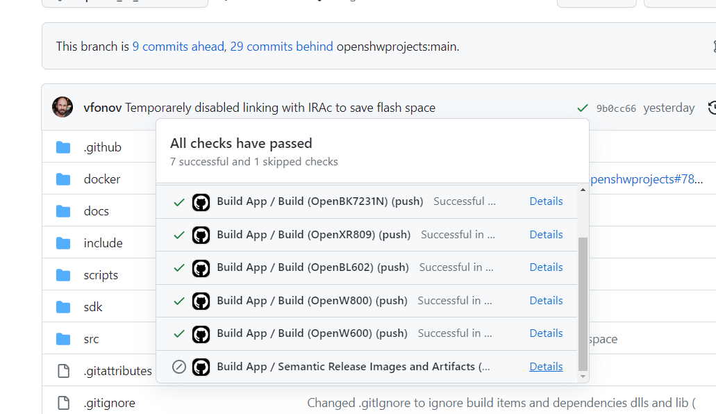

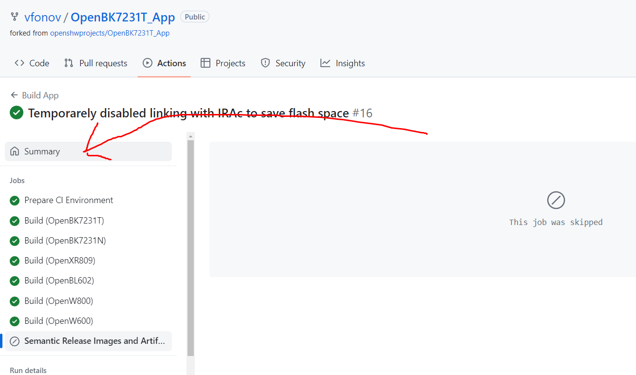

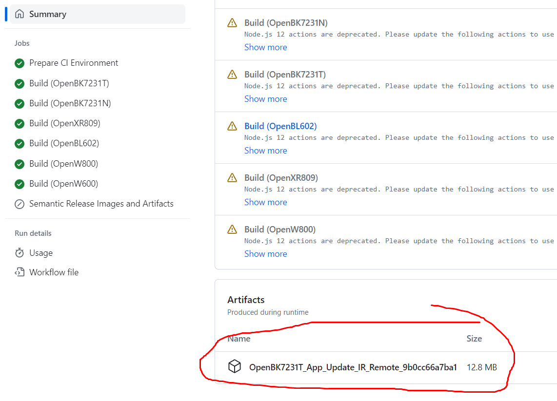

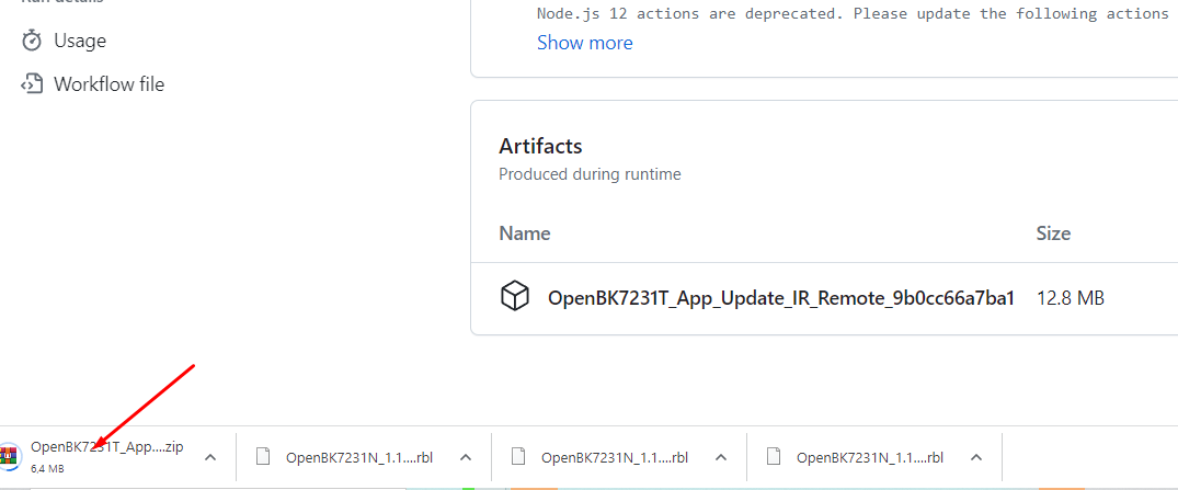

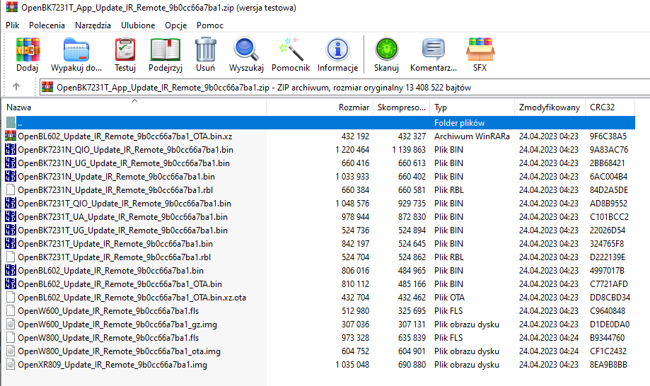

    The new testing build with IR can be found here, now for both T and N:
    https://github.com/openshwprojects/OpenBK7231T_App/pull/723
    but download at your own risk!
  • #26 20554953
    Posts: 14805
    Rate: 12972
    Hello:

    I bought the following device from Aliexpress:
    https://vi.aliexpress.com/item/1005005504887897.html
    The device says model LQ-Y06:
    Managed to get a picture of the PCB model by holding a light through the black plastic:

    Tried to decode the configuration using GUI Flash Tool but received the following response:
    However, as you can see, there is some info about pins but the tool cannot decode them.
    	"reset_pin":"9",
    	"wfst_pin":"24",
    	"owm":"1",
    	"reset_lv":"0",
    	"rsthold":"3",
    	"wfst_lv":"1",
    	"netyc":"1",
    	"infrr":"8",
    	"netnc":"0",
    	"infre":"7",
    	"crc":"72"
    So I made the guess that:
    infrr 8 -> Receive 8
    infre 7 -> Emit 7
    and went on to configure with
    PIN PIN Setting
    7 IRSend
    8 IRRecv
    24 LED_n
