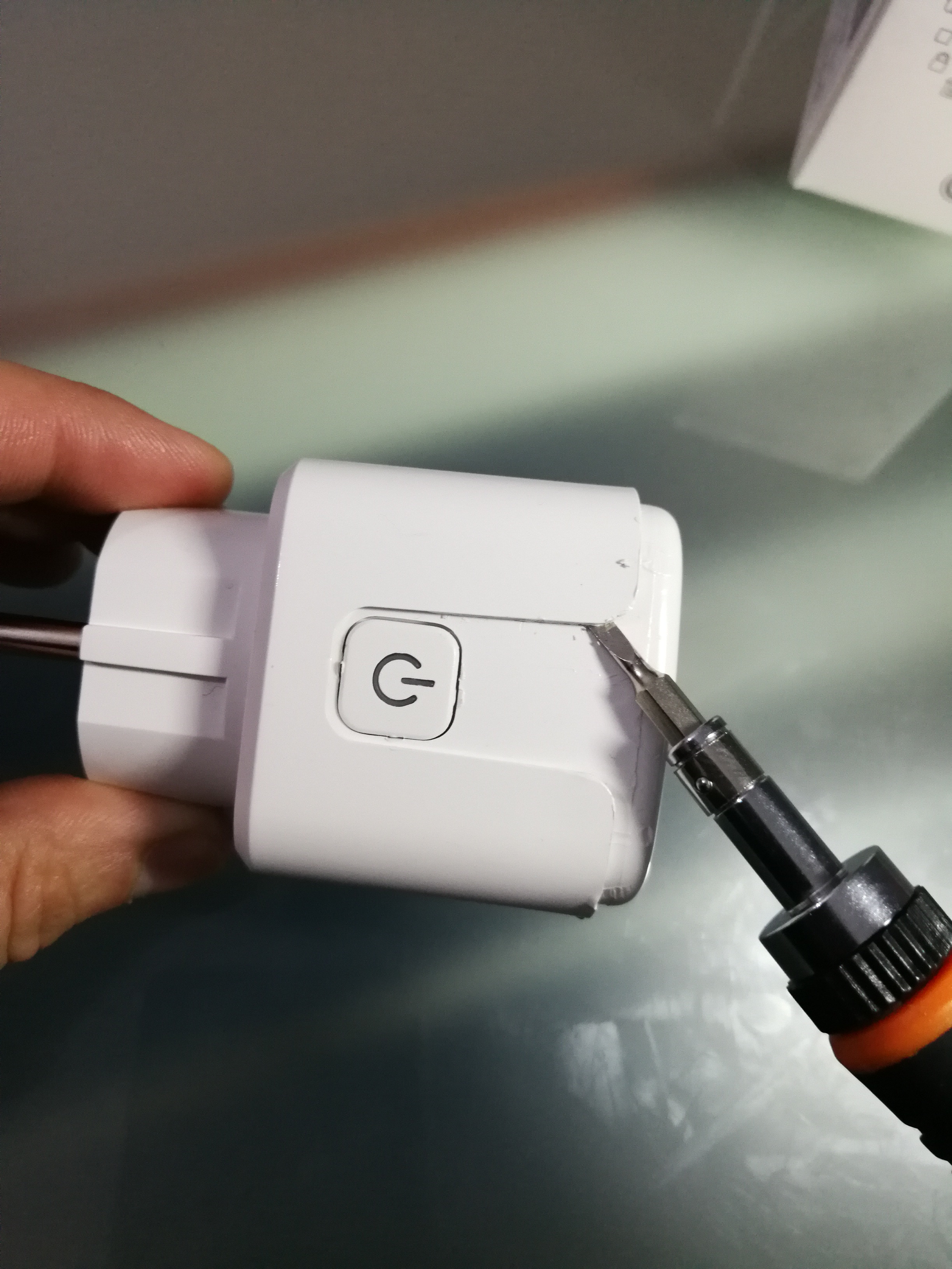

Hello friends,
I know very little about programming and linux but I have some skills with soldering components but I decided to build a smart house that works locally without internet access, so I started researching and ordered the first product: Smart Plug GIRIER 16A JR- PM01 16A Energy Monitoring.
I was going to put the Tasmota firmware because it was the only one I knew but the equipment came with the CB2S / BK7231N chip and I had to research better until I reached this magnificent project.
As I'm a beginner I'll try to explain what I managed to do in a beginner's language, I apologize to the experienced ones.
I bought this smart plug on aliexpress from this seller: Link
It was the first one I opened and it was difficult to open because it seems that in addition to the fitting it is closed with some glue.

Thank you for your report, it turned out great, even with the use of translator. Translators are very good these days. By the way, have you looked into using more advanced stats of power consumption? ... [Read more]
