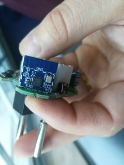

    Hello friends,
    I know very little about programming and linux but I have some skills with soldering components but I decided to build a smart house that works locally without internet access, so I started researching and ordered the first product: Smart Plug GIRIER 16A JR- PM01 16A Energy Monitoring.
    I was going to put the Tasmota firmware because it was the only one I knew but the equipment came with the CB2S / BK7231N chip and I had to research better until I reached this magnificent project.
    As I'm a beginner I'll try to explain what I managed to do in a beginner's language, I apologize to the experienced ones.
    I bought this smart plug on aliexpress from this seller: Link

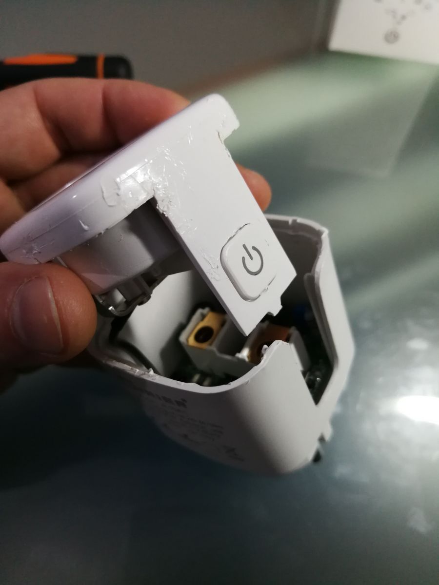

    It was the first one I opened and it was difficult to open because it seems that in addition to the fitting it is closed with some glue.

    I powered it directly from the computer's USB port using the programmer, I connected +5v and GND from the programmer's USB port to the Smart Plug at the points labeled +5V and GND as in the pictures.
    The red +5v power wire should be able to connect and disconnect easily, I recommend using an ON/OFF switch
    (I used an alligator clip as shown in the photo) because it will be necessary during the procedure to cut the power supply and reconnect.
    I connected it with the white and green wires
    TX from programmer to RX from chip (White wire)
    RX from programmer to TX from chip ( Green wire)
    ( the yellow wire that appears in the photo was not used in this case )

    If it went well, you can unsolder and disconnect the wires from the board.
    Mount the smart plug and connect it to the electrical plug, a wifi network similar to the SSID OpenBK7231xxxxxx will appear, connect to that network and open the configuration by pointing the browser to 192.168.4.1

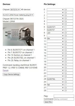

    When I select the equipment from the compatible list included in the "ELIVCO LSPA9 Power Metering Plug" firmware, it should have done this configuration automatically.
    Smart Plug GIRIER JR-PM01 16A Energy Monitoring CB2S / BK7231N
    The values for voltage, amperage and consumption appear without any further configuration needed, but the values are a little out of line with the actual values. it is not calibrated to 100% but it is very close to the real one.
    I don't know how to calibrate the BL0937

    Hello I have tuya plug like in the first post.
    My config:
    "vendor": "Tuya",
    "bDetailed": "0",
    "model": "enter short model name here",
    "chip": "BK7231N",
    "board": "TODO",
    "flags": "1024",
    "keywords": [
    "TODO",
    "TODO",
    "TODO"
    "pins": {
    "6": "BL0937CF1;0",
    "7": "BL0937CF;0",
    "8": "Rel;0",
    "10": "WifiLED;1",
    "11": "BL0937SEL;0"
    "command": "",
    But hard button doesn't work. I tried pin 10 with channel 0 and 1 and no result.
    What pins should I try?
  • #11 20561509
    Posts: 14770
    Rate: 12913
    If Relay is on channel 0, then you should set button on channel 0.
    The only question is - which GPIO is the button?
    You can try guessing, checking one by one, or maybe check some other templates. Also, do you have 2MB flash backup?

  • Easy Flasher omits P24 from extracted config
    #14 21015696
    Posts: 5220
    Help: 449
    Rate: 918
    cool. for some reason the Easy Flasher omits P24 in extracting config, so that's missing from your template. The pin assignments of 6, 7, 8, 10, 24 & 26 are seen in quite a number of these smart plugs under various brands/models/chassis.
    eg
    https://www.elektroda.com/rtvforum/topic4044107.html#21014244
    https://www.elektroda.com/rtvforum/topic4043082.html
    https://www.elektroda.com/rtvforum/topic3945009.html#20693371
  • #15 21016077
    Raufaser
    Posts: 47
    Rate: 16
    I noticed that, but the button is working anyways. What is the advantage of programming the button?
