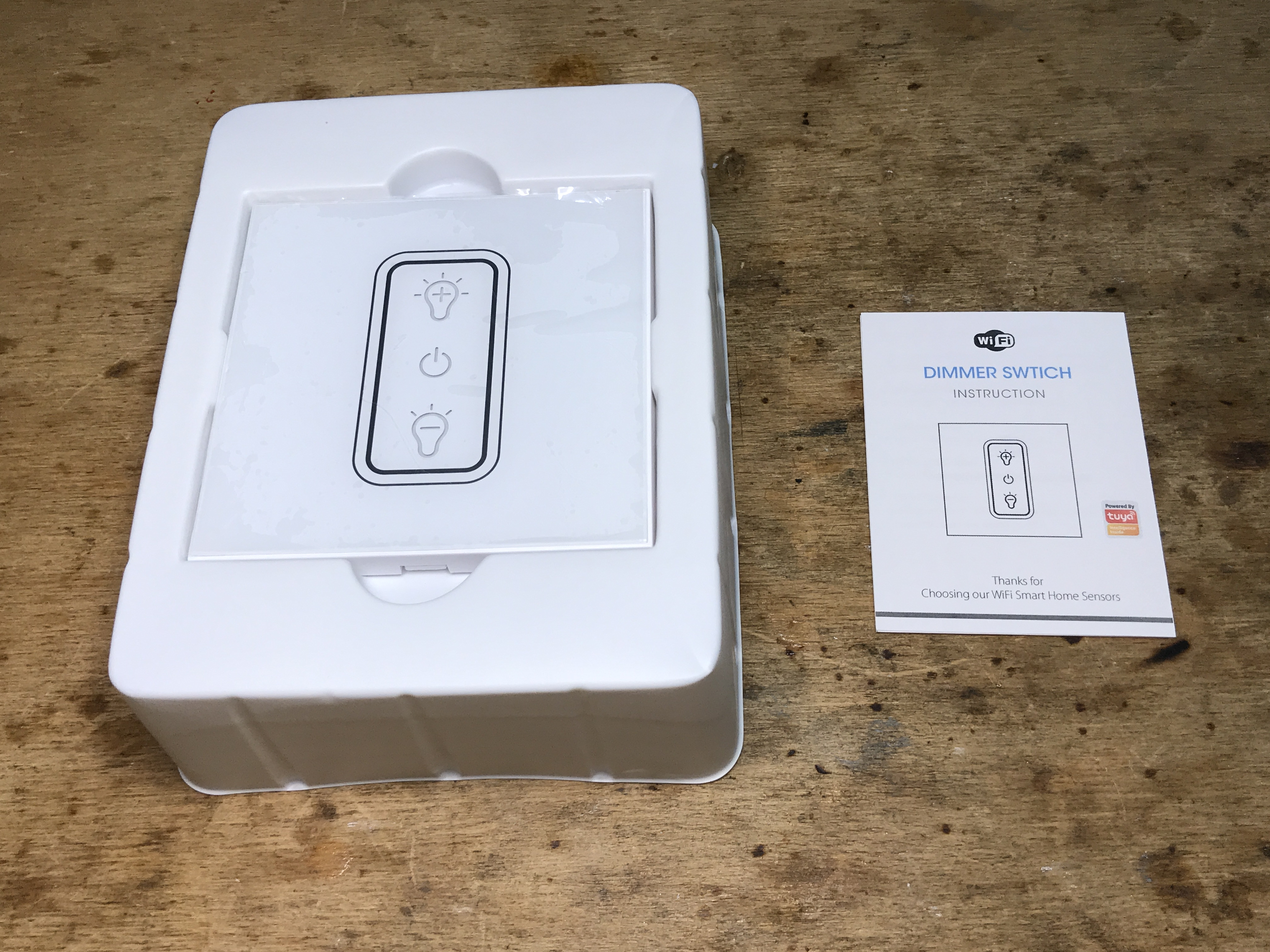

Some time ago I discussed WiFi light switches NAS-SC01W-1/NAS-SC01W-3 , I showed how to change their firmware and specified the pinouts of their non-standard WiFi module (ESP8266-MZ-V1). Now it's time for a dimmer from the same series. Here I will also provide the necessary information for those who want to change the batch for it. This time briefly, the specifics themselves, as a similar situation has already been discussed in the forum.
Dimmer NAS-.DM01W
This product can also be purchased on Polish mail order services. It costs about PLN 100 (25$), but thanks to shipping from our country we can receive it literally in 2 days.
Let's see for a start what is included in the kit:
It seems there is only manual attached, they didn't even give the screws! Anyway, let's look inside:
