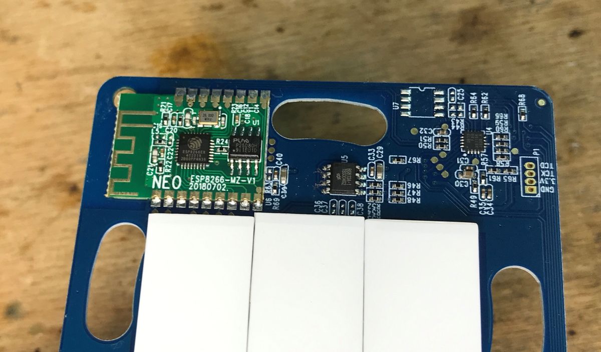

    Some time ago I discussed WiFi light switches NAS-SC01W-1/NAS-SC01W-3 , I showed how to change their firmware and specified the pinouts of their non-standard WiFi module (ESP8266-MZ-V1). Now it's time for a dimmer from the same series. Here I will also provide the necessary information for those who want to change the batch for it. This time briefly, the specifics themselves, as a similar situation has already been discussed in the forum.

    It seems there is only manual attached, they didn't even give the screws! Anyway, let's look inside:
    [ESP8266] WiFi Neo light dimmer NAS-DM01W with TuyaMCU [ESP8266] WiFi Neo light dimmer NAS-DM01W with TuyaMCU [ESP8266] WiFi Neo light dimmer NAS-DM01W with TuyaMCU [ESP8266] WiFi Neo light dimmer NAS-DM01W with TuyaMCU [ESP8266] WiFi Neo light dimmer NAS-DM01W with TuyaMCU
    Here we have:
    - WiFi module ESP8266-MZ-V1 Neo
    - touch button controller BS813A-1
    - microcontroller (in the role of TuyaMCU) SB10 F8G A0TISK 1938
    - PCB designation: NAS-DM01W0-T-V4 20190530
    The microcontroller from TuyaMCU connects to ESP8266 via UART. It will not be possible to upload firmware without cutting the paths or putting TuyaMCU in RESET state.
    Here you can also deal differently with cutting TuyaMCU from WiFi module for programming time - you can solder R50 and R51 - see PCB photos. [ESP8266] WiFi Neo light dimmer NAS-DM01W with TuyaMCU The ESP8266-MZ-V1 leads are not compatible with TYWE3S/ESP12F, see this topic for details:

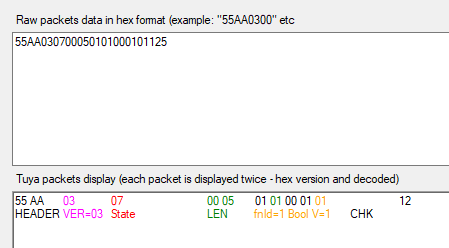

    TuyaMCU communication with WiFi module
    The TuyaMCU transmits variables to itself with the WiFi module via the UART, using a special protocol for this:
    https://developer.tuya.com/en/docs/iot/tuya-c...-serial-port-access-protocol?id=K9hhi0xxtn9cb
    TuyaMCU variables are identified by their ID, and in order to add support for this switch to Tasmota we need to know what is available under which ID:
    https://tasmota.github.io/docs/TuyaMCU/
    Specially for you, I collected the communication of this switch with TuyaMCU (I just "tapped" with the UART adapter first the RX-TX line, looking from the WiFi modules, and then TX-RX) and decoded it with a tool specially written for this (but about that another time).
    Here are the results:
    There are two important variables:
    - Bool type, ID 1 - status of the On/Off switch
    - Value type, ID 2 - brightness level (range from 0 to 1000)
    I still detected variables with IDs 3 and 4, but I didn't detect how they could be used.
    The ID of this device is {"p": "pkf6ggaaofgot9bk", "v": "1.0.0", "m":0}
    Some sample packets overheard from TuyaMCU
    Here's some information for the curious or for those wanting to e.g. program the ESP to control the dimmer yourself.
    Package that sets the state of the switch to ON:
    55AA030700050101000101125
