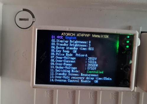

Hi All,
I have started on getting OpenBK ready for this device ,
https://pt.aliexpress.com/item/1005004407477380.html?gatewayAdapt=glo2bra
It is a 100A wifi (disabled BT) energy monitor.
Internals pictures as follows
i total of 3 units each Identical on the outside, purchased as the same model and 2 of the 3 software wise have less features but higher software version.
Software AT4PWP V1.04 will show Power Factor, Voltage, history, current (A) ,load (W) , energy used kw/h , frequency, bill and cpu temp on client app and main screen.
Software AT 4PBW V1.05 will show Voltage, Load (W) and current with on/off history on client app but displayss all the above and humidity ? on the lcd. it also has exact same pcb and markings.
Screenshot...t Life.jpg (186.36 kB)You must be logged in to download this attachment. AT4PBW
Screenshot...t Life.jpg (241.85 kB)You must be logged in to download this attachment. AT4PWP

pinouts of the ch573
PB15 -> pin 3 of JP3
PB14 -> Pin 2 of JP3 -> Button 1
PB13 -> CB3S RXD1
PB12 -> CB3S TXD1
PB11 -> pin 4 of JP2 -> bt led
PB10 - > pin 3 of JP2 -> Button 3
PB7 -> bl0942 adc/energy monitor RX
PB4 -> bl0942 adc/energy monitor TX
PB23 -> bt uart tx Ac6328 (zh-jieli.com) -> pin 2  of JP4 (not fitted)
PB22 -> bt uart rx AC6328 -> pin 4 of JP4 (not fitted)
PA4 -> Button 2
PA9 -> Relay control
