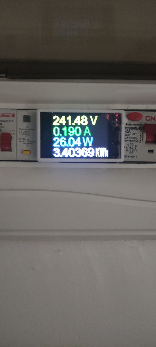

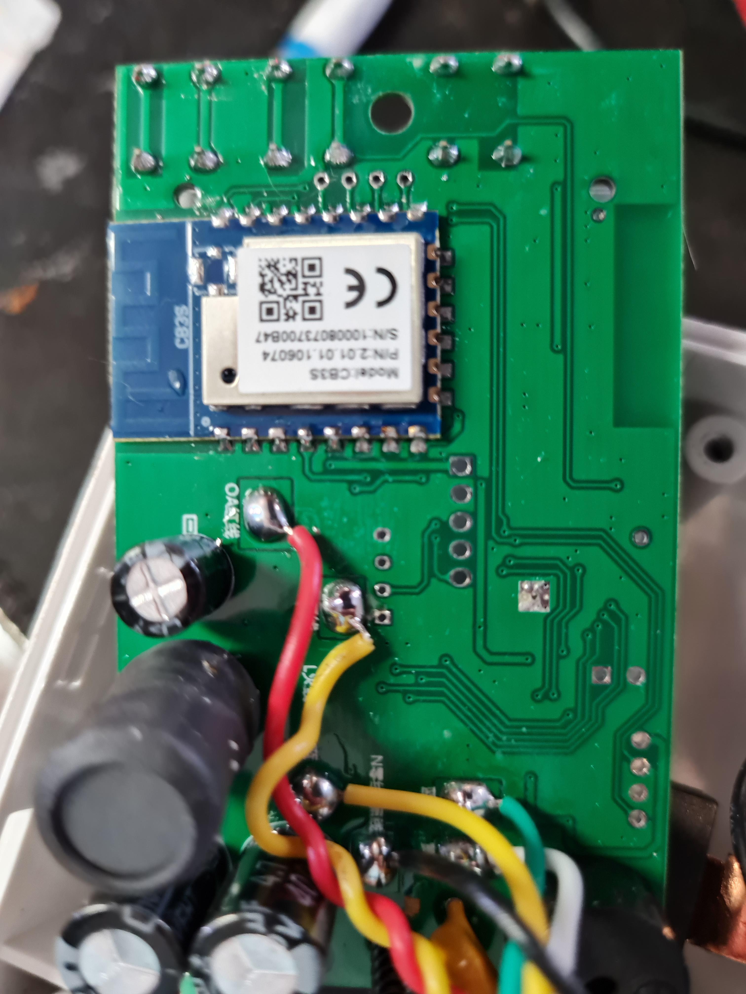

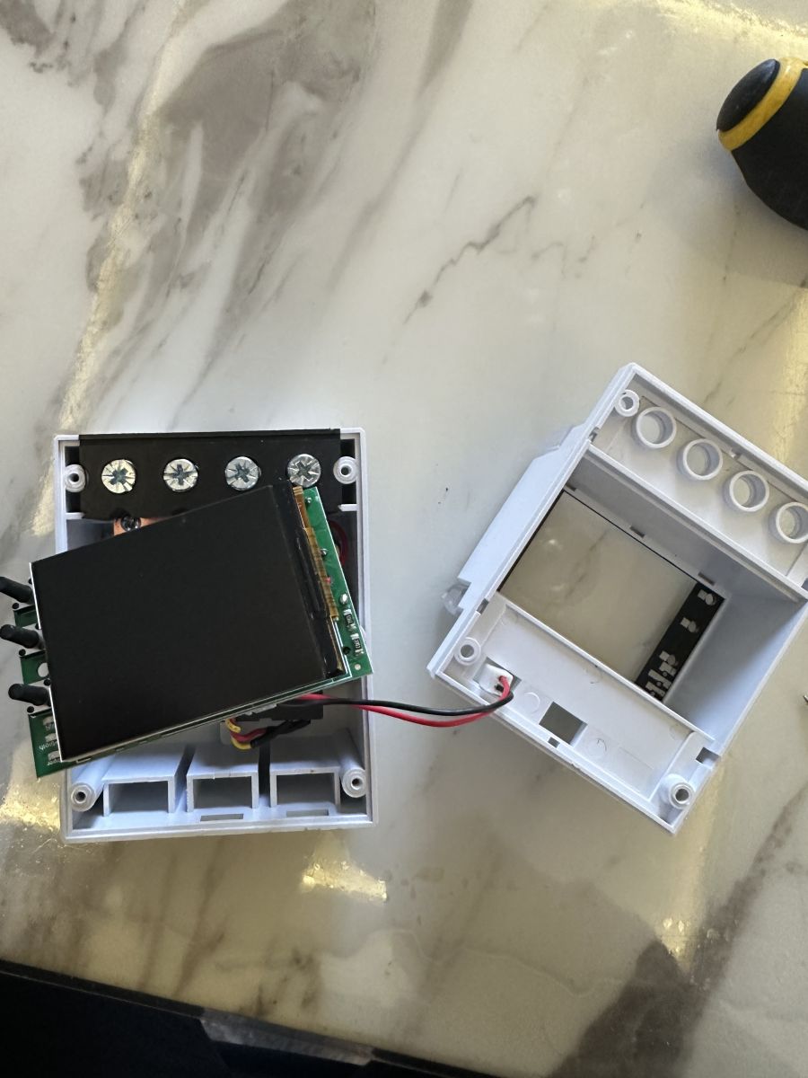

    Hi All,

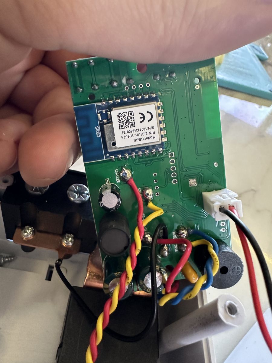

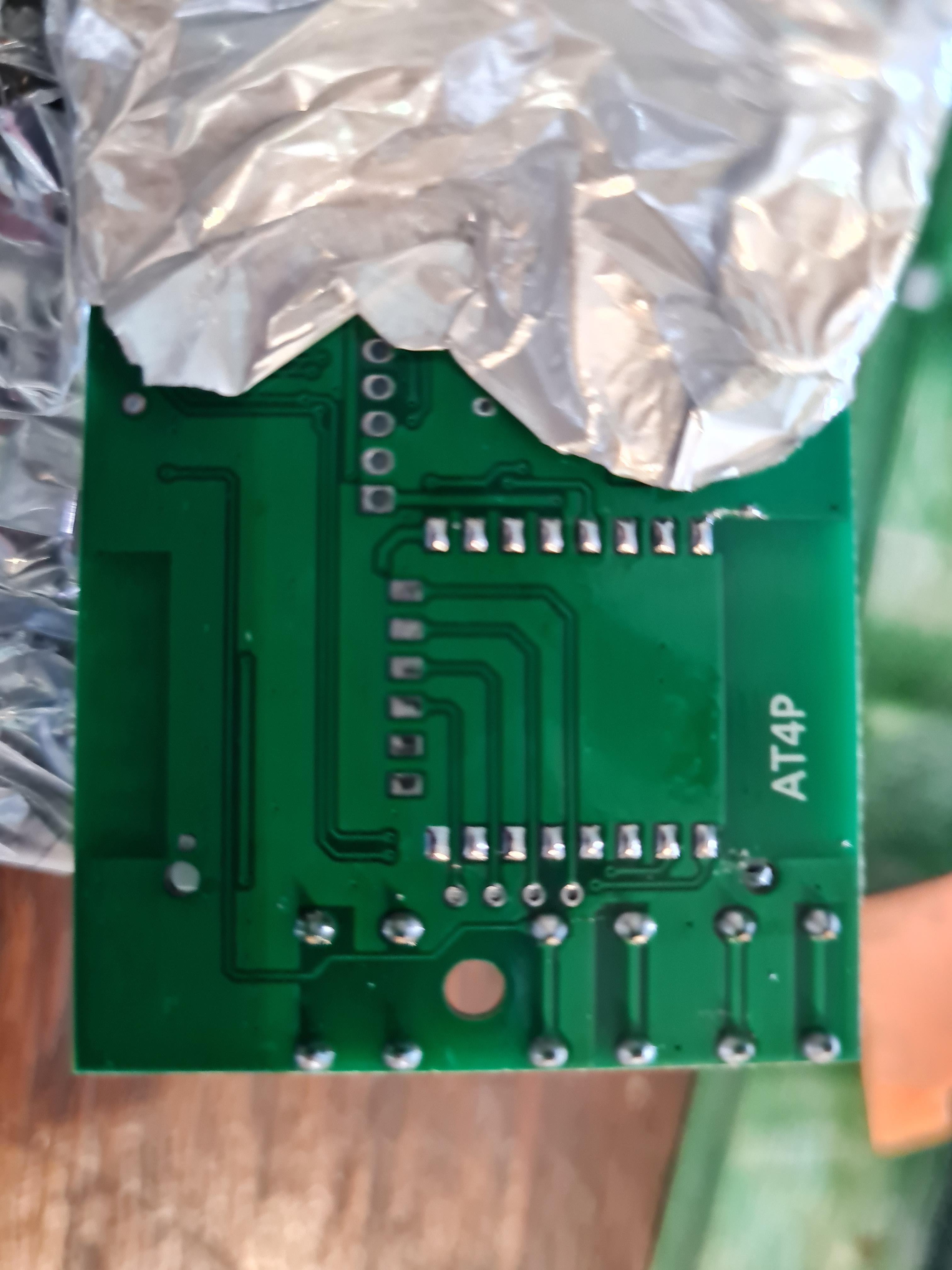

    I have started on getting OpenBK ready for this device ,
    https://pt.aliexpress.com/item/1005004407477380.html?gatewayAdapt=glo2bra
    It is a 100A wifi (disabled BT) energy monitor.

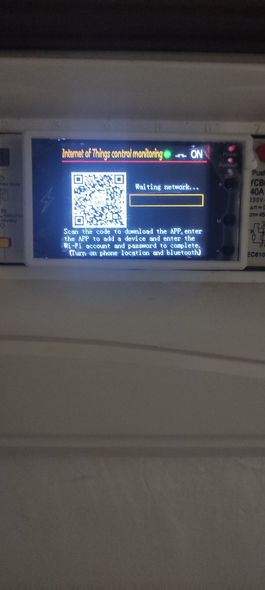

    Internals pictures as follows

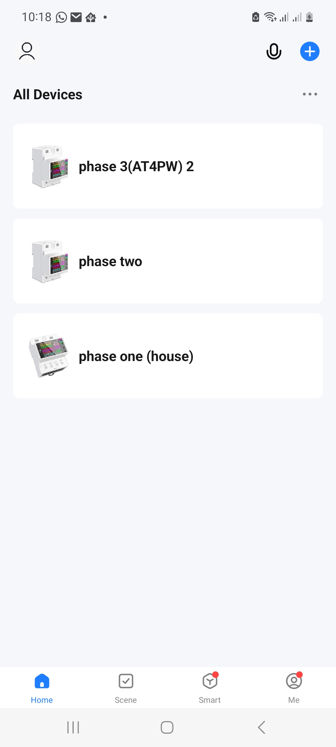

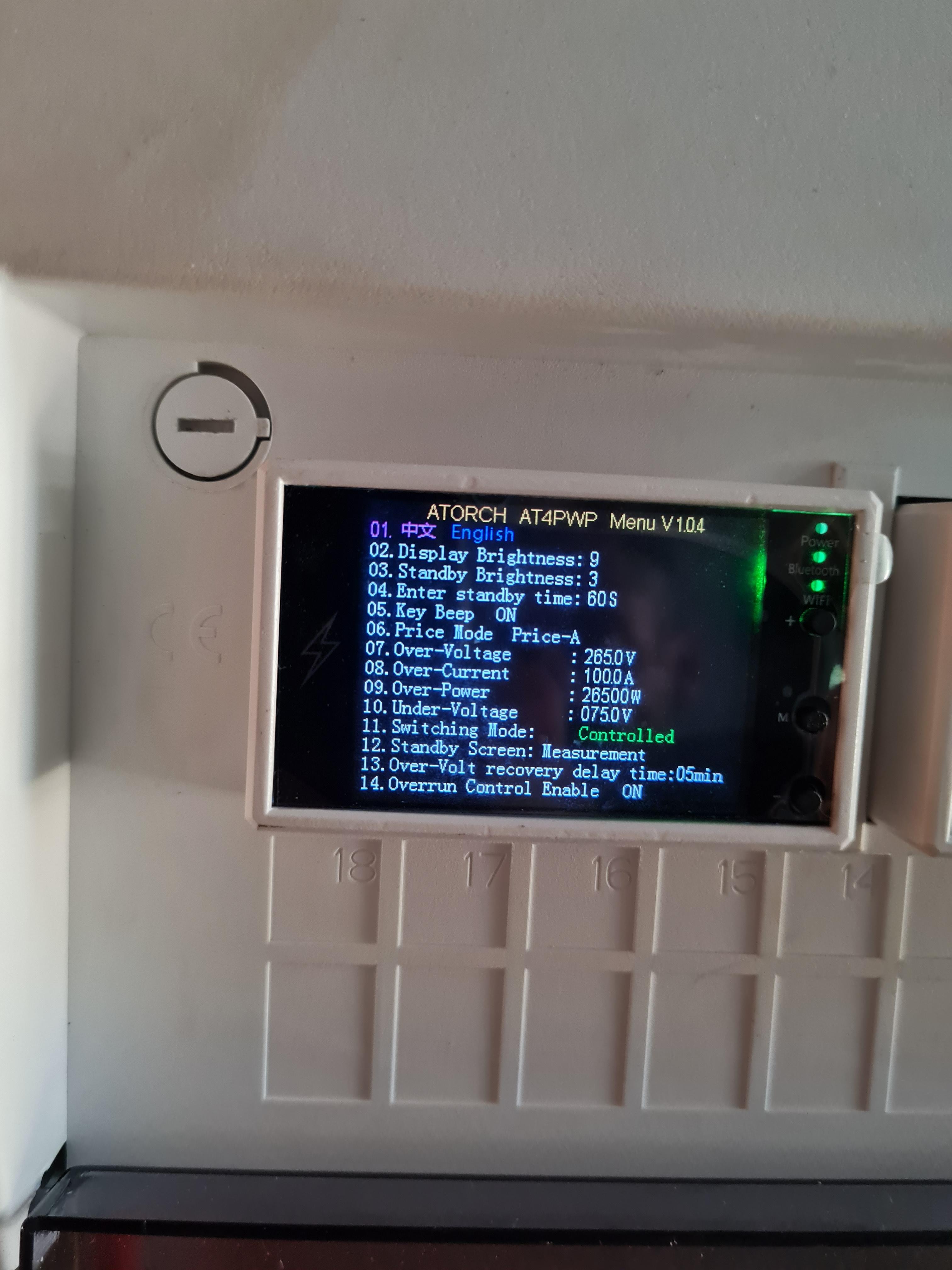

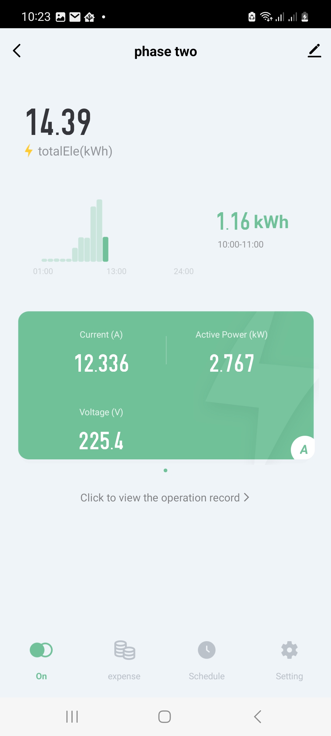

    i total of 3 units each Identical on the outside, purchased as the same model and 2 of the 3 software wise have less features but higher software version.

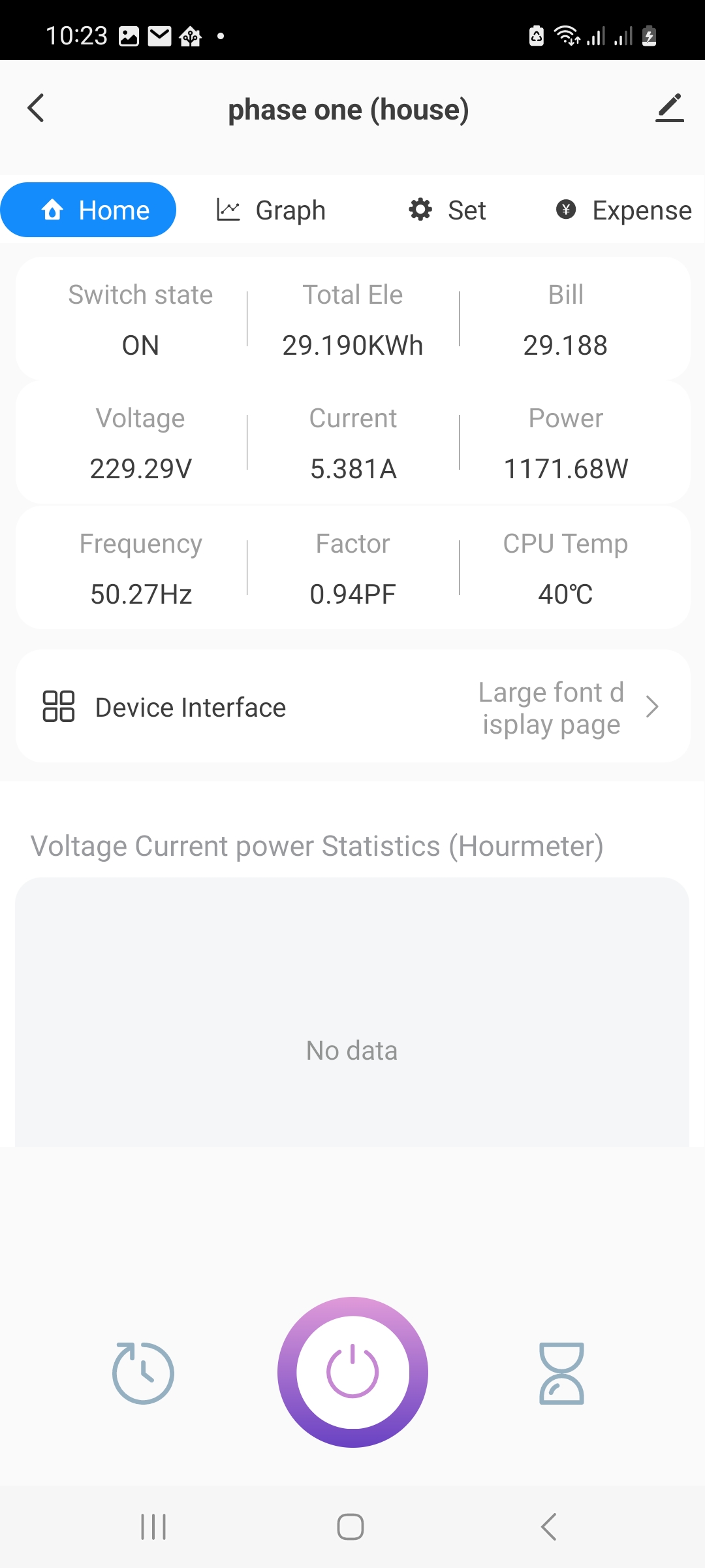

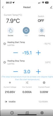

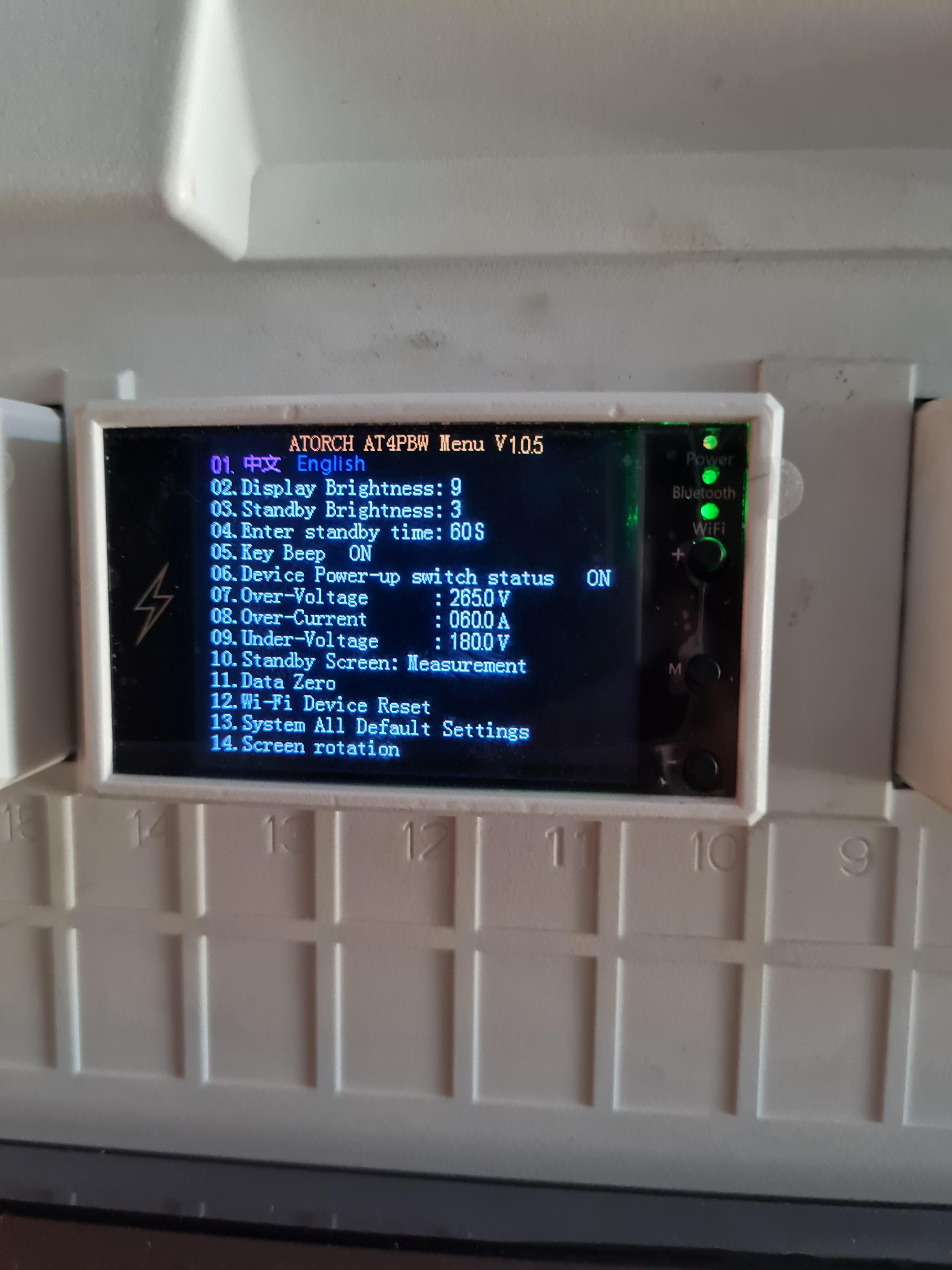

    Software AT4PWP V1.04 will show Power Factor, Voltage, history, current (A) ,load (W) , energy used kw/h , frequency, bill and cpu temp on client app and main screen.
    Software AT 4PBW V1.05 will show Voltage, Load (W) and current with on/off history on client app but displayss all the above and humidity ? on the lcd. it also has exact same pcb and markings.
    Tuya ATORCH AT4P(WP/BW) Smartlife Energy monitor (BK7231N) (C3BS) (CH573F) (BL0924)Screenshot...t Life.jpg (186.36 kB)You must be logged in to download this attachment. AT4PBW
    Tuya ATORCH AT4P(WP/BW) Smartlife Energy monitor (BK7231N) (C3BS) (CH573F) (BL0924)Screenshot...t Life.jpg (241.85 kB)You must be logged in to download this attachment. AT4PWP

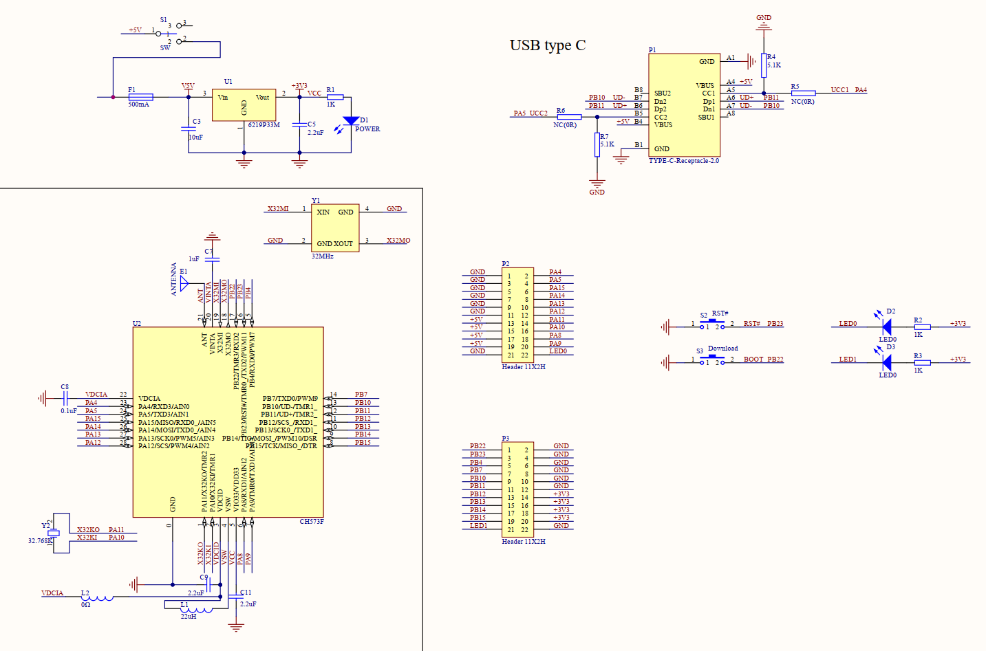

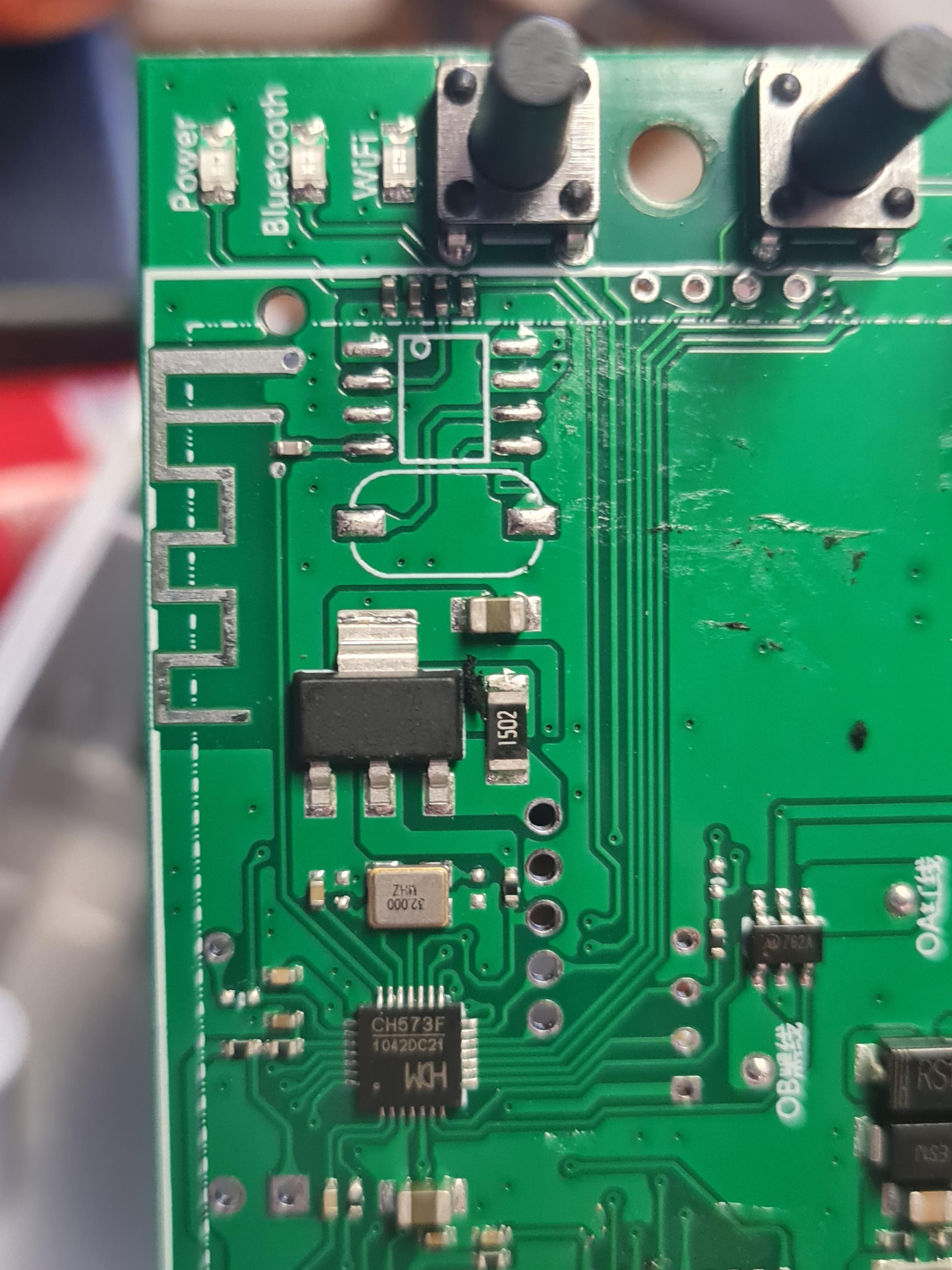

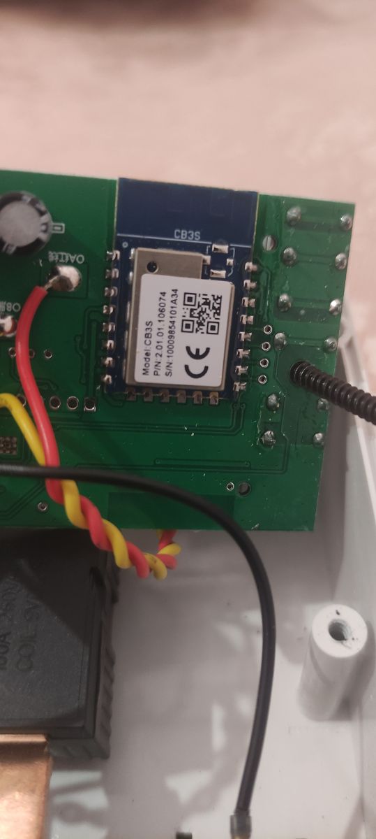

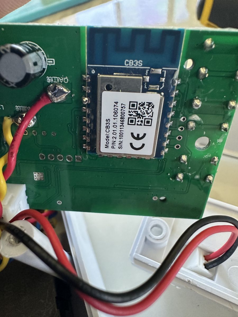

    pinouts of the ch573
    PB15 -> pin 3 of JP3
    PB14 -> Pin 2 of JP3 -> Button 1
    PB13 -> CB3S RXD1
    PB12 -> CB3S TXD1
    PB11 -> pin 4 of JP2 -> bt led
    PB10 - > pin 3 of JP2 -> Button 3
    PB7 -> bl0942 adc/energy monitor RX
    PB4 -> bl0942 adc/energy monitor TX
    PB23 -> bt uart tx Ac6328 (zh-jieli.com) -> pin 2  of JP4 (not fitted)
    PB22 -> bt uart rx AC6328 -> pin 4 of JP4 (not fitted)
    PA4 -> Button 2
    PA9 -> Relay control

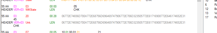

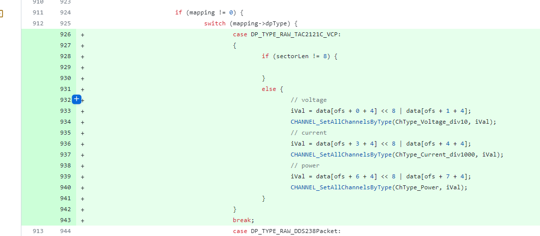

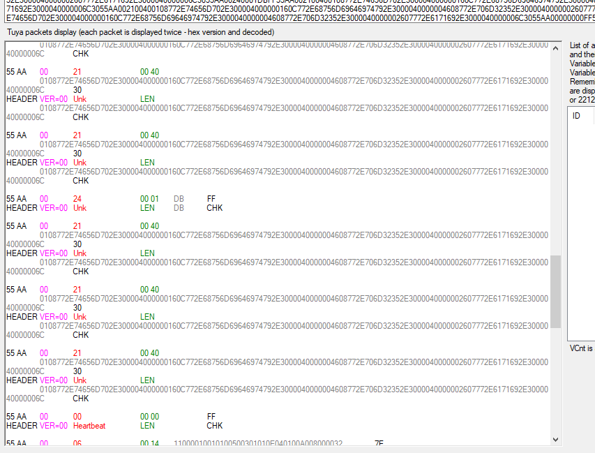

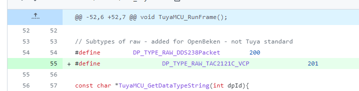

    Very good job, did you figure dpIds yourself?
    From what I can see, there was no compound device-specific packet types?
    For example, this device: Hiking DDS238-2 Smart Meter had one custom packet type that contained multiple measurement results and I had to add support for that per user request.

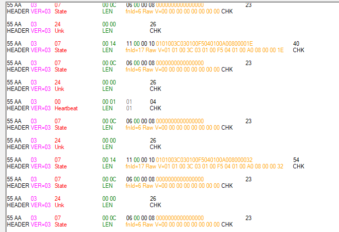

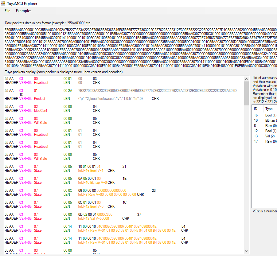

  • Baud rate change revealed the dpIds
    #3 20336287
    crg1darkspr1te
    Posts: 22
    Rate: 12

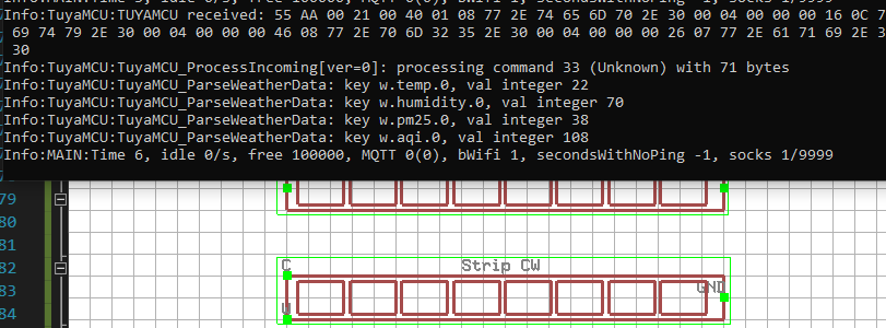

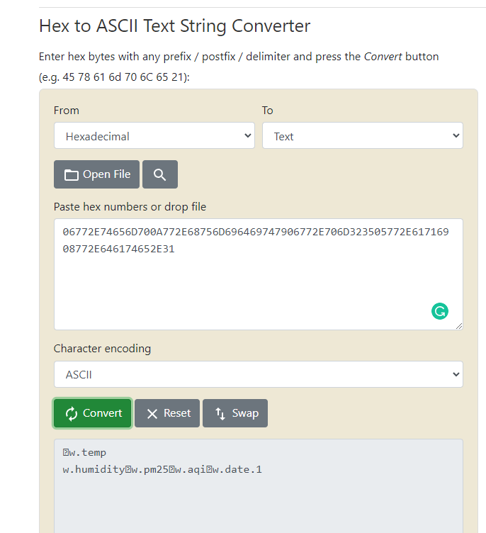

    The dplds were pulled from the logs once i figured that the baud rate had to be changed (many a time i fotgot to add that and assume wiring at fault, lmao)
    most stick to the listed ones for power/current/voltage/frequency for other devices I did confirm with set loads and power measuring tech, they are within 1v~
    I do have a dump for the cloudcutter people but forgot to sanitize my ssid etc , is there a good guide for that ?

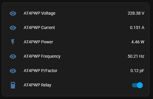

    also additional code
    configuration.yaml for basic feedback
    mqtt:
      sensor:
        - unique_id: "Phase One Current"
          state_topic: 'obk04A00E72/4/get'
          unit_of_measurement: 'A'
          value_template: '{{ (value | int)/1000 }}'
        - unique_id: "Phase One Voltage "
          state_topic: 'obk04A00E72/2/get'
          unit_of_measurement: 'V'
          value_template: '{{ (value | int)/100 }}'
        - unique_id: "Phase One Power"
          state_topic: 'obk04A00E72/3/get'
          unit_of_measurement: 'W'
          device_class: "power"
        - unique_id: "Phase One Factor"
          name: 'AT4PWP P/Factor'
          state_topic: 'obk04A00E72/8/get'
          unit_of_measurement: 'pF'
        - unique_id: "Phase One Frequency"
          name: 'AT4PWP Frequency'
          state_topic: 'obk04A00E72/5/get'
          unit_of_measurement: 'Hz'
      switch:
       - unique_id: "Phase One Operation"
         state_topic: "obk04A00E72/1/get"
         command_topic: "obk04A00E72/1/set"
         qos: 1
         payload_on: 1
         payload_off: 0
         retain: true

    I've confirmed that the other two devices i have that have different firmware features have different info,
    will paste when am done working on that device (note: they are identical in design/hw but differ in features by software only)
    darkspr1te
    Added after 3 [minutes]:
    this is the same device but software different (AT4PBW)

  • Unknown TuyaMCU commands 36 and 52 logged
    #5 20340532
    crg1darkspr1te
    Posts: 22
    Rate: 12
    So on the next device (type AT4PBW, Mcu ver 1.05) i am not getting any feedback at all,
    in the logs there are quite a few issues
    Info:TuyaMCU:TUYAMCU received: 55 AA 03 00 00 01 01 04
    Info:TuyaMCU:TuyaMCU_ProcessIncoming[ver=3]: processing command 0 (Hearbeat) with 8 bytes
    Info:TuyaMCU:TUYAMCU received: 55 AA 03 24 00 00 26
    Info:TuyaMCU:TuyaMCU_ProcessIncoming[ver=3]: processing command 36 (Unknown) with 7 bytes
    Info:TuyaMCU:TuyaMCU_ProcessIncoming: unhandled type 36
    Info:TuyaMCU:TUYAMCU received: 55 AA 03 34 00 01 03 3A
    Info:TuyaMCU:TuyaMCU_ProcessIncoming[ver=3]: processing command 52 (Unknown) with 8 bytes
    Info:TuyaMCU:TuyaMCU_ProcessIncoming: unhandled type 52
    it currently only reports one dpId of 6 but randomly it will report others
    Info:TuyaMCU:TUYAMCU received: 55 AA 03 07 00 05 0A 05 00 01 00 1E
    Info:TuyaMCU:TuyaMCU_ProcessIncoming[ver=3]: processing command 7 (State) with 12 bytes
    Info:TuyaMCU:TuyaMCU_ParseStateMessage: processing dpId 10, dataType 5-DP_TYPE_BITMAP and 1 data bytes
    Info:TuyaMCU:TuyaMCU_ParseStateMessage: raw data 1 byte:
    Info:TuyaMCU:TUYAMCU received: 55 AA 03 07 00 0C 06 00 00 08 00 00 00 00 00 00 00 00 23
    Info:TuyaMCU:TuyaMCU_ProcessIncoming[ver=3]: processing command 7 (State) with 19 bytes
    Info:TuyaMCU:TuyaMCU_ParseStateMessage: processing dpId 6, dataType 0-DP_TYPE_RAW and 8 data bytes
    Info:TuyaMCU:TUYAMCU received: 55 AA 03 07 00 05 0C 01 00 01 00 1C
    Info:TuyaMCU:TuyaMCU_ParseStateMessage: processing dpId 12, dataType 1-DP_TYPE_BOOL and 1 data bytes
    Info:TuyaMCU:TUYAMCU received: 55 AA 03 07 00 08 0D 02 00 04 00 00 C3 50 37
    Info:TuyaMCU:TuyaMCU_ProcessIncoming[ver=3]: processing command 7 (State) with 15 bytes
    Info:TuyaMCU:TuyaMCU_ParseStateMessage: processing dpId 13, dataType 2-DP_TYPE_VALUE and 4 data bytes
    Info:TuyaMCU:TuyaMCU_ParseStateMessage: raw data 4 int: 50000
    Info:TuyaMCU:TUYAMCU received: 55 AA 03 07 00 14 11 00 00 10 01 01 00 3C 03 01 00 F5 04 01 00 B4 00 00 00 1E 54
    Info:TuyaMCU:TuyaMCU_ProcessIncoming: discarding packet bad expected checksum, expected 84 and got checksum 76
    Info:TuyaMCU:TUYAMCU received: 55 AA 03 07 00 14 11 00 00 10 01 01 00 3C 03 01 00 F5 04 01 00 B4 08 00 00 1E 54
    Info:TuyaMCU:TuyaMCU_ProcessIncoming[ver=3]: processing command 7 (State) with 27 bytes
    Info:TuyaMCU:TuyaMCU_ParseStateMessage: processing dpId 17, dataType 0-DP_TYPE_RAW and 16 data bytes
    Info:MAIN:Time 121, idle 480164/s, free 76408, MQTT 0(7), bWifi 1, secondsWithNoPing -1, socks 2/38
    i am currenlty trying to get openbk to build on my system but i have a lot of installing to do and internet speed here is aweful.
    darkspr1te
  • Request for real measurements to decode raw Tuya packet
    #6 20340686
    Posts: 14770
    Rate: 12913
    Having a full communication dump from the original firmware can help a lot in such cases. It is easier to investigate when you know what's supposed to happen.
    Those commands are not known to me. I haven't seen them in case of other devices.
    55 AA 03 24 00 00 26 - 0x24 type with 00 00 len (no payload)
    55 AA 03 34 00 01 03 3A - 0x34 type with 00 01 len and 0x03 payload byte
    This looks like a raw measurements results compound packet.
    Raw data:
    V=01 01 00 3C 03 01 00 F5 04 01 00 B4 08 00 00 1E
    One could try guessing which bytes are voltage, current, etc, but without knowing which values to expect, it might not be reliable... would you be able to provide real measurement results and another packet to compare?
  • Factory firmware provisioning and setting captures
    #7 20340742
    crg1darkspr1te
    Posts: 22
    Rate: 12
    Attached is a realterm hex dump of the device with factory firmware.
    I reset the device the recorded the provisioning from both the TX and RX of the signal , attached is capture(TX of tuyamcu) and capture2 (RX of tuyaMCU)
    I then went and changed current, over voltage, low voltage and then expense cutoff and then finally switched off the device.
    I will also study it as soon as i can get a working dev env going, i recently reinstalled and having a poor time re-building my various compilers etc .
    darkspr1te
    • capture2.txt (1.14 KB) You must be logged in to download this attachment.
    • capture.txt (1.37 KB) You must be logged in to download this attachment.
  • Request for grid voltage and load capture samples
    #8 20340901
    Posts: 14770
    Rate: 12913
    Any more information on those captures? Current voltage, power, etc?
    Lots of data here
    Some of packets looks like custom data:
    Those two compound packets might contain measurement data but I don't need what to look for:
    I would need to know:
    - your grid voltage
    - how looks like the sample with 60W bulb load and with 10W load
    More custom data:
    In this custom hex data, I can see ASCII string references like w.temp.0, w.pm25.0, w.aqi.0, w.humidity.0
  • OpenBK build now works for BK7231N device

  • Tuya MCU state query logs and ez-pair issue
    #11 20342236
    crg1darkspr1te
    Posts: 22
    Rate: 12
    I have flash the lastest bin file but it seems the device wont go past the ez-pair screen (not accepting the ok from bk device? )
    if i do the command tuyaMcu_sendQueryState i will get this in the logs
    Debug:CMD:cmd [tuyaMcu_sendQueryState]
    Debug:MQTT:MQTT deduper sent 0, culled duplicates 0, culled too fast 0
    ExtraDebug:TuyaMCU:TuyaMCU heartbeat_valid = 1, product_information_valid=1, self_processing_mode = 1, wifi_state_valid = 1, wifi_state_timer=37
    Info:TuyaMCU:TUYAMCU received: 55 AA 03 07 00 05 10 01 00 01 01 21
    Info:TuyaMCU:TuyaMCU_ParseStateMessage: processing dpId 16, dataType 1-DP_TYPE_BOOL and 1 data bytes
    Info:GEN:No change in channel 7 (still set to 1) - ignoring
    Info:GEN:No change in channel 3 (still set to 0) - ignoring
    Info:GEN:No change in channel 4 (still set to 0) - ignoring
    Info:GEN:No change in channel 5 (still set to 50000) - ignoring
    Info:MAIN:Time 290, idle 180984/s, free 77384, MQTT 0(18), bWifi 1, secondsWithNoPing -1, socks 2/38
    ExtraDebug:TuyaMCU:TuyaMCU heartbeat_valid = 1, product_information_valid=1, self_processing_mode = 1, wifi_state_valid = 1, wifi_state_timer=55
    Info:MAIN:Time 471, idle 177359/s, free 77384, MQTT 0(29), bWifi 1, secondsWithNoPing -1, socks 2/38
    Debug:API:POST to api/cmnd
    ExtraDebug:TuyaMCU:TuyaMCU heartbeat_valid = 1, product_information_valid=1, self_processing_mode = 1, wifi_state_valid = 1, wifi_state_timer=56
    Info:MAIN:Time 472, idle 186702/s, free 77384, MQTT 0(29), bWifi 1, secondsWithNoPing -1, socks 2/38
    ExtraDebug:TuyaMCU:TuyaMCU heartbeat_valid = 1, product_information_valid=1, self_processing_mode = 1, wifi_state_valid = 1, wifi_state_timer=57
    Info:TuyaMCU:TuyaMCU_ProcessIncoming: (test for TH06 calendar) received 0x24, so sending back time
    Info:TuyaMCU:MCU time to set: 1671439142
    Info:TuyaMCU:ptime ->gmtime => tm_hour: 8
    Info:TuyaMCU:ptime ->gmtime => tm_min: 39
    Info:MAIN:Time 473, idle 170289/s, free 77384, MQTT 0(29), bWifi 1, secondsWithNoPing -1, socks 2/38
    Info:MAIN:Time 474, idle 153572/s, free 68776, MQTT 0(29), bWifi 1, secondsWithNoPing -1, socks 3/38
    ExtraDebug:TuyaMCU:TuyaMCU heartbeat_valid = 1, product_information_valid=1, self_processing_mode = 1, wifi_state_valid = 1, wifi_state_timer=58
    Info:MAIN:Time 475, idle 178193/s, free 77384, MQTT 0(29), bWifi 1, secondsWithNoPing -1, socks 2/38
    ExtraDebug:TuyaMCU:TuyaMCU heartbeat_valid = 1, product_information_valid=1, self_processing_mode = 1, wifi_state_valid = 1, wifi_state_timer=59
    Info:MAIN:Time 476, idle 185501/s, free 77384, MQTT 0(29), bWifi 1, secondsWithNoPing -1, socks 2/38
    ExtraDebug:TuyaMCU:TuyaMCU heartbeat_valid = 1, product_information_valid=1, self_processing_mode = 1, wifi_state_valid = 1, wifi_state_timer=0
    Info:MAIN:Time 477, idle 182957/s, free 77384, MQTT 0(29), bWifi 1, secondsWithNoPing -1, socks 2/38
    at the time this was logged the voltage was 228v/29watts/0.13amps
    when i was on the bk firmware before it did pass the wifi screen and would display "some" dpid's , however to get it to do that i had to flash the firmware from the other device (at4pwp/1.04)
    and at time am getting the other commands
    Info:TuyaMCU:TUYAMCU received: 55 AA 03 1C 00 00 1E
    Info:TuyaMCU:TuyaMCU_ProcessIncoming[ver=3]: processing command 28 (SetTime) with 7 bytes
    Info:TuyaMCU:TuyaMCU_ProcessIncoming: received TUYA_CMD_SET_TIME, so sending back time
    Info:TuyaMCU:MCU time to set: 1671439219
    Info:TuyaMCU:ptime ->gmtime => tm_min: 40
    Info:MAIN:Time 550, idle 186128/s, free 77384, MQTT 0(34), bWifi 1, secondsWithNoPing -1, socks 2/38
    Info:GEN:dhcp=0 ip=192.168.10.162 gate=192.168.10.1 mask=255.255.255.0 mac=a0:92:08:c0:18:cc
    ok some small progress my side,
    //ch 7 (dpid 16) power on/off
    linkTuyaMCUOutputToChannel  16 bool 7
    Added after 3 [hours] 21 [minutes]:
    ok ive worked out the following from dpId 17
    14th bit overccurrent amps (0x3c here) Dec 60Amps
    17/18 overvoltage (0x00 0xf5) dec 245V
    21/22 lowvoltage ( 0xb4 before decimal 0x08 after decimal) Dec 180.08 V
    when i change them in the menus they change here.

  • Packet structure analysis for 0x21 device data
    #13 20344925
    Posts: 14770
    Rate: 12913
    0x21 also seems to be specific to this device. I am not sure about the structure of 0x21 packet yet.
    Sample whole packet:
    55AA002100400108772E74656D702E300004000000160C772E68756D69646974792E3000040000004608772E706D32352E3000040000002607772E6171692E3000040000006C30
    71 bytes of data
    The beginning should be obvious:
    55AA 00 21 0040
    HDER VV TP LENG
    0040 length = 64 bytes length + header (2) + version (1) + type (1) + len field (2) + checksum (1) = 71 bytes, it matches, then:
    01 08
    772E74656D702E300 – NULL Terminated ASCII “w.temp.0”
    0040 00000 16 0C
    772E68756D69646974792E300 – NULL Terminated ASCII “w.humidity.0”
    0040 00000 46 08
    772E706D32352E300 – NULL Terminated ASCII “w.pm25.0”
    0040 00000 26 07
    772E6171692E300 – NULL Terminated ASCII “w.aqi.0”
    0040 00000 6C 30
    I don't know why 0040 repeats every time for each variable. Also, what is 0x46 0x08 for humidity? 26 07 for pm25 (air quality guideline?) and 6C 30 for aqi?
  • Weather service command 0x21 packet breakdown
    #14 20345544
    crg1darkspr1te
    Posts: 22
    Rate: 12
    The packet 0x21 is response to the command 55 aa 03 34 00 01 03 3a ,
    proactively request weather data ,
    and the breakdown of 0x21 is as follows
    (Optional) Enable weather services
    Enable the module to get the weather data.
    The MCU sends the following command.
    Field Bytes Description
    Header 2 0x55aa
    Version 1 0x03
    Command 1 0x20
    Data length 2 N((L+K)+(L+K)…)
    Data n L: consumes 1 byte and indicates the length of K.
    K: indicates the name of the request parameter.
    Example:
    L: 0x06, K: w.temp.
    L: 0x06, K: w.pm25.
    L: 0x0a, K: w.humidity.
    Checksum 1 Start from the header, add up all the bytes, and then divide the sum by 256 to get the remainder.
    For more information about the weather data, see Weather Service.
    For example, if the MCU requests w.temp and w.pm25, it sends 55 aa 03 20 00 0e 06 77 2e 74 65 6d 70 06 77 2e 70 6d 32 35 80.
    The module returns the following command.
    Header 2 0x55aa
    Version 1 0x00
    Command 1 0x20
    Data length 2 0x0002
    Data 2 Data[0]:
    0x00: failure.
    0x01: success.
    Data[1]:
    0x00: no error.
    0x01: invalid data format.
    0x02: exception.
    For example, 55 aa 00 20 00 02 01 00 22
    (Optional) Send weather data
    The module will send the weather data immediately as the weather service is enabled and then sends data every 30 minutes.
    The module sends the following command.
    Header 2 0x55aa
    Version 1 0x00
    Command 1 0x21
    Data length 2 N((LKTLV)+(LKTLV)+…)
    Data Data
    0x00: indicates a failure.
    0x01: indicates an unauthorized parameter service. Check whether you have subscribed to specific weather services or whether you have enabled the weather services through the 0x20 command.
    0x01: indicates a success.
    L: the length of the parameter name.
    K: the name of the parameter.
    T: 0x00 indicates an integer and 0x01 indicates a string.
    L: the length of the field name.
    V: the value of the field.
    The MCU returns the following command.
    Header 2 0x55aa
    Version 1 0x03
    Command 1 0x21
    Data length 2 0x0000
    Data 0 None
    If a request contains two request parameters such as w.temp and w.pm25, only w.temp returns a value, you need to check whether the request parameter name is correct.
    For example, if the weather data is w.humidity:69, w.temp:32, and w.pm25:10, the module will send the following command.
    55 aa 00 21 00 30 01 0a 77 2e 68 75 6d 69 64 69 74 79 00 04 00 00 00 45 06 77 2e 74 65 6d 70 00 04 00 00 00 20 06 77 2e 70 6d 32 35 00 04 00 00 00 10 1e 5c
    Proactively request weather data
    Besides passively receiving weather data from the module, the MCU can proactively request weather data using this command.
    The minimum request interval is one minute. If the MCU sends multiple requests within one minute, the request is only processed once.
    The module only uses this command to confirm a request and sends weather data still through the command 0x21.
    Field Length Description
    Header 2 0x55aa
    Version 1 0x03
    Command 1 0x34
    Data length 2 0x0001
    Data 1 0x03 (subcommand)
    For example, 55 aa 03 34 00 01 03 3a
    Header 2 0x55aa
    Version 1 0x00
    Command 1 0x34
    1
    0x00: success.
    0x01: failure.
    For example, 55 aa 00 34 00 02 03 00 38
    this is found on the link i posted before
    https://developer.tuya.com/en/docs/iot/tuya-c...tle-24-Proactively%20request%20weather%20data
    " target="_blank" rel="nofollow noopener ugc" class="postlink inline" title="" >
    darkspr1te

    I will try to add parsing of that data to OpenBeken later today.
    Will commit soon:

    crg1darkspr1te
    Posts: 22
    Rate: 12
    I have been able now to read voltage/current from the device and then manually calculate power , here is my patch ,
    drv_tuyaMCU.c
    	else if (sectorLen == 4) {
    			iVal = data[ofs + 4] << 24 | data[ofs + 5] << 16 | data[ofs + 6] << 8 | data[ofs + 7];
    			addLogAdv(LOG_INFO, LOG_FEATURE_TUYAMCU, "TuyaMCU_ParseStateMessage: raw data 4 int: %i\n", iVal);
    			// apply to channels
    			TuyaMCU_ApplyMapping(fnId, iVal);
    		//**new Code**
    		else if (sectorLen == 8) {
    			iVal = data[ofs + 4] << 8 | data[ofs + 5];
    			addLogAdv(LOG_INFO, LOG_FEATURE_TUYAMCU, "TuyaMCU_ParseStateMessage: raw data 8 int: %i\n", iVal);
    			result = MQTT_PublishMain_StringInt("voltage", iVal);
    			// current
    			iVal = data[ofs + 7] << 8 | data[ofs + 8];
    			result = MQTT_PublishMain_StringInt("current", iVal);
    			// power
    			iVal = (data[ofs + 4] << 8 | data[ofs + 5]) * (data[ofs + 7] << 8 | data[ofs + 8]);
    			result = MQTT_PublishMain_StringInt("power", iVal);
    		//**end of new code
    		else {
    			tuyaMCUMapping_t* mapping;
    			mapping = TuyaMCU_FindDefForID(fnId);
    			if (mapping != 0) {
    i am still learning this whole eco system so excuse poor coding and layout.
    this now at least allows me to read the data. sadly because the software is different it does not return as much info compared to the other unit which is disappointing. I have 3 more units on the way from the supplier who assures me they are all 3 the same mcu 1.04 model.
    I've looked into the possability of dumping the ch573 cpu but all indicators point to it erasing if you connect a programming cable. how ever my current 1.04 mcu has a update pending, I could man in middle attack the new update and then apply it to the other mcu's if it's not a feature killing firmware and drops all the data collecting ability the unit has.
    A couple of questions on the code base, the function void TuyaMCU_ParseQueryProductInformation(const byte* data, int len) , does it store the product ID so it can be accessed in code or it it only displayed in the logs ? if we store it we can then do model specific functions when we have a overlap in the command functions (something the tuya docs do mention).
    the CB3S module in my device also support BLE, are there any BLE function in OpenBk yet ?
    darkspr1te
  • Need configurable channels and more TuyaMCU requests
    #17 20347227
    Posts: 14770
    Rate: 12913
    This is not the correct way to do that.
    Please see this commit:
    https://github.com/openshwprojects/OpenBK7231...mmit/5a03649f7261413fba0d2c0794894c347381a5a8
    This must be configurable and must set channels so we can do automation and display things on GUI.
    I can add a packet support for you, based on your code.
    Maybe OpenBeken needs to send more requests to the TuyaMCU so it replies with more info? We can try adding it.
    There might be multiple device IDs per same functionality. The assumption is that user defines the TuyaMCU in the autoexec.bat, so through console commands.
    No work has been done on BLE yet, but it's in the SDK.
  • #18 20814148
    aerzk1971
    @ElektrodaBot I have a wifi problem before it works well but after the last power outage the wifi does not work and the green light no longer lights up I tried all the parameters like setting to zero and I stayed on wifi is the same thing! I think the wifi system is faulty
  • Power outage likely damaged WiFi module
    #19 20814149
    ElektrodaBot
    AI OpenAI ChatGPT4
    Posts: 8885
    Help: 364
    Rate: 954
    It definitely sounds like the power outage may have caused some damage to your WiFi equipment. Let's try to troubleshoot the issue step by step.
    1. Power Cycle: Although you've mentioned setting things to zero, have you tried completely power cycling the router? Unplug it from the power source, wait about a minute, and then plug it back in.
    2. Check for Damage: Inspect the router for any visible signs of damage. Sometimes a power surge can cause physical damage to the components.
    3. LED Status: If the green light that usually indicates normal operation isn't coming on, it could mean that the device isn't booting up correctly. Are there any other lights on the device that are lit or blinking?
    4. Connectivity Check: Try connecting to the router using a wired connection (Ethernet cable) to see if it's just the wireless that's affected.
    5. Router's Web Interface: If the wired connection works, access the router's web interface to check the wireless settings haven't been reset or changed. Sometimes a power outage can reset the router to its default settings.
    6. Firmware: If you can access the router's interface, check for firmware updates. An update might resolve the issue if the firmware was corrupted during the power outage.
    7. Surge Protector: In the future, using a surge protector can help protect your electronics from damage caused by power surges.
    If none of these steps work, it's possible the WiFi components inside the router have been damaged and the router will need to be replaced. But before we conclude, can you tell me what is the make and model of your WiFi router, and are there any other abnormalities or changes you've noticed since the power outage?
  • Overvoltage cutoff works, but Wi‑Fi and green LEDs fail
    #20 20814166
    aerzk1971
    the AT4P HD smart account. the problem everything works well overvoltage amperage cuts off at the request of people the red light comes on except the wifi and the two green lights
    AT4P HD smart display with IoT monitor showing Waiting network... message with a QR code for app download. Electrical meter display showing readings: 241.48 V, 0.190 A, 26.04 W, and 3.40369 kWh. User manual cover for AT4P HD Color Screen Digital Display Rail Meter. Close-up of an electronic circuit board with a CB3S module and colored wires. >>20814149
  • WiFi module likely disconnected or faulty
    #21 20814167

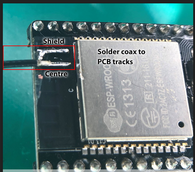

  • Asking about Wi‑Fi antenna mod and OpenBeken support
    #24 21008516

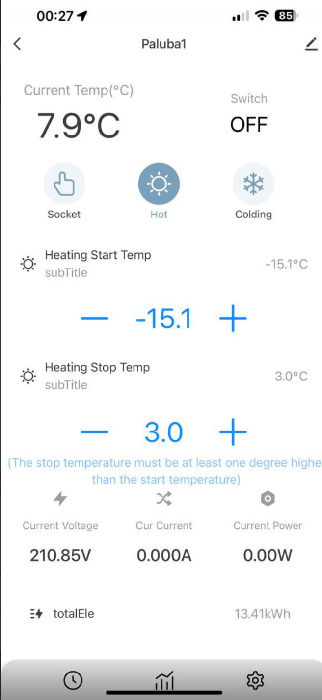

    denveronly
    Hello there.
    I recently brought 3 devices like on photo. It has a bit other model name A4PTW. It has same screen, size and specs. Has a temperature sensor. I brought it as a Thermostat in DIN rail. Menu in tuya looks like this
    App interface with temperature settings and power status.
    Have a few questions.
    1) Im a bit upset due to weak wifi signal on both 3 items i have. Wifi AP has strong signal, and is situated in 5 meters of direct sight. Im haveing random disconnections and connections every 1-2 minutes. Im thinking to Solder a Orange PI antenna to all units same as someone did for ESP. Is the Antenna wiring Okay? Will it work same on my chip?
    Close-up of an ESP chip with an antenna soldered to the PCB tracks.

    Which device model do you have exactly, can you provide detailed photos from the inside? In worst case we can try adding support for your device together. They should be still TuyaMCU-based.
    I haven't tried connecting external antenna yet.
  • Firmware 1.0.9 needed for 5-second updates
    #26 21031914
  • #27 21038442
    denveronly
    >>21008933
    Circuit board with mounted electronic module, held by a person. Close-up of an electronic device's circuit board, showing model CB3S and various colored wires. Open white electronic box with components inside.
    Here is my device
  • OBK lacks LCD support and factory MCU flashing
    #28 21038497
    Posts: 5220
    Help: 449
    Rate: 918
    wpa1 wrote:
    Is it possible to download firmware from this 1.0.9 via UART and upload it to other devices?
    Can't say I've ever seen any discussion about flashing factory firmware to other MCUs from within OBK. I did wonder about that when the Tuya app offered me an MCU upgrade in a similar device https://www.elektroda.com/rtvforum/topic4003739.html#20945733
    If I was already flashed to OBK I would have to go back to factory BK firmware first. I wouldn't even know there was an MCU upgrade unless someone posted about it somewhere either (or proactively flash to factory, pair with app, check for update).
    wpa1 wrote:
    Does this openbeken software support the display
    I don't think OBK supports any LCD displays, someone else will know better I'm sure. Anyway, won't the other chip on this device be driving the LCD? The display and menus on the other Atorch work as normal after flashing to OBK so I assumed the TuyaMCU was doing that side of things.
  • TuyaMCU controls the display, not the Wi-Fi module
    #29 21038629
    Posts: 14770
    Rate: 12913
    wpa1 wrote:
    Does this openbeken software support the display or does it only work on the esphome principle and you have to glue everything yourself?
    The device in the first post is using TuyaMCU. This means that the TuyaMCU is controlling the display, not the WiFI module itself.
    OpenBeken have a very good TuyaMCU support, so this kind of device should work good, but you need to know dpID meaning which are per-device, you can read more about TuyaMCU support here:
    TuyaMCU flashing, setup and configuration guide - configure dpIDs for Home Assistant
    Added after 56 [seconds]:
    @denveronly I still can't see much there, how is LCD connected? Is there MCU?

    duycaf
    I also have a AT4P and I am not able to connect to it anymore.
    Does someone was able to fix it? From the datasheet of Cb3s I saw that pin 1 is rst(reset), can I connect this to pin 3 and reset connectivity?
    Many thanks!

TL;DR: A single 8-byte compound packet ships voltage, current, power and energy every 5 s—“This must be configurable” [Elektroda, crg1darkspr1te, #20342236; p.kaczmarek2, #20347227].
Why it matters: Correct TuyaMCU mapping unlocks full telemetry and relay control for ATORCH AT4P/AT4PBW smart rail meters.

How do I bring a bricked AT4P/AT4PBW back online?
  1. Desolder the CB3S module.
  2. Flash a known-good 2 MB backup (e.g., v1.09) with ltchiptool via FT232RL [Elektroda, dr3amr, post #21221696]
  3. Resolder, power-cycle, and the device re-enters pairing. Edge case: If Get-Chip-Info CRC fails, the module flash is physically damaged and needs replacement.
What autoexec.bat lines give full telemetry on v1.04 hardware?
Use startDriver TuyaMCU startDriver NTP tuyaMcu_setBaudRate 115200 setChannelType 1 toggle setChannelType 2 Voltage_div10 setChannelType 3 Power setChannelType 4 Current_div1000 setChannelType 5 Frequency_div100 linkTuyaMCUOutputToChannel 1 bool 1 …repeat for dpIDs 20,19,18,133,135,134,123 as in sample [Elektroda, crg1darkspr1te, post #20335741]
My AT4PBW only shows dpID 6; how can I decode the raw 16-byte 0x11 packet?
Bytes 5-6 = over-current limit (A), 8-9 = over-voltage (V), 11-12 = low-voltage (V). Multiply to derive power if required [Elektroda, crg1darkspr1te, post #20342236]
Why does OpenBeken lose Wi-Fi after I press “Wifi reset” on LCD?
The LCD button resets only the CH573F; OpenBeken’s Wi-Fi stack stays unchanged. Force AP mode by cycling mains five times within 30 s [Elektroda, crg1darkspr1te, post #20815706]
Can OpenBeken drive the LCD directly?
No. The display is driven by the CH573F TuyaMCU; OpenBeken talks UART only. Screens and buttons keep working after OBK flash [Elektroda, p.kaczmarek2, post #21038629]
How do I request real-time weather data packets (0x21)?
Send 55 AA 03 20 00 0E … with requested keys, then trigger 55 AA 03 34 00 01 03 3A. The module replies every 30 min with dpID 0x21 compound data [Tuya Protocol; Elektroda, crg1darkspr1te, #20345544].
