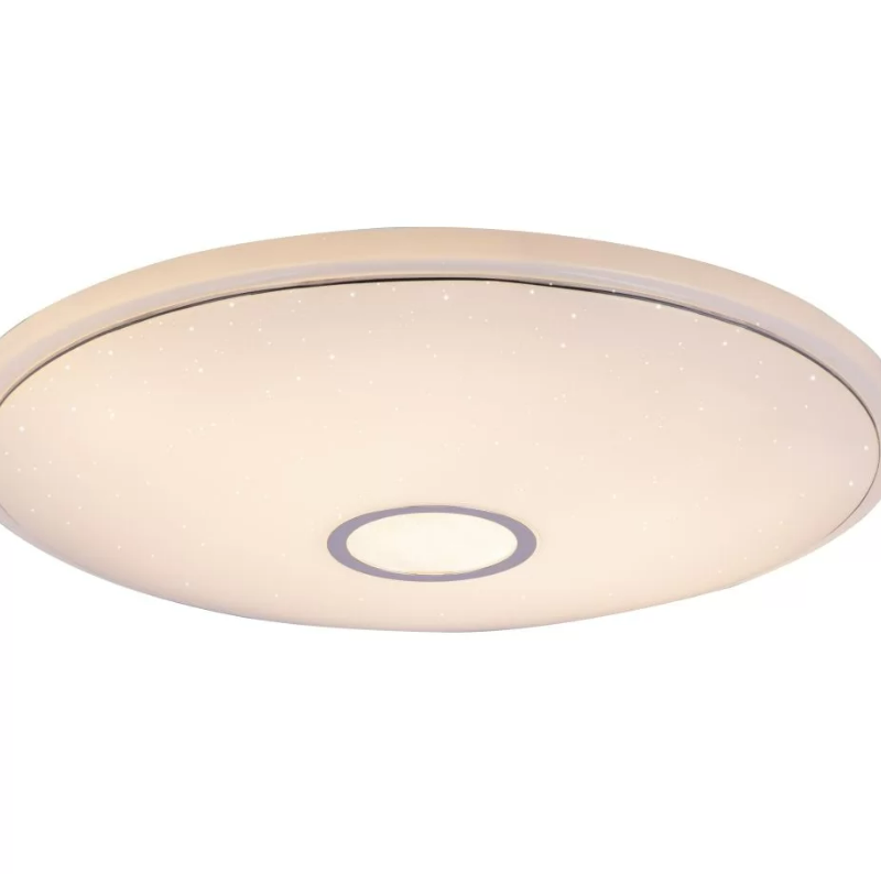

  • Flashed openBK to a Globo Connor 41386-30sh ceiling light with IR remote.
  • The light uses a Beken CB3S chip, identified as BK7321N.
  • The flash succeeded successfully.
Hi,
I successfully flashed openBK to my Globo Connor 41386-30sh ceiling Light with Beken CB3S chip (BK7321N).
thank you!

p.kaczmarek2 29 Dec 2022 01:38
Thank you for submitting pin configuration. That's a very nice lamp. I see you have an IR pin set. Does that lamp come with IR receiver? Have you managed to configure IR? You can just forward the IR... [Read more]
sabe89 29 Dec 2022 12:09
Hi p.kaczmarek2, you can see the ir receiver at the right bottom corner close to the CB3s chip. I bought the lights last year for about 90$ each. Actually I use the ir with mqtt add_dimmer and add_temperature... [Read more]
p.kaczmarek2 29 Dec 2022 12:16
Hmmm if you provide a full list of IR codes from that remote, it might be helpful for future users. [Read more]

roguezet 27 Feb 2024 13:29
I got all working. So with 41386-30sh with BK7231T it also works. The Pin mapping is a bit different though: "pins": { "6": "PWM;5", "8": "PWM;4", "9": "PWM;1", "14": "IRRecv;0", ... [Read more]
p.kaczmarek2 28 Feb 2024 22:45
Wake up state can be easily set with startup command or autoexec.bat in LittleFS. You can put any supported command there, here's the commands list: https://github.com/openshwprojects/OpenBK7231T_App/blob/main/docs/commands.md So,... [Read more]
