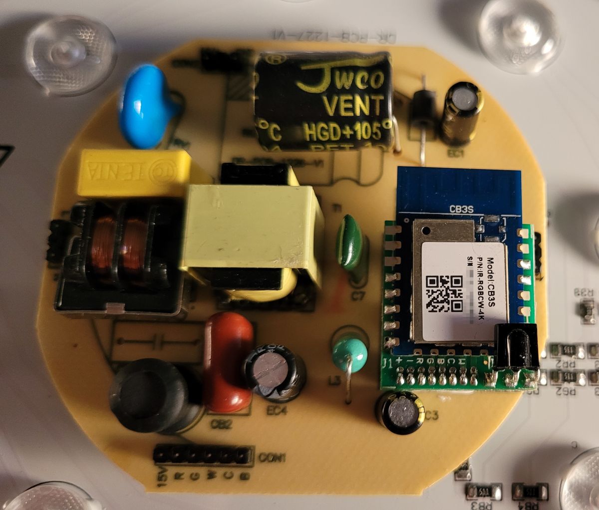

  • Flashed openBK to a Globo Connor 41386-30sh ceiling light with IR remote.
  • The light uses a Beken CB3S chip, identified as BK7321N.
  • The flash succeeded successfully.

    Thank you for submitting pin configuration. That's a very nice lamp.
    I see you have an IR pin set. Does that lamp come with IR receiver? Have you managed to configure IR? You can just forward the IR with publish to Home Assistant, or script it on the device itself to do anything you want (change LED states, etc)

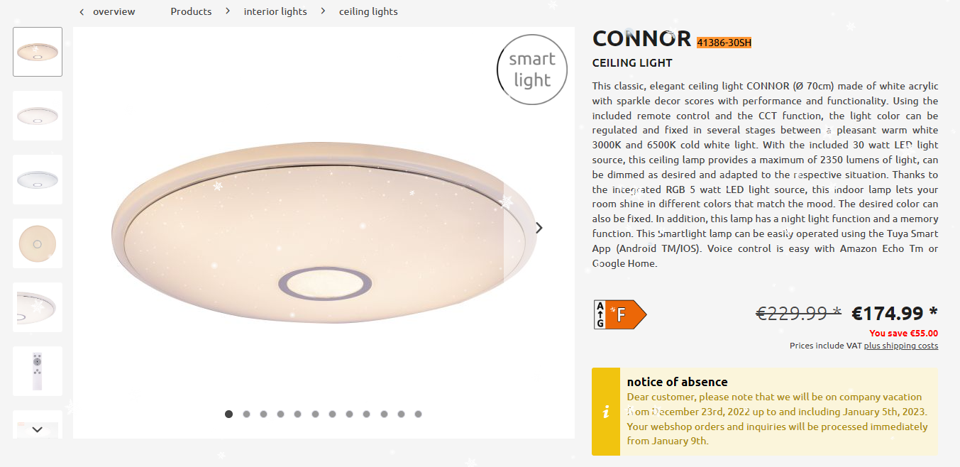

    I also looked at the price of this lamp and I am surprised. It's a big one, 175$?
    [CB3S] Globo Connor 41386-30sh ceiling light 30W with IR remote
    I've checked specs and it indeed has IR remote. Nice!
    Bulbs incl.Yes
    bulbs LEDs
    Power consumption 30 watts
    Lumens (source) 1 x 3150 lumens
    Lumens (effective) 1 x 2250 lumens
    memory function Remote control wall switch
    Remote control yes (infrared)
    Battery incl. 2*AAA
    applications Tuya
    Lifespan 20000h
    Tension 230 volts
    Degree of Protection IP20
    Protection class 1
    CCTFrom 3000 to 6500 Kelvin

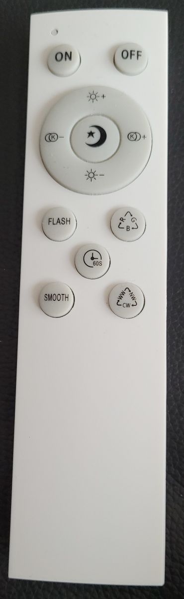

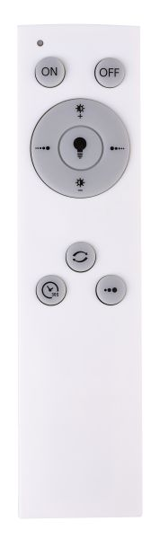

    Here is how remote looks like:

    Hi p.kaczmarek2,
    you can see the ir receiver at the right bottom corner close to the CB3s chip. I bought the lights last year for about 90$ each.
    Actually I use the ir with mqtt add_dimmer and add_temperature commands.

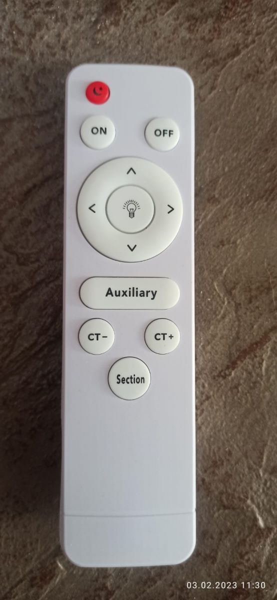

    Picture of my ir remote:
  • #4 20357465
    Posts: 14794
    Rate: 12942
    Hmmm if you provide a full list of IR codes from that remote, it might be helpful for future users.

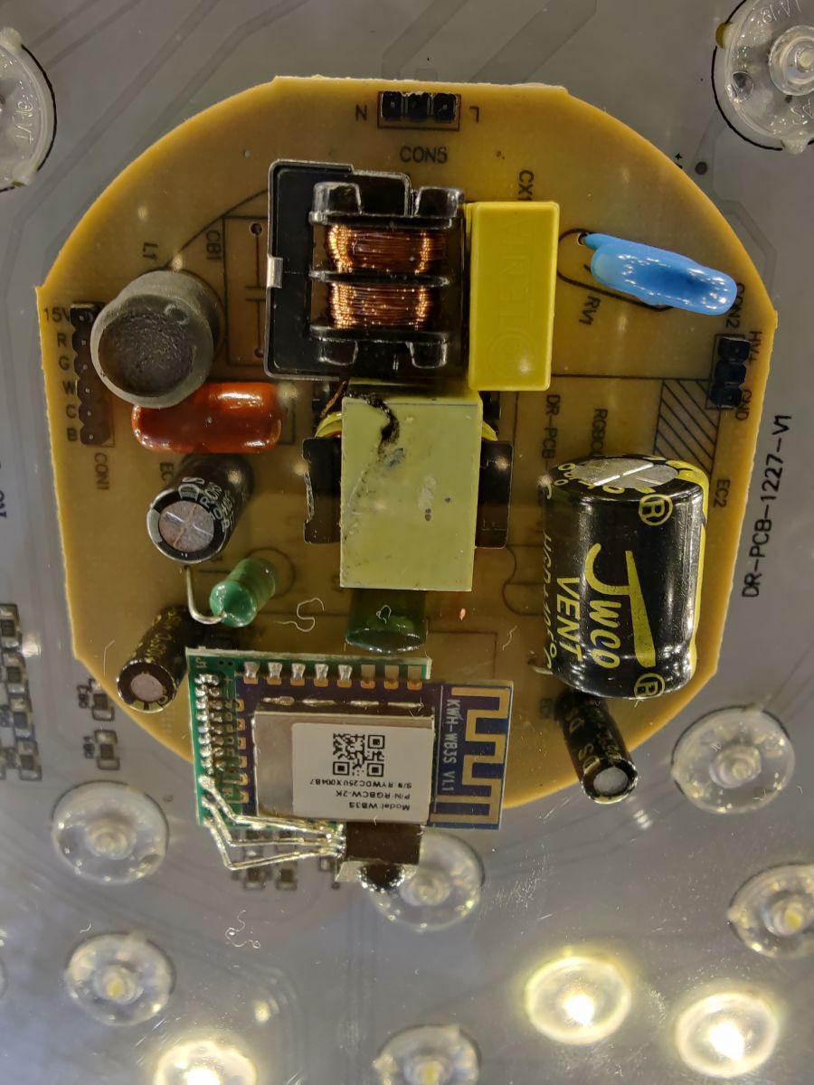

    roguezet
    Level 4  

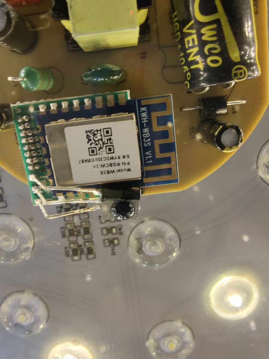

    I have the same lamp with wb3s chip.
    Is it possible to flash that as well and use the same template? I think the only dofference is that the light leds are warm and yours are cold.
    Also, how were your flashing steps?
    Best regards,
    Matthias

    roguezet
    Level 4  
    [CB3S] Globo Connor 41386-30sh ceiling light 30W with IR remote [CB3S] Globo Connor 41386-30sh ceiling light 30W with IR remote [CB3S] Globo Connor 41386-30sh ceiling light 30W with IR remote
    It really looks the same.
    I will be just adding "addEventHandler3" for you, it's a very easy modification. It will have an extra argument, which is that 'repeats' value.
    Would that solve your issue?
  • Bad remote causes inconsistent button codes
    #11 20419996
    alexandrgredasov
    Level 4  
    Hello, thank you for the answer and for your work in general!
    Upon closer examination, I found out that the last digit is not part of the code. At least it can be 0 and 1 at different times on the same button. And now I don't understand at all how to distinguish codes from buttons that are similar to each other (on my remote it's the ON/OFF button, left/right, top/bottom, and +/-, and Auxilary too)
    I bought in December from this seller.
    https://aliexpress.ru/item/1005004702068576.h...l.0.0.60c44aa6E5B2wE&sku_id=12000030155268016
    The price was about $15. I have 10 of them (there is something to experiment on). In principle, I am satisfied with the purchase, two lamps for a room of 15m2 are perfectly enough.
    Added after 28 [minutes]:
    I understood. This is a bad remote. That's how he works. Other remotes work fine! Thanks for your attention :)

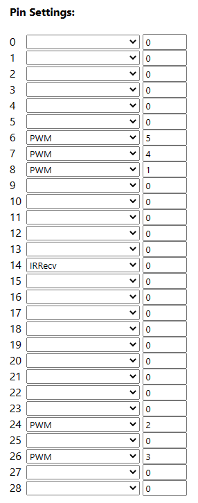

    roguezet
    Level 4  
    Hmm okay so please do fiirst a full 2MB flash read (if you can), for the firmware backup, and then flash OBK and try to configure it. I will help if any issue arises.
    I got all working. So with 41386-30sh with BK7231T it also works.
    The Pin mapping is a bit different though:
    Now I am trying to implement the lamp into my Loxone Smart Home via MQTT.
    I mainy need the commands Dimmer and Temperature.
    How can I set these via MQTT?
    Also, how can I set up a default "wakeup-state"? I only found a flag for remembering last state.
    Best regards,
    Matthias

    Posts: 14794
    Rate: 12942
    Wake up state can be easily set with startup command or autoexec.bat in LittleFS. You can put any supported command there, here's the commands list:
    So, you can, for example, put there a led_basecolor_rgb command and it will run at startup. The same for led_enableAll. Use backlog for multiple commands.
