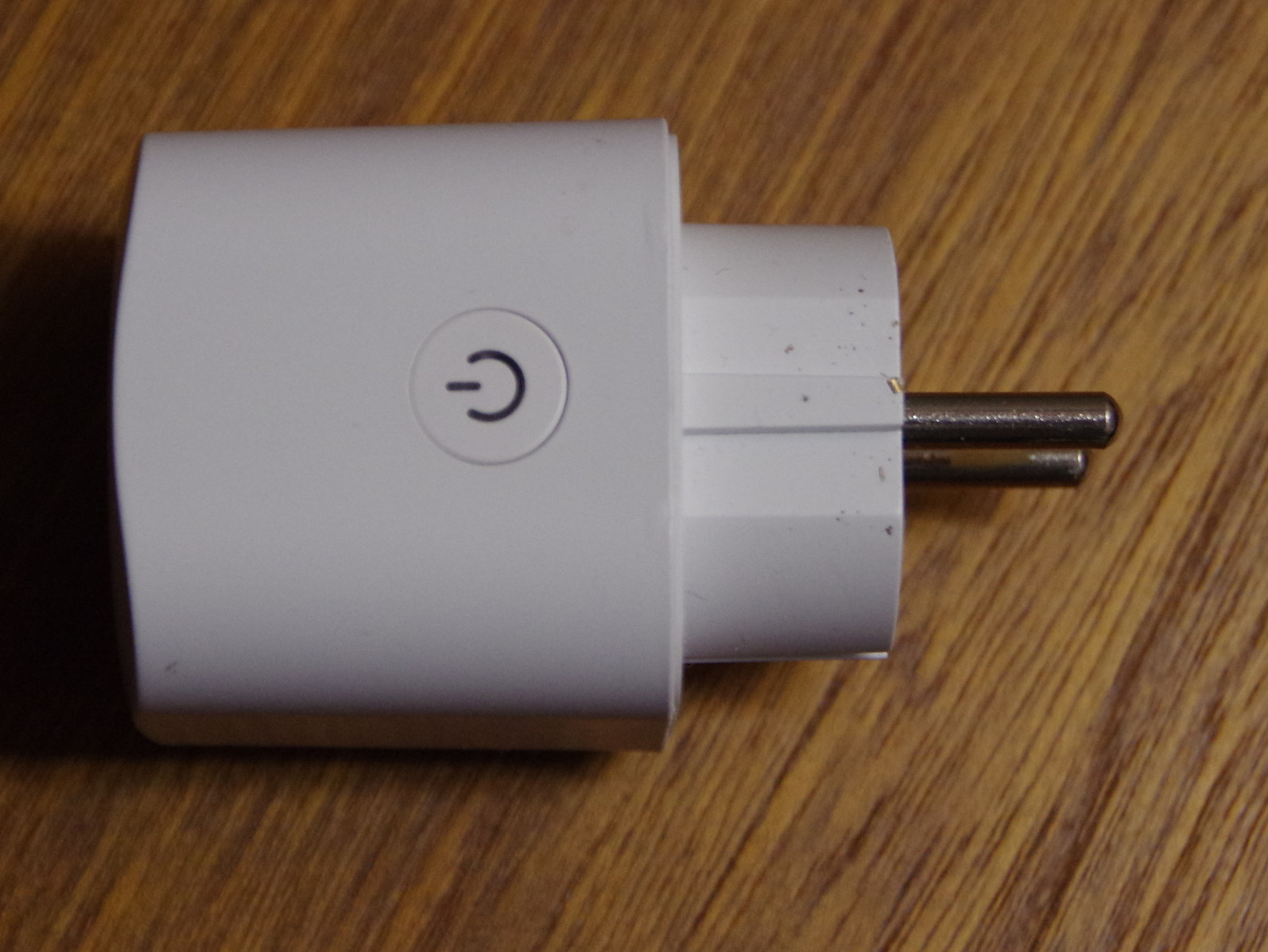

Bought a Wifi smart plug from AliExpress which seems to be of the Elivco brand, model number RMC004.
Opening the plug is relatively straightforward. In order to get the PCB off the plug I had to de-solder it from the 2 connections to the pins of the plug. After that the PCB with relay could easily be removed.
Closer inspection showed that the plug contained a BL602 board and a BL0937 IC for the energy monitoring. The power for the PCB seems to be supplied by a BP2525 IC. (I was unable to get the IC markings clearly visible on the pictures, using magnification the markings were clearly visible).
Another thing to notice is that the relay seems to be for 16A max whereas the plug is rated for 20A max. As a result I think the plug should not be used with >16A, or am I overseeing something there?
Flashing with the BL602 firmware seems to work, but configuration is necessary and at this moment the BL0937 energy monitoring does not seem to function. Following the traces on the PCB and checking continuity with a multi meter I found the following "configuration":
LED: pin 29 on the BL602, so GPIO20
Relay; P2, so GPIO2
Button: pin 31 on the BL602, so GPIO22
BL0937 CF1: pin4 on the BL602, so GPIO3
BL0937 CF: pin 22 on the BL602, so GPIO14
BL0937 SEL: pin 30 on the BL602 so GPIO21
as mentioned above at this moment this pin assignments work for LED, relay and button, but the BL0937 does not show up at all.

p.kaczmarek2 30 Dec 2022 16:57
Thank you, this is the first time I see BL0937 used with BL602. Currenty BL0937 driver on BL602 will not work, because it's missing a HAL interrupt falling edge counter that is required to count number... [Read more]

I have an identical socket, the only thing that saves you is replacing the module with ESP-02S, you can order it on ali. Today I managed to solder a new chip, upload supple to the device, and configure... [Read more]
p.kaczmarek2 15 Jan 2023 08:07
@krzychunh86 OpenBL602 almost supports BL0937, just need to add edge counter support which is missing for this platform now. However, replacing it with ESP-02S is also a good idea, if you want to write... [Read more]

I do have the BL602+BL0937 combo and also followed your suggestions for adjusting the driver (I think). As suggested I applied those in a fork of your main repo (so it should be kind of safe): https://github.com/sverd/OpenBK7231T_App/blob/main/src/driver/drv_bl0937.c... [Read more]
