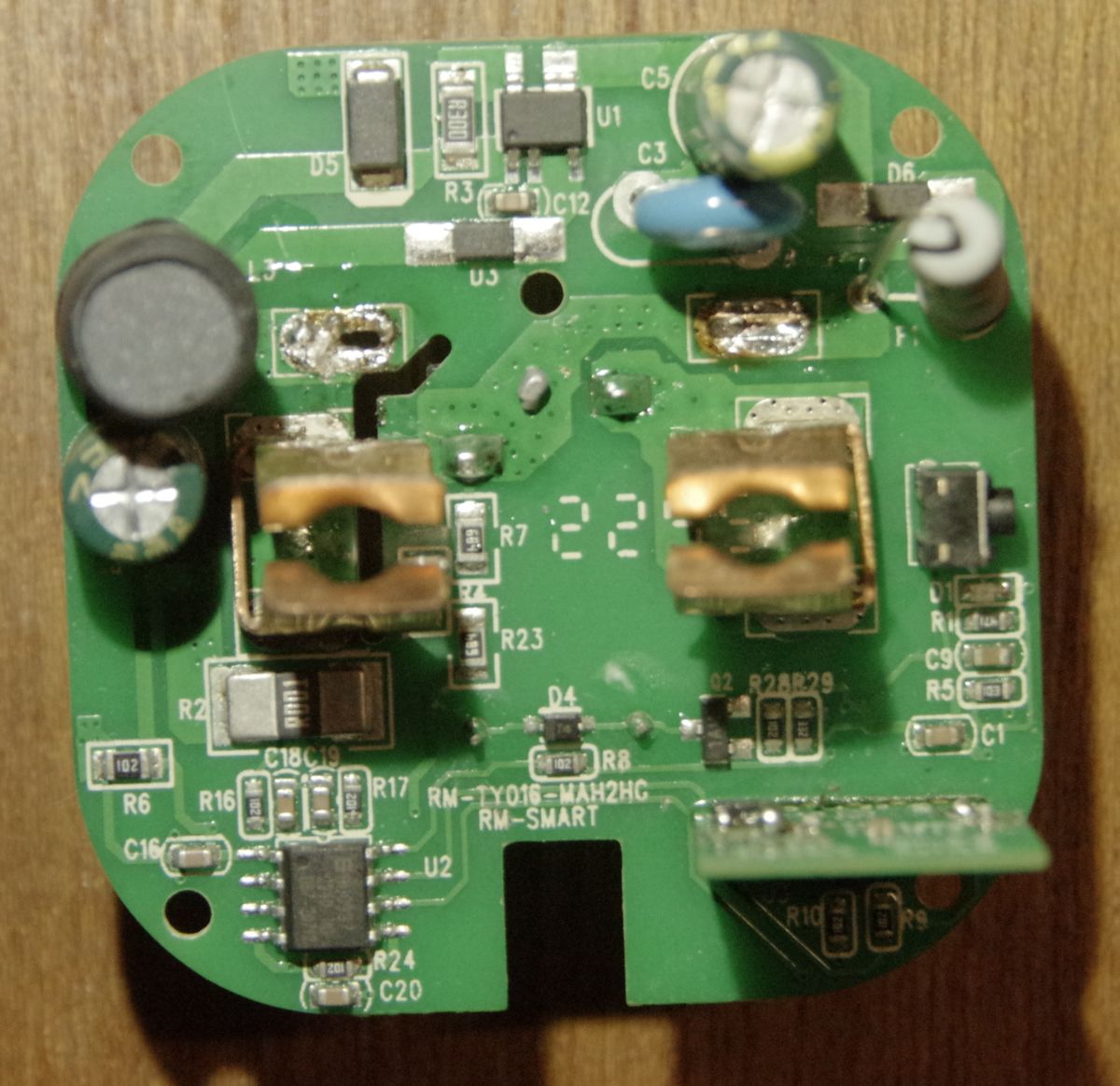

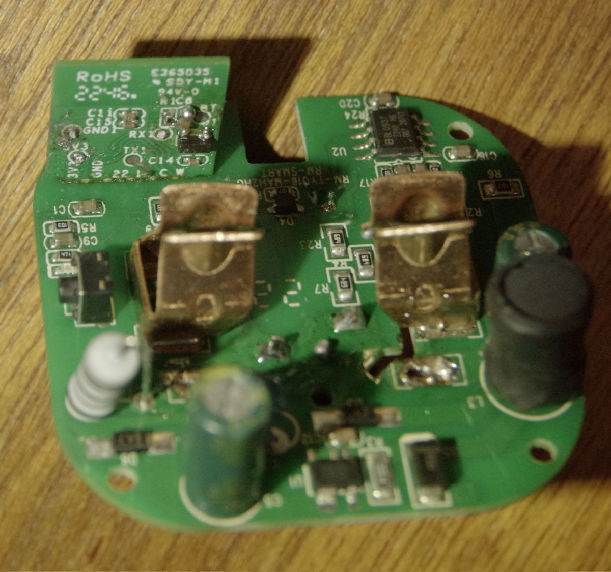

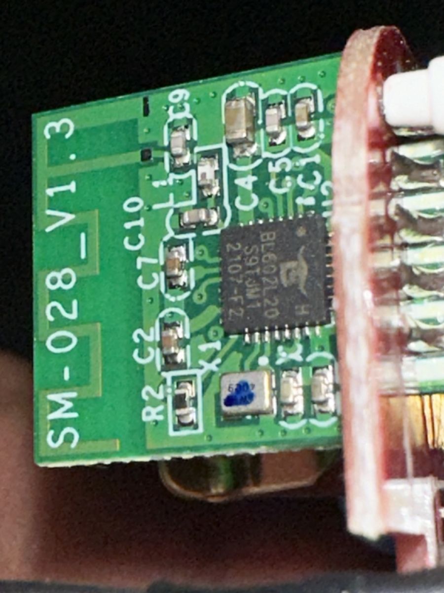

    Opening the plug is relatively straightforward. In order to get the PCB off the plug I had to de-solder it from the 2 connections to the pins of the plug. After that the PCB with relay could easily be removed.
    Closer inspection showed that the plug contained a BL602 board and a BL0937 IC for the energy monitoring. The power for the PCB seems to be supplied by a BP2525 IC. (I was unable to get the IC markings clearly visible on the pictures, using magnification the markings were clearly visible).

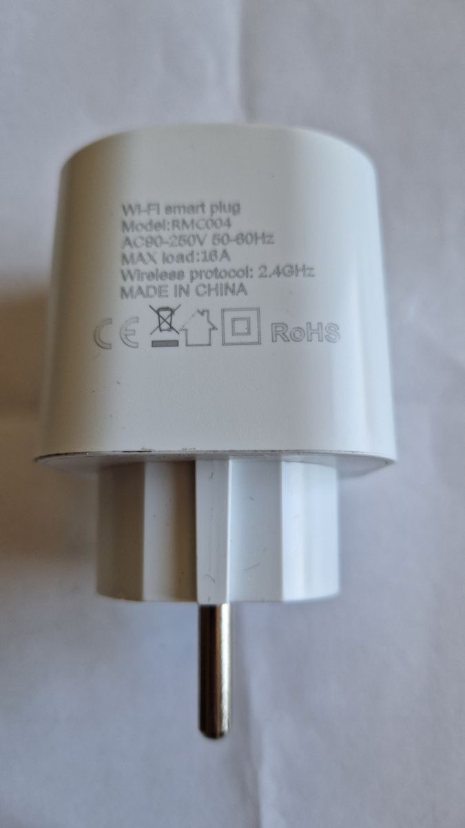

    Another thing to notice is that the relay seems to be for 16A max whereas the plug is rated for 20A max. As a result I think the plug should not be used with >16A, or am I overseeing something there?
    Flashing with the BL602 firmware seems to work, but configuration is necessary and at this moment the BL0937 energy monitoring does not seem to function. Following the traces on the PCB and checking continuity with a multi meter I found the following "configuration":
    LED: pin 29 on the BL602, so GPIO20
    Relay; P2, so GPIO2
    Button: pin 31 on the BL602, so GPIO22
    BL0937 CF1: pin4 on the BL602, so GPIO3
    BL0937 CF: pin 22 on the BL602, so GPIO14
    BL0937 SEL: pin 30 on the BL602 so GPIO21
    as mentioned above at this moment this pin assignments work for LED, relay and button, but the BL0937 does not show up at all.

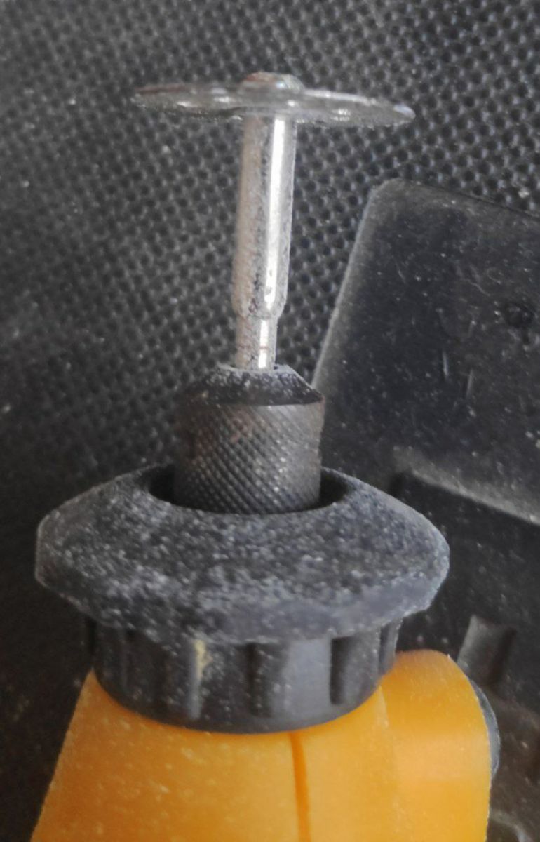

    I used a dremel-like tool and a diamond cutting disc on medium speed:
    [BL602] Elivco smart plug with energy monitor BL0937 RMC004
    If you don't have such a tool on your hands you can do this with a thin saw (or even a blade from it, if you don't have a saw - should be cheap to buy) for metal works <1mm thickness . And of course the overall look will suffer a bit in the end. So, having a cold heart and sharp mind:
    1. Fix the socket in a vise or something like it by the body.
    2. Step around 1.5 mm from the edge.
    3. Do a careful 360 degree cut about 1.5mm depth maximum (be careful not to damage anything inside).
    4. Volia!
    Then simply clean edges from excess plastic pieces with a sharp knife, do your stuff inside, and use anything you want to seal it back: super glue, hot glue, white silicone glue, epoxy resin etc. to fix it up (even a duct or insulating tape, but that will look brutal :) )

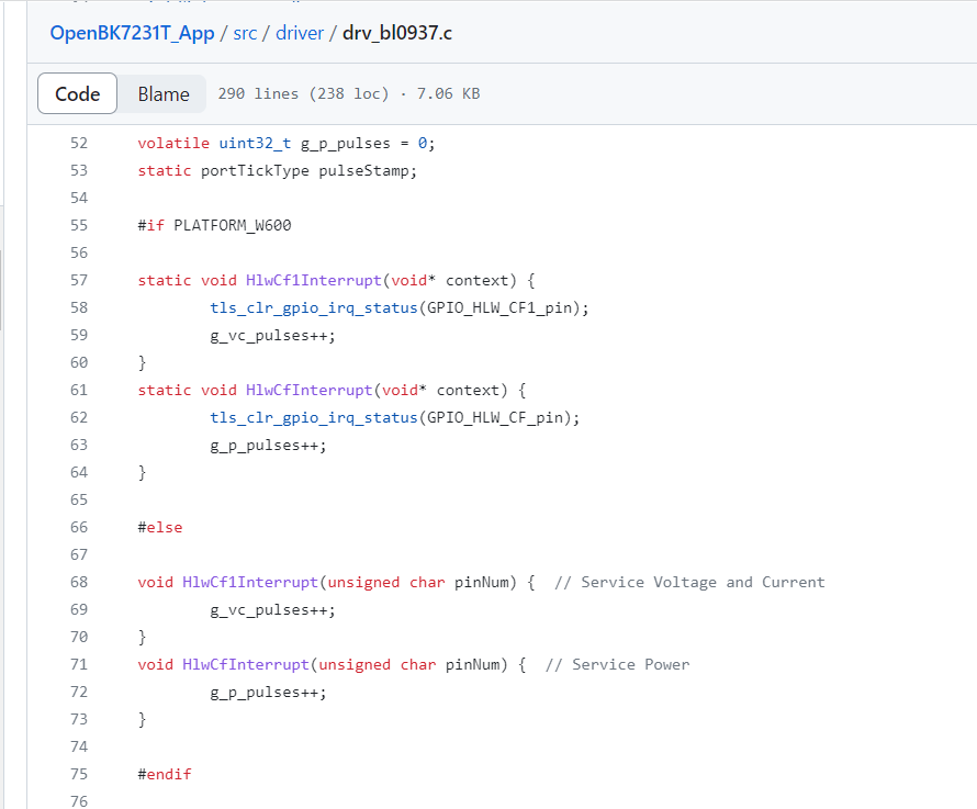

    Thank you for pinging me @P0intLess , I haven't seen this reply. Unfortunately, the BL602 interrupt counter is still not finished. I looked at that some time ago and it turned out to be somewhat problematic and didn't have time to check it since then. If you have a BL602 device, and some basic knowledge, you can just fork OBK and edit our driver:
    https://github.com/openshwprojects/OpenBK7231T_App/blob/main/src/driver/drv_bl0937.c , those calls must be working:

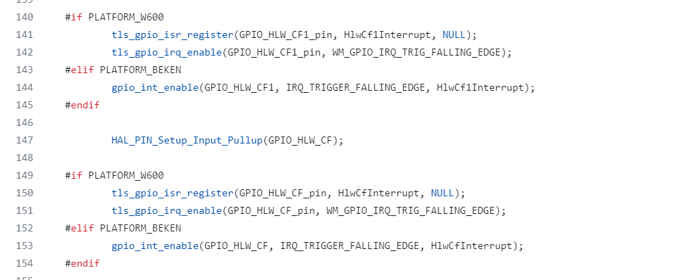

    Here you need to add #ifdef PLATFORM_BL602 and a proper interrupt on GPIO change:
    Basically you need an "on change interrupt" for both CF and CF1 pins, so both functions are called.
    You don't need to worry about compiling. If you do your own fork of OBK on Github, you will get online builds for all platforms, so you can just download new binaries for each test.
    I don't have currently a working BL602 board, it has died some time ago when I tried to figure our a method to change MAC address of the device and the queue of things TODO is currently a bit long so on my side BL602 interrupts will have to wait, but you can try if you want. It shouldn't be hard and it most likely won't break anything.

    You can look at OpenBL602 SDK:
    https://github.com/openshwprojects/OpenBL602
    Search for, for example, IRQ_TRIGGER_RISING_EDGE
    https://github.com/openshwprojects/OpenBL602/...components/fs/vfs/include/hal/soc/gpio.h#L123
    Maybe that could work?
    Code: C / C++
    Of course now that brings the question what is gpio_dev_t ....
    Code: C / C++
    So you would need to do something like:
    Code: C / C++
    maybe something like that could work, I could do another attempt with that for you, but it doesn't change the fact that I don't have BL602 device to test. Do both of you have BL602 + BL0937 combo?

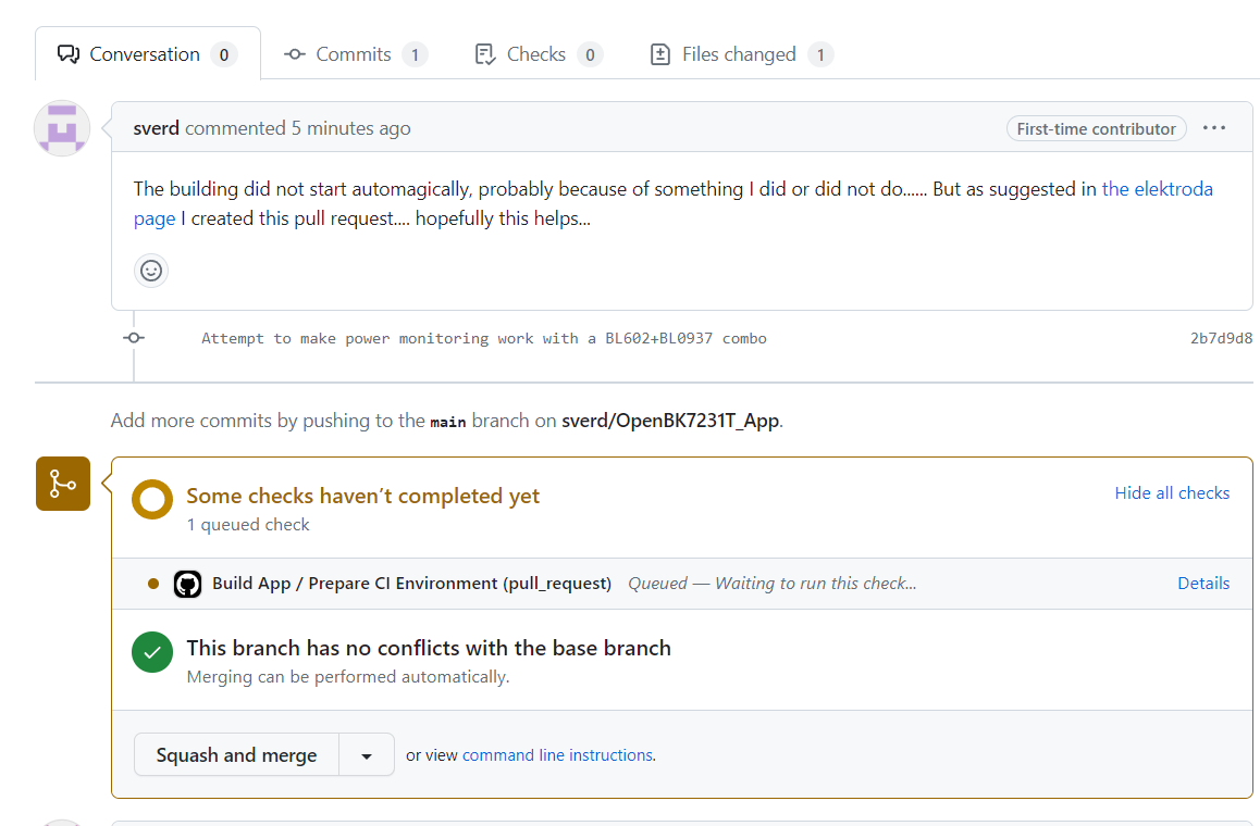

  • #22 20629558
    sverd2
    Posts: 8
    Maybe the problem is with my Github account? I did get some popups about enabling building/making the project for new users/forks. I think I enabled everything but maybe this is causing things not the build automatically. As suggested I did issue the pull request, may be that helps.
  • #23 20629562
    Posts: 14797
    Rate: 12954
    It should build soon:

    The automagic building started to work. I'm not sure why, but at least it is working. I did manage to get things to compile after a few attempts. However, now I am getting "undefined references" to hal-functions. So it seems libhal_drv.a is not included in the linking step... I somehow did not manage to figure out how to add this library in the build system. Do you maybe have some tip/hint for that?

    Bought some cheap sockets from AliExpress Elivco store (in March 2023), with the intention to cut from the cloud.
    This one is a 16A smart socket marked RMC004.
    Close-up of Elivco RMC004 smart socket with technical label.
    It has firmware V1.1.8, and so BK7231N chip. Flashed with cloudcutter. Config is different than before:

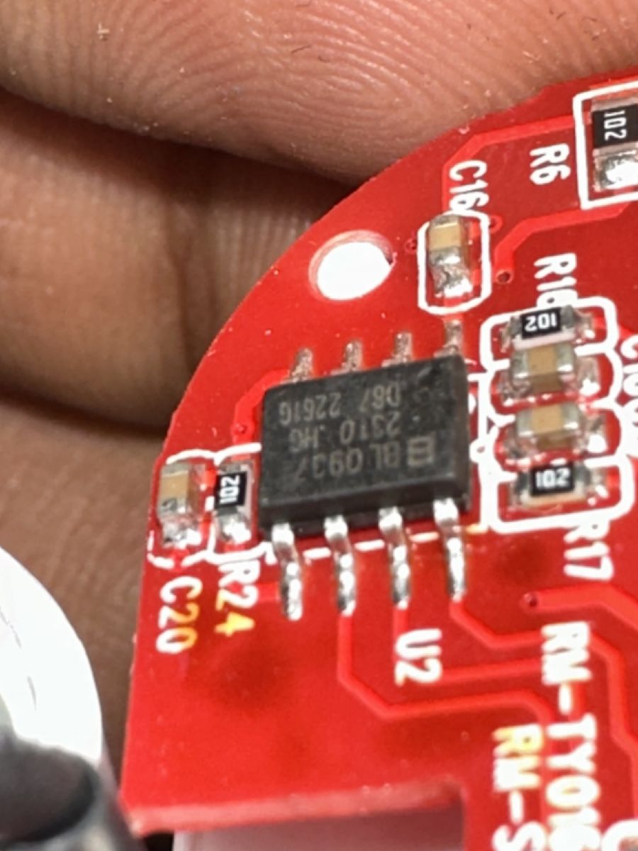

    I just received a smart-plug from Aliexpress that is ewelink branded with BL602 and BL0937 combo. I am not technically great with embedded stuff, but is there a chance that I can get this to work with OpenBeken or ESPHome - Libertiny?
    Close-up of a smart plug circuit board with a visible BL0937 chip. Close-up of a smart plug circuit board with markings and components.
  • #29 20726027
    Posts: 14797
    Rate: 12954
    ESPHome does not support that hardware and I do not recommend that. OpenBeken works ok on many platforms, including BL602:
