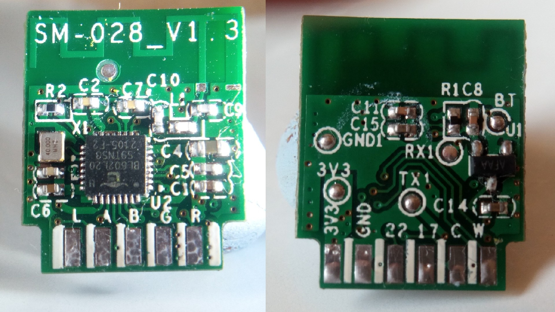

I put here a description of the pins of smart relays with the WiFi / Bluetooth BL602 Bouffalo Lab module. The basic module is the TROLINK SM-028_V1.3 BL602L20, it is used in the QIACHIP KR05-1CHKG-W relay and in the QIACHIP KR0548-2CH-W relay. Most likely, they are used by the entire series, i.e. the KR05-1CH, KR0548-1CH, KR0548-2CH and KR0548-4CH models. Without changing the firmware, they work with the eWeLink application, uploading OpenBeken allows you to free them from the cloud. These relays here are available to buy without a housing, it is the so-called. "DIY" version, they are additionally powered from USB - 5V.
The materials collected here were sent to me by one of the US users on Github. I'm posting them here at his request. Thank you!
Here is the module itself - pins probably inspired by TYWE2S from ESP8266 (and also WB2S, CB2S and so on)
LABEL GPIOs PIN
L GPIO_1 2
AND GPIO_4 5
b GPIO_20 29
g GPIO_14 22
R GPIO_3 4
22 GPIO_22 31
17 GPIO_17 28
c GPIO_21 thirty
In GPIO_2 3
The pins of the integrated circuit itself, QFN housing:
The UART port used for logging (and for programming) here are the P16 (TX) and P7 (RX) signals, they are on the back of the module, loose. There is also a BT signal that allows you to start programming mode, as in my topic:
https://www.elektroda.pl/rtvforum/topic3889041.html
The log baud on this platform is 2000000.

QIACHIP KR05-1CHKG-W (SM-028_V1.3 BL602L20)
To buy on various Chinese portals, not always with the given model:
Connection:
Photo of what it looks like in reality, from the user:
Roles of individual pins (for use with OpenBeken):
Btn -> GPIO_14 (G)
Rel -> GPIO_20 (B)
WifiLED_n -> GPIO_22 (22)
QIACHIP KR0548-2CH-W (SM-028_V1.3 BL602L20)
There are even more results here, it's a bit easier to find this product under "KR0548-2CH-W". Even on the Qihip website:
Other portal:
Btn(1) -> GPIO_20 (B)
Rel(1) -> GPIO_21 (C)
Btn(2) -> GPIO_4 (A)
Rel(2) -> GPIO_17 (17)
WifiLED_n -> GPIO_14 (G)
