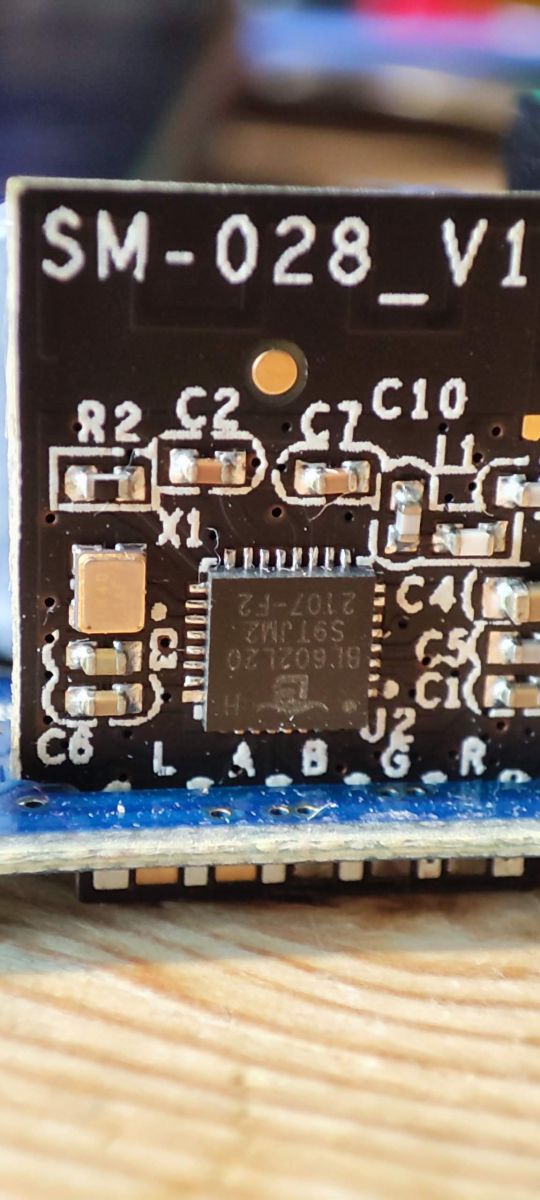

    SM-028_V1.3 BL602L20
    Here is the module itself - pins probably inspired by TYWE2S from ESP8266 (and also WB2S, CB2S and so on)
    [BL602] IoT relay series on BL602, SM-028_V1.3, KR0548-2CH-W, KR05-1CH
    LABEL GPIOs PIN
    L GPIO_1 2
    AND GPIO_4 5
    b GPIO_20 29
    g GPIO_14 22
    R GPIO_3 4
    22 GPIO_22 31
    17 GPIO_17 28
    c GPIO_21 thirty
    In GPIO_2 3
    The pins of the integrated circuit itself, QFN housing:
    The UART port used for logging (and for programming) here are the P16 (TX) and P7 (RX) signals, they are on the back of the module, loose. There is also a BT signal that allows you to start programming mode, as in my topic:

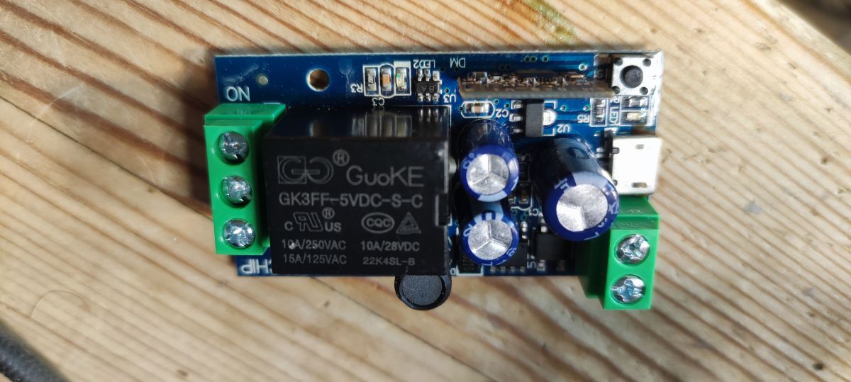

    Photo of what it looks like in reality, from the user:
    Roles of individual pins (for use with OpenBeken):
    Btn -> GPIO_14 (G)
    Rel -> GPIO_20 (B)
    WifiLED_n -> GPIO_22 (22)

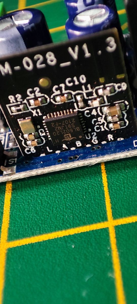

  • Asking if BL602 module can be swapped for TYWE2S
    #5 20364093
    michaeljuniper
    Hi, I have a smart switch.
    As you can see it stated eWeLink compatible so I assumed (foolishly!) it had an ESP chip inside.
    It does not, but has a BL602L20 chip mounted on a SM-028_V1.3 BL602L20 module.
    I would like to replace the SM-028_V1.3 BL602L20 with an ESP based module (TYWE2S) that I can then flash with Tasmota.
    Given your knowledge of these modules, is it just a case of desoldering the SM-028_V1.3 BL602L20 module and replace it with the ESP module?
    Then flash with Tasmota.
    I have two switches so I shall try OpenBK7231T/OpenBeken on the other one and compare.
    Thanks in advance for you help.

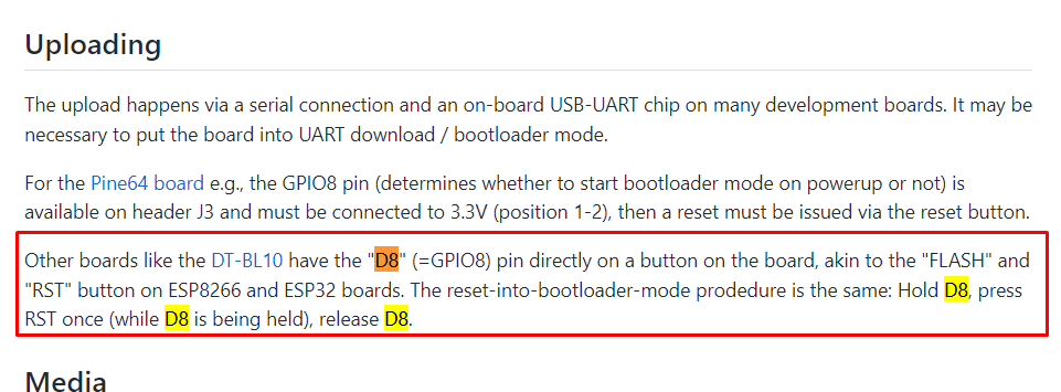

    Hi, I have flashed many ESPs but this is my first BL602. I dont get what pad does this mean?
    "BOOT from the module to the 10k resistor to the power supply"
    So, what pad/pin on BL602 / SM-028 is this "BOOT"?
  • #9 20380423
    Posts: 14755
    Rate: 12880
    Hello @mikkojordman . According to my knowledge, the BOOT pin on BL602 is D8.
    Instructions for handling the D8/GPIO8 pin on the DT-BL10 board.

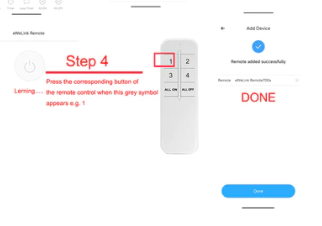

    I would like to pair the Remote Control . What is the process ?
    Thank you
  • #11 20493250
    Posts: 14755
    Rate: 12880
    Hello, what kind of remote control, and which device?

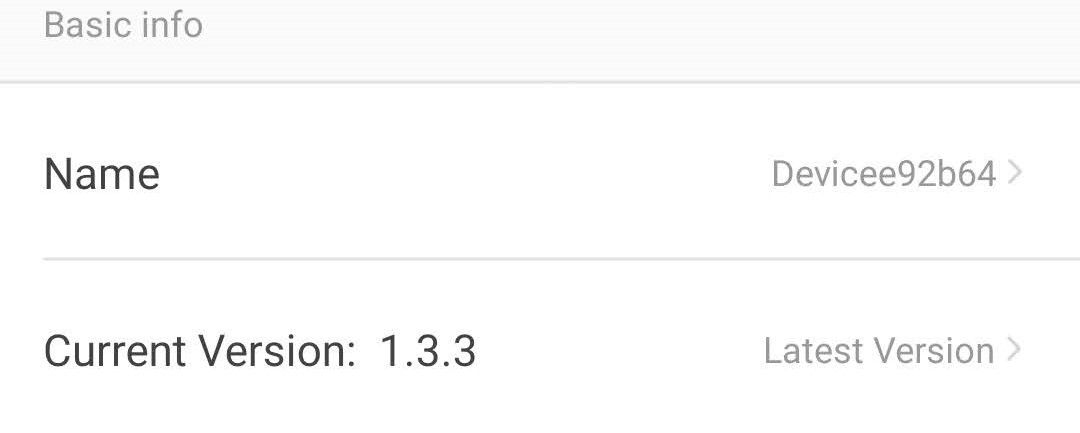

  • OpenBeken GPIO map for relays and buttons
    #12 20493470
    ipadbendavid
    Hi
    I have successfully installed the OpenBeken. Its is working very well to control the 2 relays and 2 the buttons. But i don't how to add a Receiver for the Remote control / and to pair it.
    Here the remote type. on the image below. on Weelink App , you can add a remote to control the Switch. It has 6 buttons (1, 2, 3, 4 all on and All off).
    Instructions for pairing an eWeLink remote with a device.
    Added after 8 [hours] 45 [minutes]:

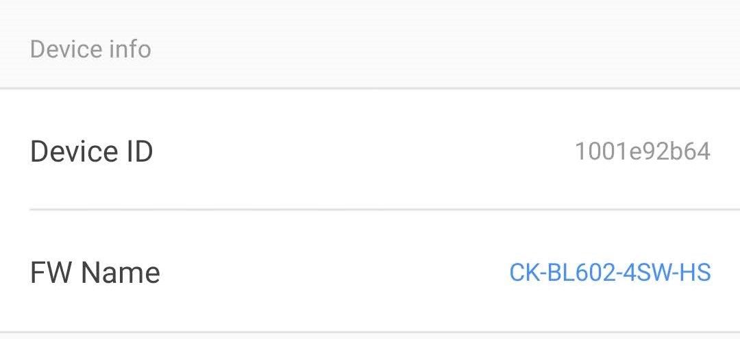

    [17:00:19.067] - Starting bl602 now....
    ############################## system init ##################################
    Device Info:[Firmware Name:<FWSW-HSBL602-SWITCH-BL602L_v1.3.0>,Build Time:<20220412.141107.766>,Boot Reason:<BL_RST_POWER_OFF>]
    [17:00:19.175] - 鴟|>|   8>`虁鴟||   8`虁鴟
    [17:00:19.283] - ||  8 8`虁
    [17:00:19.392] - > 8 |  8 鄚鎩
    [17:00:19.503] -  > |  8 鄚鎩   8 |  > >鄚苵 8
    [17:00:19.610] - cfg->led_status = 1
    Reading the dts file...
    And the GPIO config is :
    cfg->wifi_led = 14
    cfg->all_on_off = 200
    cfg->relay0 = 21
    cfg->relay1 = 17
    cfg->relay2 = 22
    cfg->relay3 = 2
    cfg->key0 = 20
    cfg->key1 = 4
    cfg->key2 = 1
    cfg->key3 = 3
    cfg->led_status = 1

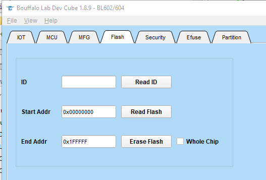

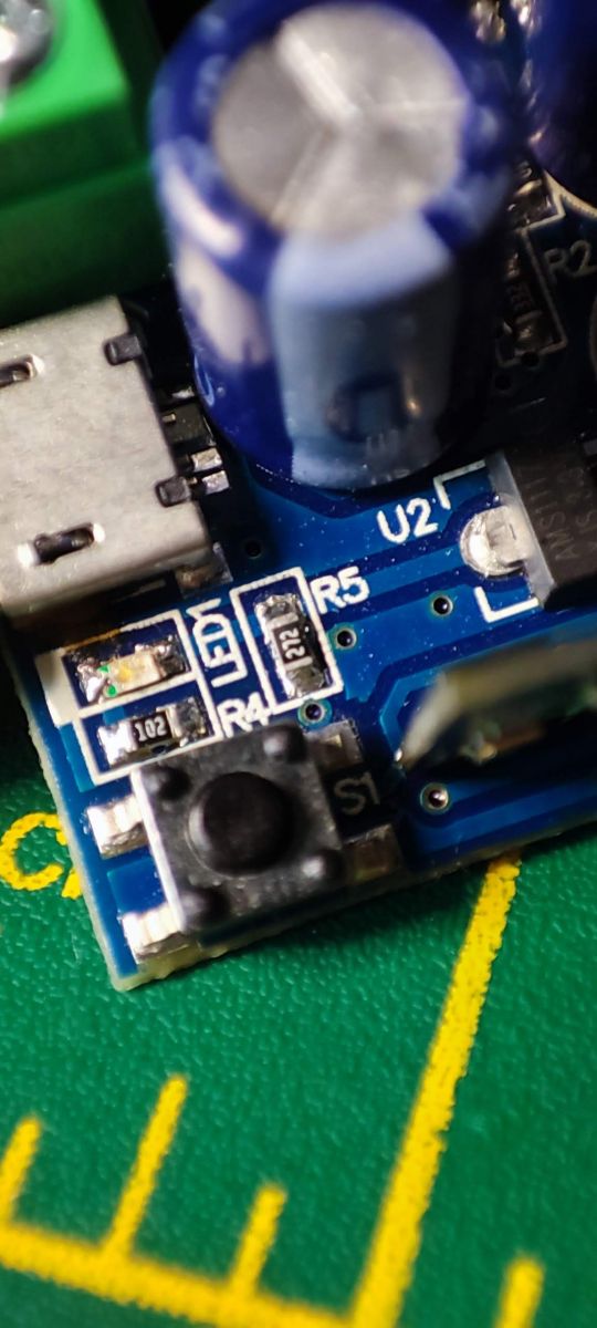

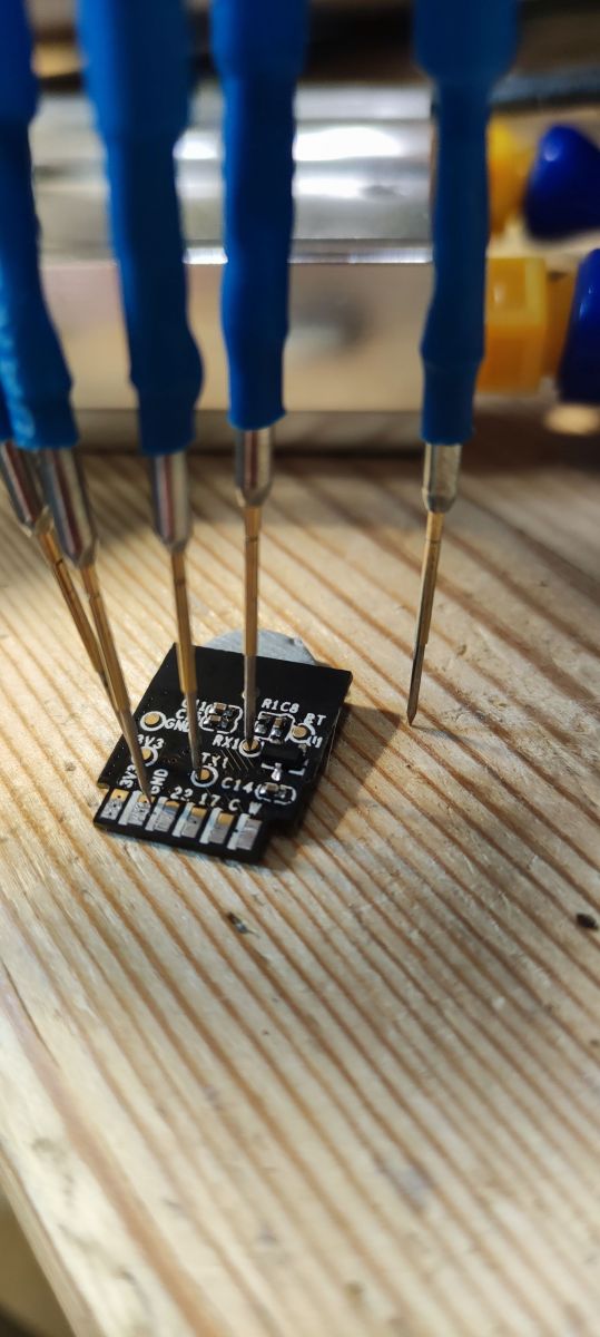

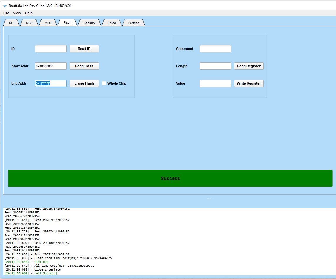

  • Ready-made BL602 bin causes reset loop
    #13 20905068
    Jekob
    >>20360406
    @p.kaczmarek2
    Good morning,
    I tried to use the ready-made OpenBL602_1.17.402.bin file from the repository and upload to the SM-028_V1.3 module soldered from some Chinese Mini switch. While the upload works, the module does not start properly, it resets all the time. Where to look for the cause? Tz is it possible to upload this ready-made bin or do you need to prepare your own.
    I attach the log from the serial port, the processor throws the same thing several times per second.
    • 20240112_test_bl602.txt (10.15 KB) You must be logged in to download this attachment.
  • Power supply may be causing BL602 resets
    #14 20905126
    Posts: 14755
    Rate: 12880
    @Jekob at first glance I'm not sure what could be going wrong. The log looks like it's booting up old soft, but I could be wrong, I haven't physically interacted with a lot of devices on the BL602. In general, the very beginning of the log is quite interesting:
    RISC-V Core Feature:RV32-ACFIMX
    Build Version:      release_bl_iot_sdk_1.6.22-22-g1d4ff804-dirty
    Std Driver Version: 541807d
    PHY   Version:      a0_final-73-g62481a0
    RF    Version:      79cc6b9
    Build Date:         Jan 11 2024
    Build Time:         15:54:32
    Boot Reason:        BL_RST_POWER_OFF
    Boot reason to power off - could it be a power problem?
    Although I'm looking at it now, build date is January 11, 2024, so maybe something was uploaded....
    There was already a similar situation on the forum, and it turned out that someone was powering the module from some weak power supply or directly from the 3.3V pin from the USB to UART converter, causing the module to reset after a while.
    Can you show how you power the module, some pictures?
    A fairly efficient 3.3V source can be found on board the NodeMCU or Arduino UNO, for example.

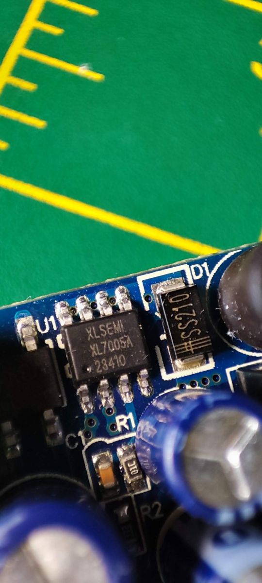

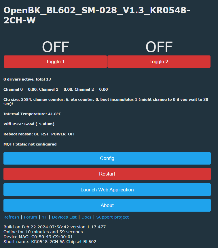

  • #15 20905200
    Jekob
    @p.kaczmarek2 Wise is and nice to listen to
    I hooked up the Korad KD3005D, which indicates current draw varying between 55 and 65mA and the module seems to work, i.e. AP appeared
    Thank you very much.
  • #16 20905218
    Posts: 14755
    Rate: 12880
    So that's it after all... in that case, I guess I'll add this problem to the FAQ, since it's not the first time I've seen it on the forum. I'll update https://github.com/openshwprojects/OpenBK7231T_App/blob/main/docs/faq.md right away

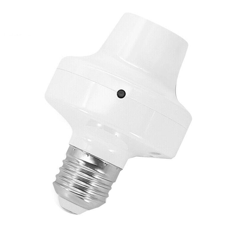

    Thank you for this great project. I use it for my E27 bulb socket relay
    https://www.ebay.de/itm/314264464569
    It has the same pinout as the QIACHIP KR05-1CHKG-W relay.
    Btn -> GPIO_14 (G)
    Rel -> GPIO_20 (B)
    I use simple web query commands like "http://192.168.xxx.yyy/cm?cmnd=Power%20Off" so far, but I could'nt figure out, how to set a sleep timer. Is there a command to switch on the bulb for 20 minutes, then switch off automatically?
    regards

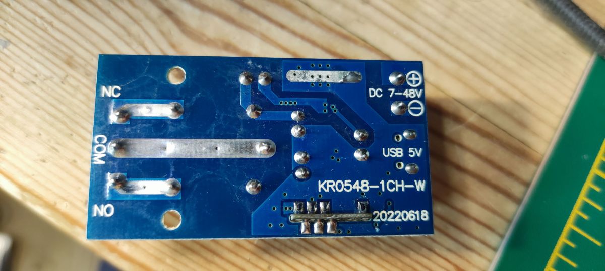

  • KR0548-1CH-W boot log and GPIO mapping
    #28 20987133
    Posts: 5212
    Help: 446
    Rate: 914
    I just got round to trying the KR0548-1CH-W I bought a while ago.
    Boot log from BL602.
    [10:11:46.743] - Starting bl602 now....
    Device Info:[Firmware Name:<FWSW-HSBL602-SWITCH-BL602L_v1.3.3>,Build Time:<2022061
    [10:11:46.745] - 4.144049.148>,Boot Reason:<BL_RST_POWER_OFF>]
    [10:11:47.338] - cfg->led_status = 0
    cfg->wifi_led = 22
    cfg->relay0 = 20
    c
    [10:11:47.340] - fg->relay1 = 200
    cfg->relay2 = 200
    cfg->relay3 = 200
    cfg->key0 = 14
    cfg->key1 = 200
    cfg->key2 = 200
    cfg->key3 = 200
    cfg.led_status = 0
    cfg->led_status = 0
    cfg->wifi_led = 22
    cfg->relay0 = 20
    cfg->relay1 = 200
    cfg->relay2 = 200
    cfg->relay3 = 200
    cfg->key0 = 14
    cfg->key1 = 200
    cfg->key2 = 200
    cfg->key3 = 200
    cfg.led_status = 0

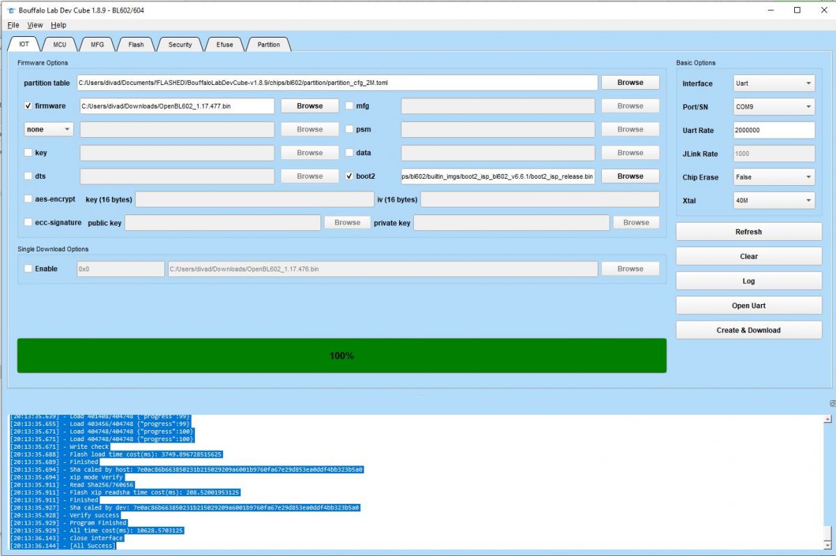

    and finally quite a successful flash using solely the latest Dev Cube, latest partition and boot2 files (!). I dispensed with the breadboard and connected power/ground using wagos. I also bumped the PSU up to 3.5v.
    flash was successful using a Prolific 2303 and 100000 baud in BLDC. I also made sure the device was pairing (with EweLink app) (as a desoldered module powered externally) and not boot looping BEFORE I flashed OBK. Then after flashing OBK the AP appeared without issue.
    Bouffalo Lab Dev Cube 1.8.9 interface with loaded firmware
    whole 2mb flash was dumped, attached
    Bouffalo Lab Dev Cube interface with Flash tab

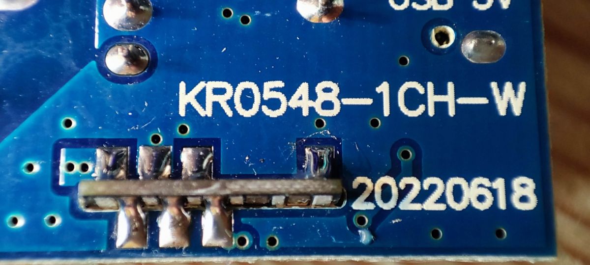

    to complete the template @stancecoke posted https://www.elektroda.com/rtvforum/topic3945435.html#20909803

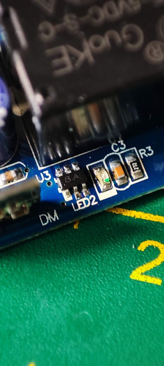

    I went with wifi (not _n) so the behaviour is that the blue LED is flashing on wifi connecting then off when connected. The red LED (not controllable) comes on with the relay in one of the positions anyway.

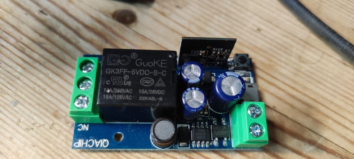

    various pics
    Close-up of a circuit board labeled SM-028_V1.3 with electronic components. Image of an electronic circuit board KR0548-1CH-W with visible solder connections and the number 20220618. KR0548-1CH-W PCB with labeled connectors and traces. Printed circuit board with electronic components and a relay. Qiachip relay module with electronic components. Close-up of a circuit board labeled SM-028_V1 with integrated circuits and other electronic components. Printed circuit board with connected test probes on a wooden surface. Close-up of electronic components on a circuit board, including an XLSEMI XL7005A chip and an SS210 diode. Close-up of electronic components on a circuit board. Close-up of a circuit board with electronic components. Screen snippet displaying the device software version information. Screenshot showing device information including Device ID and FW Name.
    • flash.bin (2 MB) You must be logged in to download this attachment.

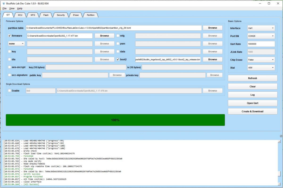

    I'm on a roll with the BL602s now. Today I did the 2-channel version of the above, same as the OP - KR0548-2CH-W.
    Same process as my previous post but this time the SM-028_v1.3 was happy at 3.4v. no boot loops at any point. dump of factory flash and flash to OBK at first attempt.
    Here is original boot log
    Here is flash ID get using BLDC 1.8.9
    Screenshot of BouffaloLab Dev Cube showing flash success.
    here is visual flash of OBK success then the text output of flash log
    Bouffalo Lab Dev Cube 1.8.9 interface during BL602 programming.
    and finally the log out of OBK itself after flash
    Control panel of OpenBK for dual-channel device with BL602 chipset.
    pin config used from existing device list entry
    This was flashed at 2000000 baud and with an FTDI USB TTL
