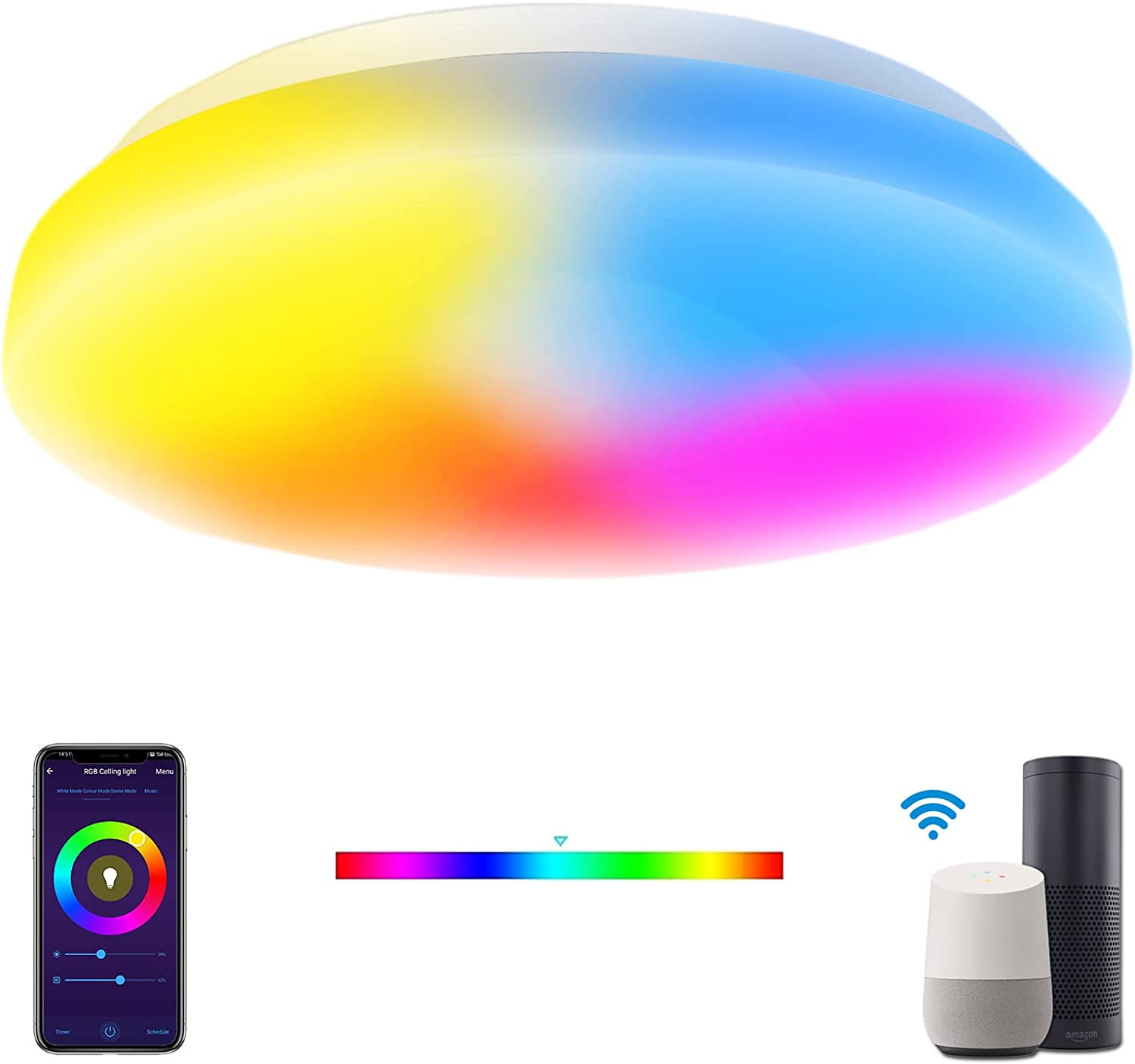

This is a short teardown and flashing guide for ANTELA ceiling lamp PLAFONIERA 20W
Wenkman - 20.01.2023
Brand: Immax
Model: ‎AN-EU-CL260-WIFILIC-RGBCW-TD-01
Chip: BK7231N
LED Driver: SM2235EGH
Shop: Amazon
I searched Amazon for a ceiling light made by Tuya, found the above, ordered it, arrived 10 days later and immediately disassembled it.
I quickly found the "3.3V,GND,RX,TX" pins on the underside, but still wanted to try the tuya-cloudcutter first.
first connected the lamp to the SmartLive app to find out the current firmware
Then immediately disconnected the lamp again.
I have now followed this guide again.
I pulled the current firmware for the BK7231N from Github
wget https://github.com/openshwprojects/OpenBK7231T_App/releases/download/1.15.344/OpenBK7231N_UG_1.15.344.bin
and then started the flashing with the start command:
sudo ./tuya-cloudcutter.sh -w wlan0
After flashing, you should definitely check which version was installed, it must be at least 1.15.345
otherwise update under OTA
after that define the pins
P24: SM2235DAT
P26: SM2235CLK
now just create an autoexec.bat and add the following code (for BGRCW customization).
SM2235_Map 2 1 0 3 4
then just confirm with the button "Save, Reset SVM and run file as script thread" and the lamp is ready.
I hope I could help someone with this.
