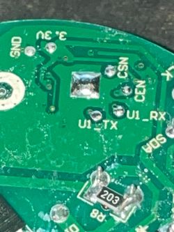

    I searched Amazon for a ceiling light made by Tuya, found the above, ordered it, arrived 10 days later and immediately disassembled it.
    [BK7231N/SM2235] RGBCW ANTELA Alexa Deckenlampe LED WiFi 20W (Immax) with SM2235EGH LED driver [BK7231N/SM2235] RGBCW ANTELA Alexa Deckenlampe LED WiFi 20W (Immax) with SM2235EGH LED driver [BK7231N/SM2235] RGBCW ANTELA Alexa Deckenlampe LED WiFi 20W (Immax) with SM2235EGH LED driver [BK7231N/SM2235] RGBCW ANTELA Alexa Deckenlampe LED WiFi 20W (Immax) with SM2235EGH LED driver
    I quickly found the "3.3V,GND,RX,TX" pins on the underside, but still wanted to try the tuya-cloudcutter first.

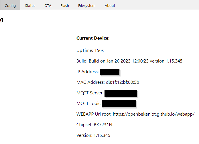

    After flashing, you should definitely check which version was installed, it must be at least 1.15.345
    otherwise update under OTA

    now just create an autoexec.bat and add the following code (for BGRCW customization).
    SM2235_Map 2 1 0 3 4
    then just confirm with the button "Save, Reset SVM and run file as script thread" and the lamp is ready.
    I hope I could help someone with this.
