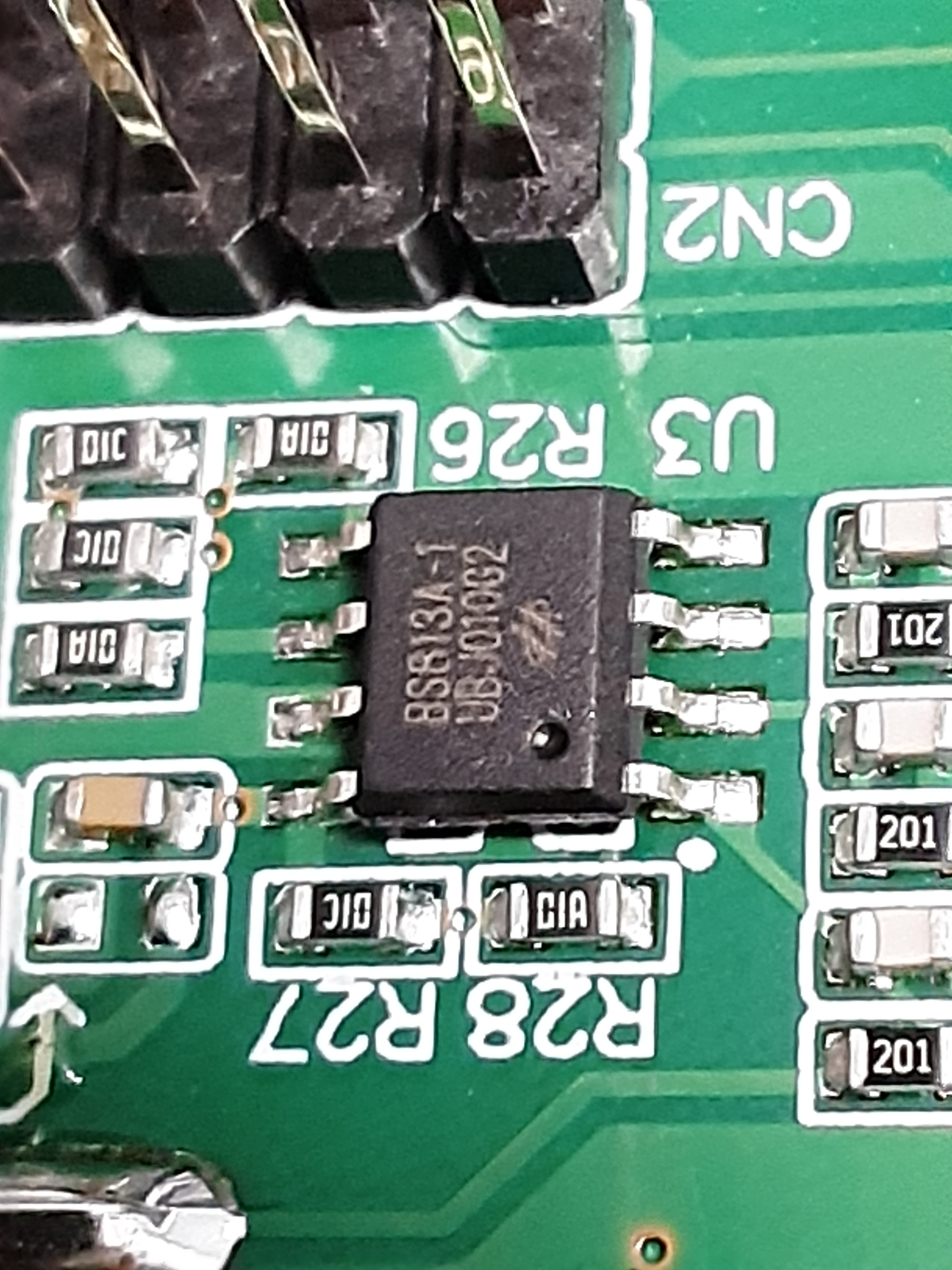

p.kaczmarek2 01 Mar 2023 11:36
Hello, the first thing to do would be to check if it's really TuyaMCU or not. I doesn't look like TuyaMCU. 1. Does removing the config from autoexec.bat for you changes anything? 2. With TuyaMCU config,... [Read more]
wolfieeewolf 02 Mar 2023 06:13
I think I agree with you that there is no TuyaMCU on board. 1. Does removing the config from autoexec.bat for you changes anything? I added the code to the autoexec.bat to see what it would do... [Read more]
