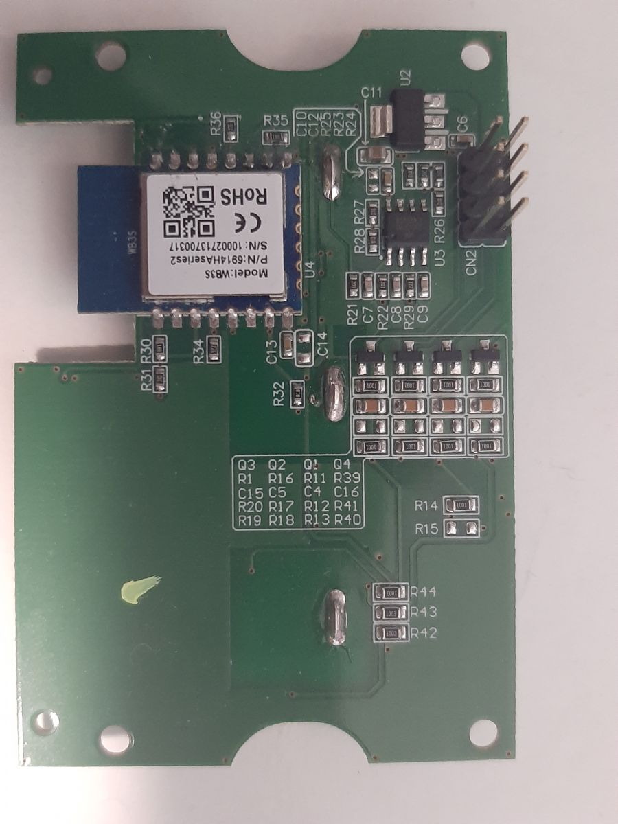

  • The Deta Grid Connect Smart Fan Speed Controller with Touch Light Switch 6914HA uses a WB3S module based on the BK7231T chip.
  • It was manually flashed with the BK7231 GUI Flash Tool, then configured with autoexec.bat to map fan relays, touch buttons, and the WiFi LED.

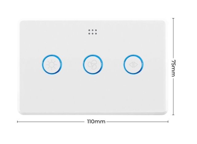

  • Bought from Bunnings Warehouse for $59.36AUD, the unit exposes separate light, min, mid, and max fan control channels plus a 3-step fan selector.
  • The relays and buttons behaved like the original firmware, all fan speeds worked, and Home Assistant MQTT entities were set up for the light and fan.

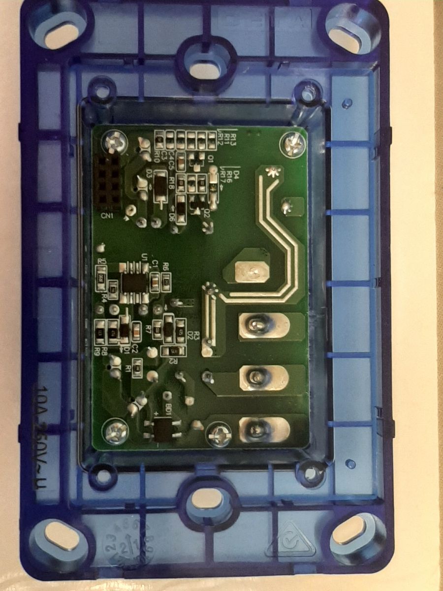

  • Device Name: Deta Grid Connect Smart Fan Speed Controller with Touch Light Switch - 6914HA
    Device Type: Fan and Light switch
    Device Chip: WB3S - BK7231T
    Device Purchased: Bunnings Warehouse - $59.36AUD
    Deta Grid Connect Smart Fan Speed Controller with Touch Light Switch - 6914HA - Teardown Deta Grid Connect Smart Fan Speed Controller with Touch Light Switch - 6914HA - Teardown Deta Grid Connect Smart Fan Speed Controller with Touch Light Switch - 6914HA - Teardown Deta Grid Connect Smart Fan Speed Controller with Touch Light Switch - 6914HA - Teardown Deta Grid Connect Smart Fan Speed Controller with Touch Light Switch - 6914HA - Teardown Deta Grid Connect Smart Fan Speed Controller with Touch Light Switch - 6914HA - Teardown Deta Grid Connect Smart Fan Speed Controller with Touch Light Switch - 6914HA - Teardown Deta Grid Connect Smart Fan Speed Controller with Touch Light Switch - 6914HA - Teardown Deta Grid Connect Smart Fan Speed Controller with Touch Light Switch - 6914HA - Teardown

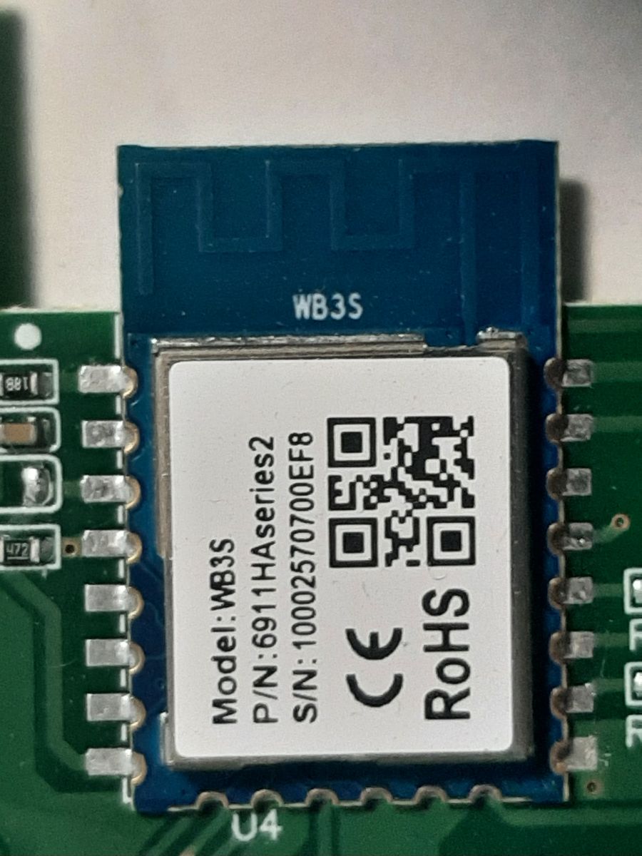

    Flashing of Main Chip
    Manually flashed the chip with BK7231 GUI Flash Tool.
    WB3S Module Datasheet
    Configuration of Module
    PinChTypeDescription
    P1Ch4Btn_ScriptOnlyFan Button (Middle)
    P6Ch2RelFan MIN speed, turns on 1 of 3 LEDs around the Arrow Button (right led).
    Pin active on all fan speeds. Turns on fan button LED
    P7Ch3RelFan MIN speed, turns on 1 of 3 LEDs around the Arrow Button (top led)
    P8Ch10Btn_ScriptOnlyArrow Button (Right)
    P9Ch4RelFan MAX speed, turns on 1 of 3 LEDs around the Arrow Button (bottom led)
    P10Ch0WifiLED_nWifiLED_n - White LED on when Wifi is connected or WifiLED - White LED on when Wifi is disconnected
    P14Ch1Btn_ScriptOnlyLight Button (Left)
    P26Ch1RelLight Relay. Turns on light button LED

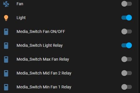

    So far all the relays/buttons are working the same as the original firmware and I'm able to set all the fan speeds.

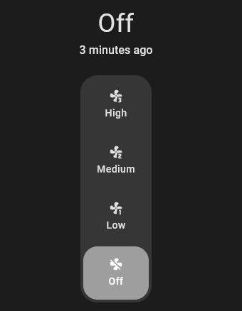

    To set up the MQTT script in home assistant use the following
    mqtt:
      light:
      ### Bedroom Light #####################
        - unique_id: bedswitch_relay_1
          state_topic: "bedswitch/1/get"
          command_topic: "bedswitch/1/set"
          qos: 1
          payload_on: 1
          payload_off: 0
          retain: true
          availability:
          - topic: "bedswitch/connected"
      fan:
      ### Bedroom Fan ##########################
        - unique_id: "bedswitch_Channel_10"
          state_topic: "bedswitch/5/get"
          command_topic: "bedswitch/5/set"
          percentage_state_topic: "bedswitch/10/get"
          percentage_command_topic: "bedswitch/10/set"
          qos: 1
          payload_on: 1
          payload_off: 0
          speed_range_min: 1
          speed_range_max: 3
          retain: true
          availability:

    WB3S likely not using TuyaMCU
    #2 20464179
    Posts: 14791
    Rate: 12937
    Hello, the first thing to do would be to check if it's really TuyaMCU or not. I doesn't look like TuyaMCU.
    1. Does removing the config from autoexec.bat for you changes anything?
    2. With TuyaMCU config, in Launch Web Application -> Logs, do you have any TuyaMCU packets received?
    3. Is WB3S TXD1/RXD1 port connected somewhere on the board (check with multimeter or just look at the PCB), and if so, where?
    The configuration of the module looks like almost the module is doing everything, so there might be no TuyaMCU.
    Futhermore, when you consider the GPIOs of WB3S:
    15RXD1I/OUART1_RXD, which is used as a user-side serial interface pin and is connected to the P10 pin on the internal IC
    16TXD1I/OUART1_TXD, which is used as a user-side serial interface pin and is connected to the P11 pin on the internal IC
    RXD1 is P10, and you already listed P10 as LED control, so it's not possible that it's TuyaMCU.
    I will say that it currently looks like a non-TuyaMCU device. So TuyaMCU config won't help.

  • No TuyaMCU found on the board
    #3 20465515
    wolfieeewolf
    Posts: 93
    Help: 7
    Rate: 20
    I think I agree with you that there is no TuyaMCU on board.

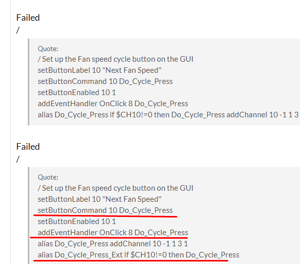

    I added the code to the autoexec.bat to see what it would do and it crashed the device on reboot. Had to ClearConfig to reset.
    I tried sending a few commands and gives little not nothing back in the log.
    I did some continuity testing with a multimeter and the TXD1 and RXD1 seem to run to the CH17M then to the BSB13A-1 then terminate on the top two CN2 header pins on the right. From some web searching it appears the chips are not TuyaMCU chips. Not that there was much info out there for them.
    I'm pretty now confident in saying that this device does not have a TuyaMCU.
    I have tried to get the scripts to work but I'm not overly confident in this stuff and couldn't get them to do anything. From what I understand I need add the script to autoexec.bat. So far it just keeps crashing or nothing happens. I'm guessing because some of the code is not compatible.
    I guess I have to write my own script from what you have giving me. I think I understand what the script is trying to do and I just need to modify it to work with my device. Will keep trying. I'm sure I'll work it out.

    Hope this helps. Have done some testing with changing pin channels and I feel that what i have below is 99.9% correct.
    I have been trying to do this via scripting, but I just have no idea where to start.
    Breakdown of what script should do
    Button 1 - Toggle light on/off
    Button 2 - Turn fan on/off - Set to Max when on
    Buttons 3 - Cycle Fan Speed - Max/Mid/Low - Needs to loop.
    What I know so far
    Relays
    Pin 26 - Light Relay - Channel 1
    Pin 6 - ? Main Fan Switch - This sets fan speed to lowest speed and turns on 1 of 3 smaller LEDs around the Arrow Button (right led).
    This pin needs to be active in all fan speeds. This pin also turns on the fan button LED - Channel 2
    Pin 7 - Turns fan to lowest speed and turns on 1 of 3 smaller LEDs around the Arrow Button (top led) - Channel 3
    Pin 9 - Turns fan to Highest setting and turns on 1 of 3 smaller LEDs around the Arrow Button (bottom led)- Channel 4
    When Fan Button is pressed it should turn on P6, P7 and P9 and when pressed again should turn off P6, P7 and P9
    The fan relays can be confusing but all 3 can be on at once. When P6 and P7 are both on at the same time it must supply a higher voltage which then increases the speed of the fan. You can turn P9 on by itself and it will go straight to max speed. However, when P9 is activated with P6 and P7 some kind of magic must be happening somewhere because it sets the speed to max and disregards whatever P6 and P7 are doing. It doesn't however turn on P6 and P7's LEDs.
    When Arrow Button is pressed it should turn on relays in this cycle
    High - P6, P7, P9 - Ch2, 3, 4
    Mid - P6, P7 - Ch2, 3
    Low - P6 - Ch2
    Button and Channels
    P8 - Light Button (Left) - Channel 1
    P14 - Fan Button (Middle) - Channel 2
    P24 - Arrow Button (Right) - Channel 3
    I do have P1 set as a button for P9 but there is no physical button. This was for the web interface so I could toggle P9. It does not need to be added to script.
    If you have a look at the Tasmota script it might give you a better idea of how it should work.
    https://templates.blakadder.com/deta_6914HA.html

    I run everything through Home Assistant and while a nice-looking gui is good, I don't really use it. I only have it that way for testing purposes to make sure the physical buttons are doing what they need to do. I could probably just get rid of the LowMidHigh as I can see the relays activating in the right order with the toggle buttons.
    My issue is that the cycling works fine when I click on the "Next Fan Speed" button on the gui but when it press the button on the physical device, it does something completely different.
    The "Fan ON/OFF" button on the gui will also only turn on/off Channel 4. It needs to turn on/off Ch2, 3 and 4.

    Maybe replace:
    alias Do_Cycle_Press addChannel 10 1 0 3 1
    with
    alias Really_Do_Cycle_Press addChannel 10 1 0 3 1
    alias Do_Cycle_Press if $CH4 then Really_Do_Cycle_Press
    because it seems that your $CH4 is POWER variable.

    I did try the changes you suggested while they did work they didn't work as I hoped.
    The Fan button now turns on/off relay channels 2,3 and 4
    The Fan cycle button cycles for high, mid, low and off.
    When you combine the two sections that's where I run into issues.
    Press Fan Button - Ch 2,3 and 4 turn on
    Then press Fan Cycle Button - Ch2,3 on, 4 off
    press Fan Cycle Button again - Ch2 on, 3 and 4 off
    Press Fan Button - Ch 2 off, 3 and 4 on.
    Fan Button just toggles Ch2, 3 and 4 on/off depending on their status. I tried to combat this by writing an If this then that type statement but I ended up having to do this for every combination possible and it just made for a messy hard to follow script that in the end didn't work.
    I did manage to get the Fan Cycle Button to only work when the Fan Button is on but with the above issue I left this out of the script because it just caused more problems then it was worth.
    I edited the script to make it a bit more understandable for me during the testing of the above. Looks messy and I know is not how things should be done but it works and I'm afraid if I mess with it again I'll just break it so I left it as is. I have updated the original post with the new script.
    New scripting below for post continuity

    addChangeHandler Channel10 == 0 backlog SetChannel 2 0; SetChannel 3 0; SetChannel 4 0; SetChannel 5 0
    addChangeHandler Channel10 == 1 backlog SetChannel 2 1; SetChannel 3 0; SetChannel 4 0; SetChannel 5 1
    addChangeHandler Channel10 == 2 backlog SetChannel 2 1; SetChannel 3 1; SetChannel 4 0; SetChannel 5 1
    addChangeHandler Channel10 == 3 backlog SetChannel 2 1; SetChannel 3 1; SetChannel 4 1; SetChannel 5 1
    addChangeHandler Channel5 == 0 backlog SetChannel 10 0
    addChangeHandler Channel5 == 1 backlog SetChannel 10 3

    Failed, Sorry I don't seem to understand the syntax properly, I have tried the following
    Failed
    / Set up the Fan speed cycle button on the GUI
    setButtonLabel 10 "Next Fan Speed"
    setButtonCommand 10 Do_Cycle_Press
    setButtonEnabled 10 1
    addEventHandler OnClick 8 Do_Cycle_Press
    alias Do_Cycle_Press if $CH10!=0 then Do_Cycle_Press addChannel 10 -1 1 3 1
    Failed
    alias Do_Cycle_Press addChannel 10 -1 1 3 1
    alias Do_Cycle_Press_Ext if $CH10!=0 then Do_Cycle_Press
  • #22 20632483
    Posts: 14791
    Rate: 12937
    Hey, you are creating a new aliased command but you are not using it! You are still using an old alias without the condition. Please see screenshot:

  • Working fan and light control script with speed cycling
    #23 20632523
    drkarl
    Level 4  
    Posts: 7
    VICTORY! Thank you for your guidance, all appears to be working as OEM delivered. I will continue testing over the next few days.

    Home assistant MQTT intergration works as per OEM button configuration above
    Light - Toggles Light
    Fan - Toggles Fan ON at speed Max and OFF
    Speed Selection - Cycles Fan Speed Decreasing From MAX -> Med -> Min -> MAX. If fan is off, any speed selected turns Fan ON at MAX (to reduce startup time and current draw) then cycles as above.

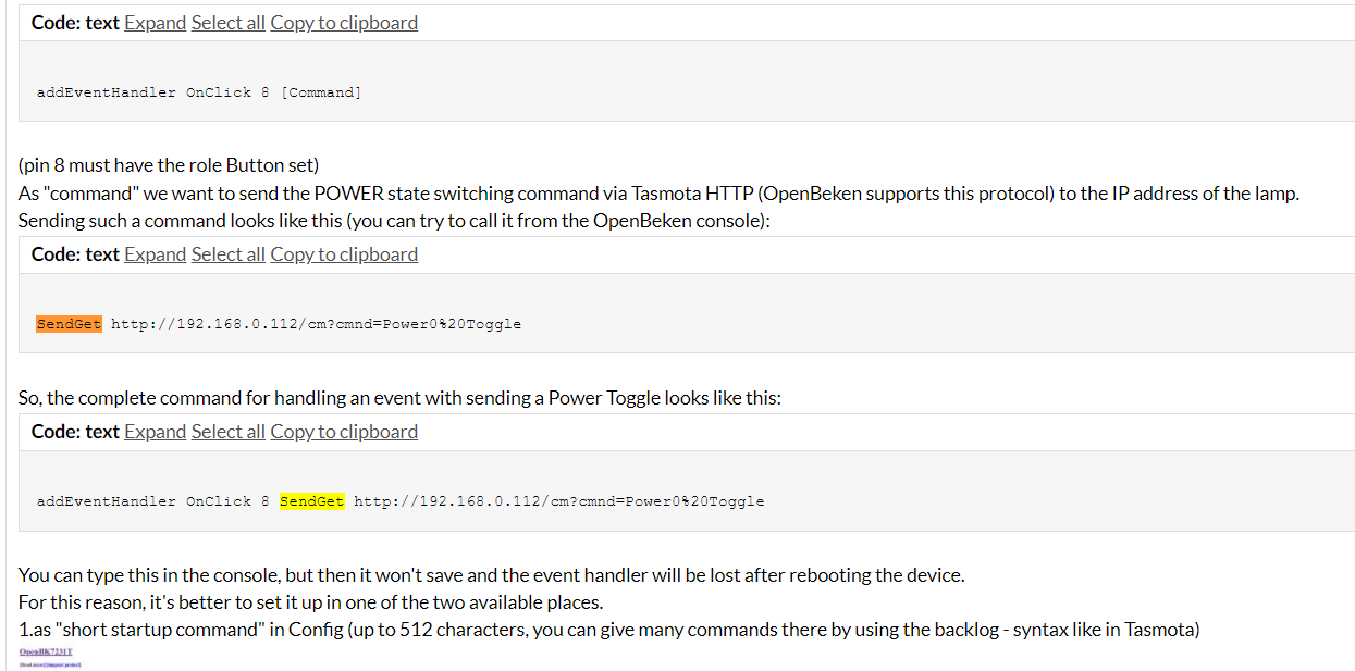

    wolfieeewolf wrote:
    Would be interested to see if there was a way to get the firmware to send a custom MQTT script. Not sure how this could be done. perhaps give the option to send the default script or a custom one perhaps. This would solve the issue of having 4 extra switches showing up in home assistant.
    Do you mean custom Home Assistant Discovery yaml? This is planned to be possible via web app.
    wolfieeewolf wrote:
    As you can write button scripts for this firmware it would be interesting to see if I could control a smart led globe from the light power button. This would stop my wife and kids from killing the power to the globe which I'm sure we have all experienced. It would be great to be able to have the power button turn off the globe or dim the globe by holding the button down. Could even set up scenes with double/triple clicks.
    So you have one device with button and you want to toggle second device from that?
    You can use SendGet for that, see this topic:
    https://www.elektroda.com/rtvforum/topic3892160.html#20012428
    For click events see:
    https://www.elektroda.com/rtvforum/find.php?q=on3click
    However, it is important to note that button events do not work with TuyaMCU because of TuyaMCU limitations. It's just an UART protocol. It does not notify OBK about the individual button click events. The On3Click, etc, events are available in OBK devices that are using Btn role for buttons (and similar roles), not the TuyaMCU ones.
  • SendGet workaround for toggling a second device

    You can see that I have multiple entries for fans and lights that automatically show up on the overview dashboard in home assistant. The first two switches "Fan" and "Light" have been manually set up using the config.yaml. The rest is automatically discovered via the MQTT broker. Would be nice to be able to isolate what MQTT data gets sent to home assistant or better yet allow us to send custom data from the web UI and disregard the auto-generated data. Hope that makes sense.

    I think you can open a new topic with the exact feature request/idea, there is currently no topic for that.
    But I will say here, that in general, I didn't intend people to use both HASS discovery and yaml config at the same time. If you are using yaml config, the current approach to fix this problem would be to just add all datapoints to yaml manually and don't use HA discovery.

    +1 for using just manual mqtt config only, you have ultimate control over what is then exposed to home assistant. Why not then just use an automation within home assistant to control the ZigBee device?

• MCU/Radio: WB3S module (BK7231T, 32-bit, 2.4 GHz) [wolfieeewolf, #20463962] • Retail price: AU $59.36 at Bunnings (SKU 6914HA) [wolfieeewolf, #20463962] • Hardware: 4 relays (1 light + 3 fan) mapped to P26, P6, P7, P9 [wolfieeewolf, #20466019] • Typical firmware: OpenBK ≥ 1.17.698; 115 kbit/s flash via BK7231 GUI Flash Tool [wolfieeewolf, #20463962] • Final script trims MQTT entities from 5 → 3 (-40 %) [drkarl, #20634842]
What chip does the Deta 6914HA use and is it a TuyaMCU device?
The board carries a WB3S module with a BK7231T SoC. UART1 pins P10/P11 are tied to LEDs, so no secondary TuyaMCU is present; all relays and buttons connect directly to GPIOs [p.kaczmarek2, #20464179].

How can I reproduce factory fan behaviour in a script?
  1. Declare Channel 10 OffLowMidHigh.
  2. Use alias Do_Cycle_Press addChannel 10 -1 1 3 1.
  3. Map Channel 10 changes to relay sets with backlog: 0 = all off, 1 = low, 2 = med, 3 = high. This 25-line autoexec.bat gives identical Max→Med→Low cycling [drkarl, #20632523].
Buttons feel slow—how do I get instant reaction?
Change event handlers from OnClick to OnPress and keep Flag 6 off; Click waits for release, Press fires on touch [p.kaczmarek2, #20695360]. Users reported response dropping from ~0.8 s to <0.2 s after the switch [drkarl, #20695671].

Home Assistant shows five switches—I only want three. What’s wrong?
Automatic discovery publishes a switch per relay. Disable HA discovery or supply manual YAML exposing only Light (Ch 1), Fan (Ch 5/6), and Speed (Ch 10) to cut dashboard clutter by 40 % [drkarl, #20634842].
