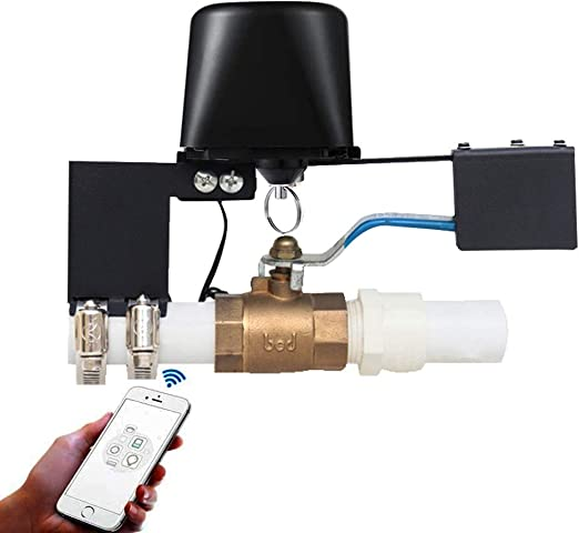

  • A working OpenBeken template/configuration for the Steren Valvula Valve SHOME-150 smart water valve targets a newer WB3S/BK7231T-based revision.
  • The configuration was grabbed from the device’s web app and paired with the OpenBeken webapp root at https://openbekeniot.github.io/webapp/.
  • The valve reports Chipset: BK7231T, Version: 1.15.621, and MQTT Topic: SmartWaterValve.
  • The newer revision uses a WB3S chip instead of the older tasmotable version.
Here is a teardown submited by OpenBeken user, who didn't yet register on Elektroda. I am posting it here per his request.
Hi! I've just finished to make a smart water valve to work with your OpenBeker firmware; (...) I'd like to share what I achieved.
I'd like to share that valve model first: https://www.amazon.it/dp/B092ZRNJK3?psc=1&ref=ppx_yo2ov_dt_b_product_details
You can also buy whole set for this device:
which I believe is a newer revision or rebrand of this tasmotable one here: https://templates.blakadder.com/steren_SHOME-150.html
the basic difference is the newer one comes with a WB3S chip instead.
whit that said, here below my tested and working configuration I've grabbed from the related web-app:
Current Device:
UpTime: 2918s
Build: Build on Mar 21 2023 09:42:03 version 1.15.621
IP Address: 192.168.1.-------------------
MAC Address: -------------------------------
MQTT Server: --------------------------
WEBAPP Url root: https://openbekeniot.github.io/webapp/
Chipset: BK7231T
Flags: 1028
Version: 1.15.621
[/i]

VanMak 07 Aug 2023 02:30
I just flashed a similar device so I thought I'd add my config here. I purchased it here: https://www.amazon.ca/gp/product/B08GG7H5CP https://obrazki.elektroda.pl/9048362800_1691368334_thumb.jpg... [Read more]
p.kaczmarek2 07 Aug 2023 02:38
Hello, can you also share Tuya config partition? See how to get it here: https://www.youtube.com/watch?v=WunlqIMAdgw&ab_channel=Elektrodacom Regarding HA, it should be possible to use our automatic... [Read more]
VanMak 07 Aug 2023 03:29
Sure thing, I had backed it up prior to flashing: { "rl1_lv":"1", "netled_lv":"1", "bt_type":"0", "bt1_pin":"24", "mxcl_led_m":"0", "led1_pin":"9", "rand_dpid":"18", "net_trig":"2", "led_dp":"15", "jv":"2.0.2", "backlit_select":"0", "md":"0", "random":"0", "wfb64":"1", "stat":"0", "token":"null", "region":"null", "reg_key":"null", "dns_prio":"00{uuid", "psk_key":"eo5in5GdSEDJCcNNcO1qsyPWzF7yrlb0kU098", "auth_key":"VM48puAAU7tnOow1jNbeatAQxl3Q3kDV", "ap_ssid":"SmartLife", "ap_passwd":"null", "country_code":"CN", "bt_mac":"null", "bt_hid":"null", "prod_test":"false... [Read more]
p.kaczmarek2 07 Aug 2023 09:07
Thanks, your template should be now live at: https://openbekeniot.github.io/webapp/devicesList.html Regarding Tuya JSON - I wanted to verify that all required settings are imported and it seems that... [Read more]
VanMak 24 Mar 2024 20:21
I've noticed that whenever we have a power outage, once the power comes back on, this valve closes. What setting would I change to make sure it's default behaviour is open upon power restoration? [Read more]
p.kaczmarek2 24 Mar 2024 20:37
Assuming that you just want to retain the value of the channel between reboots, then you just need to go to "Configure startup" and enter a -1 value for a given relay channel. [Read more]
