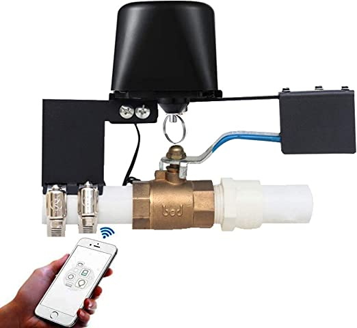

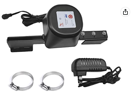

    Here is a teardown submited by OpenBeken user, who didn't yet register on Elektroda. I am posting it here per his request.
    Hi! I've just finished to make a smart water valve to work with your OpenBeker firmware; (...) I'd like to share what I achieved.
    I'd like to share that valve model first: https://www.amazon.it/dp/B092ZRNJK3?psc=1&ref=ppx_yo2ov_dt_b_product_details
    [BK7231T/WB3S] LgowithU Smart Water Valve template/configuration, Steren Valvula Valve (SHOME-150)

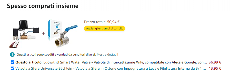

    You can also buy whole set for this device:

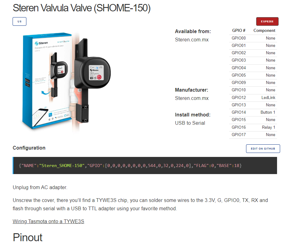

    which I believe is a newer revision or rebrand of this tasmotable one here: https://templates.blakadder.com/steren_SHOME-150.html
    the basic difference is the newer one comes with a WB3S chip instead.
    whit that said, here below my tested and working configuration I've grabbed from the related web-app:

    Thanks, your template should be now live at:
    Regarding Tuya JSON - I wanted to verify that all required settings are imported and it seems that they are. For example, here's how Tuya defines Relay pin:
    	"rl1_pin":"6",
    Thanks to this users can get GPIO settings without guessing/investigating PCB.
