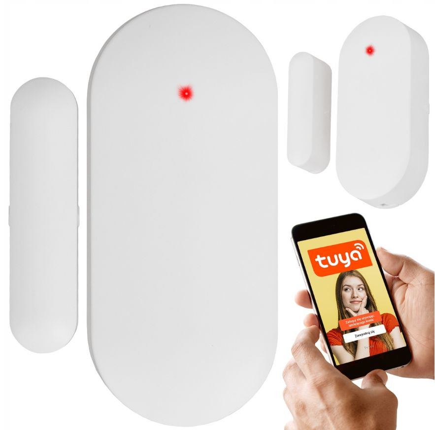

Name on sale: Autonomous Tuya window door opening sensor Label name: Heckermann, Product: Wifi Door Window Sensor, Model: PB69
Device photos:
