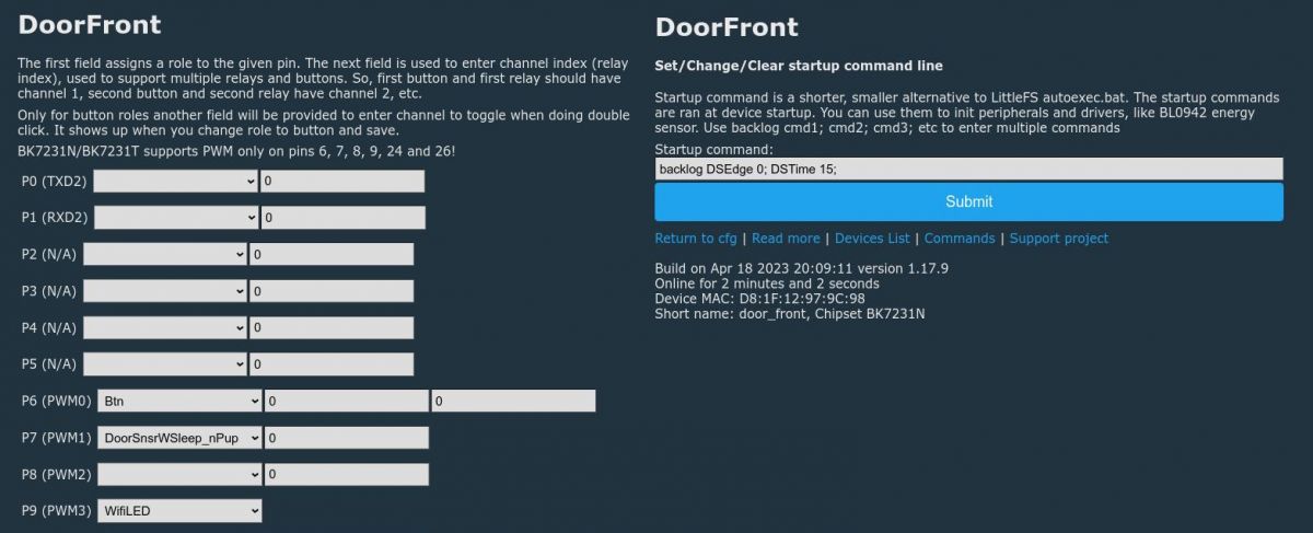

    Necessary settings:
    We connect to the Access Point of the device via Wifi and enter the configuration page: http://192.168.4.1
    We set in turn:
    1. Wi-Fi → Configure WiFi ( after confirming, we need to reconnect via the address taken from DHCP )
    2. Static IP address to speed up connection → Configure IP
    3. Sensors → Configure module :
    P6 Btn
    P7 DoorSnsrWSleep_nPup
    P9 LED
    4. Flags → Configure general/flags :
    x 35 [HASS] Deactivate avty_t flag for sensor when publishing to HASS (permit to keep value). You must restart HASS discovery for change to take effect.
    x 37 [WiFi] Quick connect to WiFi on reboot (TODO: check if it works for you and report on github)
    5. Start commands → Change startup command text : (we set the same wake-up state for each position and shorten the time to fall asleep)
    backlog DSEdge 0; DSTime 15;
    6. Device name → Configure names
    7. Connection to MQTT → Configure MQTT
    8. Home Assistant settings→ Home Assistant Configuration

  • Flags 35 and 37 for HASS sensor publishing and WiFi reconnect
    #2 20546826
    Posts: 14782
    Rate: 12920
    Very good material, at the beginning I will only add that disabling the addition availability can also be implemented through a flag, according to:
    https://github.com/openshwprojects/OpenBK7231T_App/blob/main/docs/flags.md
    In addition, it will come in handy:
    (but flag number 37 will be enabled by default soon).

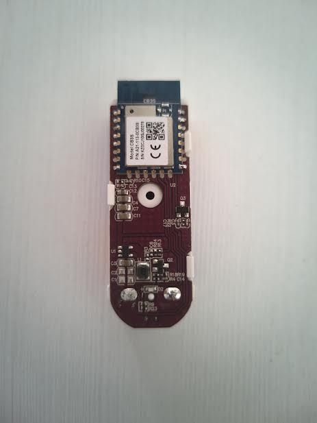

  • Closed-state deepsleep prevents hall sensor wakeup
    #10 20628197
    Jagis
    Posts: 7
    Hi,
    I have a problem with the door/window open/close sensor. The manufacturer is Melink, on the PCB I found only such information as MC400D-A002 and the production date 20210910. The sensor has a CB3S module, I installed OpenBK7231N_QIO_1.17.152 on it and configured it according to dumb matched with tuya, it also has a hall sensor.
    I have a problem with waking up the sensor, if it goes into deepsleep when it is open, the wakeup works properly, but if it goes into deepsleep when it was closed then it does not wake up after applying the magnet. Only waking up open/closed with a physical button works correctly.

  • Try DSEdge 1 or 2 and reboot
    #11 20628332
    Posts: 14782
    Rate: 12920
    Hello @Jagis, this issue was discussed with @nihildiximus in this thread:
    https://www.elektroda.pl/rtvforum/topic3971140-0.html
    But in short, you just probably need to change the DSEdge setting to something else. While you actually have DSEdge 0 at the moment, you'll have to try to see if DSEdge 1 or DSEdge 2 works better.
    Just remember that the startup command, as the name suggests, is executed at device startup. So if you change it and don't do Restart, then in this session (before reboot) setting won't run. So after changing the commands I recommend to reboot.
    PS: It's very good that you also set the Button role, because without it, in case of problems with DSEdge, you wouldn't be able to wake up the device and you would have to remove the batteries.

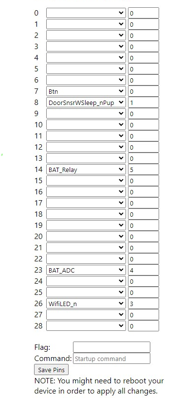

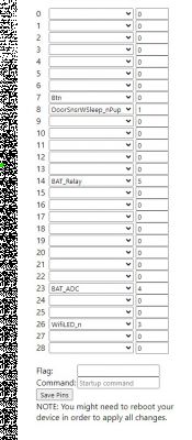

  • Purple board works with I/O mapping and autoexec settings
    #12 20748384
    andrewishy2
    I have the same device, this is what I did to make the purple board work...
    Set the I/O to the following
    Screenshot showing the configuration of device input/output settings with various values assigned to each field.
    And the following in the autoexec.bat
    DSTime 5
    DSEdge 1
    addEventHandler OnHold 7 DSTime 600
    Edit 1 - I got it working
    Edit 2 - Added reduced the wait time in autoexec.bat to 5 seconds and added a handler so if you press the button it stays up for 600 seconds

Power-cycle the device five times to force the OpenBeken configuration access point. The thread states that turning power on and off five times opens the configuration AP again. Use that AP to correct WiFi, MQTT username, or MQTT password. The user who had wrong MQTT credentials confirmed the method helped on May 25, 2023. [#20593887]
What do OpenBeken flags 35 and 37 do for Home Assistant availability and faster WiFi reconnect on battery door sensors?
Flag 35 disables the Home Assistant avty_t availability flag for sensors, keeping the last value published. Flag 37 enables quick WiFi connection on reboot. The thread recommends both for battery door sensors. After changing flag 35, restart Home Assistant discovery for the change to take effect. The maintainer also noted that flag 37 was expected to become enabled by default later. [#20546826]
How should I configure MQTT and Home Assistant for a PB69 door sensor when the open and closed payload values are reversed?
Create a manual MQTT binary_sensor and swap the payload values. Use state_topic: "doors_front/0/get", payload_on: 0, and payload_off: 1. The thread says Home Assistant Discovery can add the sensor automatically, but its default values were reversed. After adding the manual entity, set the Home Assistant device class to door for better display. [#20546781]

Why is the battery voltage or battery channel always 0 in MQTT on a CB3S door sensor, and why can USB-UART power affect battery readings?
Battery readings can stay at 0 when the sensor runs from USB-UART instead of batteries. A user reported that battery numbers started working only after powering the device with a battery. While powered from the USB serial adapter, the device did not show power or voltage correctly. This affects channels such as battery channel 5 on similar CB3S door sensors. [#20754824]
