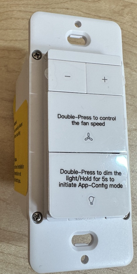

I recently purchased a couple of Treatlife DS03 Smart Dimmer / Fan controller.
Naturally, I had no desires to use the Tuya cloud services and wanted to connect it directly to my Home Assistant setup.
There were many guides that one could find, but none of them was complete (using phrases like "do it in the usual way"). As someone new to both HA and OpenBeken world, I've had some trouble getting a definitive answer on how to get the process across. To make matters worse, I only have a Mac machine so all the windows flashing guides weren't very usable for me
After some trial and error and time spent on research, I've decided to put down the following guide for prosperity. Hope someone finds in useful in the future.
1. Disassemble the board
Open the four screws connecting the face plate and carefully pry open the panel (which contains the WB3S board)
