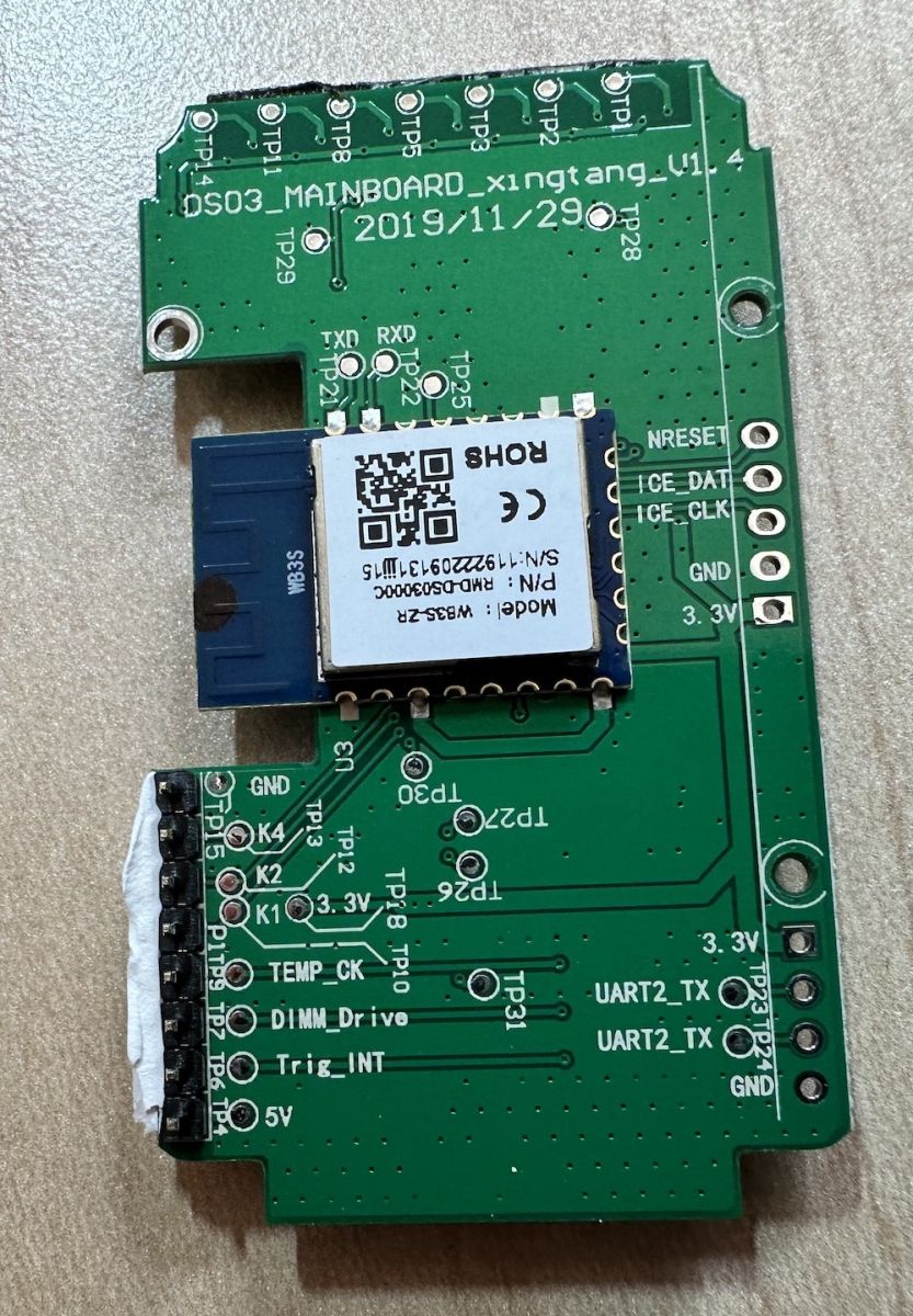

    2. (Optional) Remove board with WB3S board from buttons
    Remove 3 small screws and disconnect main board from panel (marked above in red)
    You should end up with the following board (both sides shown below)

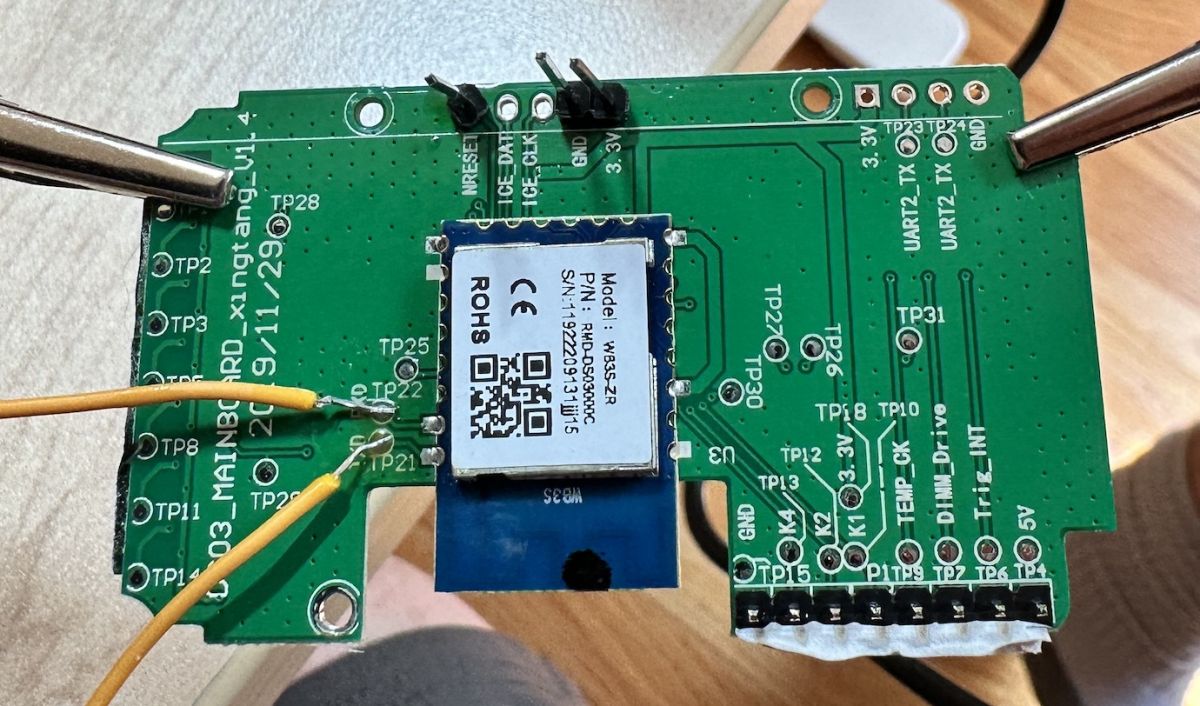

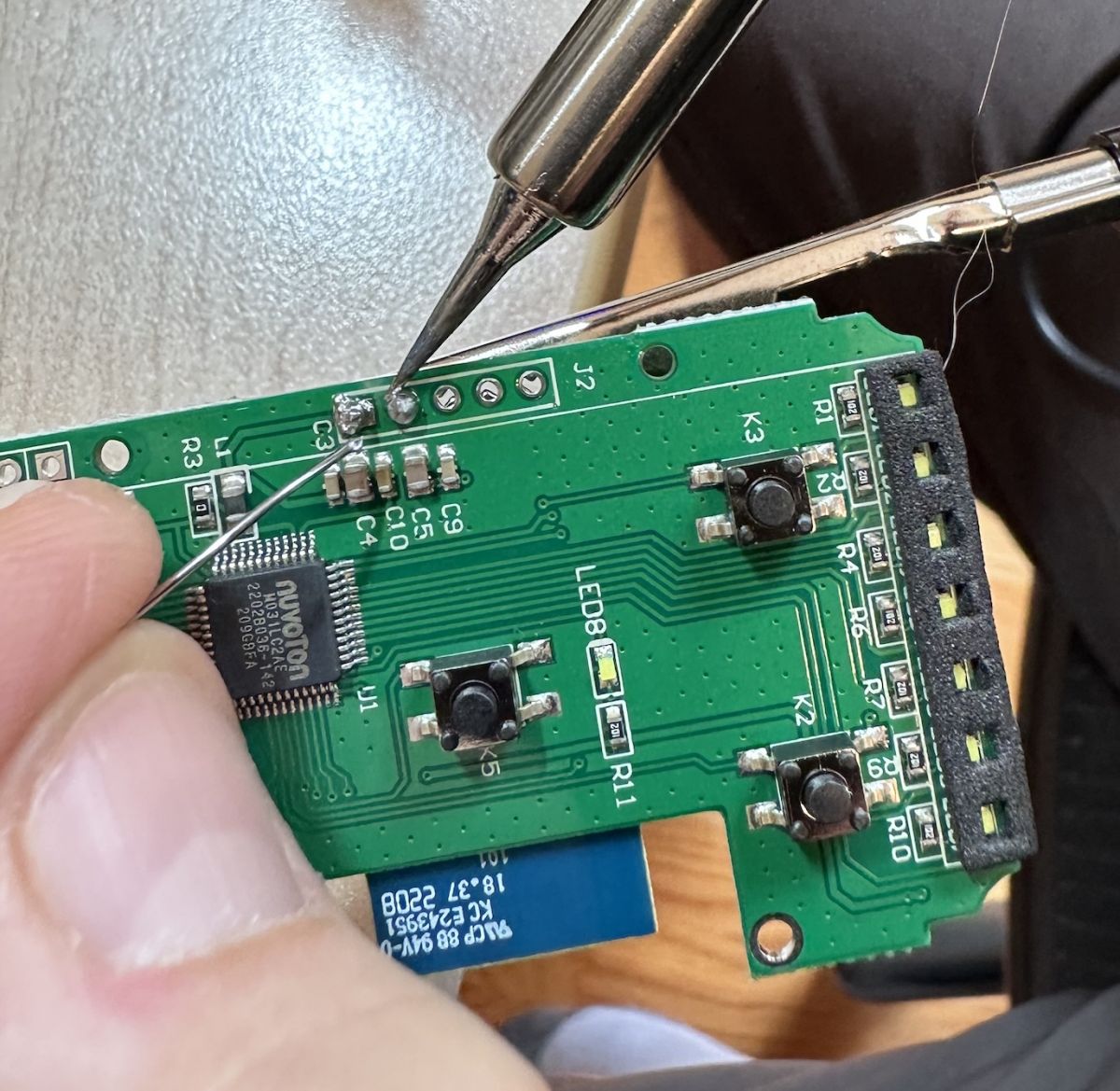

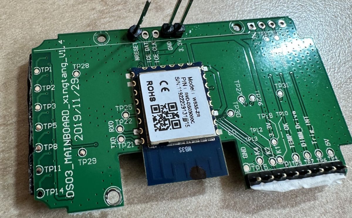

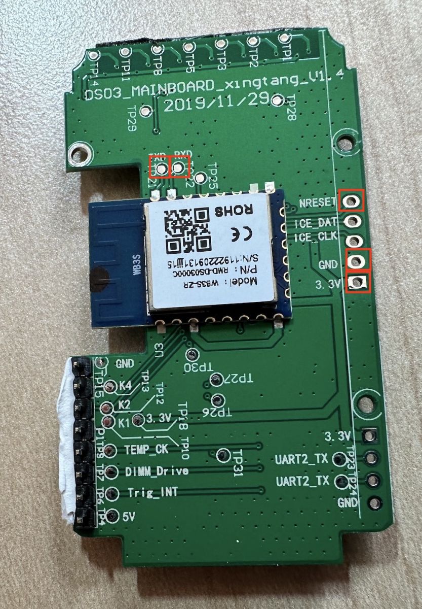

    3.Soldering wiring and pins
    In order to flash OpenBeken on this chip we're going to need to use the UART interface of the WB3S board. However this interface is already used by the Tuya software to communicate with the Tuya MCU (Novton board on opposite side) that's actually controlling the leds and GPIOs.
    So we need to expose the UART wires and reset the MCU so that we can chat without interruption
    Solder pins / wires on the 3.3V, GND, nRESET, TX & RX lines, marked below
    Treatlife DS03 Smart Dimmer / Fan controller - Absolute beginners guide to flashing (On a Mac)
    Solder the pins
    Treatlife DS03 Smart Dimmer / Fan controller - Absolute beginners guide to flashing (On a Mac) Treatlife DS03 Smart Dimmer / Fan controller - Absolute beginners guide to flashing (On a Mac)
    Solder the wires
    If you're not experienced in soldering, verify all the connectivity with a multimeter.

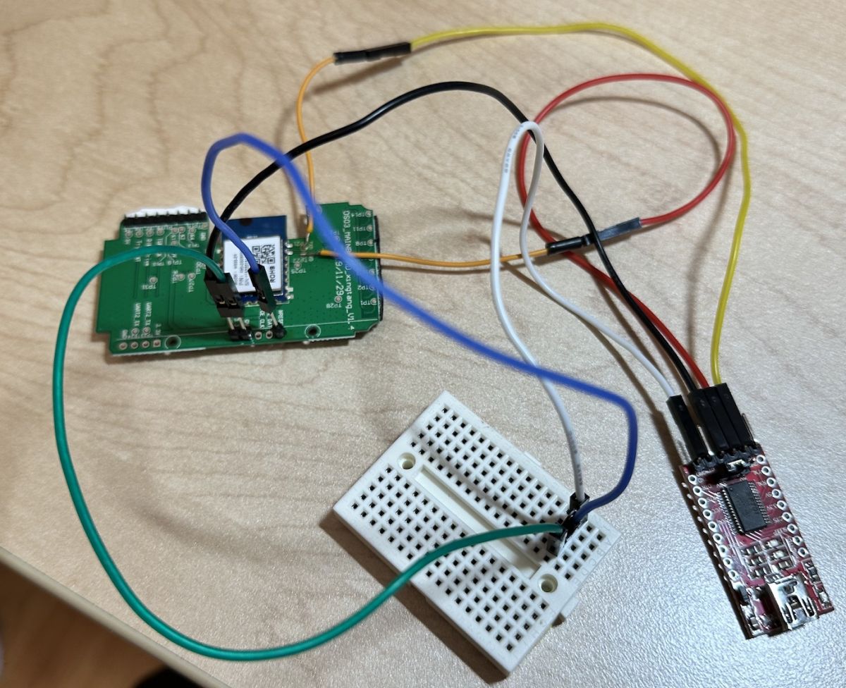

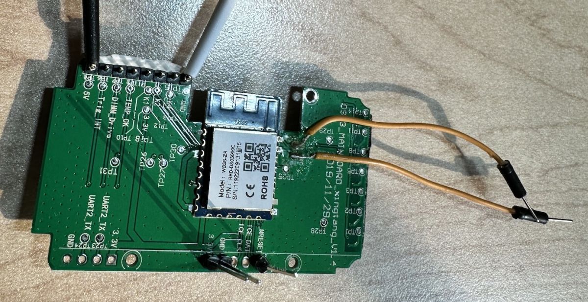

    4. Connect to USB-to-TTL board
    I'm using this board and use the following connections. Notice that RX on the board is TX on the USB-to-TTL and vice versa.
    DS03 MainboardUSB-to-TTL
    3.3vvcc
    GNDGND & NRESET
    TXDRXD
    RXDTXD
    Note, in order to connect the USB-to-TTL GND to both GND and NRESET, I used a small breakout board as seen below
    And connect the USB-to-TTL to your computer (my MBP in my case)

    In some of the boards the above worked without issue, while in another board I could not get the above to work at all. The problem seems to have been that the Tuya app was trying to talk over the UART with the MCU (which is held at reset) and would only give a small time window at boot time to talk with the bootloader.
    The solution comes from reseting the board while the python script was already running (the bk7231tools script is internally flooding the serial).

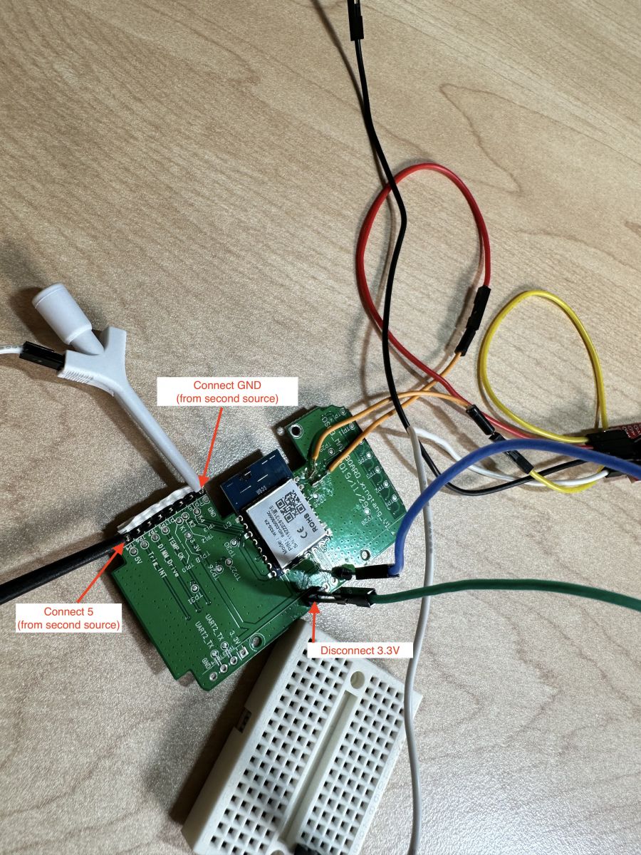

    Reseting is done by shorting the CEN pin on the WB3S board to GND. However the USB-to-TTL board I've had didn't appreciate the" "short" here and reseted themselves (disconnecting the USB).
    The below describes what one can do if that happens:
    7.1 Use a separate 5V power source and connect it to the 5v connectors as marked below. Disconnect the 3.3V source from your USB-to-TTL converter. In my case I used another USB-to-TTL with the jumper set to 5V. Do not use TX/RX on this device as it may damage the WB3S.
    7.2 Run the bk7231tools command as above and while it waits, tap connect the GND to the CEN pin as marked below (to reset the WB3S) board. See below on locations. I connected another connection to the breakout board connected to GND and used the other side of the wire to momentarily tap the wire on the CEN pin, quickly reseting the board.
    7.3 The python script should work now as expected

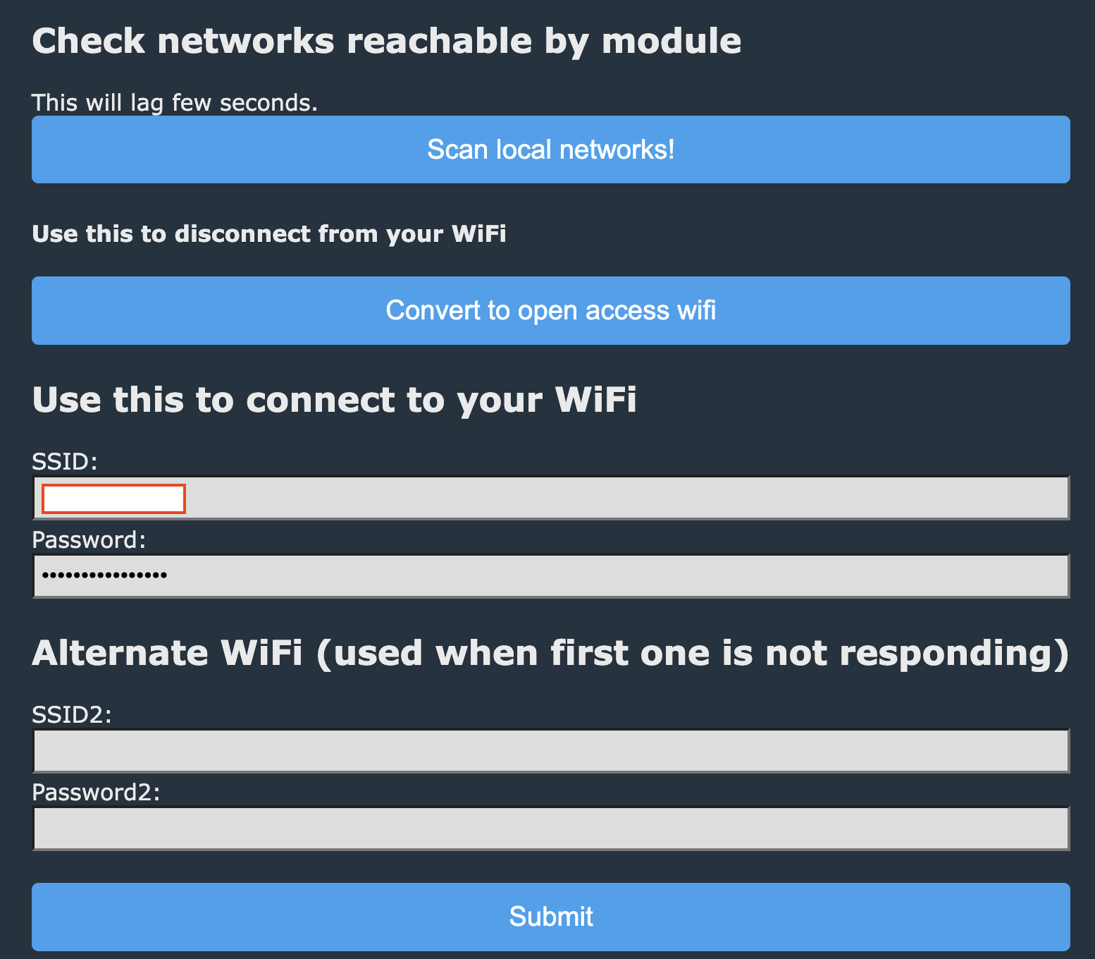

    [b]11. Configure the OpenBeken software to connect to your wifi
    Connect your computer to the OpenBeken SSID and browse to 192.168.4.1
    Configure the wifi details
    Restart the WB3S and connect to it's IP address (use your router's interface to find it)

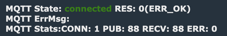

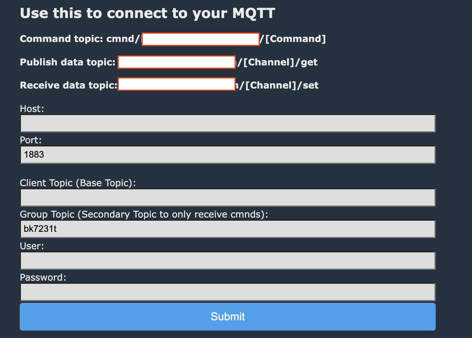

    12. Configure names and MQTT parameters
    And it should connect to MQTT in your setup

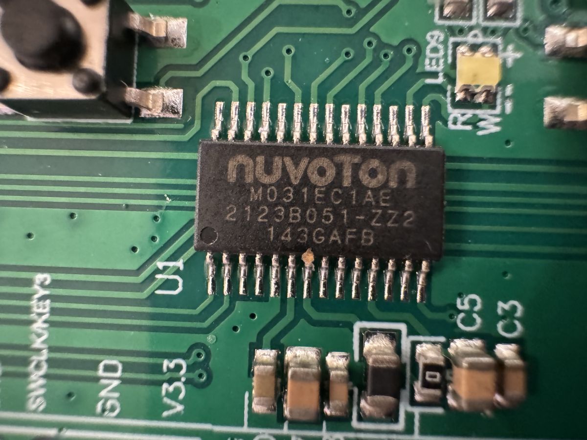

    I just experienced this too. There are three boards inside on top of each other and they're all soldered together.
    I removed the two screws on the metal faceplate and wiggled the assembly out. In order to get to the top board, I carefully flexed the board to remove the three small screws holding the board to the button faceplate. That allowed me to get to the soldered header. I removed the solder from the 8 pins and wiggled the board off. Not easy. I have a desoldering suction gun which made it easier though.
    The layout of the board looks the same as picture above but some writing is different, and the NRESET hole is labeled in chinese, which seems to translate to "empty feet".. not sure resolution is high enough.

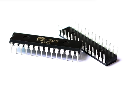

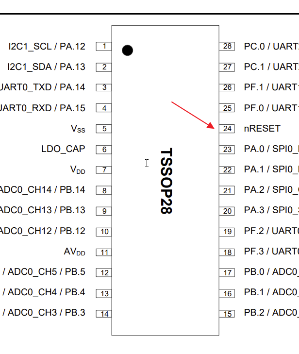

    The MCU is Nuvoton M031EC1AE which is different than in the picture- it's a 28 pin DIP package not a square.. The pinout shows the reset on pin 24, which the board appears not to have connected. This is a problem.
    My current thought is to desolder the CB3S module from the board and flash it in isolation, then resolder it. I'd also like to try replacing with a ESP12 board but it looks like pin 10 is being used, which appears to be a PWM GPIO, which I don't think ESP12 has.
  • #10 21253554
    Posts: 14782
    Rate: 12920

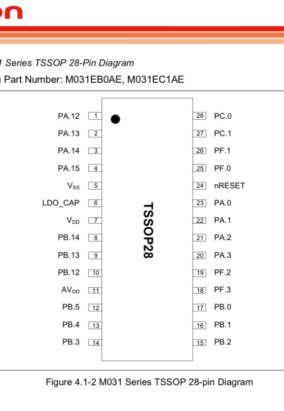

    28 pin DIP MCU, are you sure? That would be a very large case, as for Tuya device... Two 28-pin DIP microcontrollers on a white background.
  • #11 21253814
    kaplanroger
    Posts: 10
    >>21253554
    Well not technically a dip but rectangular with pins on 2 sides
    Nuvoton integrated circuit on a green printed circuit board with pins on both sides.
    Note how the 5th pin on the top has no trace, that’s the reset pin.
    TSSOP 28-pin diagram with pin layout for part number M031EB0AE, M031EC1AE.
  • #12 21254098
    Posts: 14782
    Rate: 12920
    So a TSSOP28 case. That is very possible. DIP28 is not used in smart devices at all.

    However to get to that point I used these to connect directly to the MCU pins:
    https://www.aliexpress.us/item/3256805273940254.html
    Colorful IC test leads connected to an integrated circuit.
    Any sort of IC test lead that says it will handle TSSOP chips will work. So use it to grab the nReset pin and connect it to ground.
    As a bonus you can use them to clamp onto the Tx/Rx solder globs where the BK board mounts to the main so you don't have to deal with soldering a wire to the tiny solder pads.
    The nReset pin is pin 24 on the Nuvoton TSSOP28 chip (14 pins per side). Look closely and there'll be a dot at one corner. That's pin 1. Position that at the upper left. The pins are numbered counter-clockwise so pin 24 will be the fifth from the top on the right side.
    Pin connection diagram of a TSSOP28 chip with the nRESET pin highlighted.
    If anyone cares the MCU pins 3 and 4 are the Tx/Rx pins that communicate with the BK board.
    Rather than purchase another unit I decided to try the Kasa controller which has a much nicer interface anyway and the Kasa integration with Home Assistant seems to work well.
