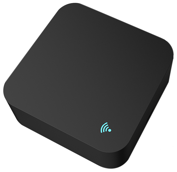

I ordered some WiFi universal IR remotes on AliExpress and want to share my experiences from flashing OpenBeken on them.
Here are some pinouts for configuration and other hints:
TUYA Home Smart Life Mini Universal IR Remote S06 (BK7231T) [WB3S]
Black square IR WiFi remote with illuminated blue WiFi symbol.
Button: GPIOP_6
IR RX: GPIOP_8
WiFi LED: GPIOP_9
IR TX: GPIOP_26

p.kaczmarek2 01 Sep 2023 10:41
Thank you, can you also post JSON configs from Web App so I can just copy-paste them to our devices list? Futhermore, are you sure that you got BK7231N in a WB3S form? Usually WB3S i BK7231T, and CB3S... [Read more]
Lexcis 01 Sep 2023 11:30
Sorry, checked it again and you are right: Both of them are BK7231T. I have corrected my post. Sure, I will add the JSON code shortly. [Read more]
p.kaczmarek2 01 Sep 2023 12:12
Okay, no problem, I was just asking because we really already had a batch of devices that were using CB2S with BK7231T inside , which was very, very strange and confusing for our users, because you have... [Read more]
p.kaczmarek2 06 Oct 2023 13:48
JSONs were added to our teardowns list. Thank you! Now we have more than 400 devices in our Elektroda database! [Read more]
