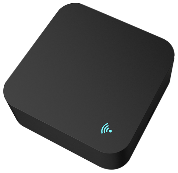

    TUYA Home Smart Life Mini Universal IR Remote S06 (BK7231T) [WB3S]
    Black square IR WiFi remote with illuminated blue WiFi symbol.
    Button: GPIOP_6
    IR RX: GPIOP_8
    WiFi LED: GPIOP_9
    IR TX: GPIOP_26

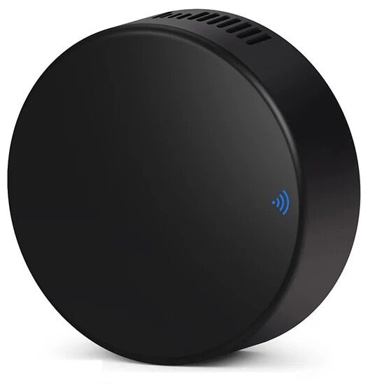

    TUYA Home Smart Life Mini Universal IR Remote S18 (BK7231N) [CB3S]
    Black, round universal IR remote with a blue LED.
    Button: GPIOP_6
    IR RX: GPIOP_7
    WiFi LED: GPIOP_8
    IR TX: GPIOP_26
    Important notice for flashing: In my case labeling of Rx and Tx was mixed up on PCB

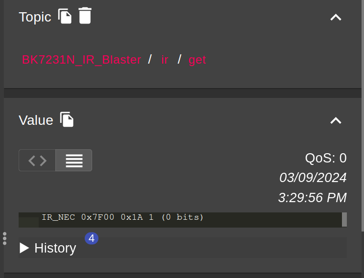

    I have one tuya IR Remote working with config like this post and embembed in HomeAssistant.
    Working!!!
    My question... How to send as mqtt topic the irCode getted by the sensor? Instead of check device logs... Send the data to a topic.
    IR pinouts not allow define Channel so...

    nacxoffw wrote:
    Hi!
    Working!!!
    You need to set Flag 14 in the config>Configure General/Flags and then it will publish IR codes to <dev id>/ir/get

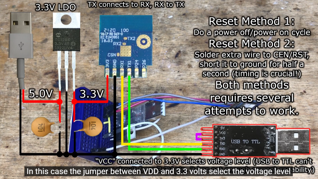

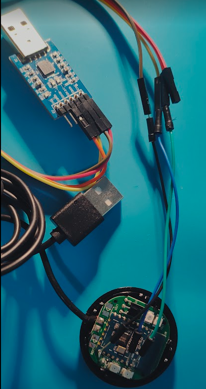

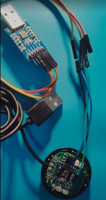

    I have one of these devices (CB3S, BK7231N), but I am confused about how this is supposed to be flashed.
    According to the second youtube video in this thread I should connect TX1, RX1 and GROUND pin to USB-to-UART converter. I did this.
    Then I should power on, off and then on again the device using its own USB cable. I did this.
    However the BK7231 Easy UART Flasher continues to output the following messages:
      Getting bus failed, will try again - 91/100!
      Getting bus failed, will try again - 92/100!
    I had some experience with smoke sensors, based on the same chip and in that case it was necessary to connect the CEN line and breafily connect it to the ground, but this is not mentioned in this guide and I am pretty confused right now. May I get any help?
    [img] Module connected to a USB to UART converter with wires. [/img]
  • #17 21156029
    baudneo
    Posts: 17
    If it's not entering bootloader mode on its own, then try the CEN to ground method.
  • #18 21156054
    carlig833
    Posts: 23
    Thanks for answer. Unfortunatly the CEN to GROUND trick does not work either.
    What is nonsense to me is having the device powered separately via its own USB cable, but also connected via USB-to-UART.
    Would not be more straightforward to power it via the USB-to-UART device as we do for smoke and water sensor?
    In that case on which CB3S PIN should I provide the 3.3V coming from USB-to-UART?
  • #19 21156073
    baudneo
    Posts: 17
    Yes, you can power it from the usb to TTL converter. The usb power is just for convenience.
    I haven't had any issues flashing obk to several devices now, sounds like maybe there's a hardware issue or something.
  • #20 21156442
    Posts: 14615
    Help: 655
    Rate: 12632
    I'm afraid that you actually can't reliably power it from USB to UART converter. It does not have enough current capability. In our videos, we always use external 3.3V supply:
    https://www.youtube.com/watch?v=L6d42IMGhHw&list=PLzbXEc2ebpH0CZDbczAXT94BuSGrd_GoM
    Diagram of USB to UART converter connection with an external 3.3 V power supply and reset methods.
  • #21 21160214

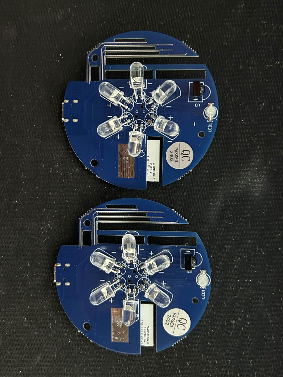

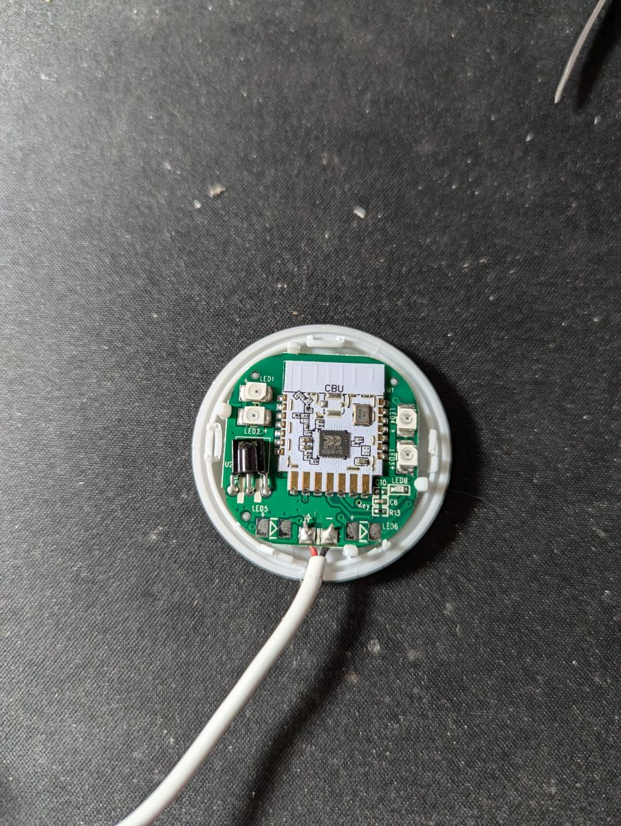

    agudelotmateo
    Hey everyone, I just got myself two units that seems to match the "TUYA Home Smart Life Intelligent WiFi IR Remote Control IRC02 (BK7231N) [CB3S]" but I have no idea how to flash them. I've flashed "S06 Pro"s in the past using the Avatto profile on Tuya CloudCutter, but even though these (the IRC02 ones) are running 1.0.2 from the factory, after trying a bunch of profiles none of them worked.
    I also removed the case and I have no idea where I could solder, I can't seem to find any VCC, UAT, GND, RX or TX labeled connections.
    Any ideas? I'm not very experieced but I could probably solder my cables directly to the CBU (?) chip after finding the proper pinout, but isn't that kind of scary? I know that development pins or connectors ase essentially the same thing but I'm worried about messing up the chip. Two round, blue circuit boards with mounted LED diodes. Two circuit boards with a WiFi module on a black background. Screen displaying device software update information.
  • #25 21282250
    Posts: 14615
    Help: 655
    Rate: 12632
    I can't see any solder pads that could be a flashing port. You can still try probing with multimeter to find some, but maybe it would be worth to solder directly to CBU...
    You don't have much wires to solder, you will only need to solder RX and TX to CBU pads.
    Ground can be soldered elsewhere, for example, this large pad is most likely connected to ground - just check it first with multimeter.
    Then, power, it can be supplied via USB connector, from the same machine that you have USB to UART converter connected to.
  • #26 21299443

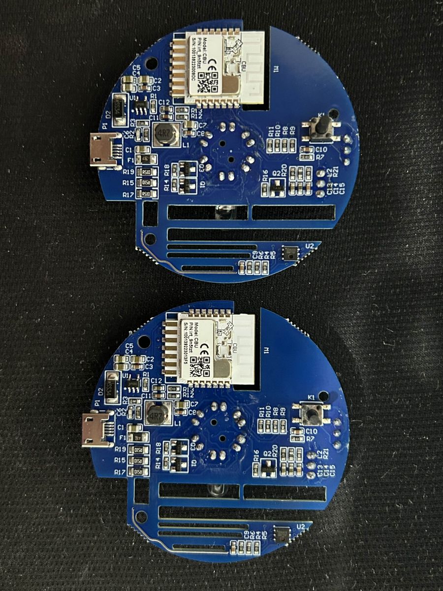

    agudelotmateo
    OK I was able to dump the stock firmware using ltchiptool but UPK2ESPHome was unable to get anything out of it. I flashed ESPHome and at this point I'm able to flash wirelessly, but the device isn't working, really, because I don't know how to get the IR to work of read the data from the sensors.
    This is a CBU device and based on my research (I'm new at this) it doesn't have a TuyaMCU. I have no idea how to configure this device. I have a similar device (S06 Pro) but that one uses a TuyaMCU (temperature and humidity are read from the TuyaMCU, Pin 26 is the IR Transmitter and Pin 8 the IR Receiver so pretty easy under generic-bk7231t-qfn32-tuya with RX1 and TX1 for the UART bus at 9600 baud rate) and this one apparently does not.
    Any idea on how to figure out the pins and stuff for this device? I attached the stock firmware dump in case that's useful
    EDIT: Looks like the device I have is exactly like the one shown in this post: https://www.elektroda.com/rtvforum/topic3974946.html#20560227, but the pinout specified there does not work for me (Pin 8 for the IR Transmitter and Pin 24 for the IR Receiver). This is the relevant part of my ESPHome YAML file:

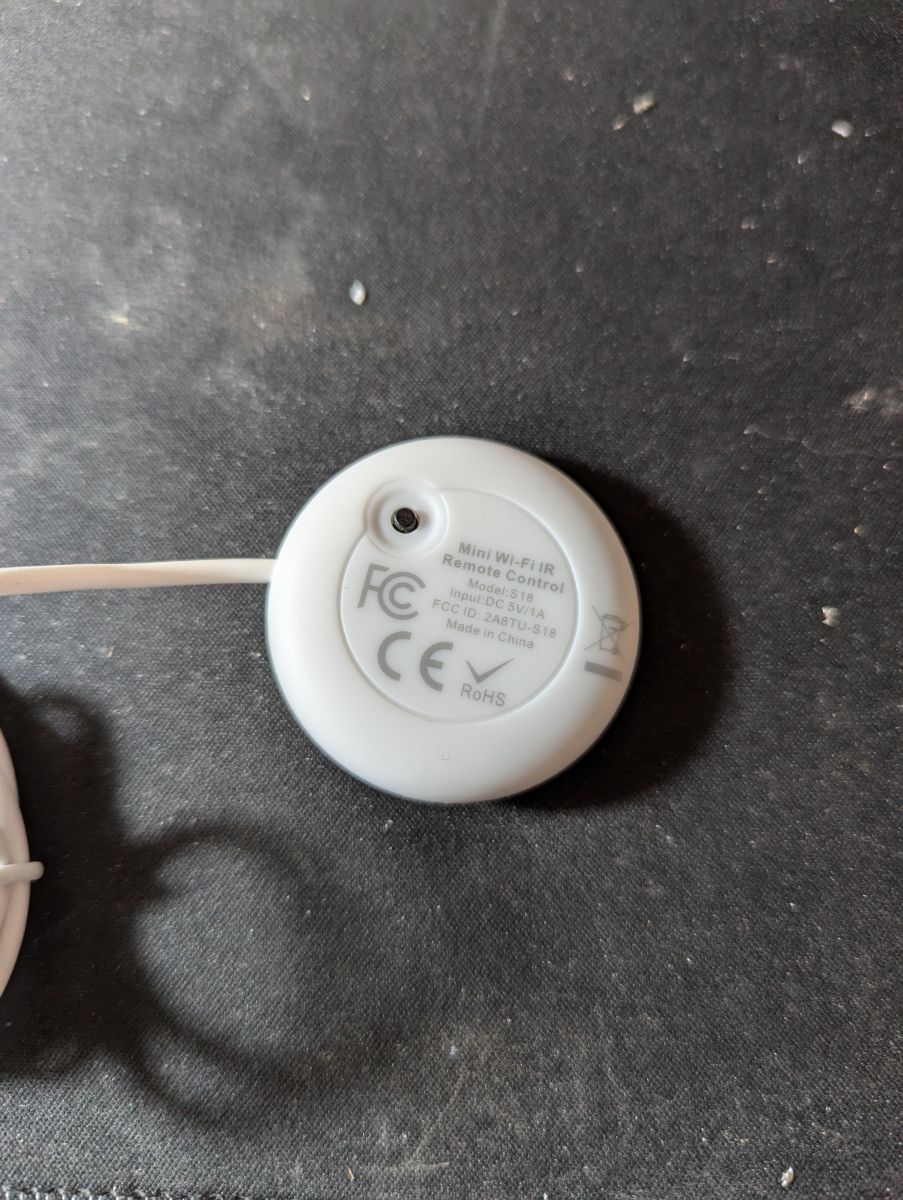

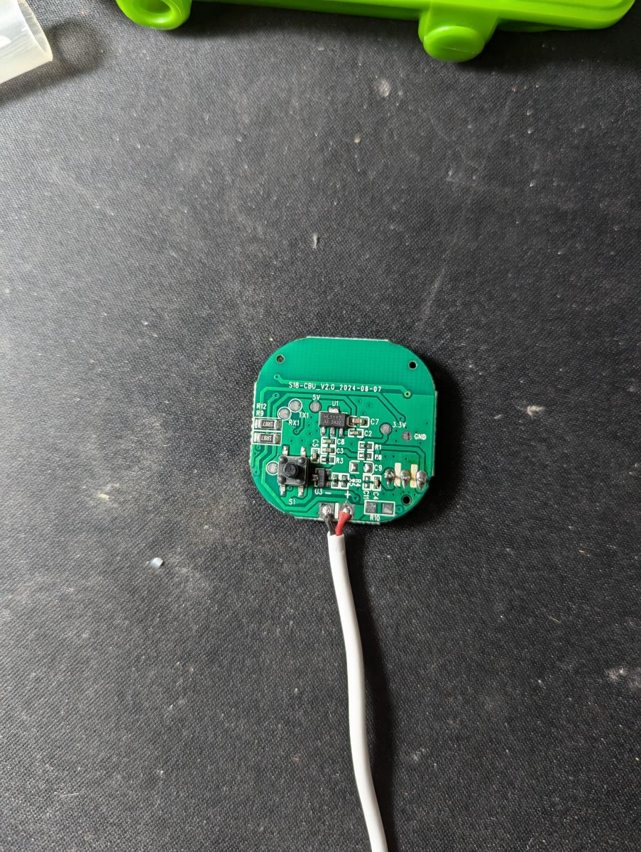

    Hi,
    I recently bought 2 units labeled as model S18. They are white, small and come with a soldered-on USB-A lead.
    They do not have the same IO mappings as the S18 unit described in the very first post of this thread.
    In fact, they are equipped with a CBU module rather than a CB3S.
    My units came programmed with Tuya firmware version 2.0.0 and could be flashed through Cloudcutter. It's a good thing because opening up these suckers will surely break all retention clips. You will need to use glue to put it back together.
    Here's the mapping info pulled from BK7231Flasher
    	"reset_pin":"26",
    	"wfst_pin":"24",
    	"owm":"1",
    	"reset_lv":"0",
    	"rsthold":"3",
    	"wfst_lv":"1",
    	"netyc":"1",
    	"infrr":"8",
    	"netnc":"0",
    	"infre":"7",
    	"crc":"32"
    - Button is on P26
    - WiFi LED on P24
    - IR Receiver is on P8
    - IR Transmitter is on P7
    No module information found.

  • #28 21315480
    Posts: 5062
    Help: 438
    Rate: 893
    even though you used Cloudcutter, did you happen to take a factory firmware backup anyway or was that config extraction from the 73kb Tuya config download from within OpenBeken webapp?
  • #29 21315828
    Posts: 14615
    Help: 655
    Rate: 12632
    CBU has P16 easily available, I'd use this device to attach WS2812B strip as a nice addition to basic functionality.

    As I couldn't figure out the IO mapping, I disassembled the second unit and while at it, I decided to go through serial flashing rather than cloudcutter.
    So lucky you!
    Attached binary dump
    EDIT: Here's the product page I bought it from: https://www.aliexpress.com/item/1005006871030126.html
    It was $5.50 USD at the time, for 2 units.
    • readResult_BK7231N_QIO_s18_cbu_1_2024-23-11-02-02-33.bin (2 MB) You must be logged in to download this attachment.

Newer S18 variant CBU / BK7231N Btn P26, LED P24, IR RX P8, IR TX P7 Different from original S18 mapping
Later S18 variant T1-3S / BK7238 IRSend P6, input P9, LED P24, IRRecv P26 Needs BK7238 path, not BK7231
Key insight: Do not trust the product name or PCB silkscreen alone. Verify the actual Wi-Fi module and extracted Tuya pin map before flashing or importing a template.

  • A practical serial-flashing constraint appears repeatedly: use an external 3.3V supply, because a USB-to-UART adapter may not provide enough current for reliable flashing. [#21156442]
  • One OpenBeken user referenced a 73 kB Tuya config download from the web app for extracting mapping data on a CBU variant, which helps verify pins before full reconfiguration. [#21315480]
How do I configure OpenBeken GPIO pins for the Tuya S06, S18, and IRC02 WiFi IR remotes with BK7231 modules?
Use the model-specific mapping, not a generic IR profile. S06 uses Btn P6, IR RX P8, LED P9, IR TX P26. The original S18 uses Btn P6, IR RX P7, LED P8, IR TX P26. IRC02 uses Btn P6, LED P7, IR RX P24, IR TX P26. One S18 board also had RX and TX silkscreen labels swapped, so verify with the board or extracted config before flashing. [#20717083]
Where do I import the OpenBeken JSON template file like s18.json.txt, and how do I use the template importer web app?
Import the JSON through the OpenBeken web interface or paste it into the standalone template importer. 1. Open the device web app and use the pin-import function. 2. If needed, open the standalone template importer page mentioned in the thread. 3. Paste the JSON from files like s18.json.txt and apply the generated pin setup to the device. A video and the web importer were both linked for this exact task. [#20858630]
Why does BK7231 Easy UART Flasher keep showing "Getting bus failed" when flashing a CB3S or CBU IR remote, and how can I fix it?
That error usually means the device did not enter bootloader mode or the serial wiring is bad. In the thread, one case was fixed by correcting bad TX/RX soldering. Another reply suggested trying CEN-to-GND if auto-entry fails. Also avoid relying on the USB-to-UART adapter for power alone; an external 3.3V supply is the recommended setup for stable flashing on these IR remotes. [#21160214]

How can I publish received IR codes from OpenBeken to MQTT instead of only seeing them in the device logs?
Enable Flag 14 in OpenBeken. After that, received IR codes publish to the MQTT topic <device id>/ir/get instead of staying only in logs. This was given as the direct fix for a Home Assistant user who already had the Tuya IR remote working and wanted incoming codes over MQTT for automation, not just live log viewing. [#20997557]
Why does OpenBeken detect some remotes correctly but show only IR_UNKNOWN 0x0 0 or random unknown values for AC remotes?
Because some AC remotes use protocols the current build does not decode correctly. In the thread, one remote produced valid Sony logs, while an old TECO AC remote showed only IR_UNKNOWN 0x0 0. Later users reported Samsung AC remotes producing changing unknown values around 173 to 175 bits. Tuya learning mode could still recognize some of those remotes, which shows the hardware may receive the signal even when OpenBeken cannot decode it cleanly. [#21905896]
