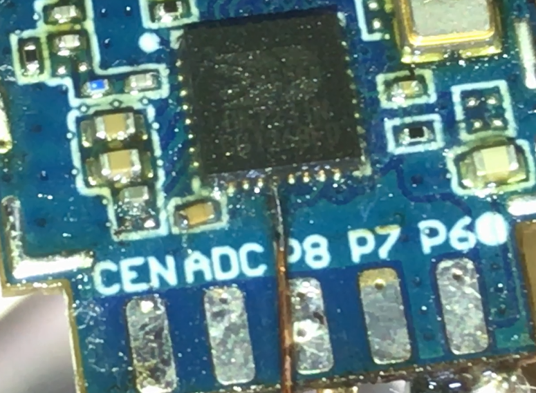

Here I will show you how to access the hardware MOSI pin, P16, on a common Tuya CB2S BK7231N module. The MOSI pin can be used for hardware SPI communication and also for driving individually addressable LEDs like WS2812 or SM16703, but it's not available on CB2S pads. We will have to solder a wire to one the QFN pads and then break it out.

Step 1: Removing CB2S shielding
Shield can be easily removed with hot air, large nozzle, and some extra flux to loosen the solder connection:

Step 2: Choosing where to route
The best option is to reuse one of the existing pads, for example CEN. I chosen to use CEN because I don't use it for flashing, I just do a power off/power on cycle and it works reliably. So, I had to cut the CEN trace:
Close-up of CB2S module with visible soldering points.
Close-up of a PCB showing traces and pads.
That way CEN is now disconnected from the pad and pad can be reused for our purposes.
Step 3: Preparing the wire
Get a thin wire, roughly of the size of the QFN pad. Strip the enamel from it. Tin the tip of the wire for easier soldering. You can use old broken transformer or a coil as a source of such wires.
Step 4: Soldering the wire
Once the wire is prepared, it's time to solder it to the correct pad of QFN case. Make sure that you have identifier the first pad directly - it's marked with a dot. You can use the crystal pads for orientation, just to check if you've correctly determined the orientation.
I have used a thin soldering tip for the soldering process, first I added flux and some Pb solder and then I finally made the connection:
Close-up of a CB2S module PCB with a thin wire soldered to a QFN pin.
Close-up of a soldered wire on an integrated circuit on a blue PCB.
Remember to clean the PCB with IPA before going to next step.
Step 5: Adding UV-curable solder mask
Now you can secure the connection with UV-curable solder mask. Otherwise the wire may get loose during module usage or storage. Apply solder mask and use UV to cure it:
CB2S BK7231N with MOSI wire highlighted under UV light Close-up of a Tuya CB2S module with a thin wire soldered to a QFN pad.
Step 6: Second solder joint
Finally it's time to solder the second end of the wire to the pad. Of course, it also have to be stripped from enamel. Then you can also solder futher wires to connect the module to the breadboard:
CB2S module with soldered wires on a breadboard Close-up of a Tuya CB2S module with wires soldered to the QFN pad.
