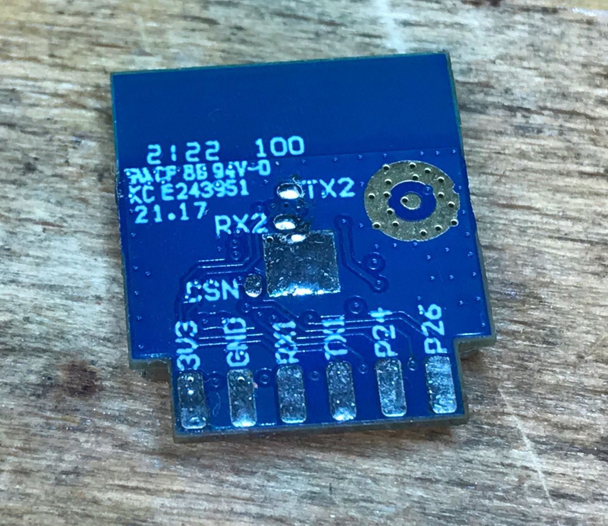

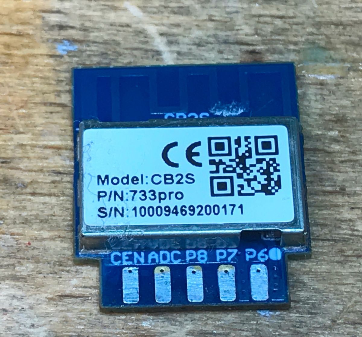

    Here I will show you how to access the hardware MOSI pin, P16, on a common Tuya CB2S BK7231N module. The MOSI pin can be used for hardware SPI communication and also for driving individually addressable LEDs like WS2812 or SM16703, but it's not available on CB2S pads. We will have to solder a wire to one the QFN pads and then break it out.
    Step 0: Considerations

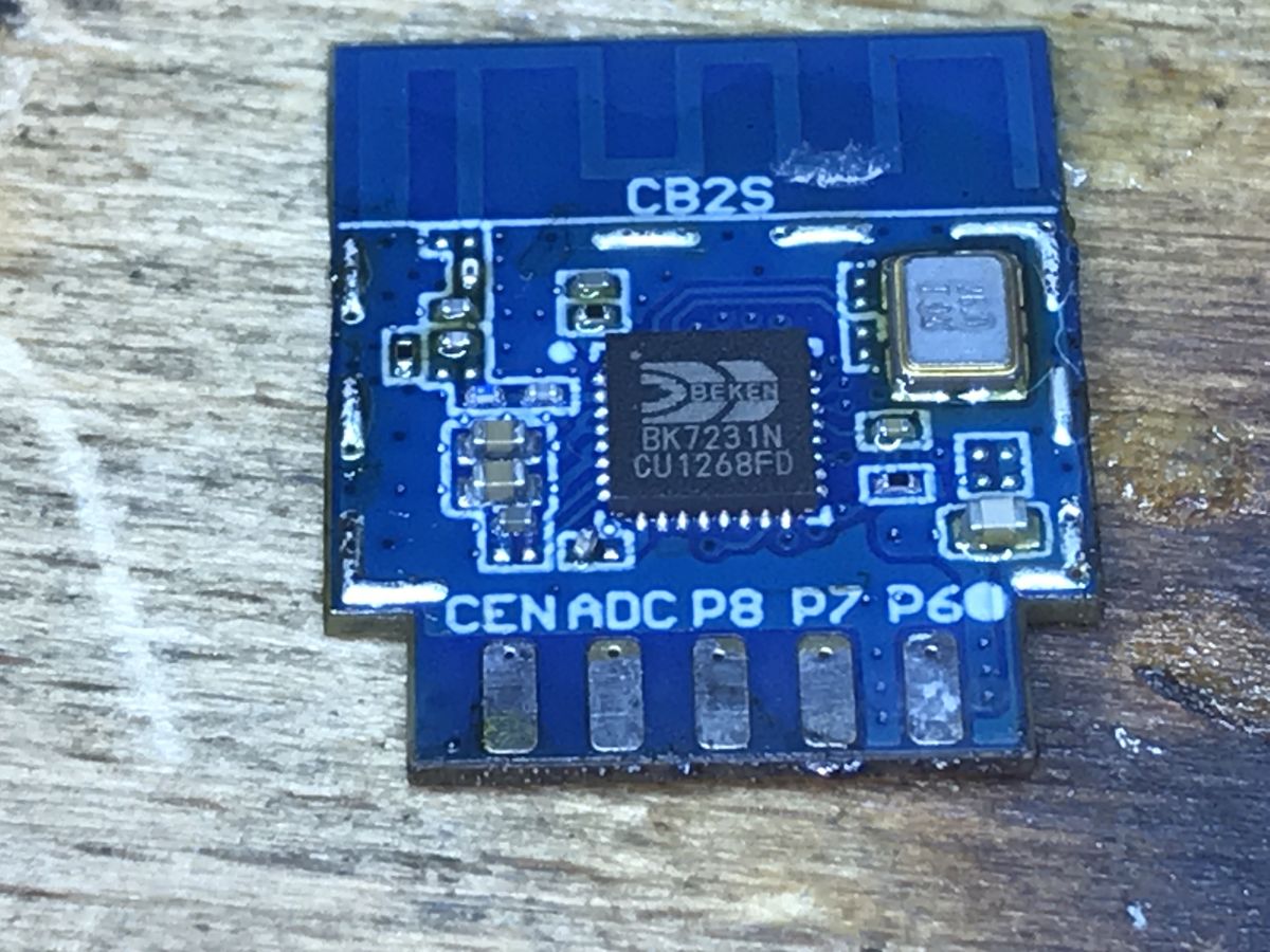

    Let's consider the CB2S module:
    Image of a Tuya CB2S BK7231N module on a wooden surface. Tuya CB2S BK7231N module with visible pins and QR code. Close-up of a Tuya CB2S module with exposed shielding and visible soldering pads.
    Most commonly used GPIOs are routed to the pads, there are also some debug GPIO pads at the bottom of the module, but P16 is nowhere to be found. Still, we can check the pinout of the QFN BK7231 IC itself, to find that it should be available, at least on the QFN pad:
    Pin configuration diagram of BK7231T chip
    This means that the designer of CB2S module must have skipped this pin. We are going to fix that now.

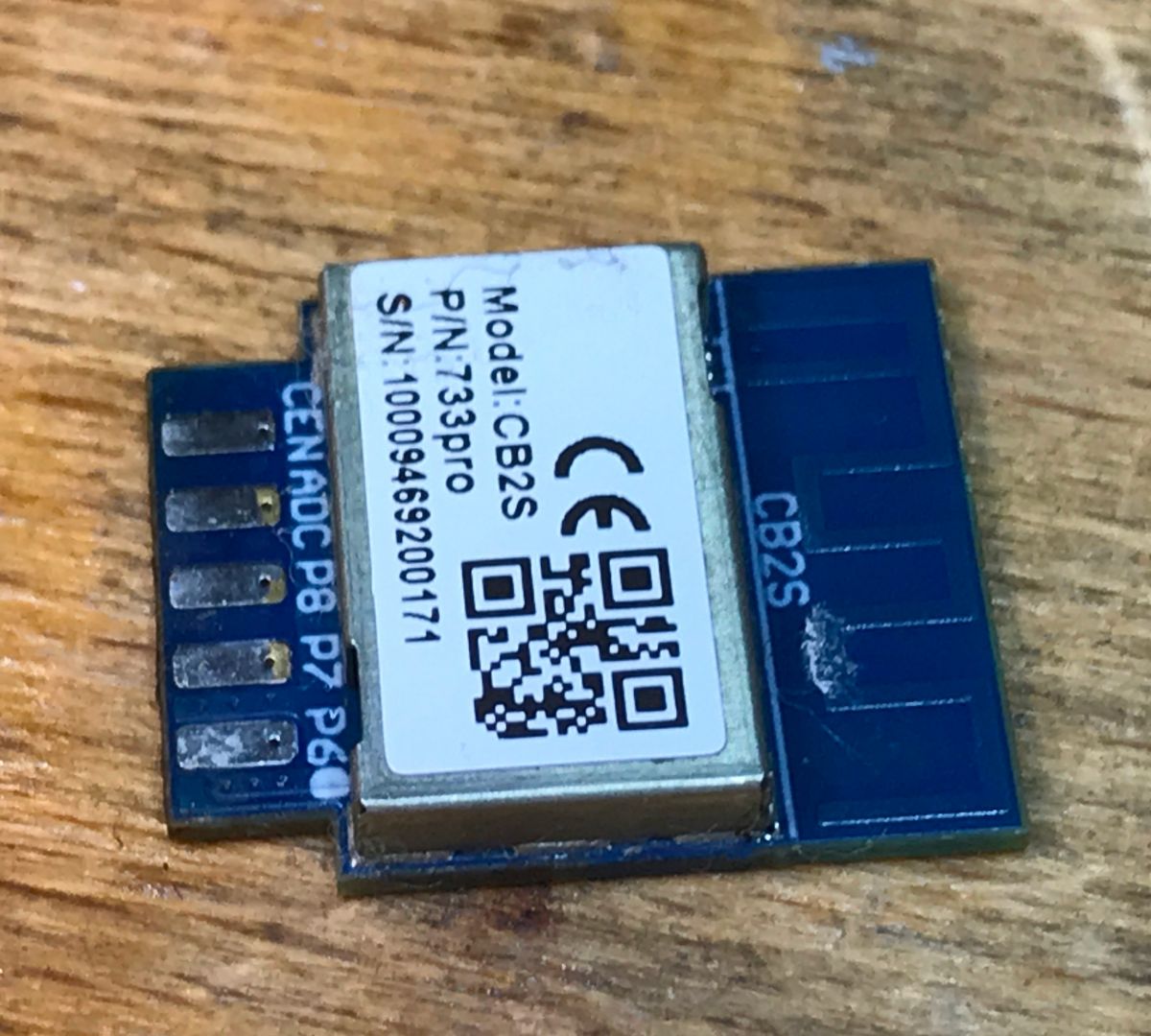

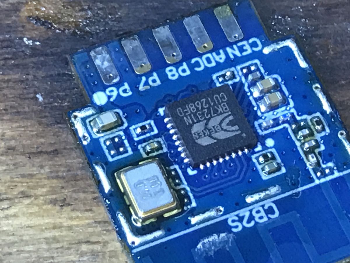

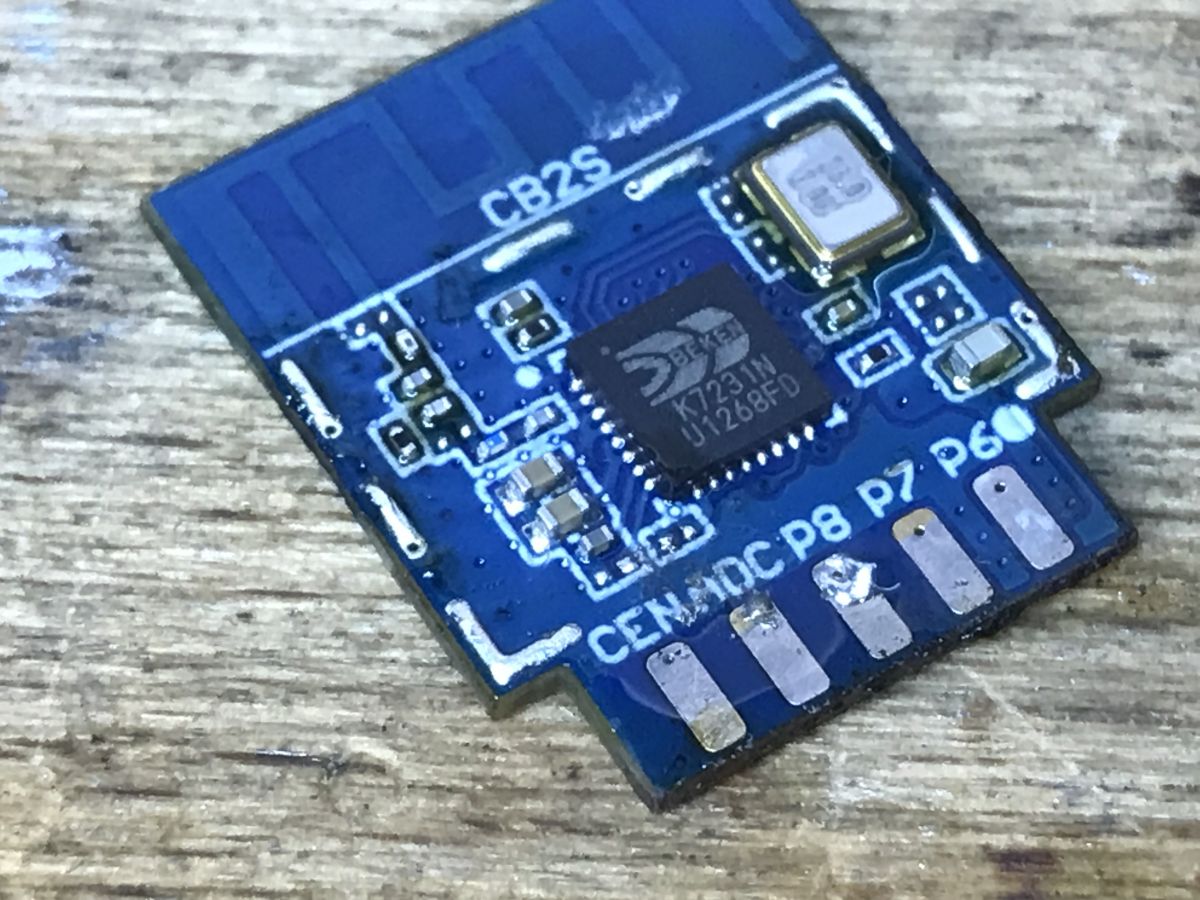

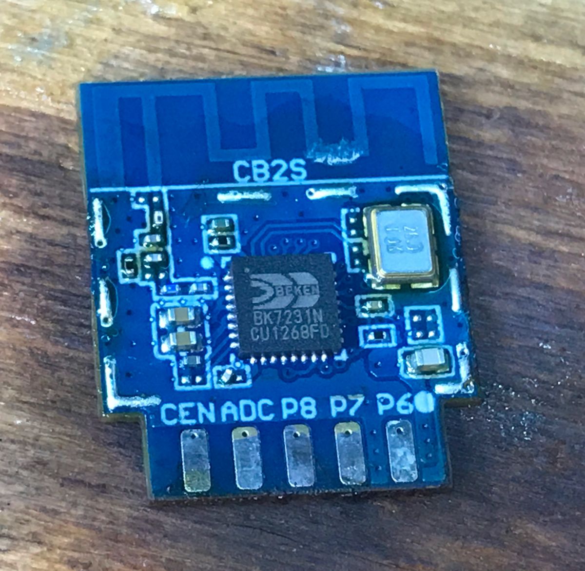

    Step 1: Removing CB2S shielding
    Shield can be easily removed with hot air, large nozzle, and some extra flux to loosen the solder connection:
    Photo of a Tuya CB2S module with a visible BK7231N chip on a wooden background. Close-up of Tuya CB2S BK7231N module with QFN chip. Close-up of the CB2S BK7231N module with visible pads and microchip. Tuya CB2S module with BK7231N chip and pad markings on the board.
    On the pictures, I have also accidentally desoldered the 100nF power supply decoupling capacitor. This needs to be fixed before using module again:
    Sharp tip of a soldering tool on a wooden background

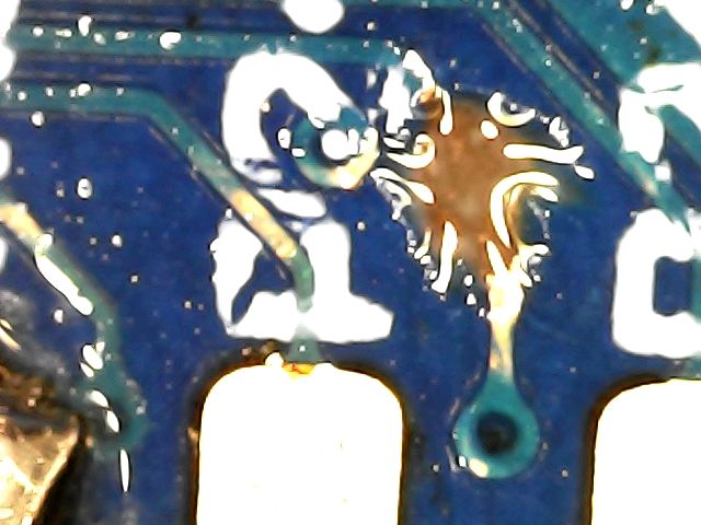

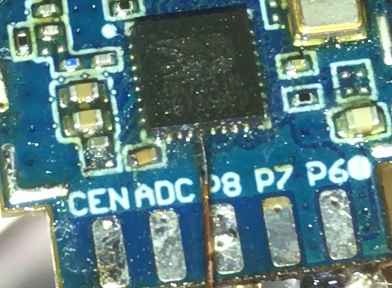

    Step 2: Choosing where to route
    The best option is to reuse one of the existing pads, for example CEN. I chosen to use CEN because I don't use it for flashing, I just do a power off/power on cycle and it works reliably. So, I had to cut the CEN trace:
    Close-up of CB2S module with visible soldering points.
    Close-up of a PCB showing traces and pads.
    That way CEN is now disconnected from the pad and pad can be reused for our purposes.

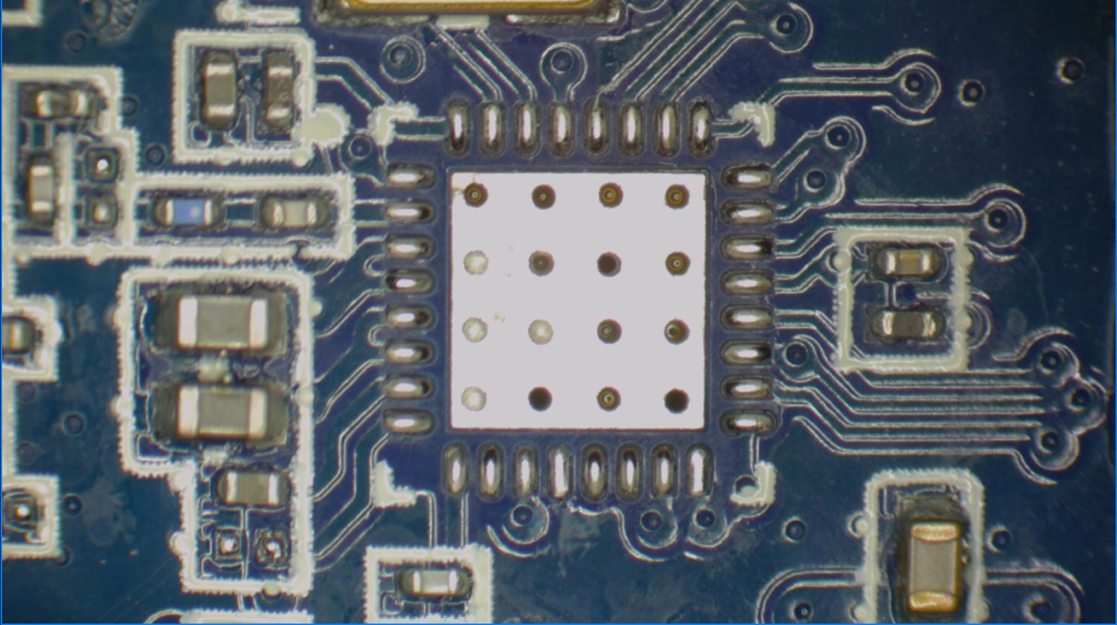

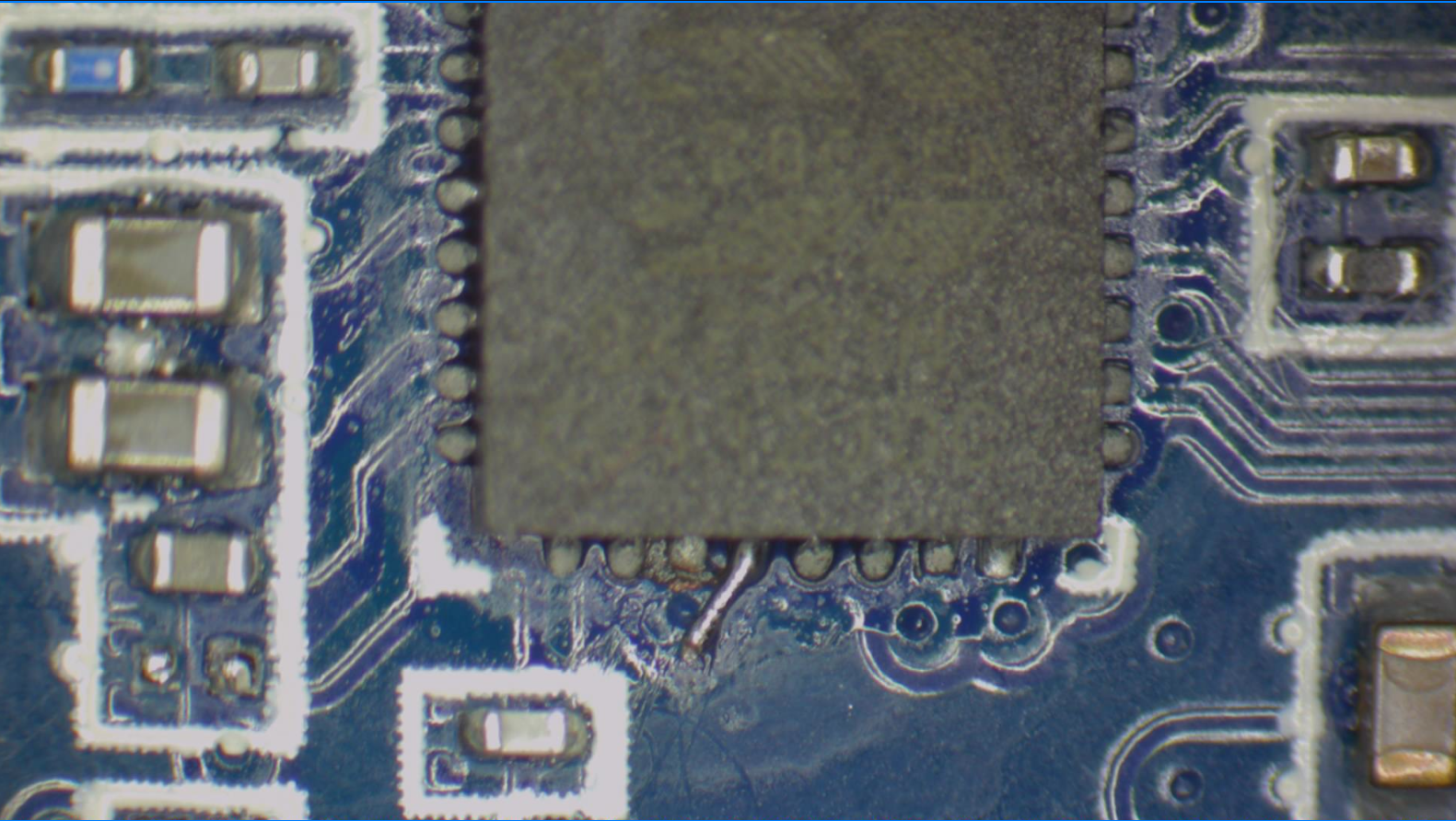

    Get a thin wire, roughly of the size of the QFN pad. Strip the enamel from it. Tin the tip of the wire for easier soldering. You can use old broken transformer or a coil as a source of such wires.

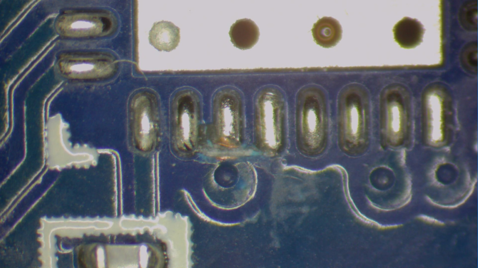

    Step 4: Soldering the wire
    Once the wire is prepared, it's time to solder it to the correct pad of QFN case. Make sure that you have identifier the first pad directly - it's marked with a dot. You can use the crystal pads for orientation, just to check if you've correctly determined the orientation.
    I have used a thin soldering tip for the soldering process, first I added flux and some Pb solder and then I finally made the connection:
    Close-up of a CB2S module PCB with a thin wire soldered to a QFN pin.
    Close-up of a soldered wire on an integrated circuit on a blue PCB.
    Remember to clean the PCB with IPA before going to next step.

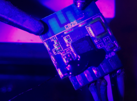

    Step 5: Adding UV-curable solder mask
    Now you can secure the connection with UV-curable solder mask. Otherwise the wire may get loose during module usage or storage. Apply solder mask and use UV to cure it:
    CB2S BK7231N with MOSI wire highlighted under UV light Close-up of a Tuya CB2S module with a thin wire soldered to a QFN pad.

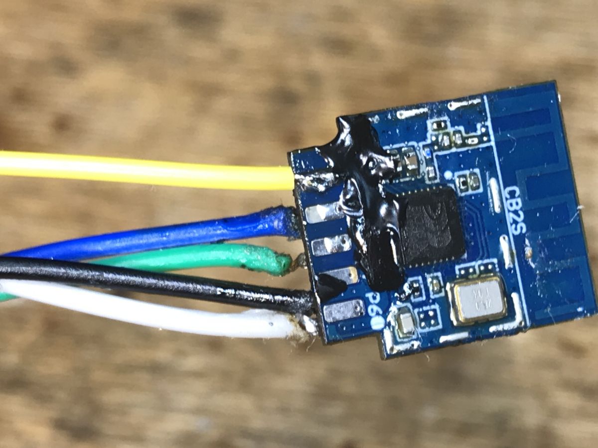

    Step 6: Second solder joint
    Finally it's time to solder the second end of the wire to the pad. Of course, it also have to be stripped from enamel. Then you can also solder futher wires to connect the module to the breadboard:
    CB2S module with soldered wires on a breadboard Close-up of a Tuya CB2S module with wires soldered to the QFN pad.
    Summary

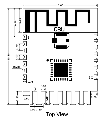

    That way you can break out the P16 (MOSI) on the common CB2S module. The same method can also work for similiar modules like CB3S, etc. Alternatively you can look for module that has P16 already available on pads like CBU module:
    Technical drawing of the CB2S module with dimension and pin markings.

    Test pointCSNI/OMode selection pin. If it is connected to the ground before being powered on, enter the firmware test mode. If it is not connected or connected to VCC before being powered on, enter the firmware application mode. Correspond to Pin 19 on the internal IC.
    But CBU module seems to be less popular and less accessible than the CB2S/CB3S so the presented method can be useful is some cases.

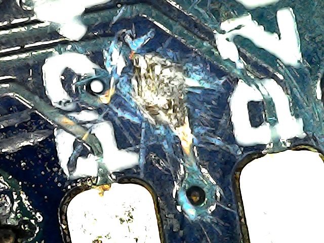

    Here is how you can mode CB3S module. I've cut P14 pad from the via and connected P16 to that via so I can have easier access to P16 for testing. Everything is reversable if need be.
    Close-up of a printed circuit board with a chip module and soldering traces. Close-up of electronic components on a blue printed circuit board. Close-up of a modified CB3S module board with exposed soldered connections.
