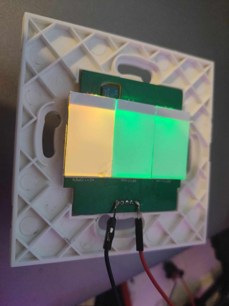

It is difficult to open the whole switch because the pins going to the board are not plugged in, but soldered. I wasn't able to desolder them. I lifted the board and soldered only RX and TX (according to the CB3S module documentation), and connected the power supply to the extreme pins on the board (see photo), where GND is on the left - the same as the OPEN button.
VCC and GND:
Electronic switch with connected wires and colored backlighting.

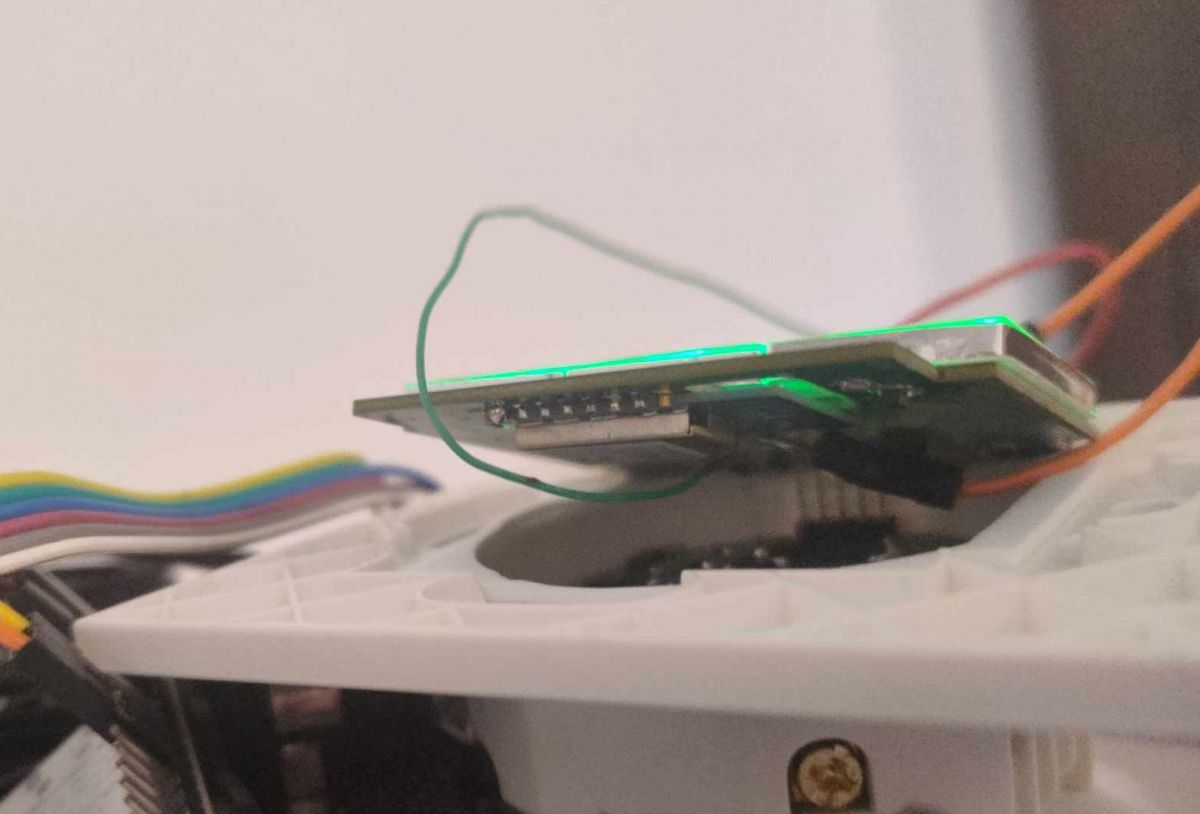

RX and TX:
Printed circuit board with attached wires on a white base.
I started the flashing mode by shorting GND to CEN.
The flashing application is not able to read the settings automatically. I had to find all the exits myself. Here they are:
P6 (PWM0) "WifiLED_n;0"
P7 (PWM1) "Btn;2"
P8 (PWM2) "LED_n;2"
P9 (PWM3) "Btn;1"
P14 (N/A) "Rel;3"
P23 (ADC3) "Btn;3"
P24 (PWM4) "LED;3"
P26 (PWM5) "Rel;1"
