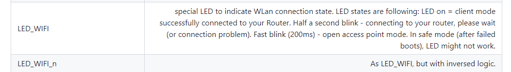

    IO docs:
    https://github.com/openshwprojects/OpenBK7231T_App/blob/main/docs/ioRoles.md
    LED is on when linked channel is on, LED_n has inverted state (it's on when channel is off), WiFILED shows WiFi state, WIFILED_n is inverted WifiLED.
    Those roles are GPIO roles, they are per single GPIO. It's not possible to change color with that due to the hardware limitations. You can only send high or low state.
    That is, unless, they are two LEDs on the pin... then, it's very possible that you can switch the colors (reverse them) by changing LED to LED_n or vice versa.
    It's relatively hard for me to be more specific because I don't know the hardware you're operating on. How are LEDs connected?

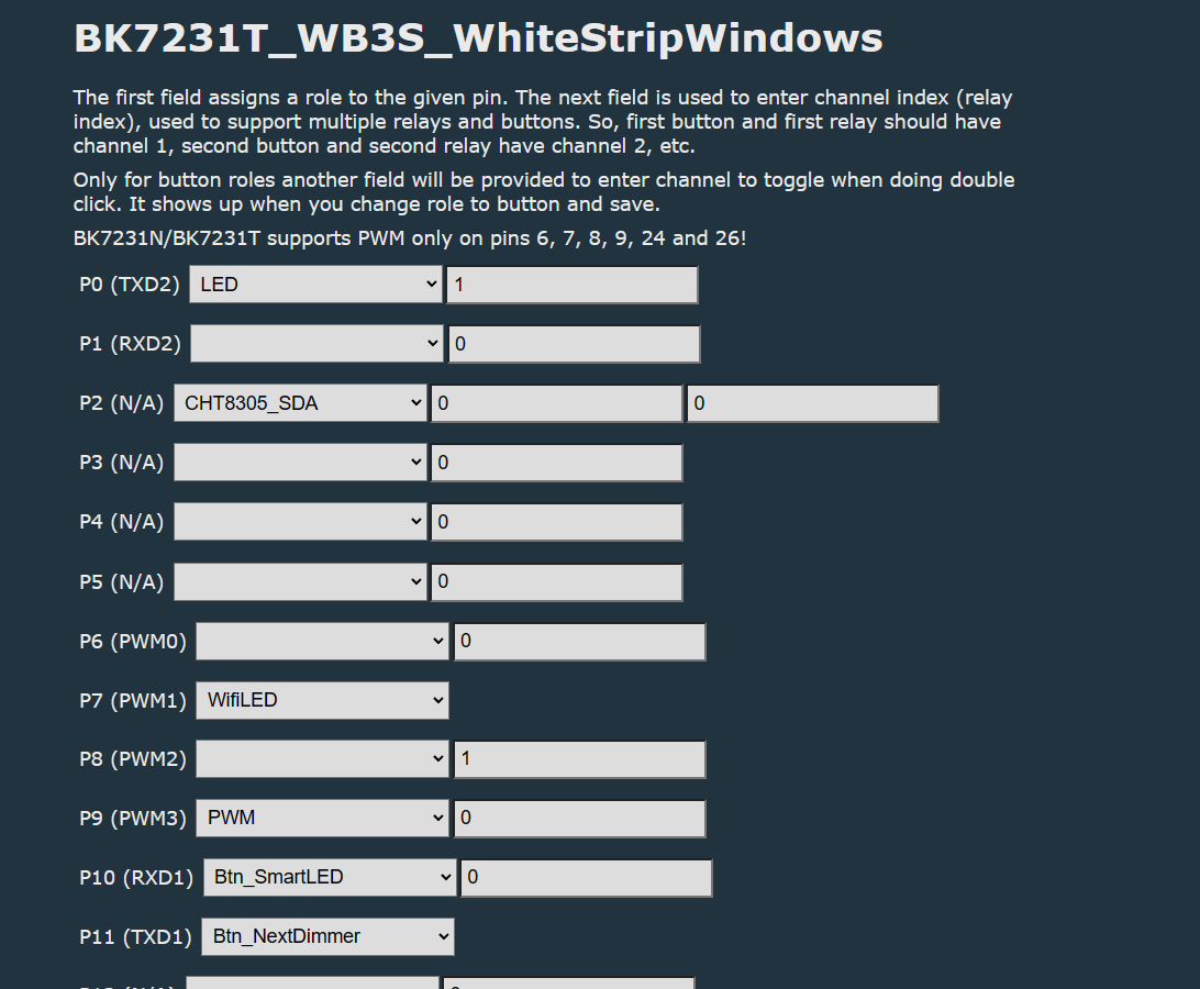

    Maybe you can backup your configuration, open OBK web app, go to GPIO Doctor and play around there.
  • GPIO finder mapping for LED color and button control
    #8 20978313
    hezipereg
    Posts: 19
    I managed to switch the LED color by playing with it in GPIO finder.
    The correct configuration for me is:
    "pins": {
        "6": "Rel_n;0",
        "7": "Btn;2",
        "8": "LED_n;2",
        "9": "Btn;1",
        "14": "Rel;3",
        "23": "Btn;3",
        "24": "LED_n;3",
        "26": "Rel;1"
    Additionally, changing "6": "WifiLED_n;0" to "6": "Rel_n;0" allowed me to add a button which turn on/off the LEDs. This can be used for example to turn off the LEDs during day time when the sun is up.

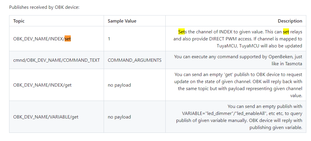

    Which channel stores this value in autoexec.bat ? You can set any channel via MQTT with set topic:

    Well, the LEDs are defined in the "Configure module" tab and there is a field to enter a linked channel number, see an example below:
    Configuration of BK7231T_WB3S module pins with assigned channels and roles for each pin.
    What do you want to do with that LED? Is your LED on P6?
    If you set a channel, let's say, channel 5 for P6, and set LED role for P6, then you will be able to control this LED manually via channel 5.
    If you want then to manually toggle channel 5 (the one that has linked LED now), you can write in script:
    toggleChannel 5
    or
    setChannel 5
    The following line will toggle channel 5 and all LEDs and RELs (and LED_n, and REL_n) on this channel will follow.
    Alternatively, you can set P6 (your LED) role to WIFILED_n, then it will automatically without channel and display your WiFi state.

    There are two ways to control LEDs.
    - first way is to assign a LED (or a LED_n, which is inversed LED) role and a channel, then LED will follow the channel and will be scriptable and controllable by user
    - the second way is to assign a WiFiLED role, which will make LED display the WiFi state (fast blinking when connecting, etc, etc, on when connected, etc)
    You can read more about IO roles here:
    Table describing the states of LED WiFi and LED WiFi_n.
    hezipereg wrote:
    I didn't understand what you said regarding
    In that case, how will I be able to turn on/off the LEDs?
    WIFI_LED is not controllable by user, it just displays the state of your WiFi connection. If you want to be able to manually control the LED, then choose LED (or LED_n) state.
    Some Tuya devices have two onboard LEDs and in their case users choose to configure first LED as WiFiLED_n to display WiFi state and to configure second LED as LED on the same channel which Relay is using to display the relay state.

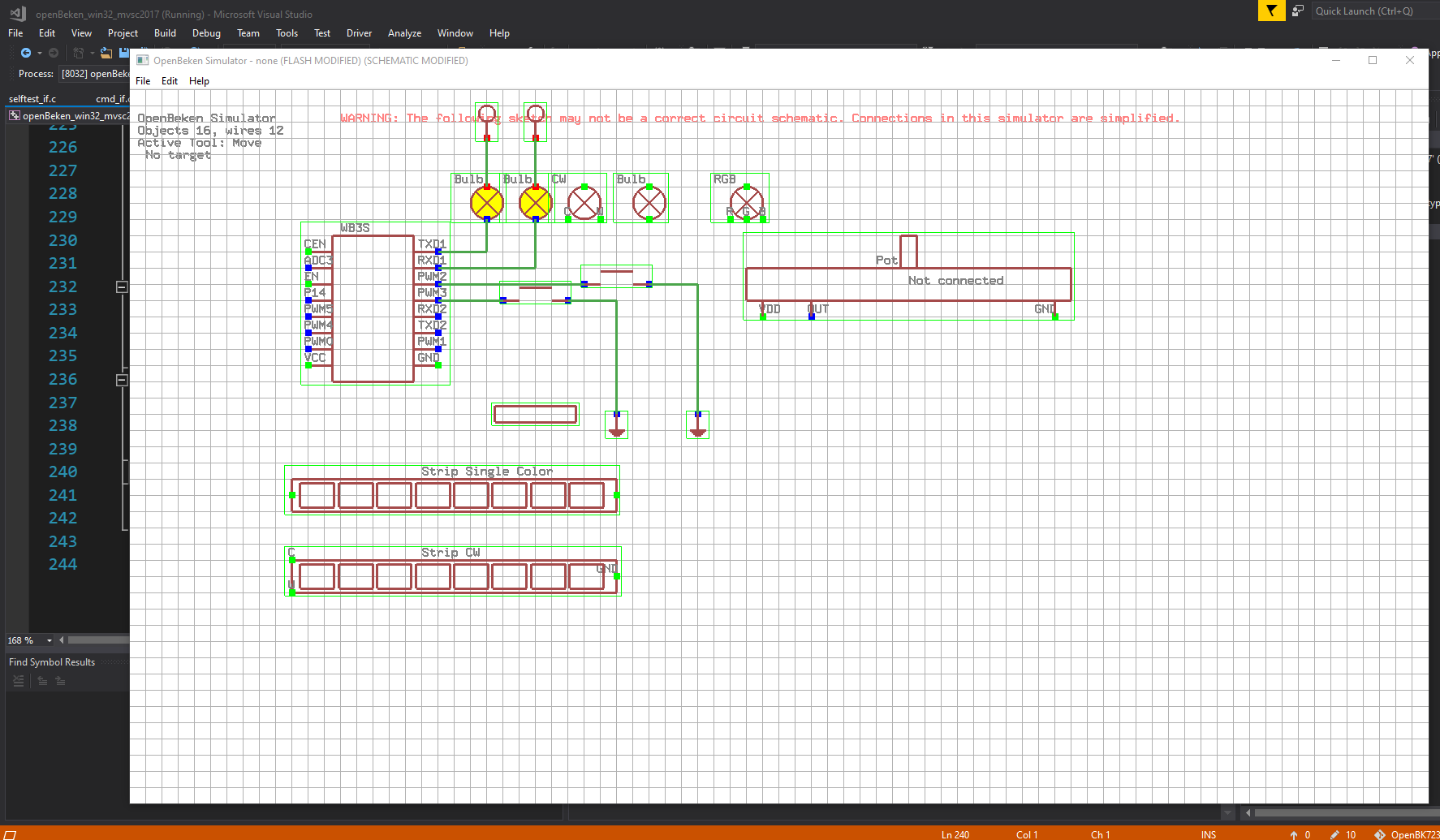

    The VS project is for Windows Simulator, which I use to quickly debug things. It allows you to run virtual OBK device on Windows:
    OpenBeken simulator diagram with electronic circuit on a grid.

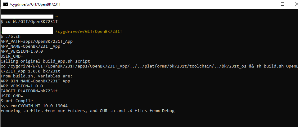

    To compile BK7231 build, you need to either:
    1. use online github builds:
    https://www.elektroda.com/rtvforum/topic4033833.html
    2. checkout SDK, either T or N:
    https://github.com/openshwprojects/OpenBK7231N
    checkout app to the SDK:
    so your path is:
    C:/Anything/GIT/OpenBK7231T/apps/OpenBK7231T_App
    run build in cygwin
    Screenshot of script compilation in Cygwin terminal for the BK7231T platform.
  • #30 20990439
    hezipereg
    Posts: 19
    You need to create a branch. Issues are irrevelant for creating PR.
    I don't have the open branch button available.
    run build in cygwin
    I tried to build using wsl. I get: ./b.sh: 1: ./build_app.sh: not found
    I tried calling ./build_app.sh apps/OpenBK7231T_App OpenBK7231T_App 1.0.0 and got ./build_app.sh: bad interpreter: /bin/sh^M: no such file or directory
