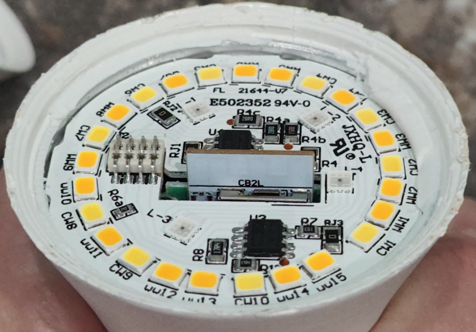

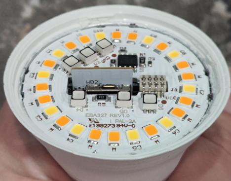

Light bulbs can be opened using a utility knife, cutting and prying around the diffuser base.
I could not remove the module, but the model can be clearly seen. It's WB2L (BK7231T) for type A, and CB2L (BK7231N) for type B.

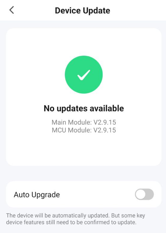

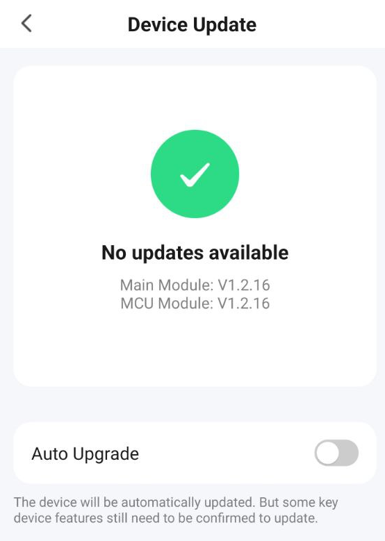

After pairing with Tuya Android app, it can be seen (see screenshots) that type A uses firmware version 2.9.15, type B uses version 1.2.16.

- Select 2.9.15 - BK7231T for type A and 1.2.16 - BK7231N for type B;
