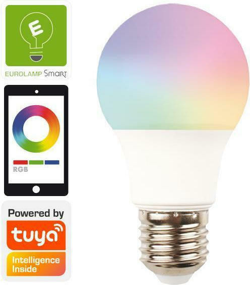

Here is a really quick teardown of two EUROLAMP RGBW bulbs, an E27 and a GU10.
From what I've gathered, this brand is exclusively in the Greek market, so you probably won't ever see it.
E27:
https://www.eurolamp.gr/en/product/Smart_Worl..._LED_BULB_A60_9W_E27_RGBW_220-240V-147-77901/
This one was my first lab rat, and I had a small accident as you will notice in a bit 😅
It uses the BK7321N CB2L module and the BP1658 driver.
EUROLAMP RGBW smart bulb with Tuya logo and mobile app illustration DSCF76..jpg (4.12 MB)You must be logged in to download this attachment. DSCF76..jpg (3.13 MB)You must be logged in to download this attachment. DSCF76..jpg (3.22 MB)You must be logged in to download this attachment. DSCF76..jpg (1.72 MB)You must be logged in to download this attachment.
