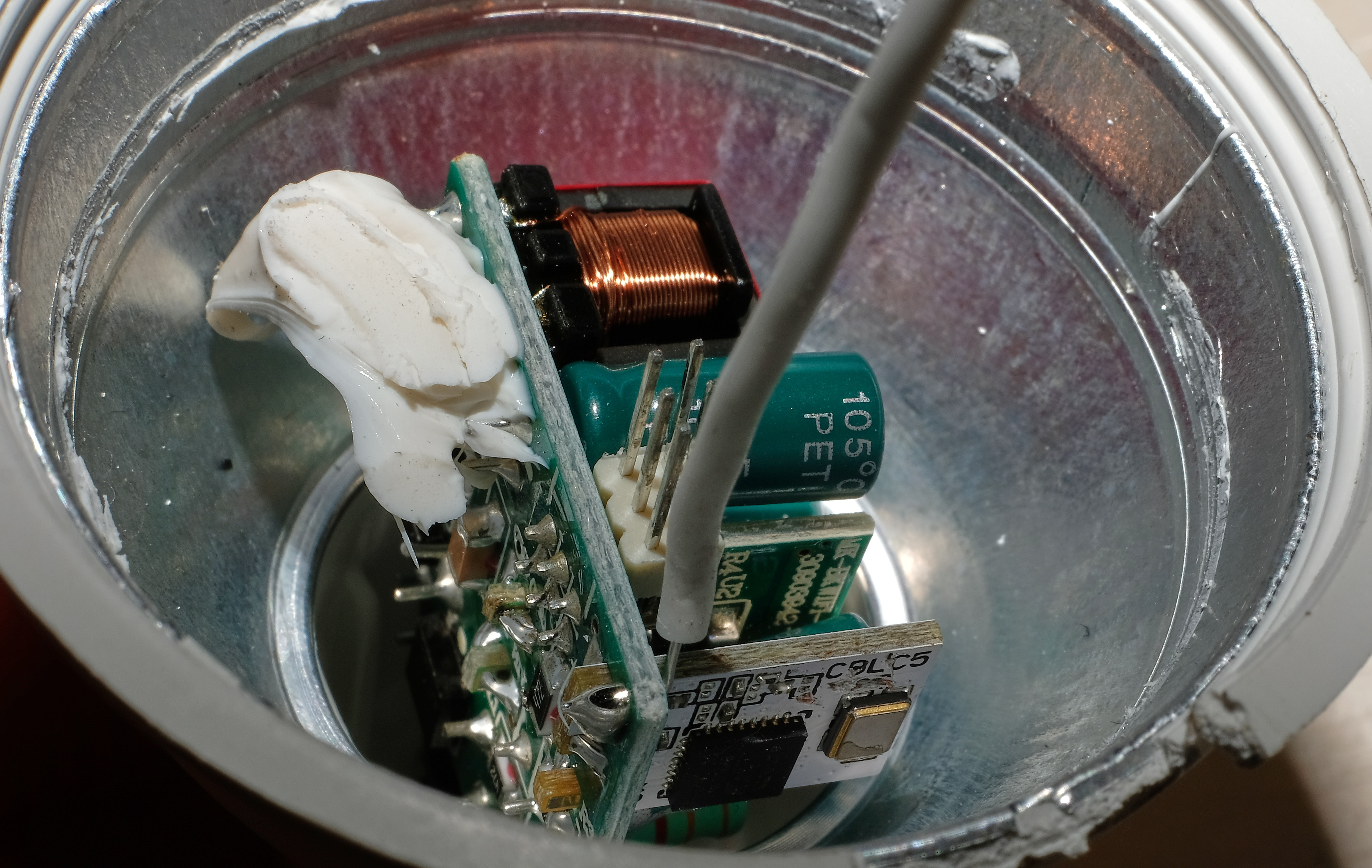

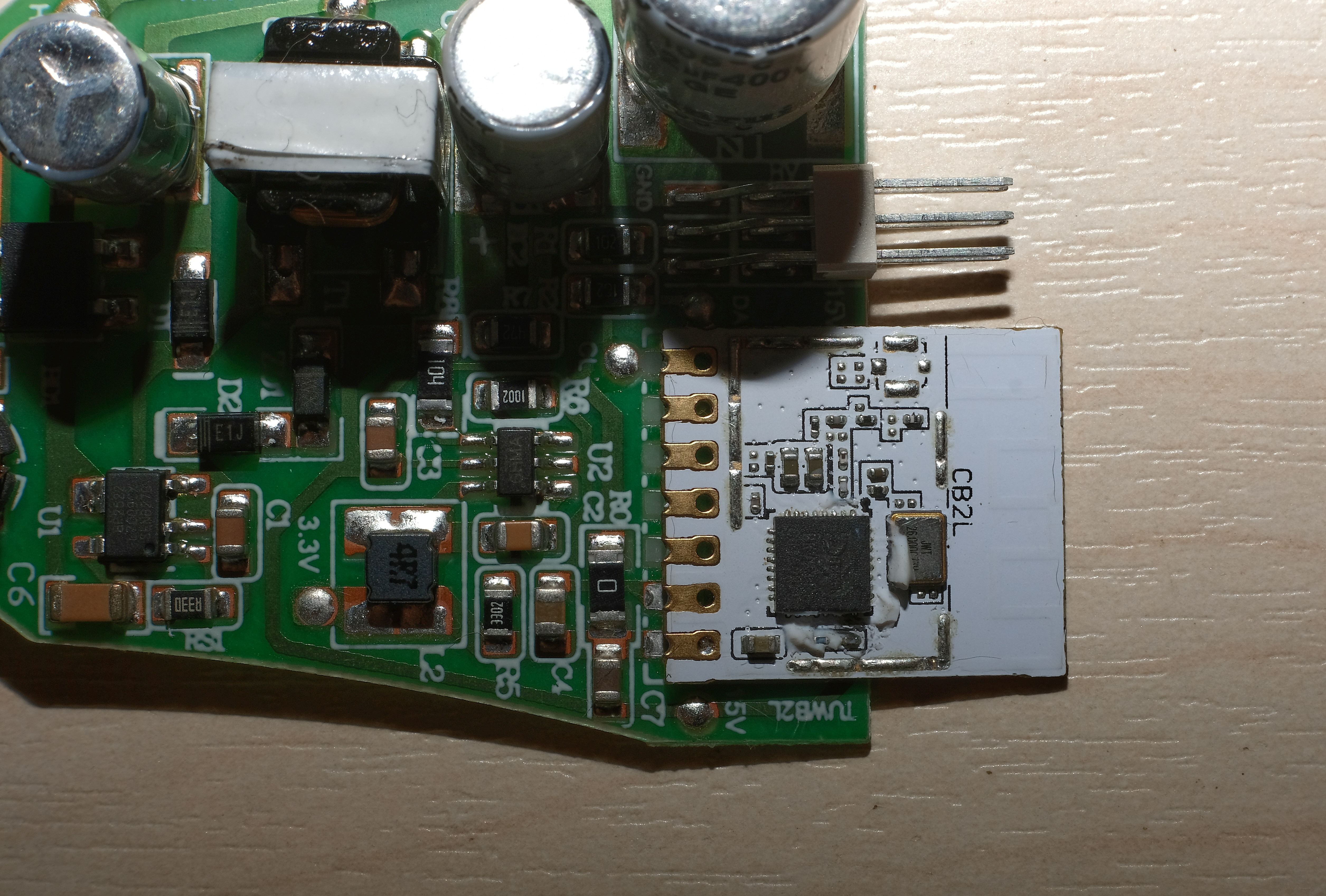

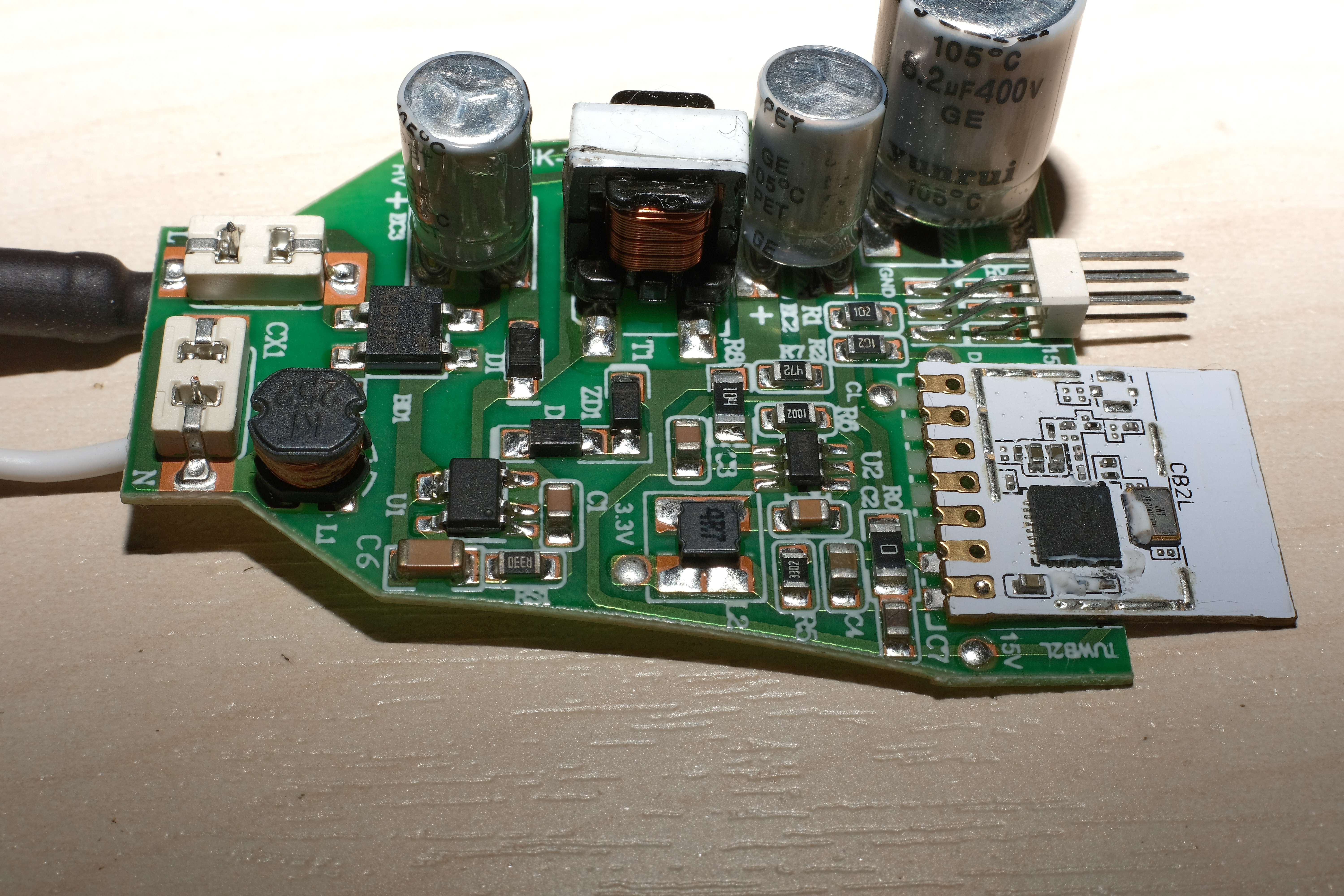

  • Here is a really quick teardown of two EUROLAMP RGBW bulbs, an E27 and a GU10.
    From what I've gathered, this brand is exclusively in the Greek market, so you probably won't ever see it.
    E27:
    https://www.eurolamp.gr/en/product/Smart_Worl..._LED_BULB_A60_9W_E27_RGBW_220-240V-147-77901/
    This one was my first lab rat, and I had a small accident as you will notice in a bit 😅

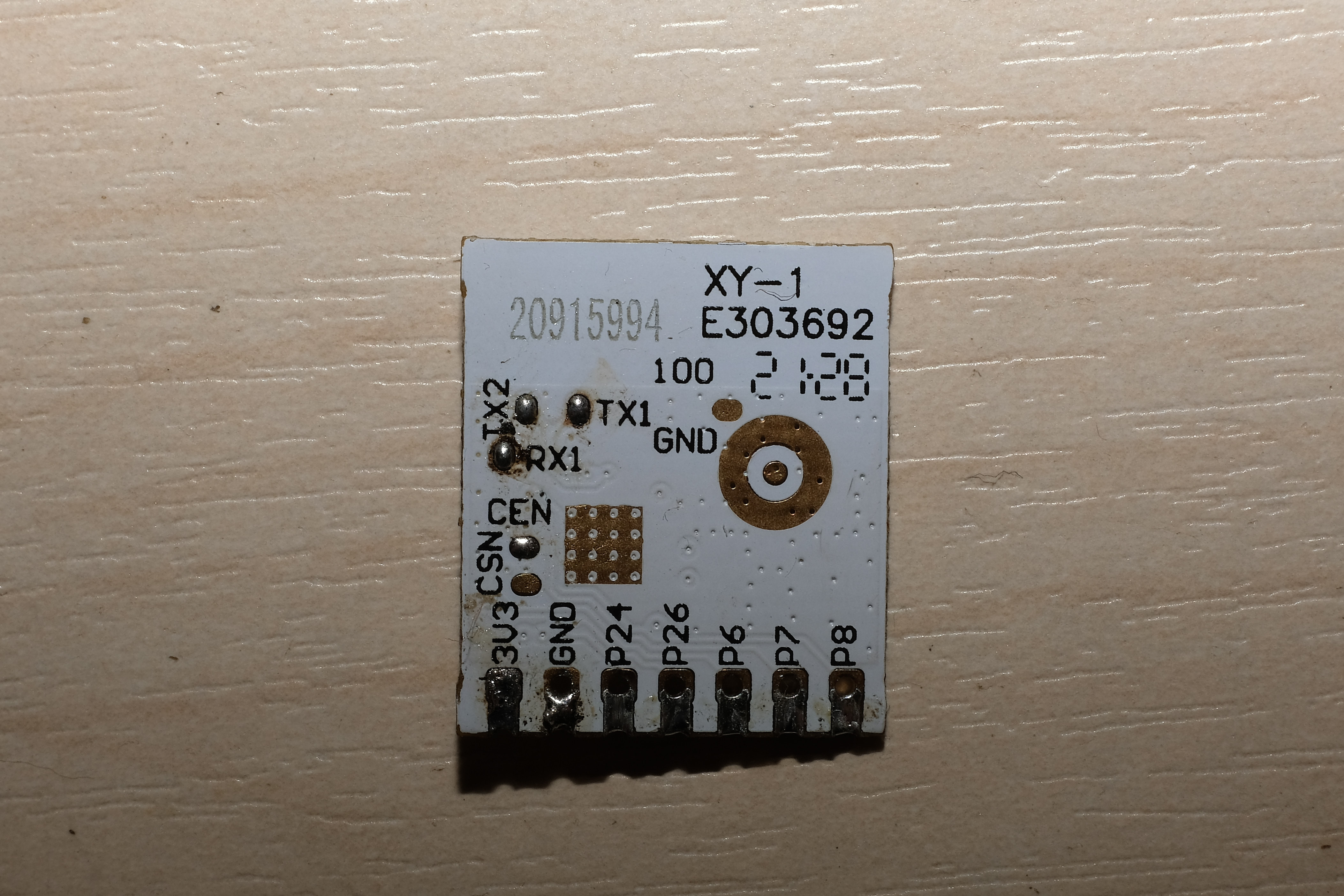

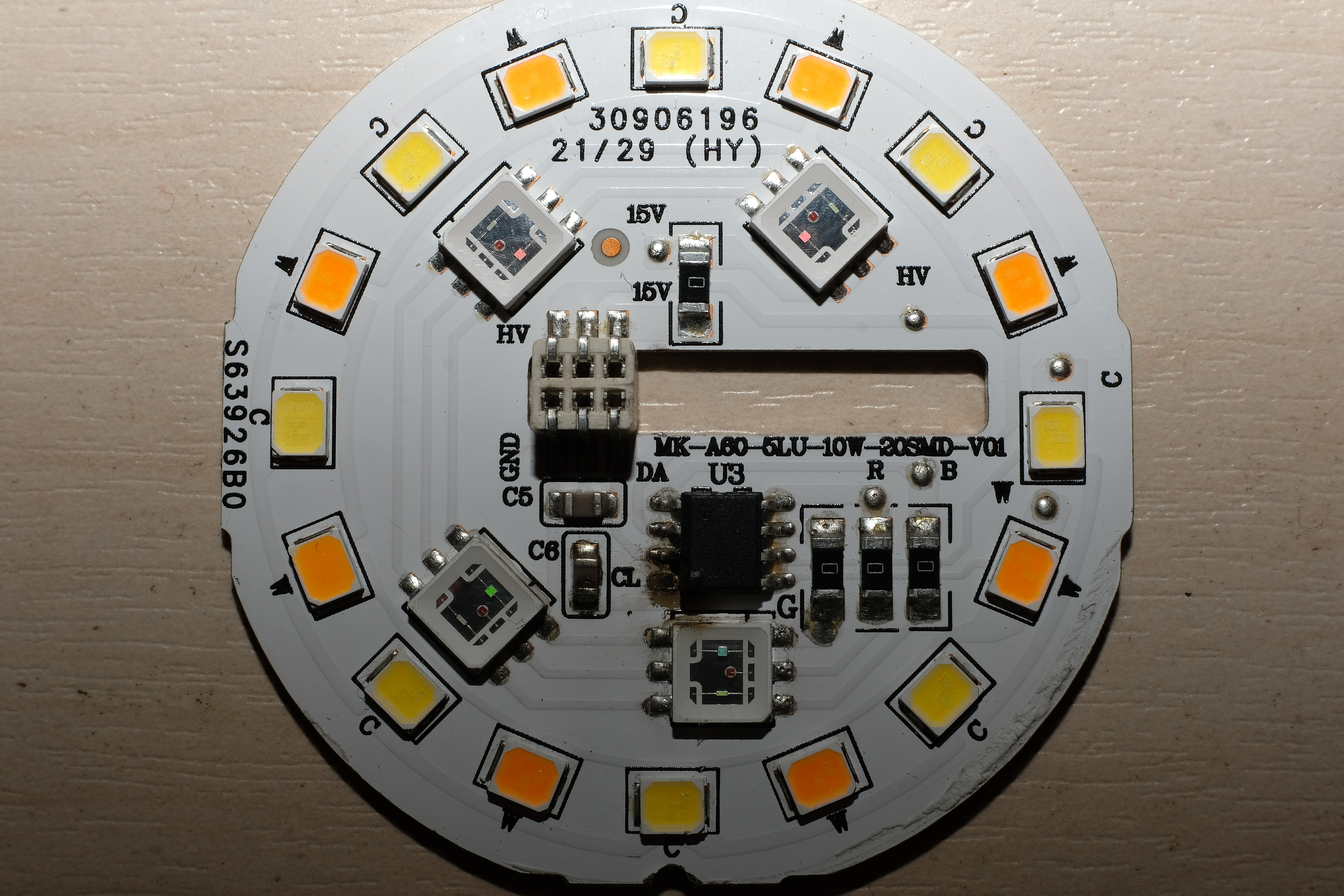

    It uses the BK7321N CB2L module and the BP1658 driver.
    EUROLAMP RGBW smart bulb with Tuya logo and mobile app illustration Teardown of EUROLAMP Smart Wifi RGBW E27 and GU10 Bulbs with BK7321N and BP1658 ModulesDSCF76..jpg (4.12 MB)You must be logged in to download this attachment. Teardown of EUROLAMP Smart Wifi RGBW E27 and GU10 Bulbs with BK7321N and BP1658 ModulesDSCF76..jpg (3.13 MB)You must be logged in to download this attachment. Teardown of EUROLAMP Smart Wifi RGBW E27 and GU10 Bulbs with BK7321N and BP1658 ModulesDSCF76..jpg (3.22 MB)You must be logged in to download this attachment. Teardown of EUROLAMP Smart Wifi RGBW E27 and GU10 Bulbs with BK7321N and BP1658 ModulesDSCF76..jpg (1.72 MB)You must be logged in to download this attachment.

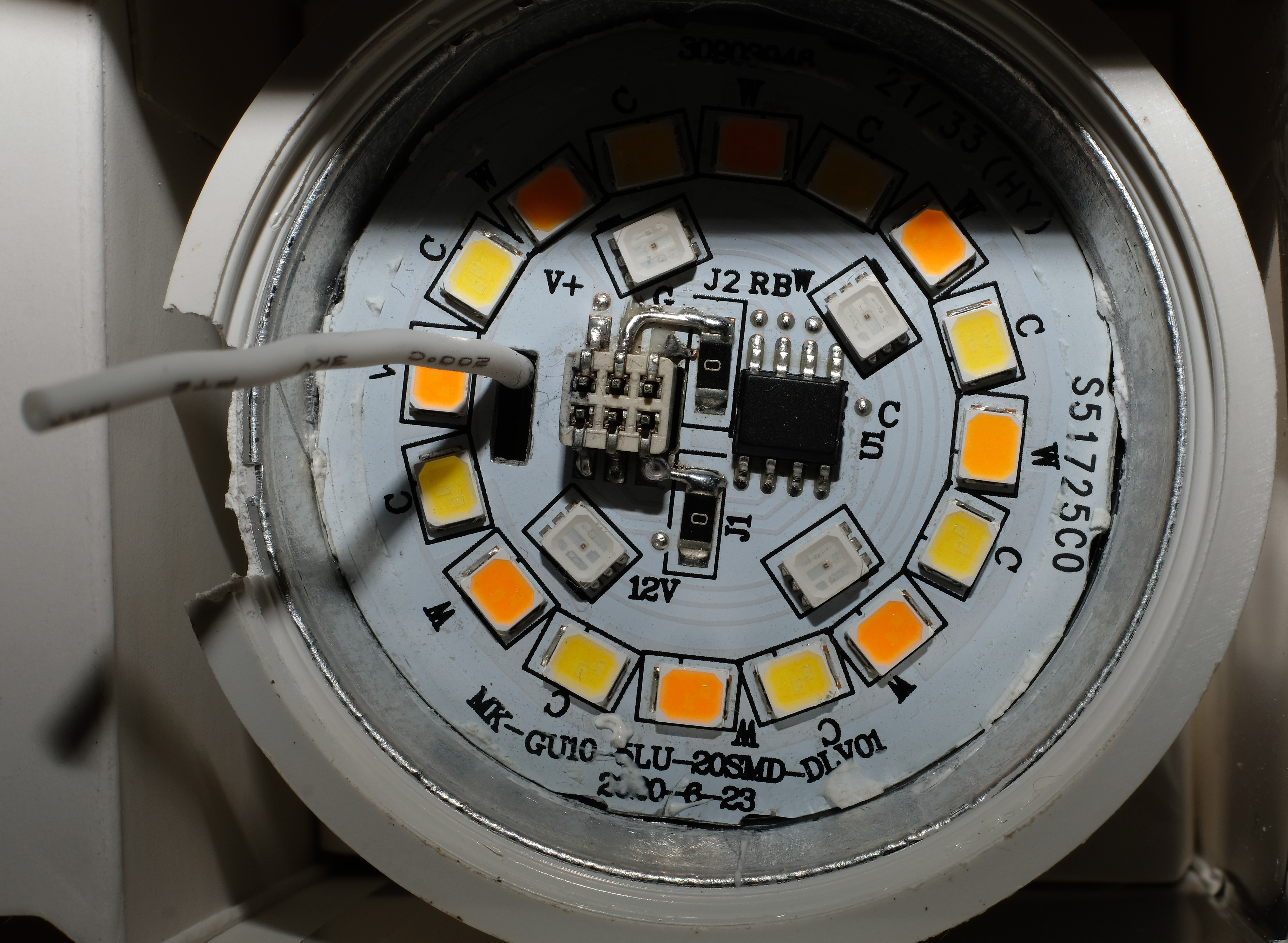

    GU10:
    https://www.eurolamp.gr/en/product/Smart_Worl...ART_WiFi_LED_GU10_6W_RGBW_220-240V-147-77903/

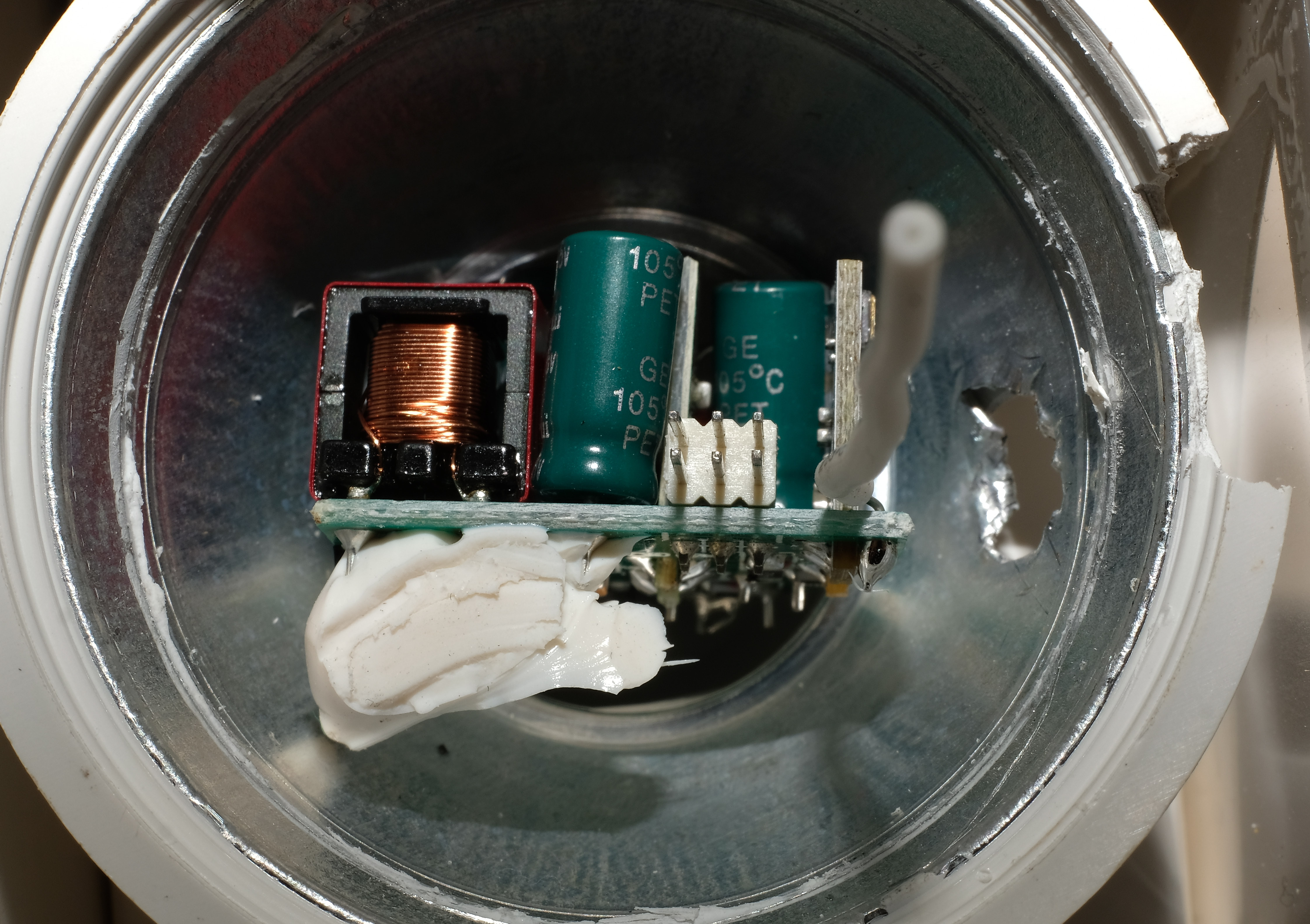

    When opening this one, be careful as the WiFi antenna is folded just under the cap; if you accidentally change its shape, it will not work.
    Also, the LED PCB/heatsink is glued to the main board, so don't try to pry it (because you'll tear the pads and need to repair it lol).
    It uses the BK7321N CBLC5 module and the BP1658 driver.
    EUROLAMP GU10 RGBW bulb with EUROLAMP Smart logo and app control graphic. Teardown of EUROLAMP Smart Wifi RGBW E27 and GU10 Bulbs with BK7321N and BP1658 ModulesDSCF76..jpg (1.68 MB)You must be logged in to download this attachment. Teardown of EUROLAMP Smart Wifi RGBW E27 and GU10 Bulbs with BK7321N and BP1658 ModulesDSCF76..jpg (2.01 MB)You must be logged in to download this attachment. Teardown of EUROLAMP Smart Wifi RGBW E27 and GU10 Bulbs with BK7321N and BP1658 ModulesDSCF76..jpg (2.73 MB)You must be logged in to download this attachment.
