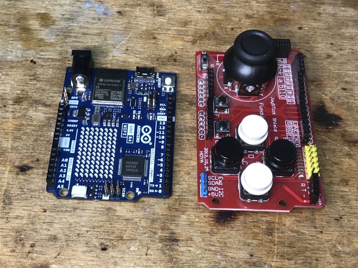

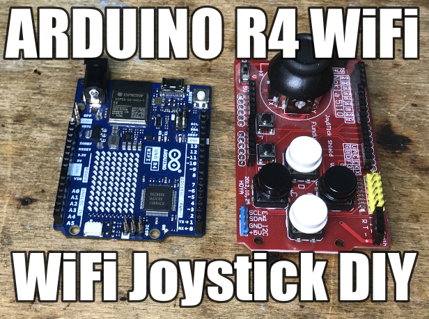

I will show here how we can make our own wireless gamepad based on Arduino R4 WiFi and Joystick shield. Our controller will connect to our WiFi network and send pressed key data to our server via UDP connectionless protocol, which will provide us with fast response to pressed keys.
We will basically only need the title Arduino R4 WiFi and the title joystick shield, to be bought for about a dozen zlotys:
Joystick Shield V1.2 for Arduino with four buttons on a red board.

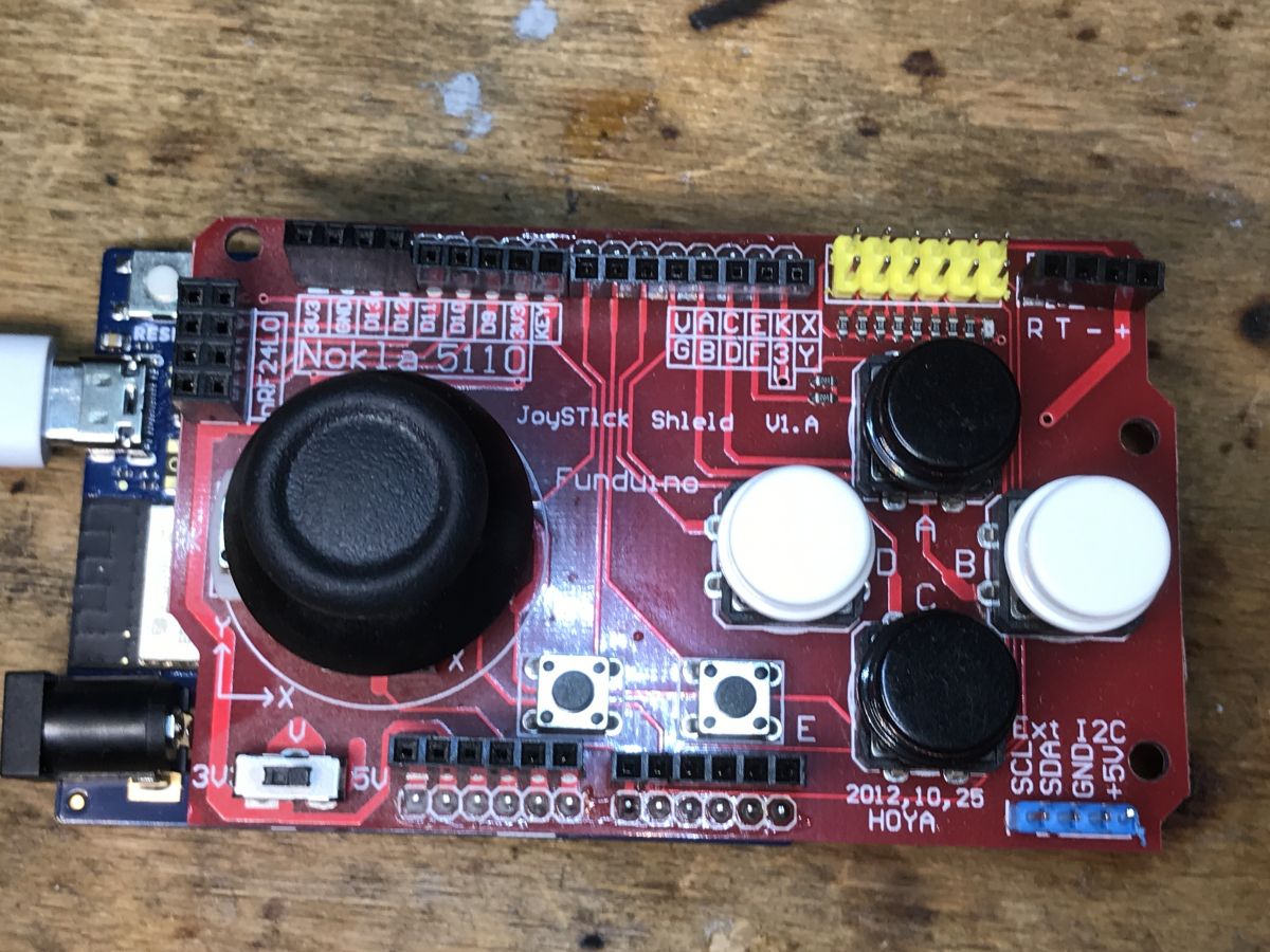

Here it should be noted that this shield offers two types of control:
- the joystick itself allows analog control, by this I mean that the value read from its potentiometers faithfully reflects the bias of the knob
- the buttons, as buttons do, give us only boolean information, true or false, pressed or not
The joystick's analog control capability allows us to be more precise in moving whatever we happen to be controlling.

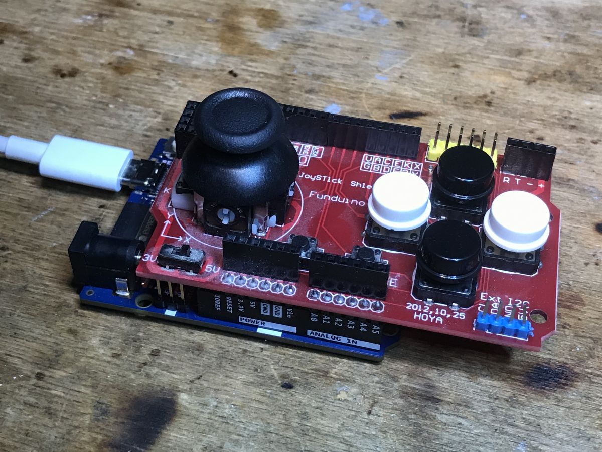

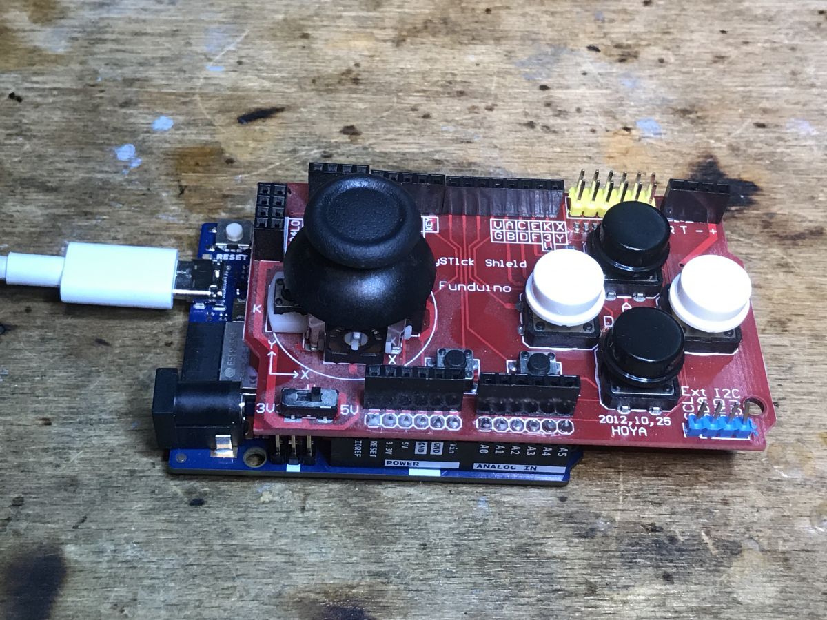

The joystick shield fits on the Arduino R4, as it has the same form factor as the previous Uno R3:
Joystick Shield module mounted on Arduino R4 WiFi. Joystick shield mounted on an Arduino board with a connected USB cable. Joystick shield on an Arduino board with buttons and control elements Arduino R4 WiFi and Joystick Shield on a wooden desk Running the joystick shield Let's start with just running the shield. Fortunately, as is common in the Arduino environment, we already have a sketch ready for this.
The JoystickShield class cleverly hides the button and ADC readout behind nice, well-described functions.

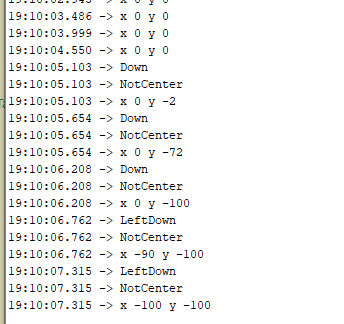

Upload, test:
Console monitoring of Arduino joystick data.
Everything works, and we have swings in the range of -100 to 100, so these are no ordinary buttons - that's what we wanted, this allows to control the given device in a precise way.

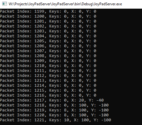

We fire up both programs, both joystick and server.... We make sure they are on the same WiFi network and.... success:
Console window with a running JoyPad server.
Our program correctly receives data from the controller.
