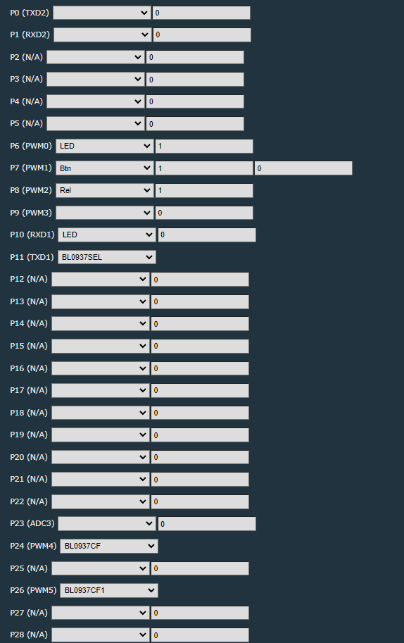

Hi!
I've bought a new smart power socket from Action. Aparrently it's a new model that haven't been posted here. It is using CB2S module.

JSON config:
Plaintext:
- BL0937 SEL on P11
- Button (channel 1) on P7
- LED (channel 1) on P6
- BL0937 VI on P24
- WiFi LED on P10
- BL0937 ELE on P26
- Relay (channel 1) on P8
Device seems to be using CB2S module, which is using BK7231N.

p.kaczmarek2 12 Dec 2023 15:33
OBK config: { "vendor": "Action", "bDetailed": "0", "name": "Teardown Action LCS Smart Plug (with Energy Meter)", "model": "3202087", "chip": "BK7231N", "board": "CB2S", "keywords":... [Read more]

Hello everyone, I also received the sockets today. Unfortunately, it is not possible for me to flash these with the Tuya Cloudcutter OTA. Which profile should you choose? The Tuya firmware is V1.1.17. Thanks... [Read more]
Dobie01 22 Dec 2023 07:59
AFAIK, it is not in the profiles yet. I simply entered the settings listed in the JSON. In "BK7231 Easy UART Flasher," I used the button "change obk settings for flash write" and edited the details before... [Read more]
p.kaczmarek2 22 Dec 2023 08:38
If you are referring to OBK profile, it seems to be here: https://obrazki.elektroda.pl/5843347000_1703230509_thumb.jpg Have you watched our tutorial videos? We have videos one per each device... [Read more]

aldialbrecht2 17 Jan 2024 14:02
Hello everyone, today I successfully flashed said sockets to openbk using a USB to TTL converter. The whole thing worked without soldering using jumper cables and test hooks. If you are interested,... [Read more]

p.kaczmarek2 18 Jan 2024 09:22
The simplest way to get it automatically configured is to use our OBK Web App config extraction: Thanks to this, you can get GPIO config directly from Tuya partition. It's always better than guessing. Anyway,... [Read more]
dingsundbums 18 Jan 2024 09:32
Did it with a dump to get the pinout. Worked too. As said: only Voltage divider was wrong. [Read more]

Hey! so i flashed the chip and all well. But when i calibrate the power, it stays on 2.5watt even the attached appliance is 100% off? Did i do something wrong or is the onboard powermeter not very reliable?... [Read more]
p.kaczmarek2 11 Apr 2024 12:03
Apart from the 2.5W issue, which seems similiar to the problem I read in this topic: https://www.elektroda.com/rtvforum/topic4047633.html do everything else works correctly? Are 100W, 200W, etc, loads... [Read more]
