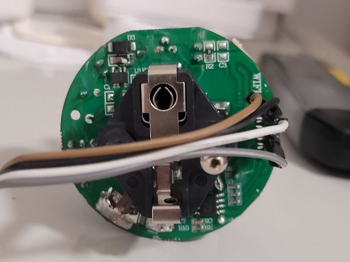

  • Hi!
    I've bought a new smart power socket from Action. Aparrently it's a new model that haven't been posted here. It is using CB2S module.
    Screenshot of pin configuration for a smart socket.
    Smart power socket user interface displaying measurement data.
    New Action smart power socket in white color.
    Close-up of a circuit board inside a smart power socket with visible wires.
    Close-up of a circuit board featuring a BL0937 integrated circuit and various electronic components.
    Close-up of the internal components of a smart power socket showing the electronic module.
    Close-up of the interior of a smart socket with a CB2S module.
    Back of the LSC Smart Connect smart plug packaging.
    Box of LSC Smart Connect smart power plug.

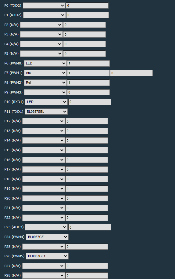

    JSON config:
    Plaintext:
    - BL0937 SEL on P11
    - Button (channel 1) on P7
    - LED (channel 1) on P6
    - BL0937 VI on P24
    - WiFi LED on P10
    - BL0937 ELE on P26
    - Relay (channel 1) on P8
    Device seems to be using CB2S module, which is using BK7231N.

    OBK config:
    Added after 13 [minutes]:
    Added, thank you:
    https://github.com/OpenBekenIOT/webapp/commit/6b2b0c0fd57f1b99a3bbf2a88d073ffe651e46c4

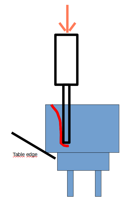

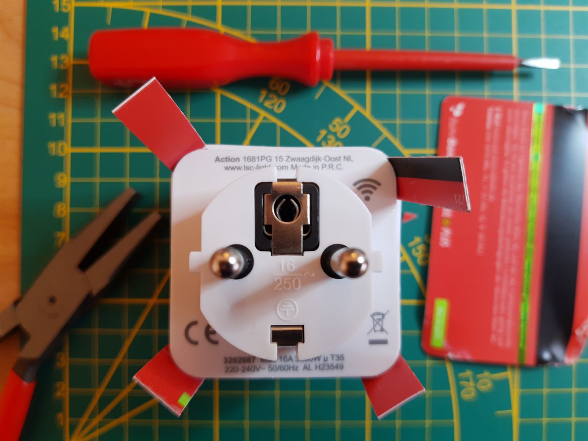

    Hi,
    Thanks for the info. How did you open it without breaking the housing?
    Ok, found it: The hooks that hold it together are in the corners. So you have to press the edge on the side of a table at a 45° angle and then push on the left or right ground surface with a screwdriver.
    Schematic drawing showing how to remove a device cover using a table edge and screwdriver.
  • #4 20867542
    mihaim1980
    Posts: 19
    In each corner on the back, there is a clip. I used a slim metal blade to force it a bit.

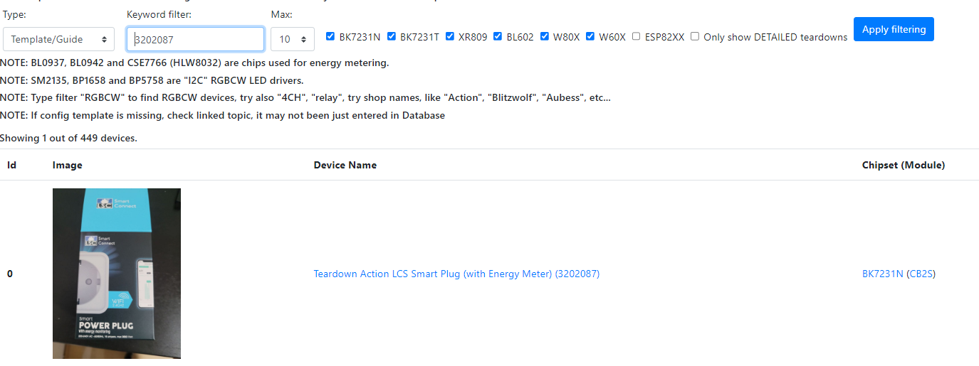

    If you are referring to OBK profile, it seems to be here:
    Screenshot of an electronic devices database.

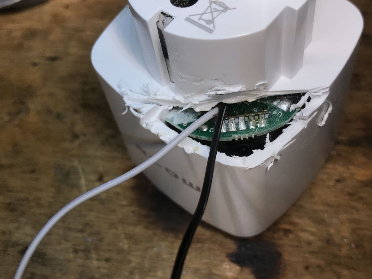

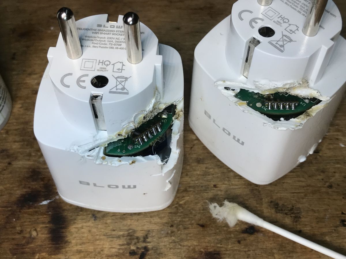

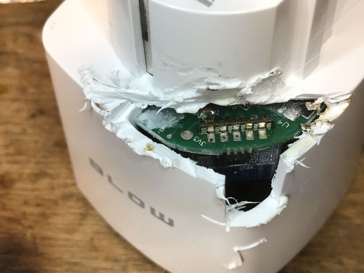

    It's easy to flash with wires, even if socket is hard to open. Here's how I handled one like that:
    Two damaged smart sockets with exposed internal electronics. Close-up of a damaged plastic device with visible wires and a circuit board. Close-up of a white plastic casing with damage exposing a green electronic circuit board.
    It's just import to secure the hole later.
    Fortunately, the LSC sockets are not glued and can be opened easily. Do you have a tutorial for flashing using a USB to TTL serial adapter? Thanks in advance!

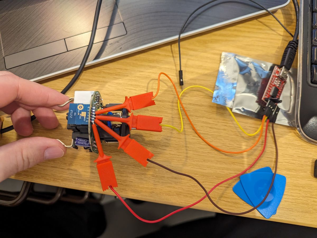

  • USB-to-TTL flashing of BK7231N socket without soldering
    #13 20914389
    aldialbrecht2
    Level 4  

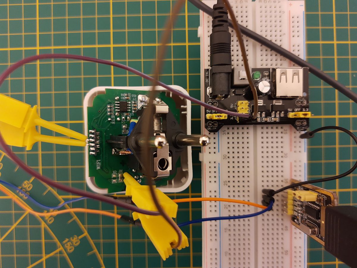

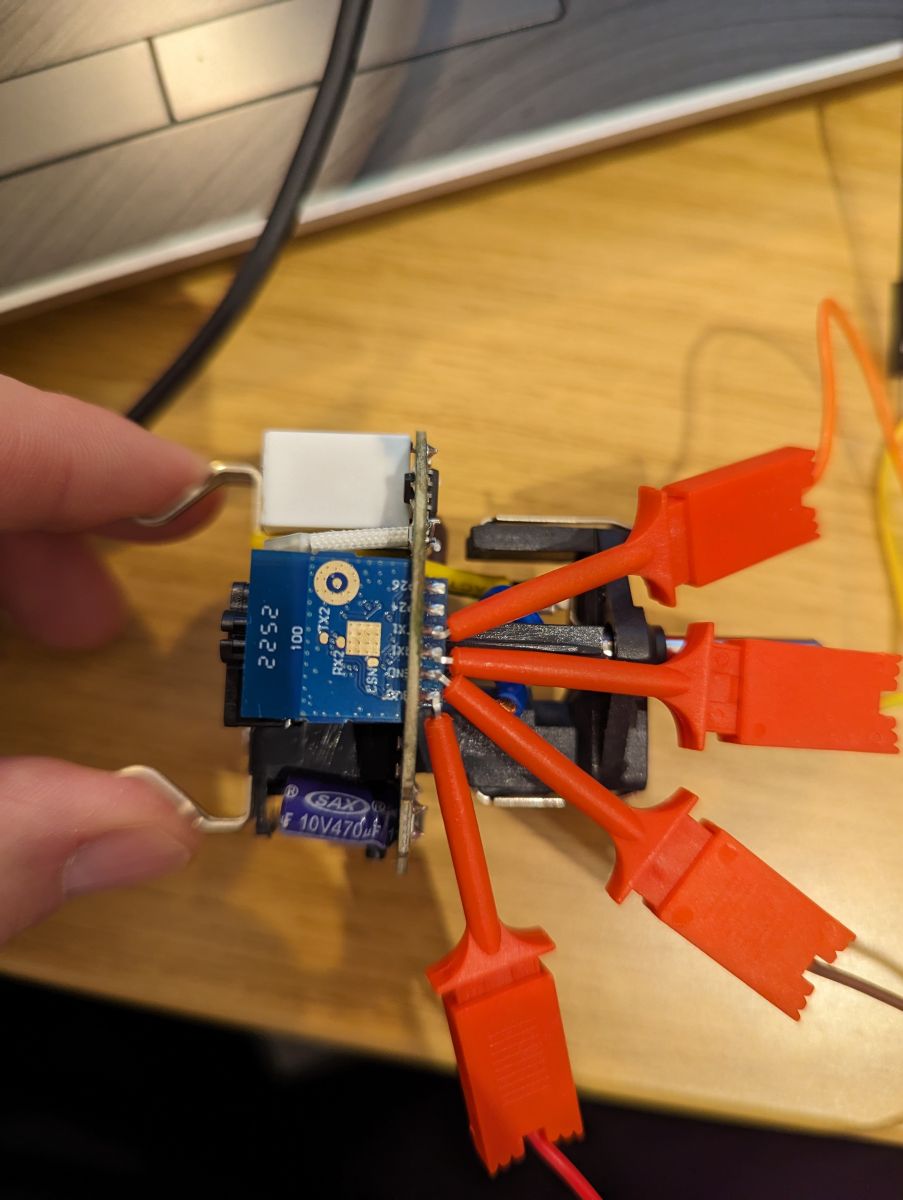

    Hello everyone,
    today I successfully flashed said sockets to openbk using a USB to TTL converter.
    The whole thing worked without soldering using jumper cables and test hooks. If you are interested, here is the link and two more pictures:
    Close-up of a Haljia DuPont cable set with test hooks, available on Amazon.
    https://amzn.eu/d/c8j3XUQ
    A hand holding an electronic setup with cables and test hooks connected to a USB to TTL converter on a wooden desk next to a laptop. Close-up of a hand holding an electronic board with connected red wires and test hooks.

  • Breadboard supply needed for BK7231N flashing
    #17 21029538

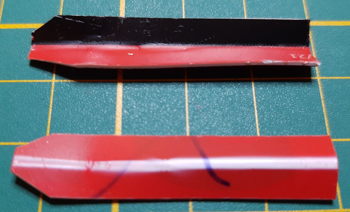

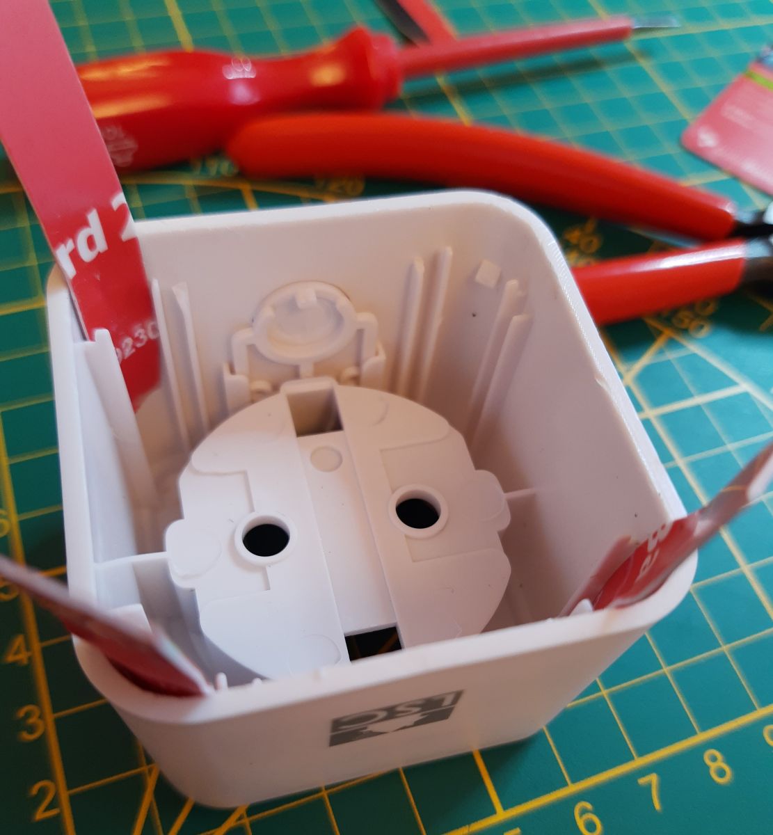

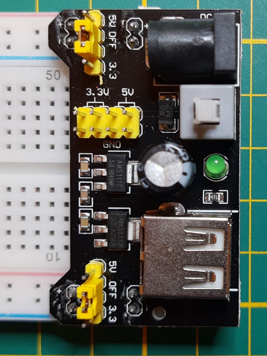

    ElektroTechnikus
    Posts: 22

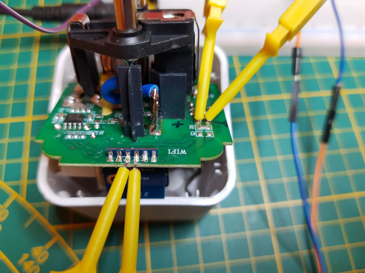

    I have just spontaneously registered here to add some more information. Maybe it will help some successors. Thanks also for the help I found here.
    "Action" in Germany still has some of these sockets on sale and as they are the cheapest with energy metering I could find, I thought I'd give them a try. Disassembly also seemed to be simple...
    However, I didn't find it quite so easy and "carved" four wedges from a credit card to release the tabs in the corners of the housing. I had to use another credit card and a pair of pliers to get them inserted. In the pictures you can see where they finally went in with some difficulty and a lot of wiggeling.
    Electrical socket with adapter and credit card wedges, tools on a measuring mat background. Close-up of an opened socket with credit cards inserted into the casing. Two wedges made from credit cards on a green cutting mat.
    In fact, the power supply from the CH340 adapter was not sufficient, but an existing breadboard power supply solved the problem quite easily, especially as it has its own switch. I also followed the tip with the mini terminals. Again, hopefully the photos show enough detail. The power was injected at the terminals of the 3.3 volts filter capacitor.
    (I did the backup and flashing in two separate steps.)
    Close-up of an electronic circuit with a socket and adapter on a breadboard. The image shows a dismantled electrical socket with an exposed circuit board and attached measurement wires. Close-up of a prototype development board with 3.3V and 5V markings and yellow jumpers. USB to TTL adapter with an integrated circuit on a breadboard

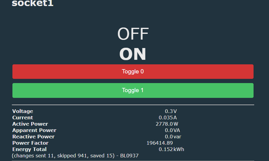

    Hey! so i flashed the chip and all well. But when i calibrate the power, it stays on 2.5watt even the attached appliance is 100% off? Did i do something wrong or is the onboard powermeter not very reliable? I did an athom plug the same way and no problems there...
  • #19 21041264
    Posts: 14755
    Rate: 12878
    Apart from the 2.5W issue, which seems similiar to the problem I read in this topic:
    https://www.elektroda.com/rtvforum/topic4047633.html
    do everything else works correctly? Are 100W, 200W, etc, loads correctly measured?

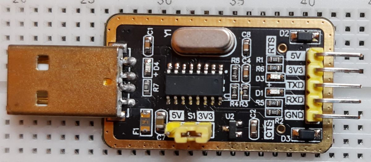

  • Flashing CB2S via CP2102 with EN grounded

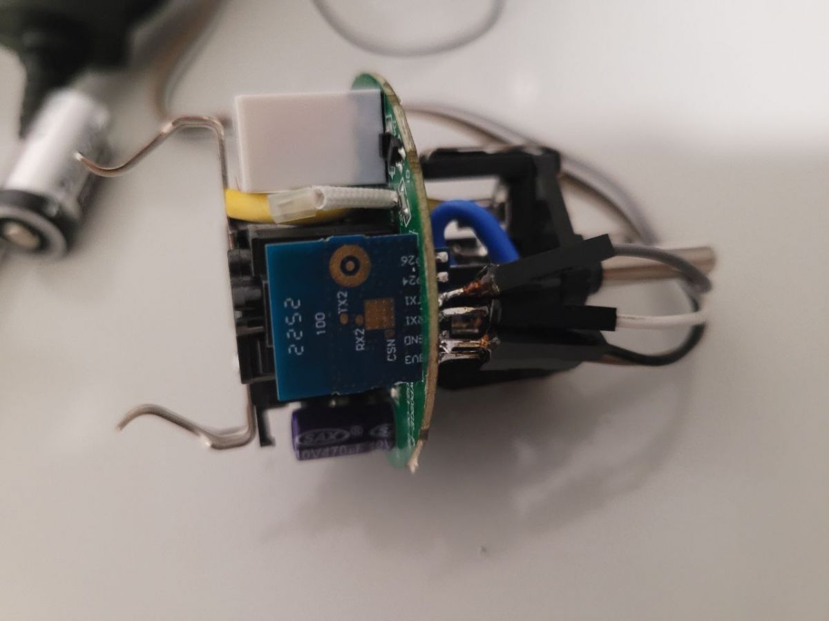

    #21 21544388
    4N6nerd
    I had an old LSC smart plug without the energy monitor and with the strange labeled CB2S board (the one with the T cpu instead of the N version)
    Anyway.... I flashed it using my DOIT ESP32 devkit V1. Or actualy only the CP2102 USB-serial chip which is on that board. The power supply on that board can power the ESP32 so it should be, and is, ably to power a CB2S board.
    So i connected it as follows:
    3V3 to 3V3
    GND to GND
    TX to TX *
    RX to RX *
    EN to GND **
    * YES this is right. TX to TX and RX to RX.
    The TX/RX lables on the ESP32 devboard are labled from the ESP perspective. So from the CP2102 perspective it is the other way around.
    So the label TX on the board is the TX of the ESP and is connected to the RX of the CP2102
    ** This is the main trick in this method. EN is the "chip enable" pin of the ESP32.
    Pulling EN to GND makes the ESP32 inactive. Effectivaly leaving you with just the CP2102 USB to serial converter and a powerfull enough 3V3 powersupply.

How do I flash the BK7231N-based Action LSC smart plug with a USB-to-TTL adapter and OpenBeken?
Flash it over wired UART after opening the housing and connecting a 3.3 V serial adapter to the CB2S module. 1. Open the case and access the module pads. 2. Connect power, GND, TX, and RX with a USB-to-TTL adapter. 3. Use BK7231 Easy UART Flasher or ltchiptool to back up and write OpenBeken. Multiple users reported success, including no-solder setups with hooks or grabbers. [#20914389]
Why does Linux lose the UART port during BK7231 flashing when I power-cycle the module, and how should I reset it properly?
Linux loses the UART port when you disconnect power from the USB-to-UART converter instead of only resetting the target module. The thread’s advice is to remove 3.3 V from the Wi‑Fi module, not unplug USB. That keeps the serial device present while the BK7231N reboots. Poor power wiring can also make the port disappear during inrush. [#20872214]

How do I flash an LSC smart plug without soldering using jumper wires, test hooks, or mini grabbers?
You can flash it without soldering by gripping the module contacts with temporary probes. 1. Open the plug and expose the CB2S area. 2. Attach jumper wires, test hooks, or mini grabbers to 3.3 V, GND, TX, and RX. 3. Power it from a stable source and flash over UART. Users reported success with test hooks, mini terminals, and even improvised access holes that were sealed afterward. [#21029538]
Why does the flashed Action LSC plug report about 2.5 W even when the connected appliance is fully off?
The thread does not confirm a final fix; it flags about 2.5 W idle reading as a known metering issue to investigate. The follow-up question asked whether larger loads like 100 W and 200 W were measured correctly, which implies the offset may affect low-end calibration more than full-scale readings. Treat it as a calibration or measurement-floor problem, not proven hardware failure. [#21041264]
How should I configure BL0937 voltage divider and status LEDs in ESPHome or OpenBeken for this smart plug?
Use BL0937 on P26, P24, and P11, and check the voltage divider carefully. One user reported the profile’s divider felt wrong and got better results with voltage_divider: 800 instead of 1600. That same setup defined two status LEDs: blue on P10 and red on P6. If your voltage reads high or low, start by checking that divider value first. [#20915418]
How can I use an ESP32 dev board’s CP2102 USB-serial interface to power and flash a CB2S smart plug safely?
Use the ESP32 board only as a CP2102 USB-serial adapter by disabling the ESP32 itself. Connect 3V3 to 3V3, GND to GND, TX to TX, RX to RX, and pull EN to GND. The thread explains that TX/RX are labeled from the ESP32 side, so TX-to-TX and RX-to-RX are correct in this special case. This method also provides a strong enough 3.3 V supply for CB2S. [#21544388]
